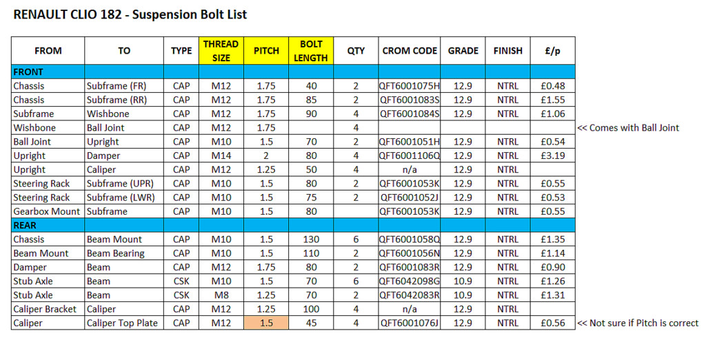

https://www.cliosport.net/threads/nuts-and-bolts.814078/
Hi Neil..
I've condensed the info I have on the suspension bolts.
The caliper backing / top plate I ended up reusing the original bolts as the top plates use the shank of the bolt to locate and is a special size bolt.
I also spec'd these bolts to get the required shank length, they will need cutting down to suit, or you'll have excess thread out the end of the nut.
I bought the bolts from Cromwell and have listed the part code.
Hope that helps.
