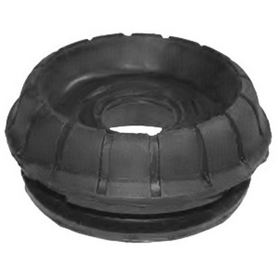

I'd use spring compressors, you need the top mount rubber thing off your old strut, if you dont use compressors you'll be looking everywhere for that nut
Are you referring to use the rear springs without using the mounts given, fine if you want the extra lows many do it.
Sorry yeah as George says, you will need to use spring compressors if you want to re-use your top rubber mount (this part in at the top of the strut once removed.
Looks like this
I used new top mounts so didn't think :o
