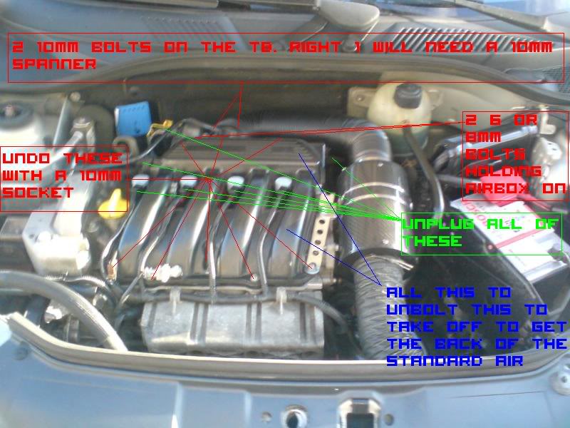

heres what you have to do, sent it to some guy the other day. heres my 1.4 with a BMC which is exactly the same. You have to remove the whole standard airbox with involves removing the plenum to get the rear box off
  Shdhdhd
thanks makes it clear what is needed to swap for ind. kit. did u relocate ur air feed to ur lower grille. i fink our enjoys may be different or the same and diff to the 1.2 ?

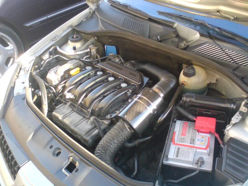

imo, just undo the bottle located behind the ecu, then wiggle the black box at the back of the engine out. comes out easy enough without having to undo the 20 odd bolts. then alls i did, was get some tube, and put it round the throttle body to my bmc cda.
bobs ya uncle, *****s your ant?
edit: old pic -
  Shdhdhd
or you could do this and just remove the air filter from the box at the back:
have u left the part that come out of the back and conected ur pipe unlike that unlike the guy whos seems to go right into the back of the engine?
