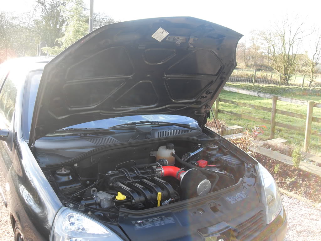

Hey, was gonna fit an induction kit, just for the noice :p, but i can figure out where the hell to fix it on lol. I've got one of the later 1.2's the ones that look like a plastic block. any help would be great thanks.

Take the plastic cover off. Theres a connection for it on the right Need a relocation pipe though

is it like that ^
From memory just disconnect air feed that run in front of your battery to towards the passenger head lights.
Then disconnect breather pipe.
Take off the plastic cover/airbox cann't remember how it is fixed think it was 4 bolts.
Then mount induction kit and 90 degree bend with a breather pipe filter, and I used one cable tie so the breather pipe and filter stayed still
Hope that helps

Thats the one :D thats great
cheers :D
