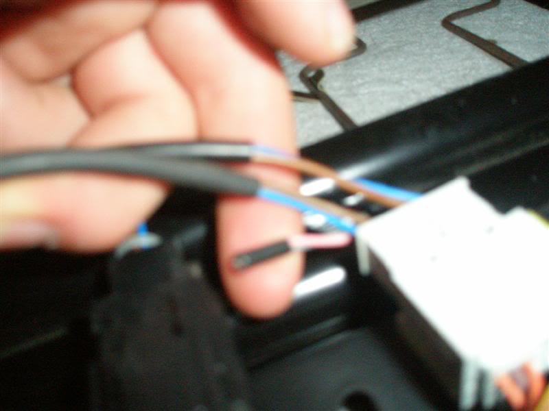

The old seats have pretensioners on the side, an airbag connection in the middle and then a bundle of wires going into the floor

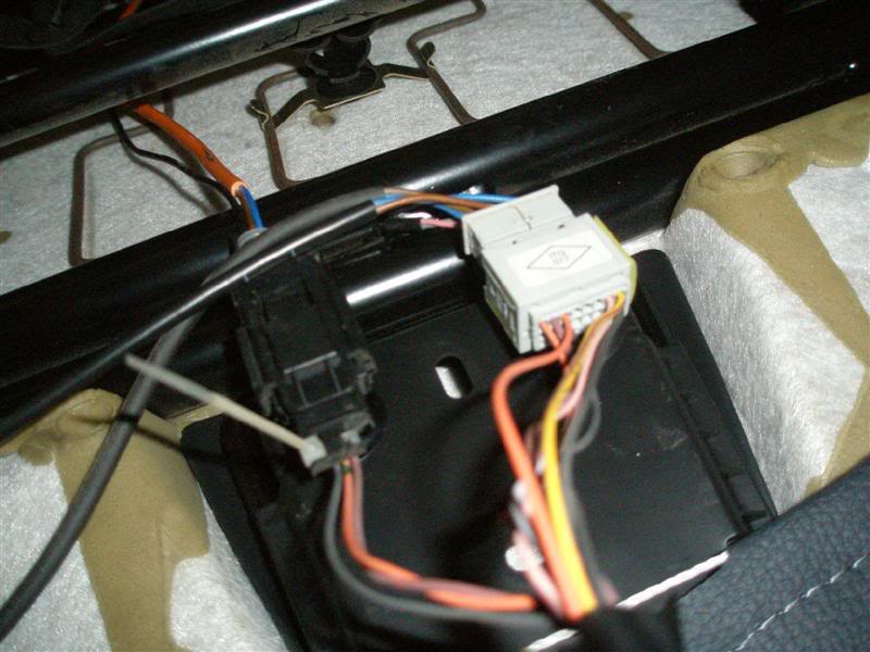

The leather seats have no pretensioners atm, the airbag connection in the middle, another grey connection box in the middle which im confused by and the bundle of wires which have been cut
dunno where to start

anywho ive just niticed that the bundle of wires splits into two connections
a black box and a grey one
on the dynamique there is only the black connection box
what is the grey one for and wha do i do with it?
2 connections
leads into 3 sections one is cut
wire from the grey box lead to this, along side the subframe
ive heard that when you swap seats you have to rewire
can anyone give me some pointers about which wires need to go where
really stuck with this

Just referencing to the above.... the Grey block with yellow part on is the Pre-Tensioner wiring.
The Black Connectior with the red clip on is the Airbag wiring.
yeah i was just about to say the above has. when i fitted mine, i was putting ph1 into a ph2 which had different wiring so i just left them undone. lol. if your swapping the whole seat with the runners it will be better as that thing in the last pic is fitted to the runner, so will break if you remove your seat from the car minus the runner.

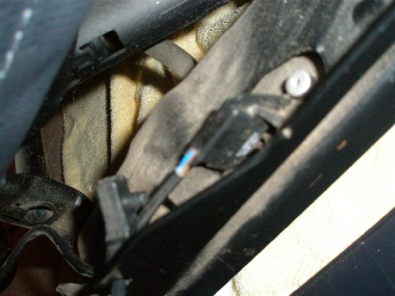

What is the little switch for in the bottom picture on NJ's post? (post 6). I know it goes on the drivers subframe but can I get rid of it when I stick my Cobra subframes on or do I have to fit it somewhere?
