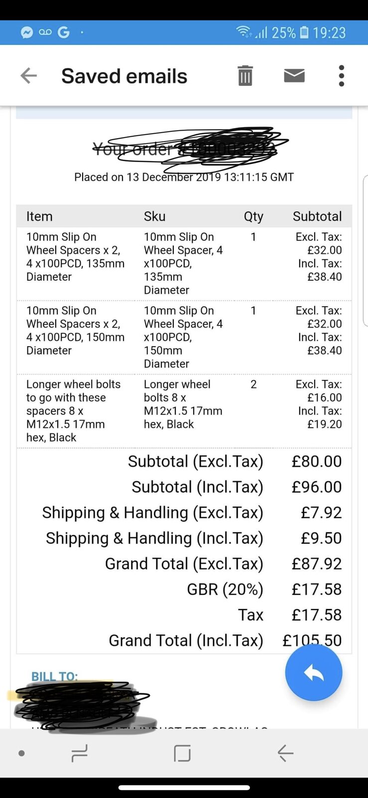

Hello, I’ve recently brought some puremotorsport slip on wheel spacers 10mm, I have a 172 cup. I’m new to the whole spacer scene and just jumped onto the band wagon without doing any research prior to buying them. Another clio sport owner pointed me in the direction off buying them as he has them on his with no issues whatsoever, Same car/wheels etc. When I drive over 60mph I get a violent steering wheel shake, the wheel only just sits on the hub. Brand new brakes all round so the spacers sits flush. Any advice because I can’t send them back and feel like I’ve wasted £105 🙄 sorry I started a new thread but struggled to find a thread with my problem.

Wow they were a lot more expensive than I was expecting! A stud and nut kit may well sort your issue but 10mm all round isn't going to give you the best result.

I know! Me either. If I knew thatthe price would add to that I wouldn’t of bothered. Especially with the hassle I’m getting from it. I’ll try sell these and then get the hub centric for front and the axle spacer for the rear. Thanks for the help, can’t see why pms would sell these especially if this is the issue. Should of checked before hand really but I just 4x100 wheel spacers would work especially only 10mm.
