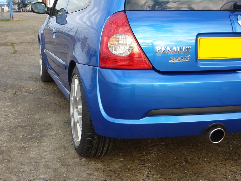

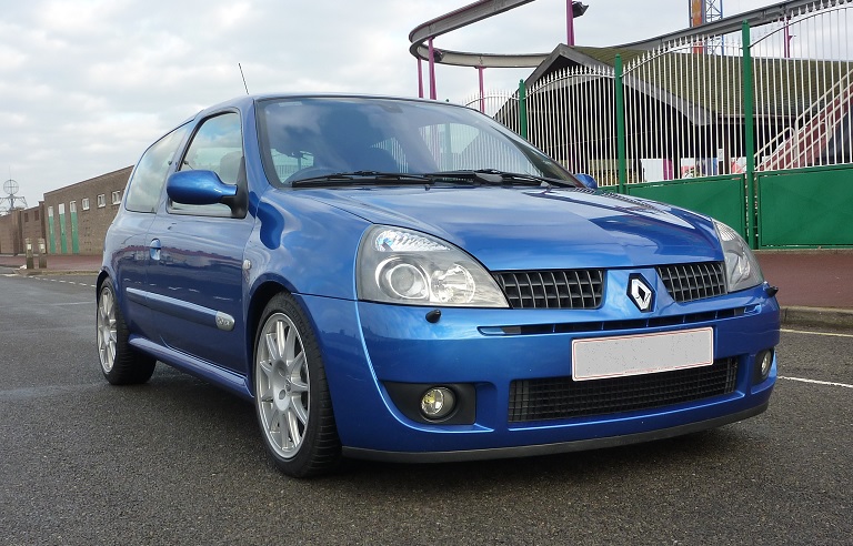

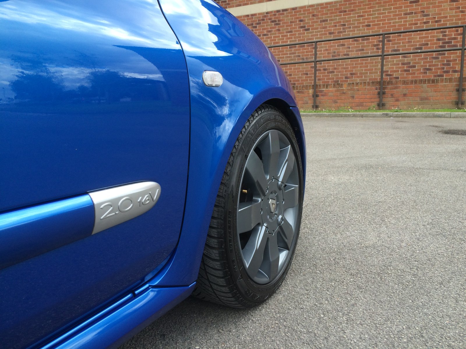

Standard, but want a bit more girth. Excuse the dirt.

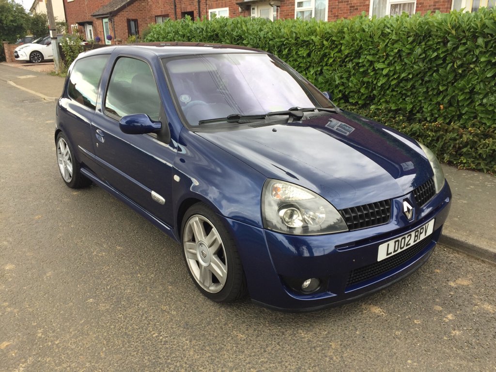

Looks similar to mine at the front. I've tried various spacers and it looks a bit better but prefer without. May be an idea if people are putting pics up to let others now suspension, tyres and offset of wheels.
Is your turinis cup offset or trophy offset? (Cup is et 38, trophy is et43) The lower the number, the further/wider they stick out.

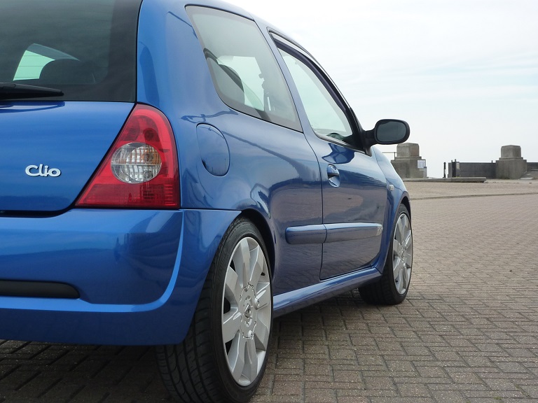

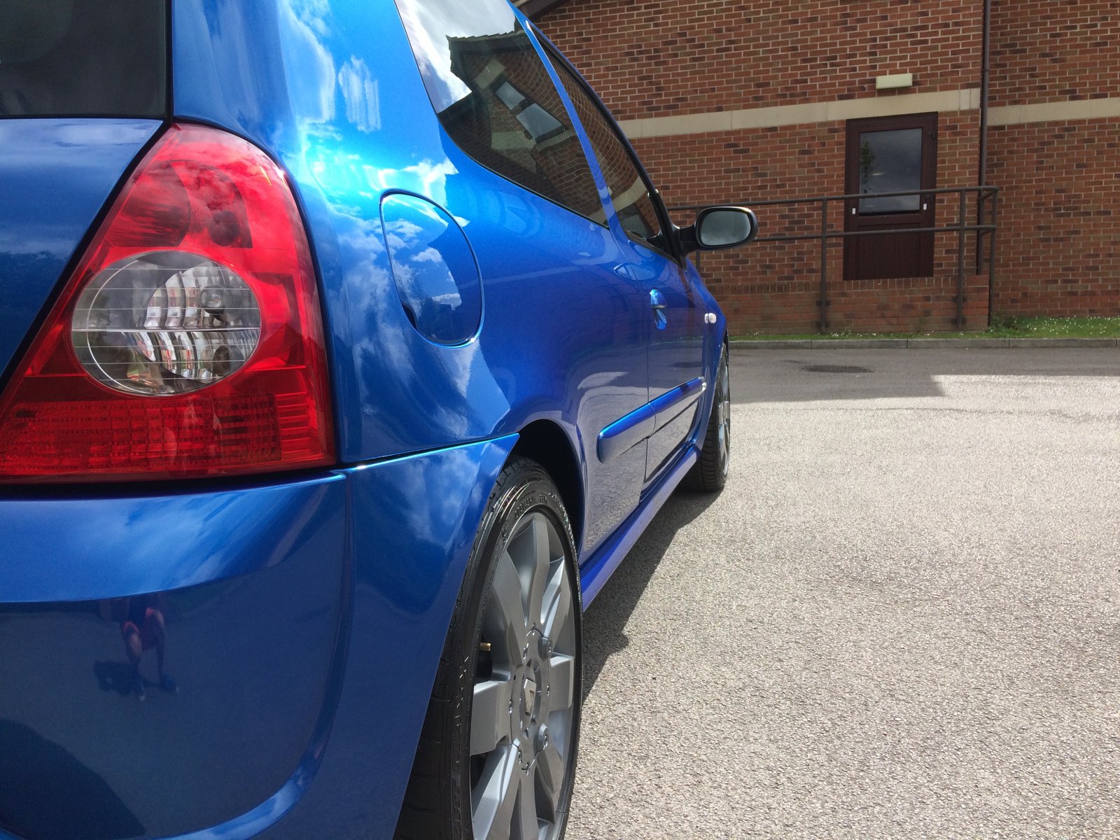

Good idea for a thread this, keeps all the information in one section! I'm really happy with my Clio running 5mm spacers all round with Cup offset Turini's, 195/45/R16 tyres and lowered on Cooksport springs. However, I must agree, the fronts sit perfectly on yours @Christ Almighty at 20mm but they would be waaaay to wide with my Cup offset wheels haha. Maybe in the future I might think about some 10mm's for the front of mine but at the mo, 5mm looks cool.......... oem+ yooo! :laughing:

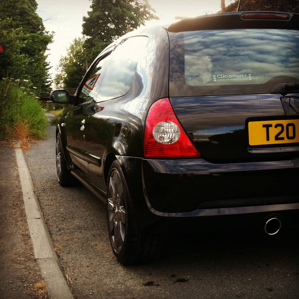

Yeah I get that, when I had the 15mm/16mm hubcentric ones on mine with the standard 182 wheels, the rears looked really smart! I can see how 5mm could do with a small change for the back but it still looks smart!
Have you got any pics of yours with the 15/16mm spacers on the rear with the standard wheels mate?

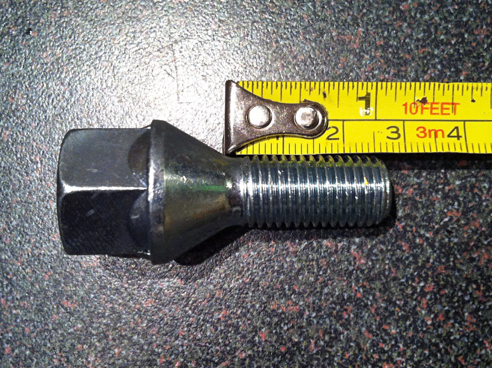

I don't have them anymore sorry mate, I literally sold the 16mm hubcentric ones yesterday to @T9 0LLE for his 172......... when on though, these were using 36mm bolts
This is why I needed the 30mm bolts for the 5mm spacers as the 36's would have been waaay too long!
