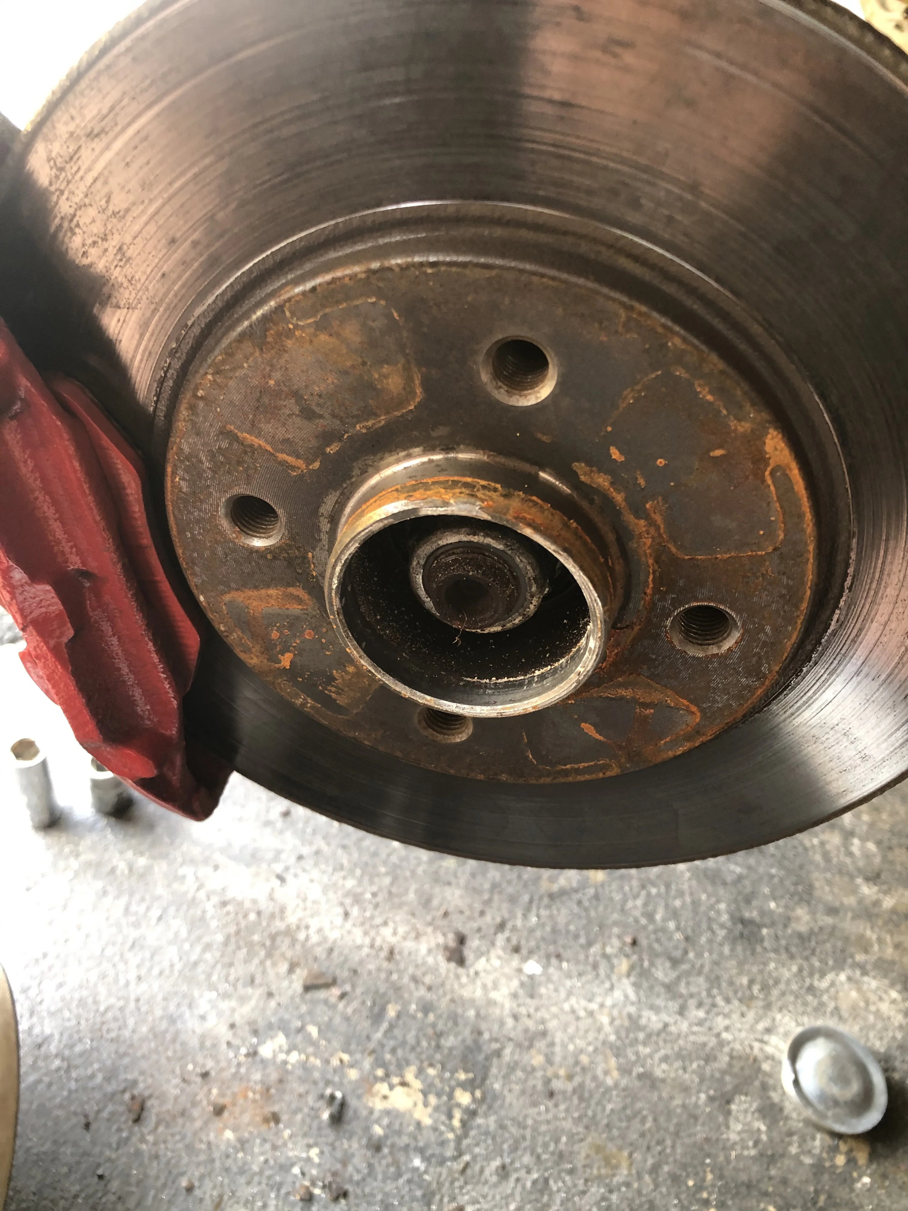

Undo 2x Caliper bolts an move out of way...
Undo hub nut nyloc and remove disc giving access to 4x t50 torx heads...

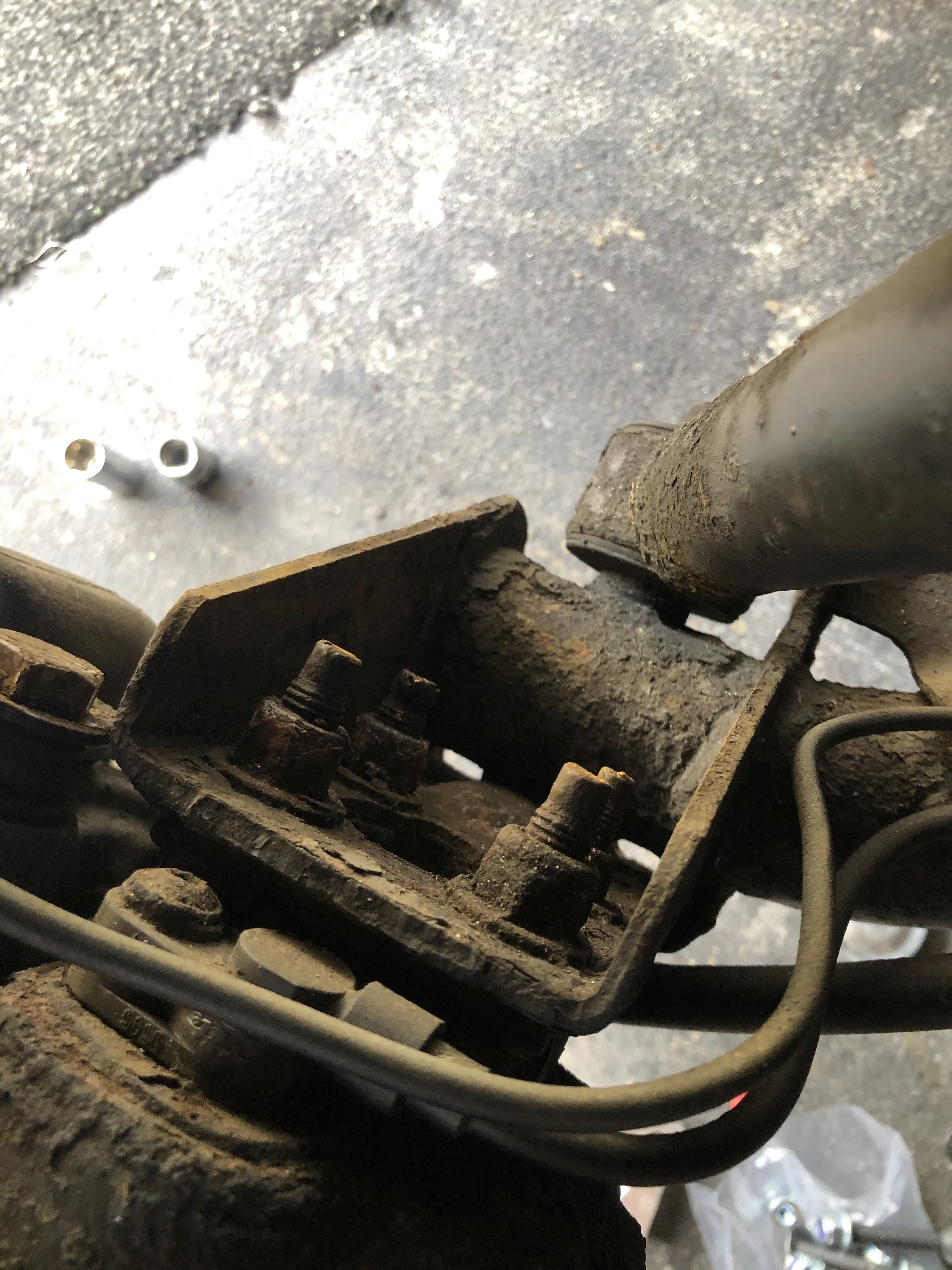

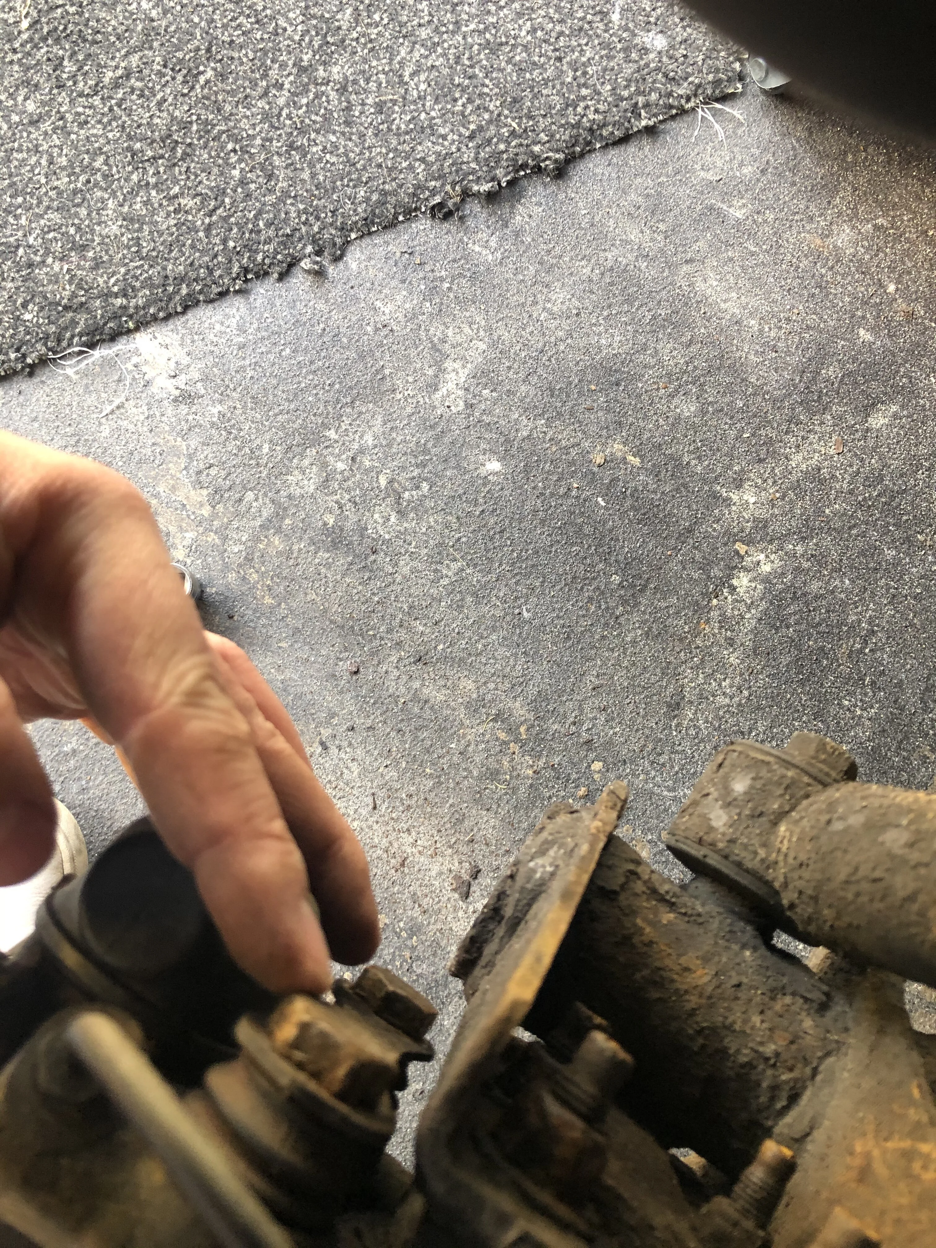

Finally undo the nuts whilst holding the t50s not the other way round...
I know the hub nut is 175nm can anyone please confirm the caliper and axel bolts torque please also?

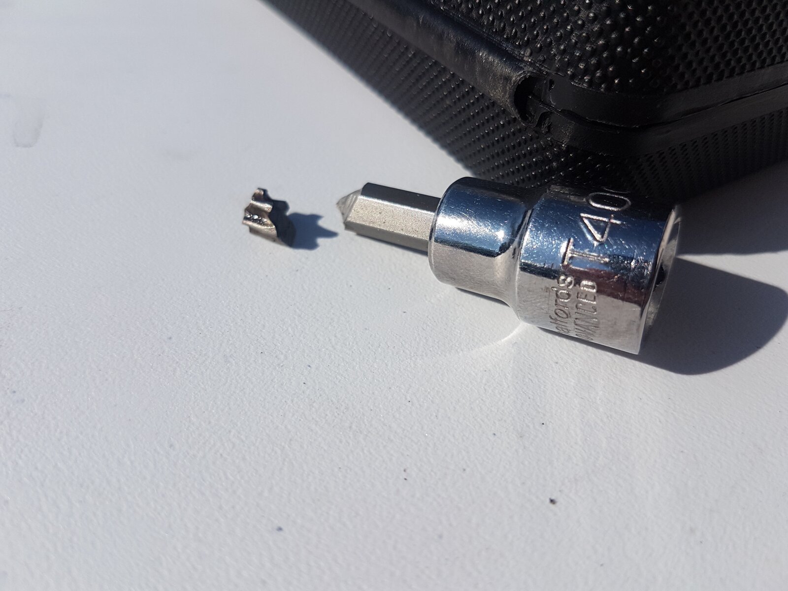

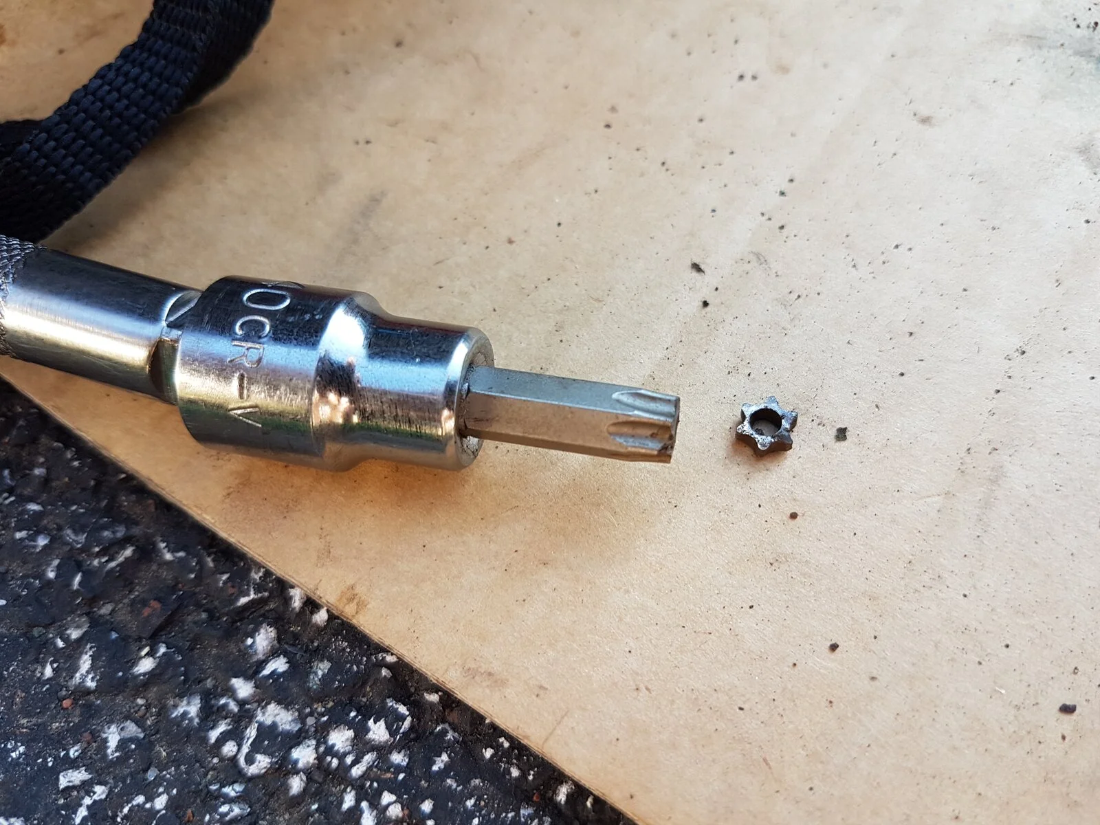

I believe they're T40, but yeah best to avoid undoing them from the front if you can..
