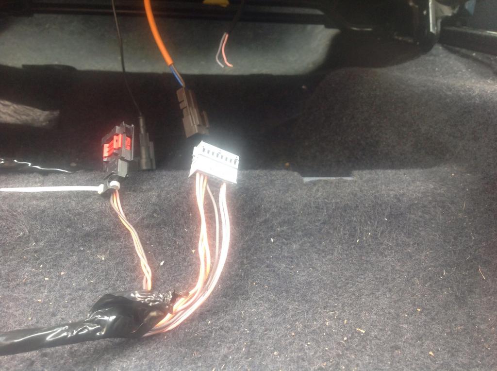

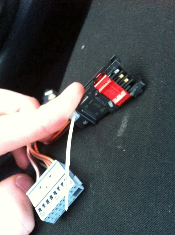

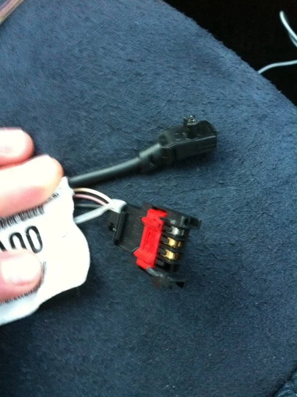

Pictures as requested , these are the wires i have ,

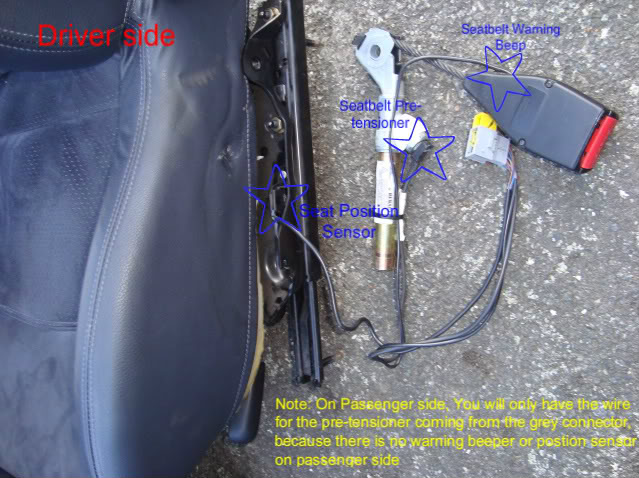

In the guide it says the grey connector is under both seats , but i only have one on the drivers side
And the black connector looks different too

You only need to do it in the one's coming from the car itself. Are the black/red ones attached to the seats or the car end?
The thick black one in the first pic plugs into the seat belt pretensioner.
You can see it plugged into where it should be (metal bit) in my pic:
Yeah the black and red ones come from the car , and one of them
Is attached to the grey one under the drivers seat , the one under passenger seats on its own
I did have airbag in my old seats though :-/ , and i only have 1 grey connector, thats on the drivers side , in the guide it says there is 2

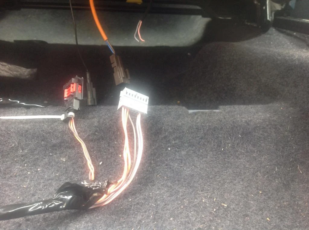

Hi guys first post on an old thread but here goes. Just got my son a clio 1.2 dynamique. It failed the mot today for airbag and service light. This has got sport seats and looking underneath half the wires are not connected but have been attempted at some stage. I have wired the passenger seat, see pic but the drivers seat has the grey and black connector from the car, resistor has been fitted to the black connector, the grey connector should plug into the connector from the seat but there is no seat connector just a orange wire, grey and pink and a black. Can I cut the grey connector of and wire them altogether, if so can anyone tell what wire to what.
thanks
