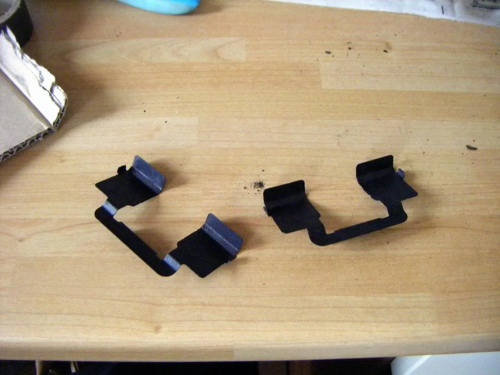

Just reading through other threads here the shims go on to the pads not the carrier right? Appologies for a daft question.
Seems I was a bit confused as to what shims actually were.
Not these bits as I now know!
What are these and are they important?

They are anti rattle shims.
Ahh okay thanks.

I'm being told elsewhere that some copper grease between the back of the pad and the shim is all that's necessary? In that they don't need sticking to the pad. They have raised notches that would stop them dropping down and cutting in to the hub.
you changed front and rear pads? you dont need much grease at all, just where metal meets metal except the friction material itself!
