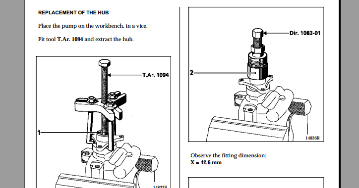

I thought at one point I needed to change my steering pump so did all the necessary looking into it.
You need a puller to get it off, and I found the part no for the tool needed to press it back on, Its: Dir. 1083-01 and was around £30 when I asked.

Yep I had the same feelings when I thought I needed mine changing, I dont know myself but someone might know on here if that tool above to push the flange on is just so it can be done without a press?
Could a garage with a press push the new flange on or special tool only?
you'll never get the flange off an old one, just order a new one, it'll save you time and hastle when you have to order it later
Correct. order a new flange 1 you can line it up better.
2 they always break. you can't use a press other wise it pushes the shaft out the back of the pump.
