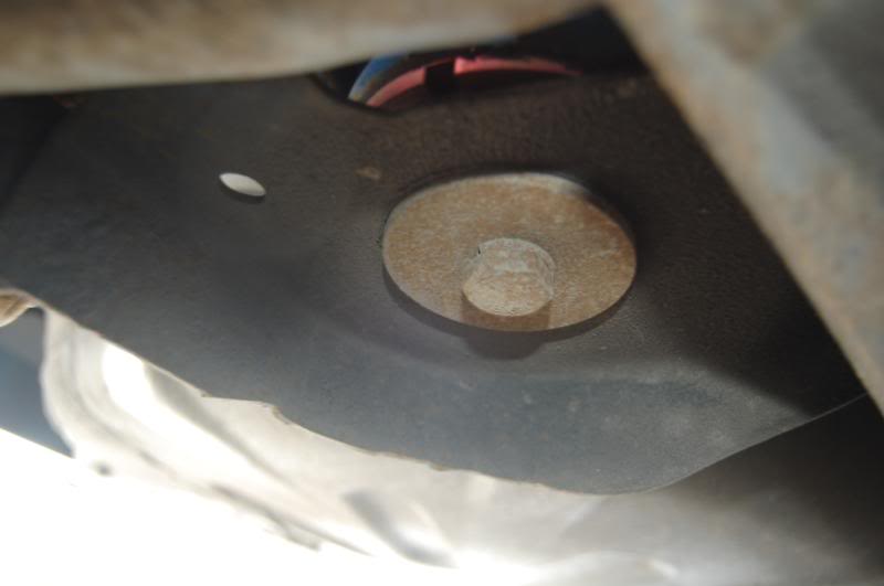

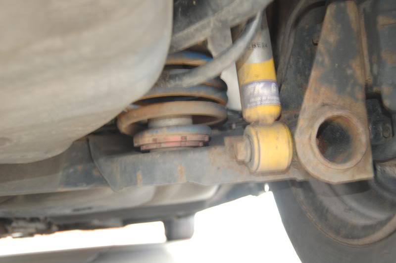

on mine the rear coil plate is bolted on, you done that?
ill go and take a pic now how mine are

Karl - yeah we bolted that plate onto the bottom and tightened it as much as possible. Have you got any pics of what the back struts look like from inside the back of your car and also underneath the arch? Just for comparison.
Did you put them onto your car exactly how they came out of the box mate? as shown in the pic I posted above.

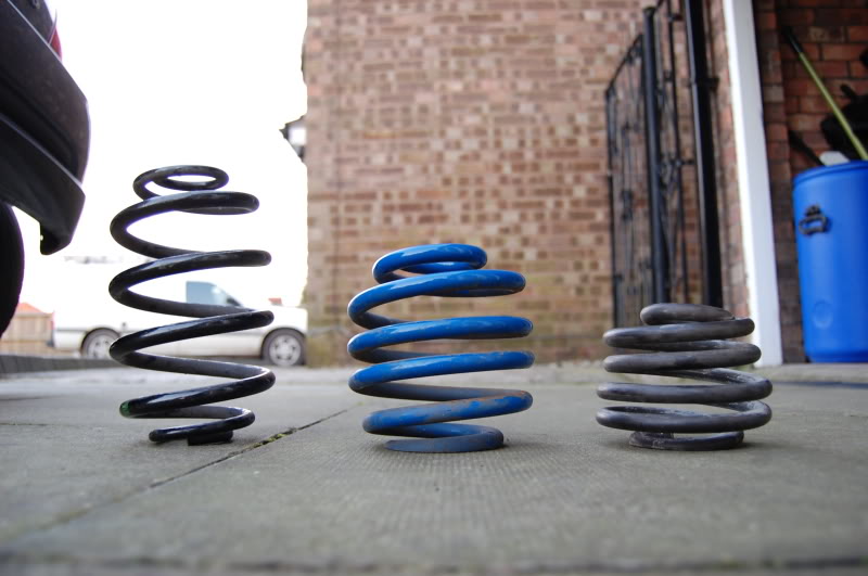

if you had seen my rear springs in person, off the car, you would be worried to set foot in my car to be fair, lol, i fitted them as edde fitted mine, as immis are, as cliochris1's are..........if 3 cars or more are wrong so be it, let somewhere else have a gander as jay said

Perhaps if it is very low and the springs are compressed too much they will bind? And make a metallic noise? Also arent you supposed to use the rubber mounts on the rear suspension at the bottom of the spring ...
  Vectra 1.9 CDTi SRi 150
Stock set up uses a rubber pad top and bottom of the spring. With the FK's the bottom pad will be removed. The coils do bind on these, this will be visible once the paint has worn off. IMO the FK springs are too hard for road use, i found my back end bouncing off the road on bumpy roads at speed. Having spoken to FK by email, they do a softer set which have comparible spring rate to that of the GDi coilovers.
I'm starting to think this tbh, we have maxed out the height at the back and when going over bumps/round bends fast they are bound to move.
I'm going to go try it without the 20mm spacers at the back now and see if it's them. I still can't see why FK would package the rear shocks differently to how your supposed to fit them....

bound to move where? they are perfect fit around the seating platform as they are designed to be, and they arent going to come off that as the whole weight of the car (1 tonne+) is ontop of them..........if your'es are coming off them platforms what are mine going to be doing? my springs are half the size of the FK ones on the back....
