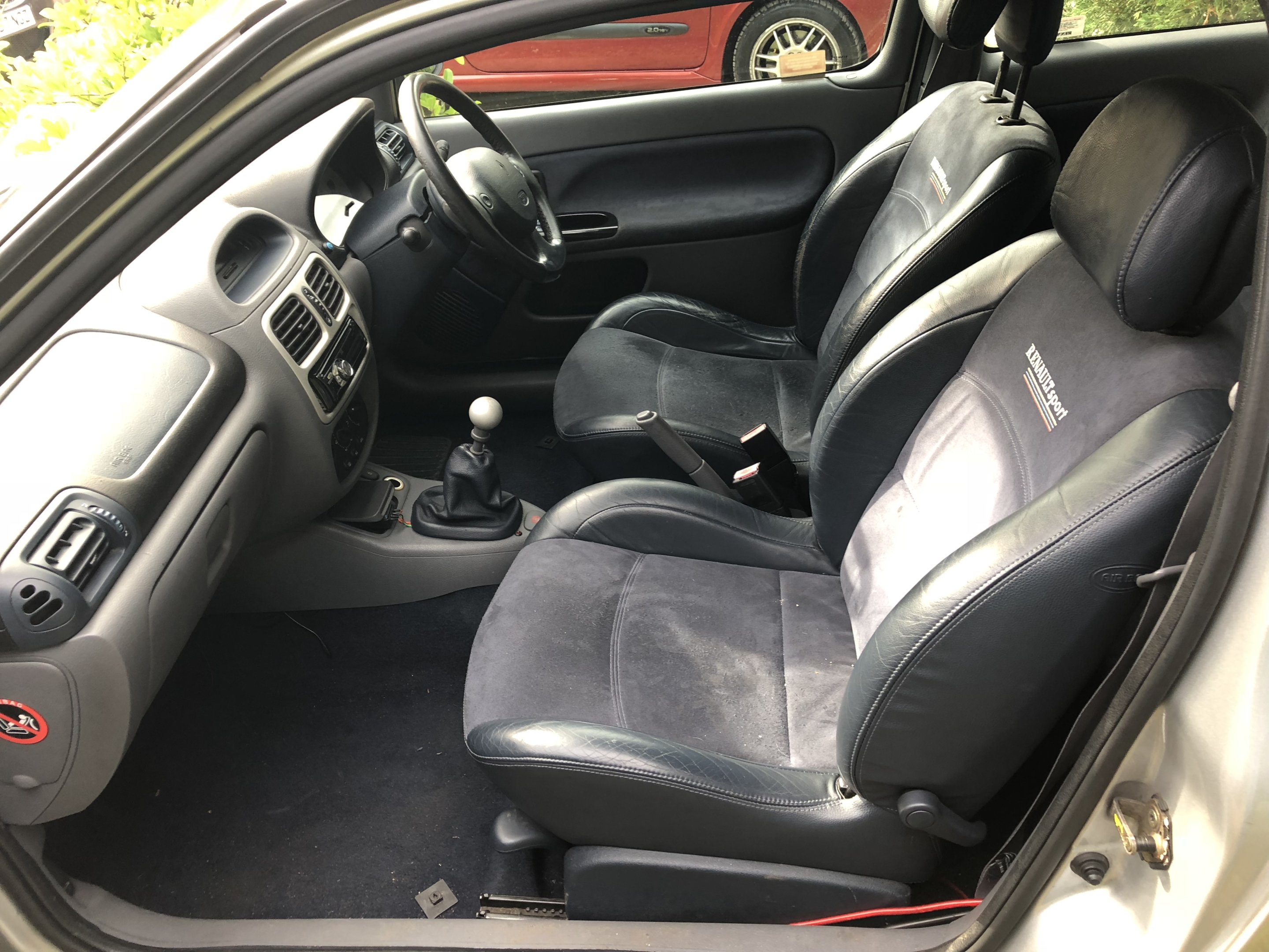

Looks good perfect daily now, quick question, does the dash top with the clock in just pop off the dash or is it plastic welded on, I am guessing you had to take it off to run the cable underneath for the Parrot
Yes you have to pull it up and forward hard, it doesn’t feel natural but it then pops off

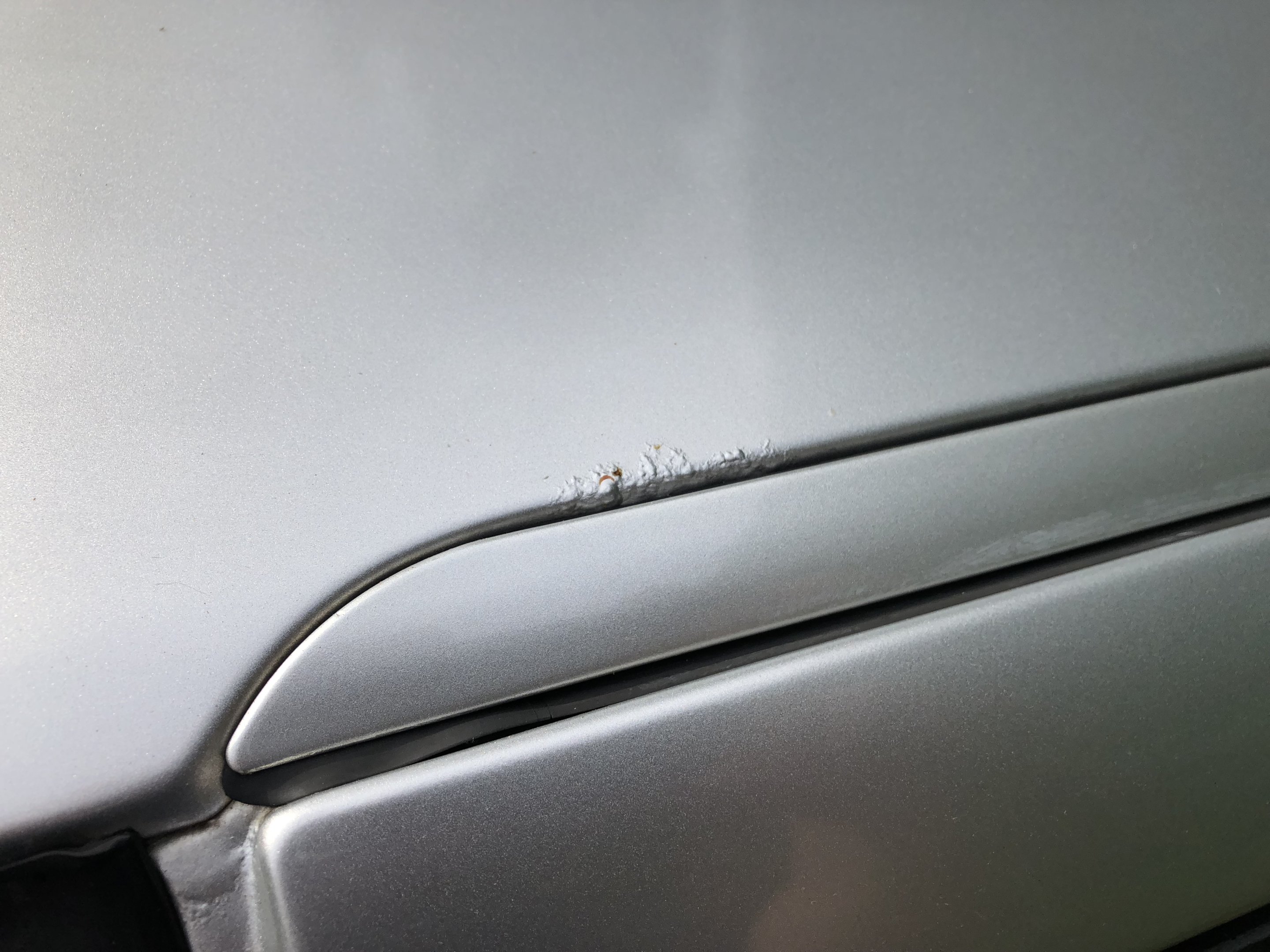

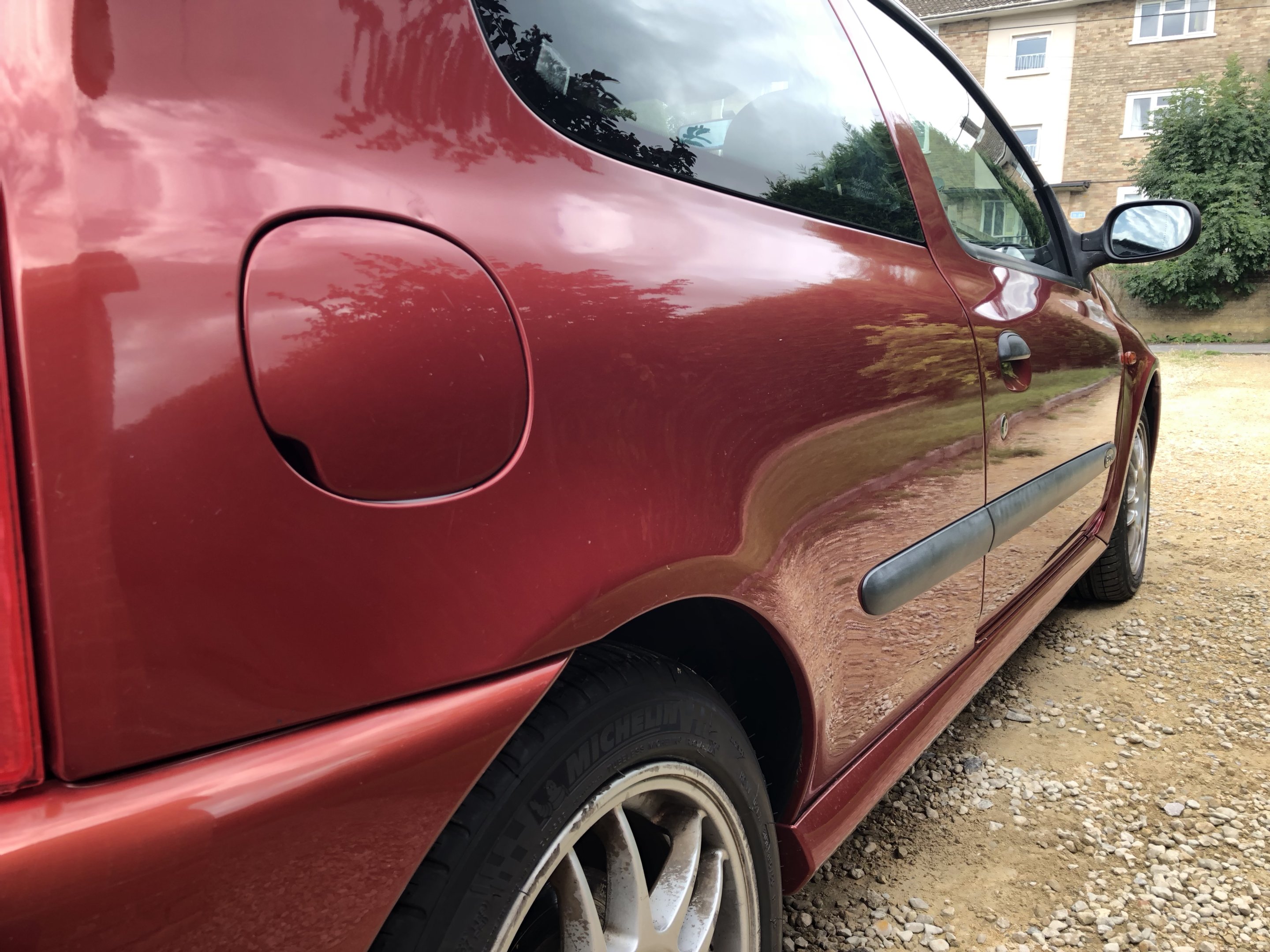

Had door dent man here for
2hrs today, 20 dents removed later she is Looking 1000 times better. Can do anything with on dent my petrol cap but I can handle that. £100 all in.

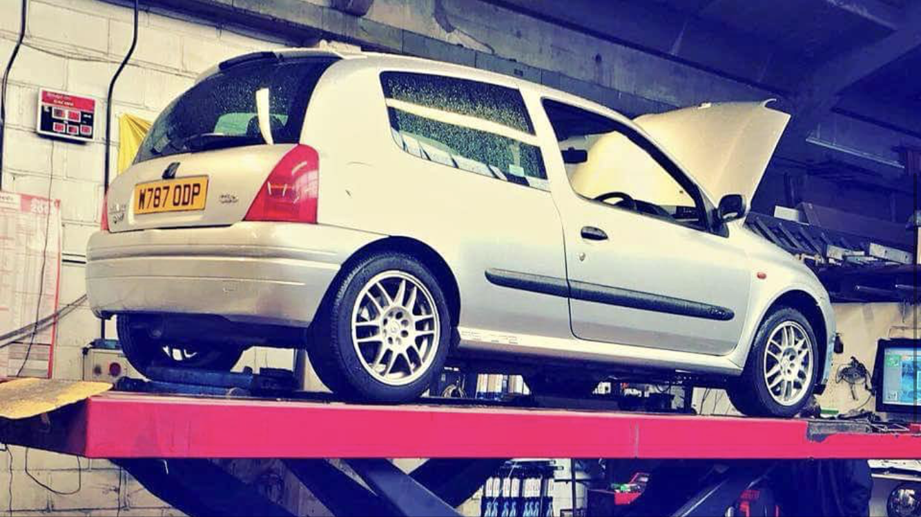

Flamer is in for its belts today, very large service at a very large expense. Hopefully wife will be driving home shortly.
Interesting the belt looked in great nick and was timed correctly. Probably didn’t need doing but there is no history of belts and the car has been off the road since 2012.
Also fitting new lower arms and inner/outer arb bushes.

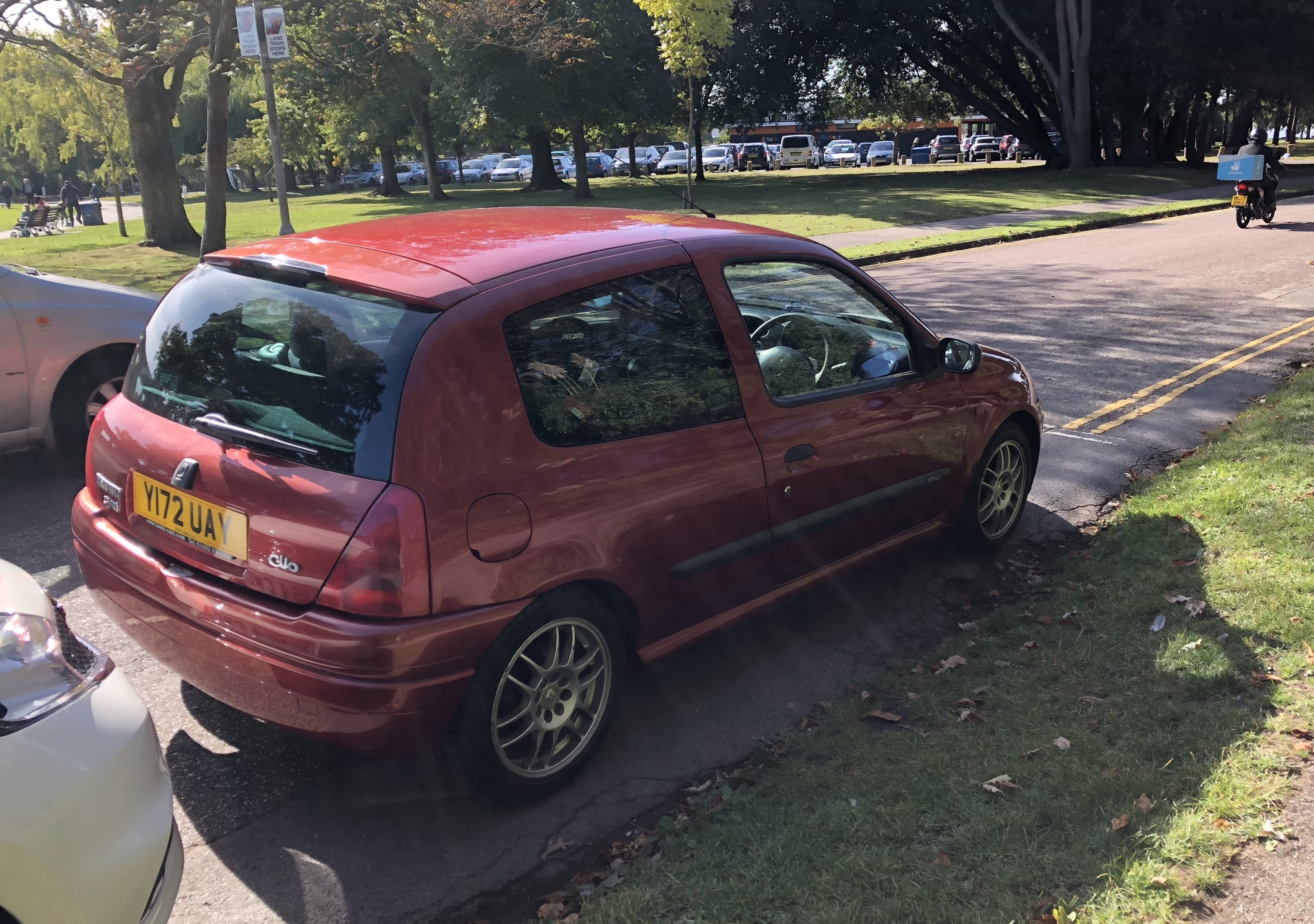

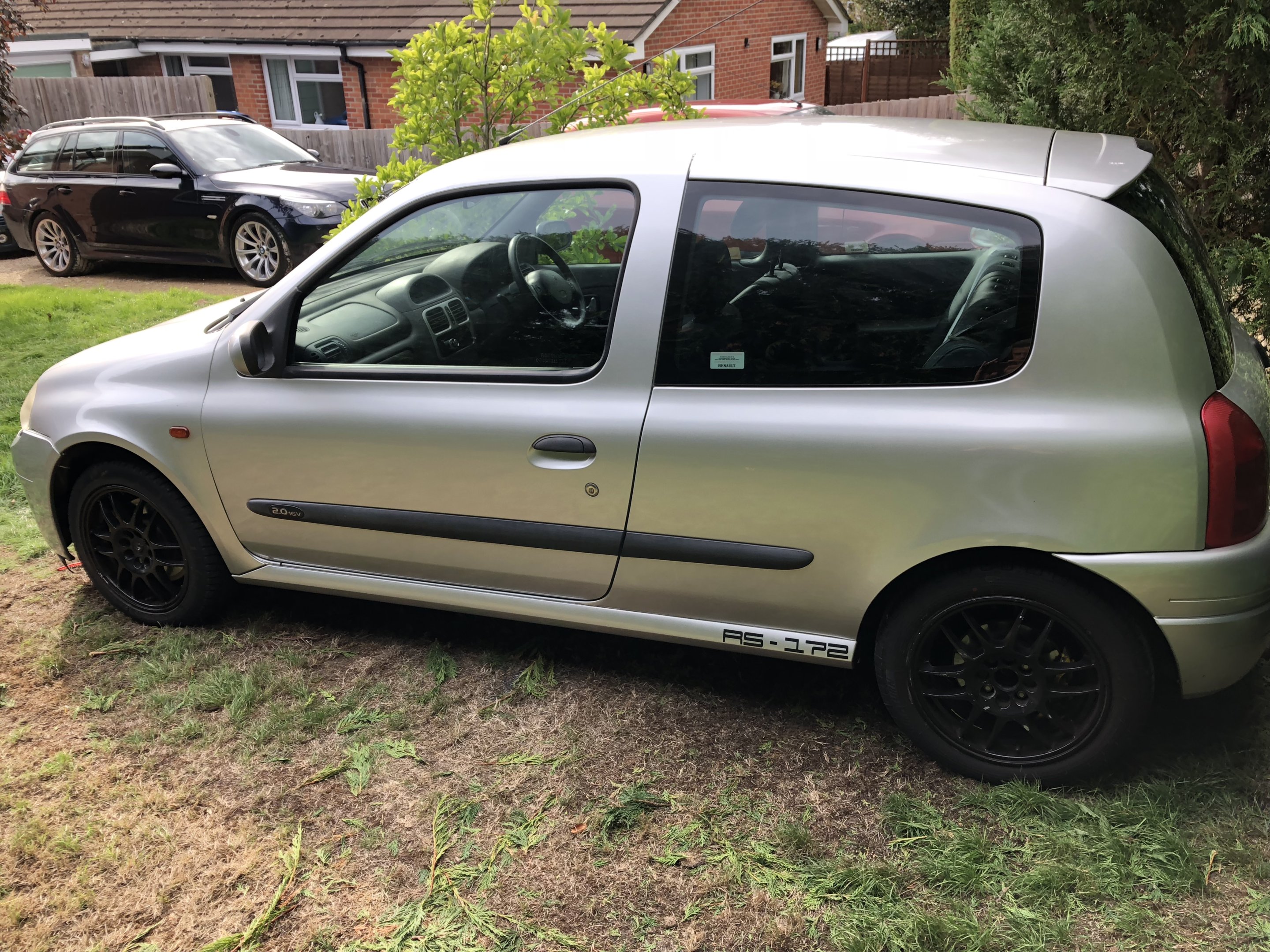

Spent the day on road in the flamer picking up this £500 shed....
Daz...
  Inferno 182 Cup
Crazy stuff, your drives becoming a retirement home for old Clios!
That new 500 quider looks rough but for that money, certainly can't complain as that's proper cheap. The well painted fuel rail guard is a highlight isn't it!
What's the plan? Make it mint or use for parts etc?
Naughty Boy
Brembo! Brembo! Brembo!
Parts car literally. Won’t be doing anything else with it.

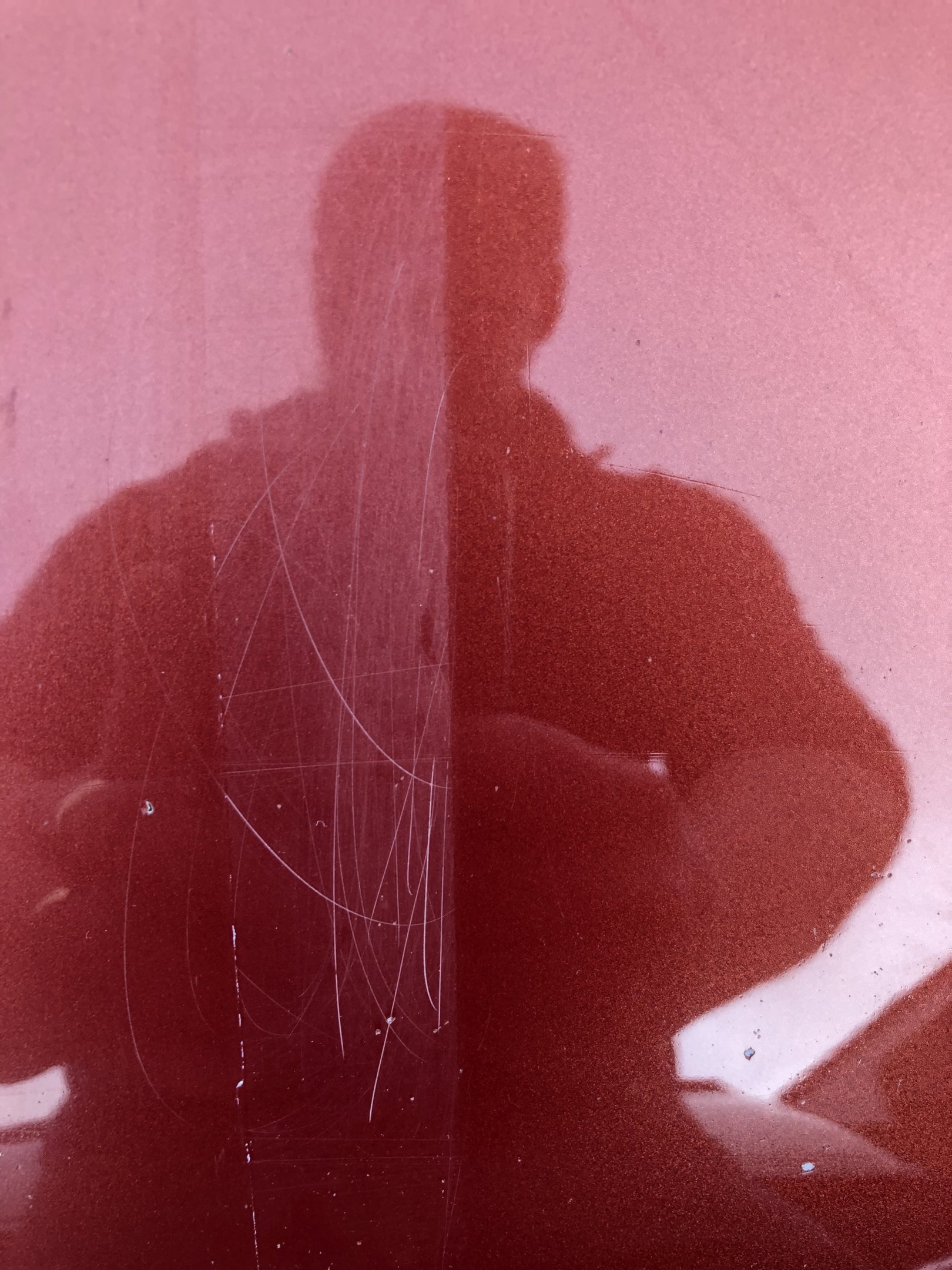

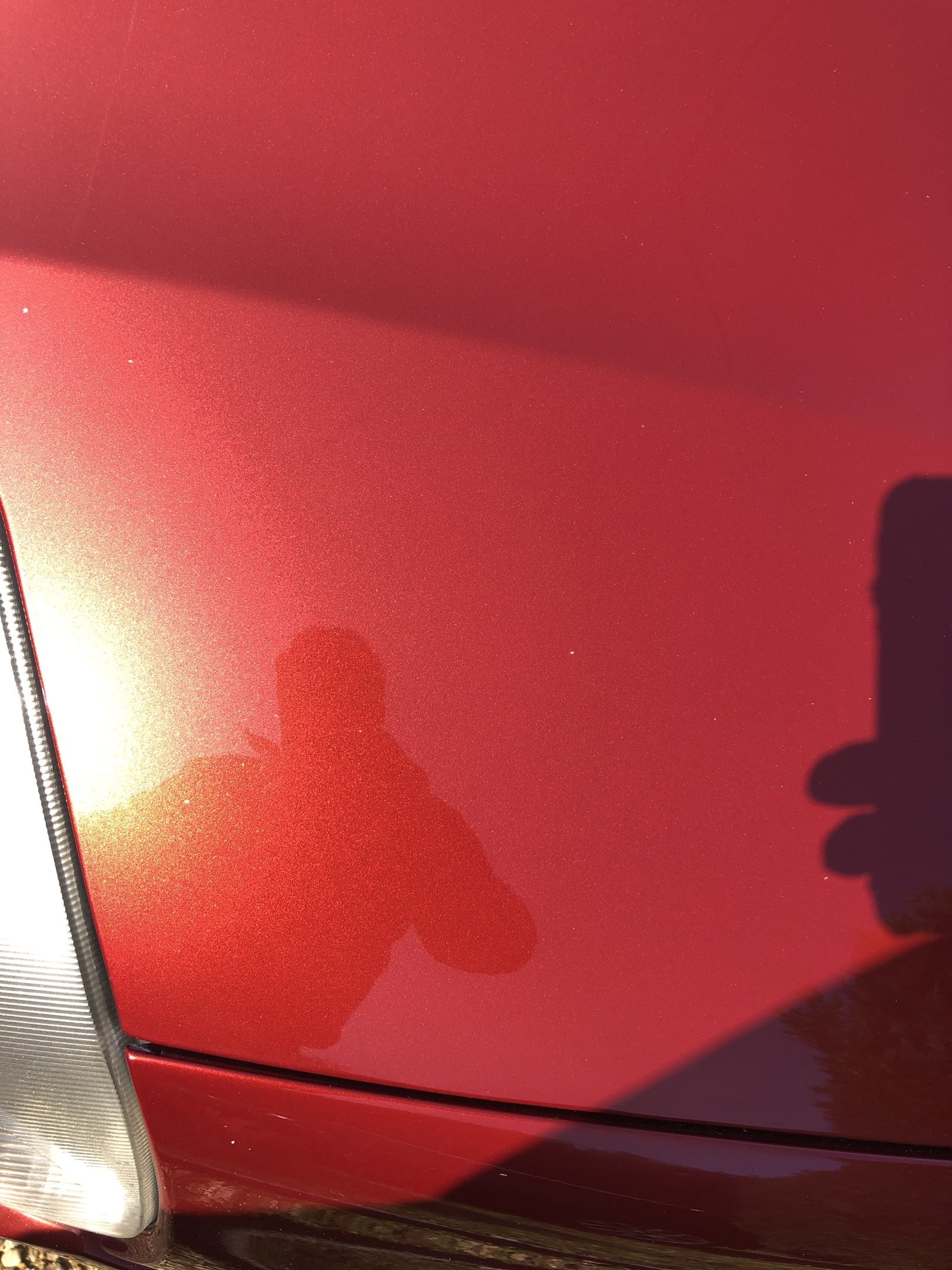

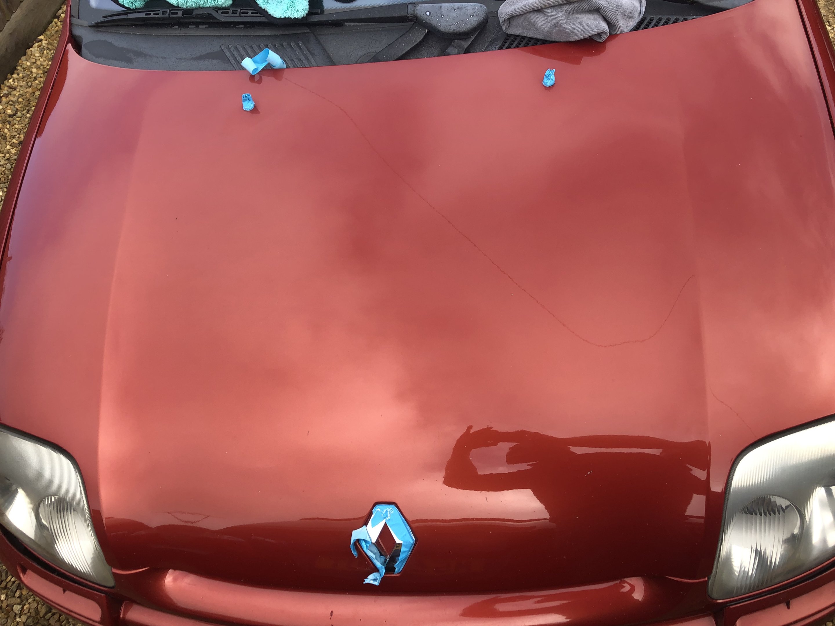

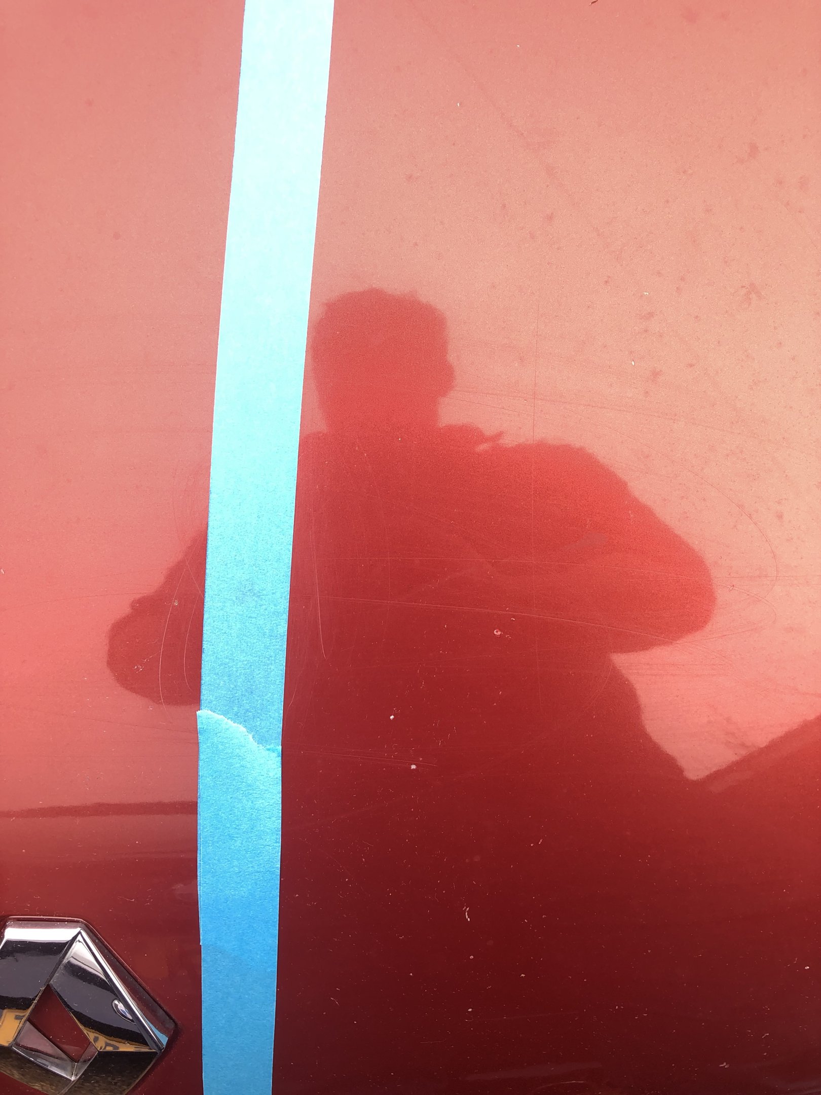

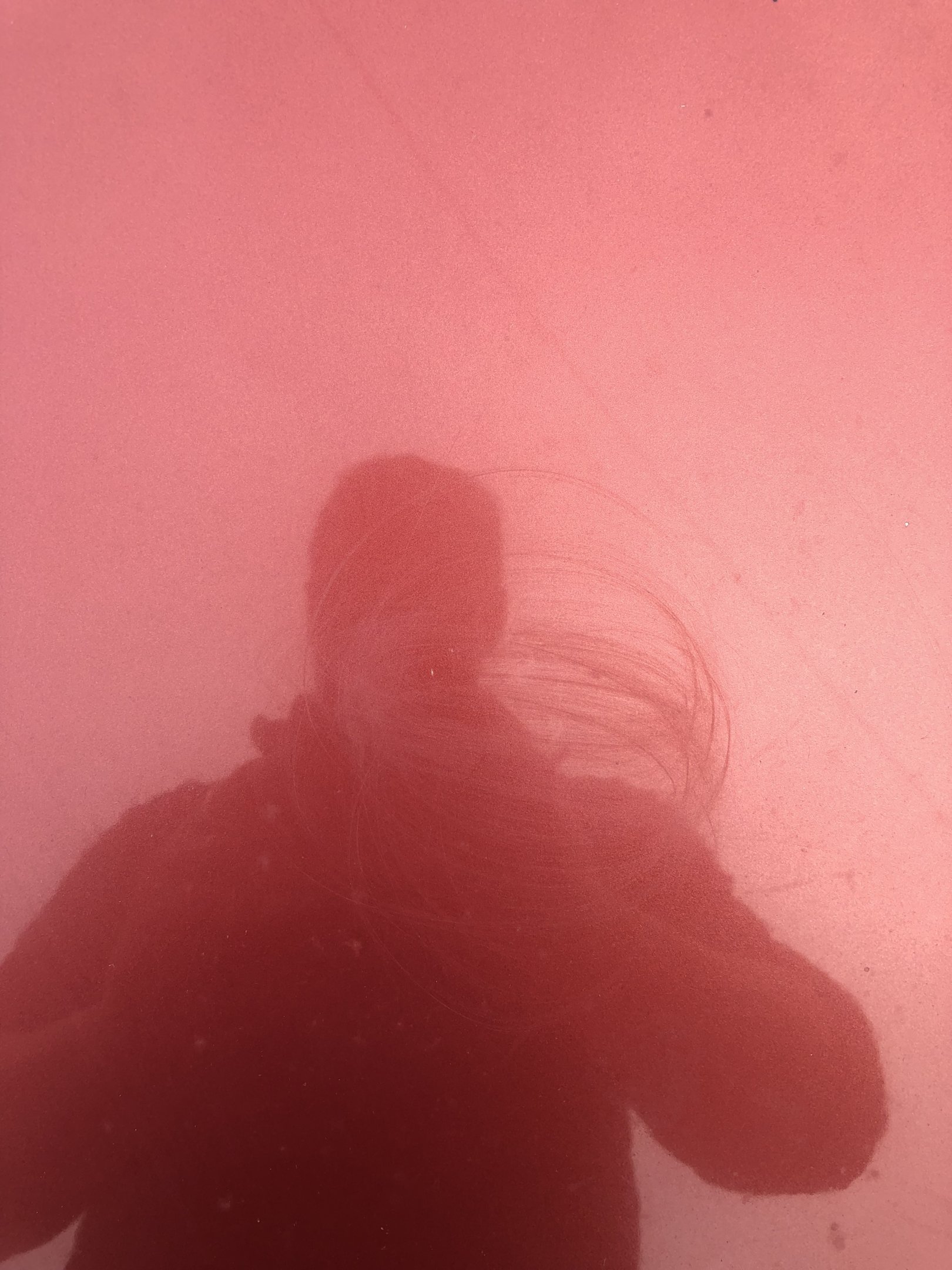

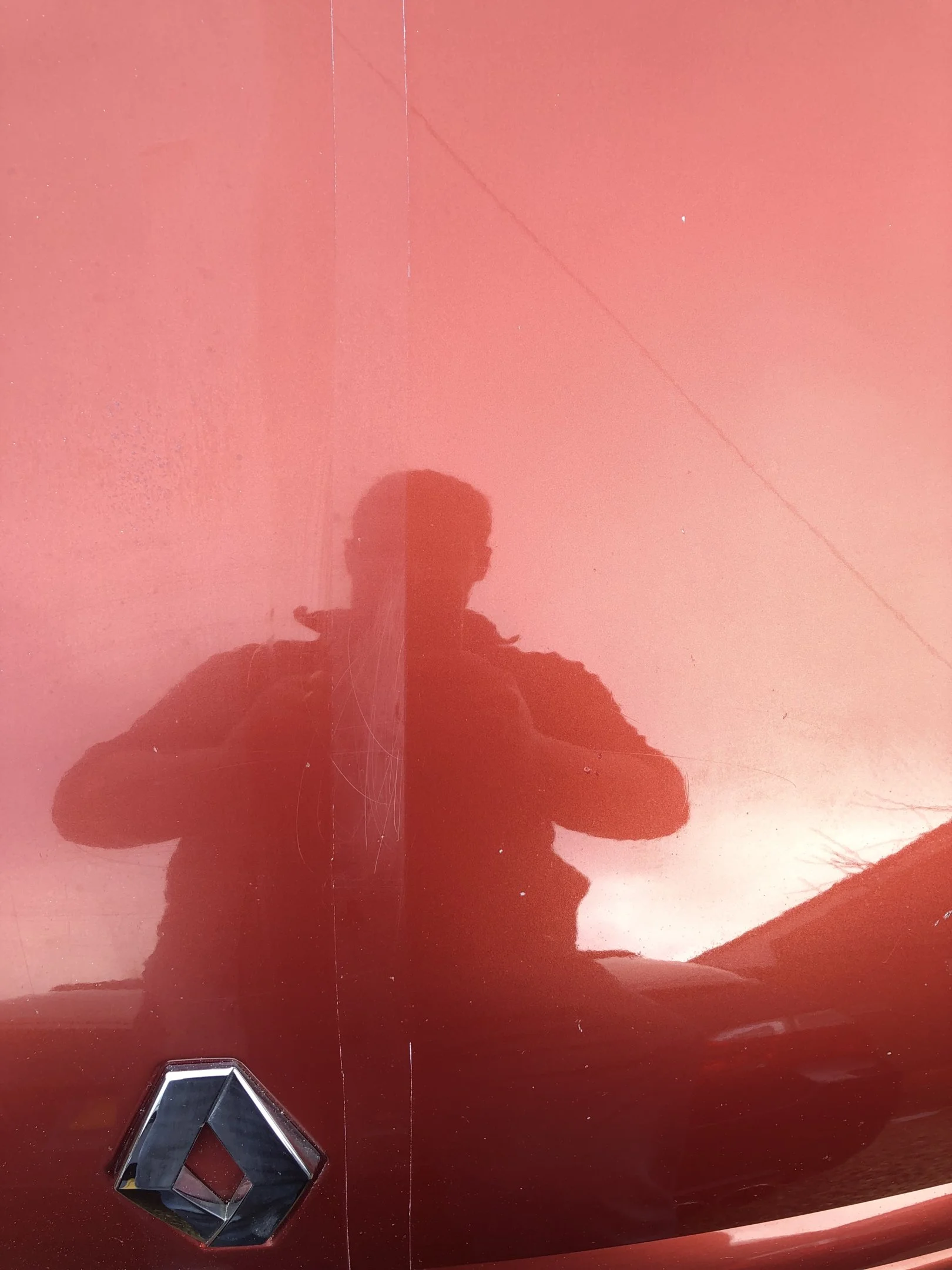

Today is a first for me so wanted to start using the DA.
I have a mixture of pads/sizes and compound to experiment with.
So just for today (sun gun not arrived yet) I practiced on the bonnet. This car is the test bed as it needs a full respray so if I f**k up doesn’t matter. I know pictures aren’t the best, by the time I get to the last car I will sort it......
So before
During
After
Happy with the result.
In the end due to severity I went with a green Orange County pad plus S3 gold compound. Topped off with a black pad and meguiars gold wax paste.
Once the sun gun arrives I will crack on with the rest.

Really nice this, one thing, run the parrot cable through the vent surely??? Or is the plug too big? It’s a bit unsightly as is!
It’s not ideal but I would have to drill through the pipework somwhere and that’s something I wanted to avoid.
