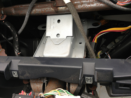

I found this on lowering the steering column..
Process is simple
Remove steering column surround, dash top and clocks
Undo 4 bolts from underneath
Use 4 new bolts and screw in from the top.
add nuts to secure then use a nut either side of the steering column mount (I also used washers) to tighten up.
Make sure its all straight.
Process is simple
Sounds easy enough.
Spot on, makes a huge difference

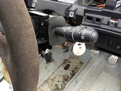

Finished work early today due to the snow, cold weather.
Dash off, and plastics around the steering wheel
[/url]
Untitled by fletcher10, on Flickr
[/url]
I removed the 4 bolts holding the steering column in place, but didn't have the right screws nuts bolts/ washers. Looks like I'll be able to get the steering wheel quite a bit lower though :)
