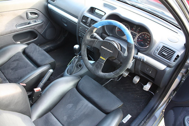

Dont know if your seat position is much lower than stock or how tall you are. But I find myself to close to the pedals if I get the steering wheel in perfect range. And now with lower seat position the steeringwheel is to high.
So I used 15mm spacers to get the steering wheel lower (you need to bend and cut some metal aswell) + 50mm snap-off to get the wheel closer = perfect
May be something to consider if you have the same problem.

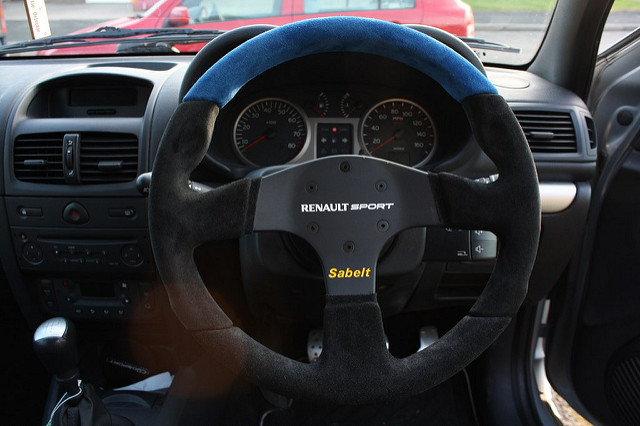

Looks very good, steering wheel looks awsome
wheel looks cracking mate, im thinking of getting rid of the 197 and going for one of these!
Thanks guys, I am really happy with it. I've had it sat in the spare room for the last 11 months, so it was nice to finally fit it!

I am 5-9/10 mate so not that tall, I also like to have my seat quite far forward so am happy with the steering wheel position ATM.
Do you do much road driving in the 182 with the Revenge seats fitted, if so how do you get on with the fixed wings come T junctions etc?

Have you sorted your horn out on the V6 with this wheel fitted yet Ali?
Im 5-8 as a reference.
My car is under a total rebuild so Ive never driven it with these seats. Guess they will complicate things a bit in everyday driving especially since you will be unable to lean forward because of the 6-point harness. But I dont mind, security on track is my priority, hardly drive it on road besides some trips to the ring :D
Oh and one more thing, If you want to fit a full cage with these seats you will need to strip the inner roof and likley the B-pillar as well. Otherwise there is no room for the tubing because of the seats.
Nah. A few lads have gone for the ph1 stalk tho with the horn on the end.
I've got a PH1 stalk already Ali.

I went for a ph1 stalk withthe horn on the end, don't need to do any re wiring just plug it in and job done :)
We /me Chris and Tim couldn't work out how to remove the existing stalk mate :S

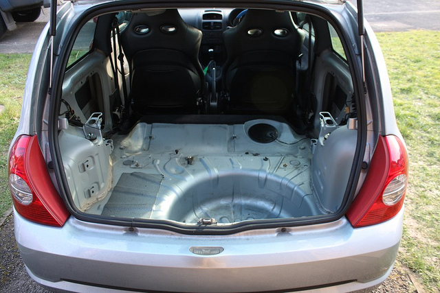

Big thanks to Chris and Tim today for helping strip the back of the clio, and fit the steering wheel :cool:
Some updated pics of the interior..
Really happy with how the car drives ATM, with the smaller steering wheel, de-cat and weight loss.
Next job get the 2118s on.
How noisy is in inside the car when strippedl like this?

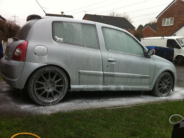

.... I had a few hours spare today, and fixed one of my Karcher PW (I now have 3 lol) so I gave the bus a quick snow foam.
Quite pleased with the rear ride height still, considering how much weight I've removed!

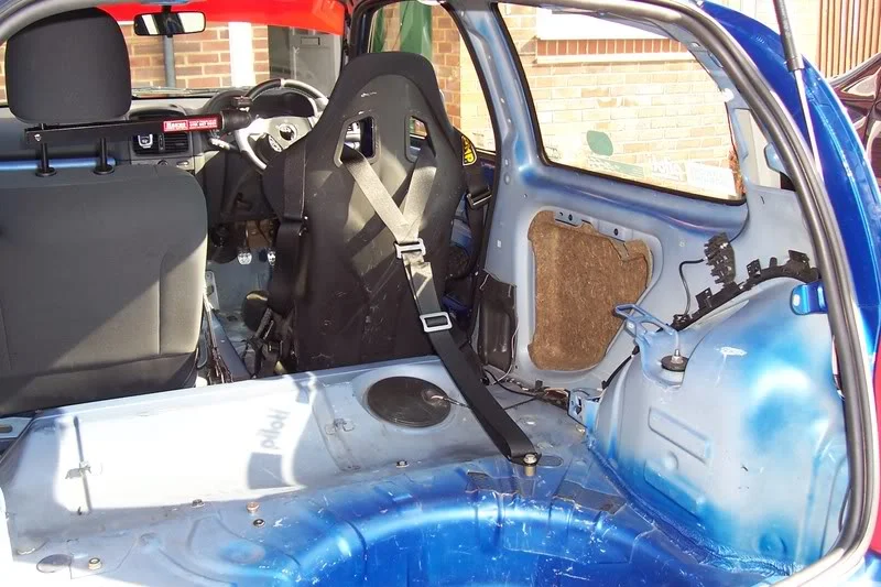

Fletch, consider putting the foam back in where you're removed the rear quarter panels.
I took mine out originally, but then realised;
a, I saved absolutely nothing weight wise
b, the tiniest knock from anything inside the car without the foam in place would dent your bodywork
May not be an issue, but mine's often loaded up with wheels, tyres, jacks, tool boxes etc so back in it went...
