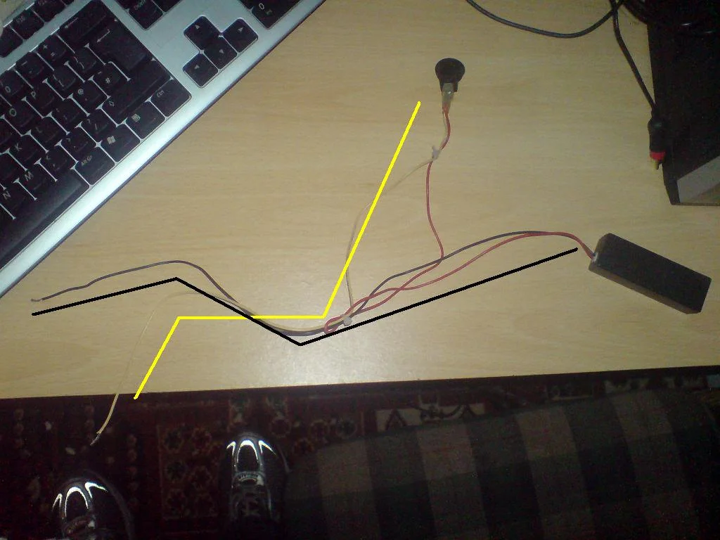

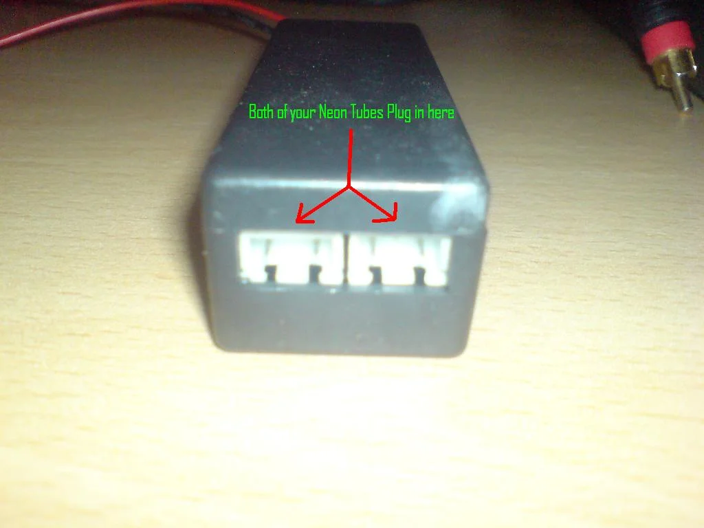

heres how i did it (very basic)
1) the only 2 end wires you need are the yellow wire from the switch and the black one from the black inverter box.
2) now all you have to do is wire the yellow wire from the switch to any 12v power source, and wire the black wire to and suitable ground (e.g a bare metal area) i used the 12v lighter socket from my undercar neons
AND NO YOU DONT NEED RESISTORS
here are some useful pictures
Many Regards
Nathan
PS and no i dont have anything like this on my clio, i did it to my puma
