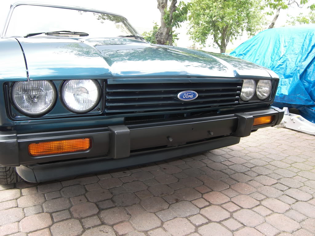

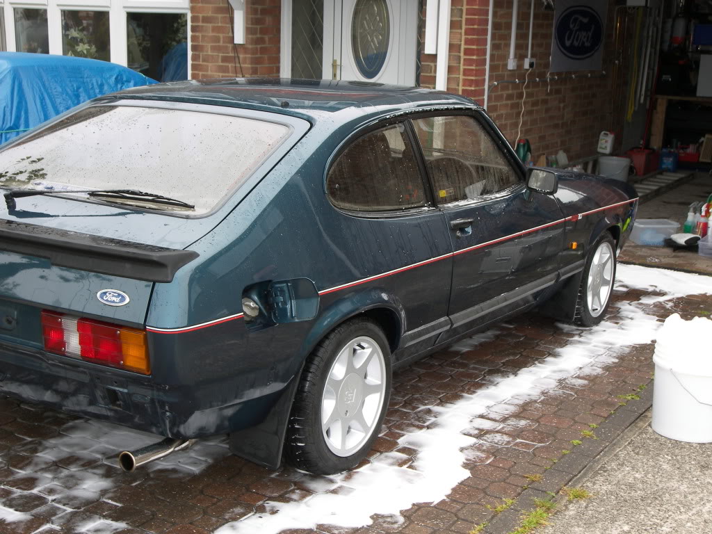

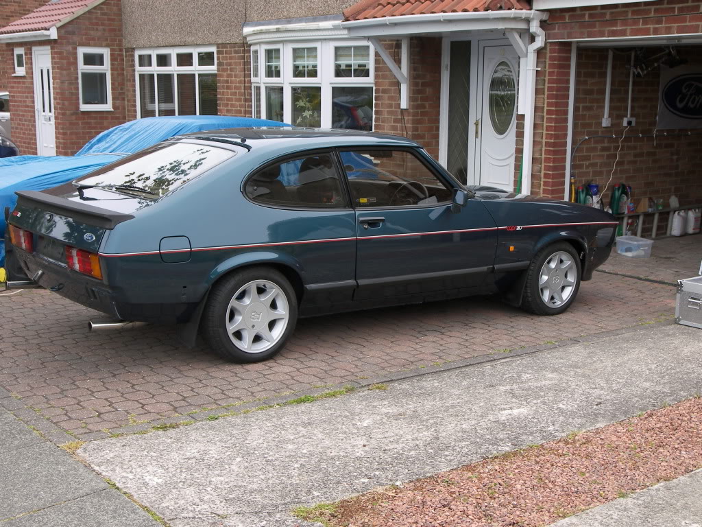

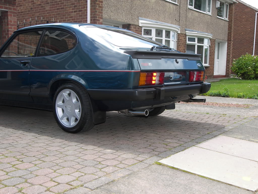

The car before I start

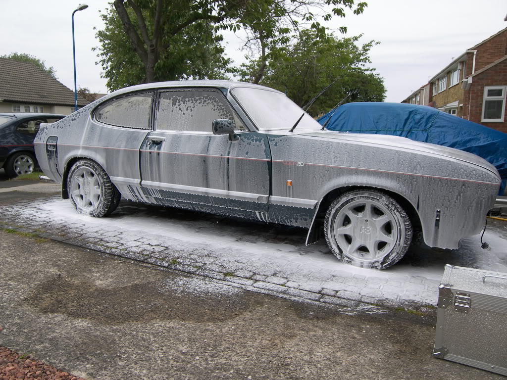

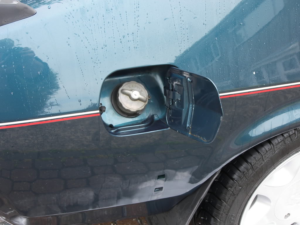

I started by giving the car blast off with the pressure washer as it only really had light covering of dust on it, the car was then snowfoamed using a mix of megs hyper wash and snowfoam .Whilst this did its stuff the inside of the petrol flap and trims were cleaned using a soft brush and I cleaned the wheels using the bilberry wheel cleaner and various wheel brushes, these alloys are in very good condition with only a slight mark on the rim of 1 wheel.
This was then blasted off with the pressure washer, and then the car was given another coat of the same mix snowfoam and washed using Meg’s hyper wash and the 2 bucket method and a wash mitt before being power rinsed off and dried. The lower parts of the car and inner arch lips where sprayed with Tardis which was left to do its stuff before being wiped down with a microfibre cloth

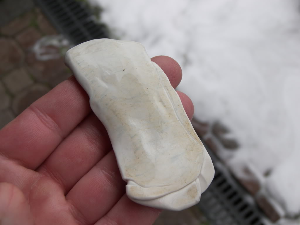

The car was then rinsed off using a open ended hose and left wet before claying using citrus bling and water mix( 4 to 1) clay bar which didn’t really pull much from the paint work except some slight tree sap from the roof it was then rewashed using the same method and dried using a Uber microfiber drying towel.

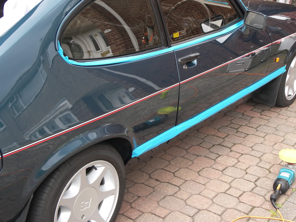

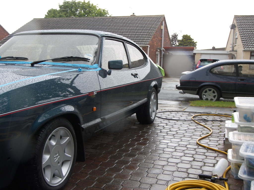

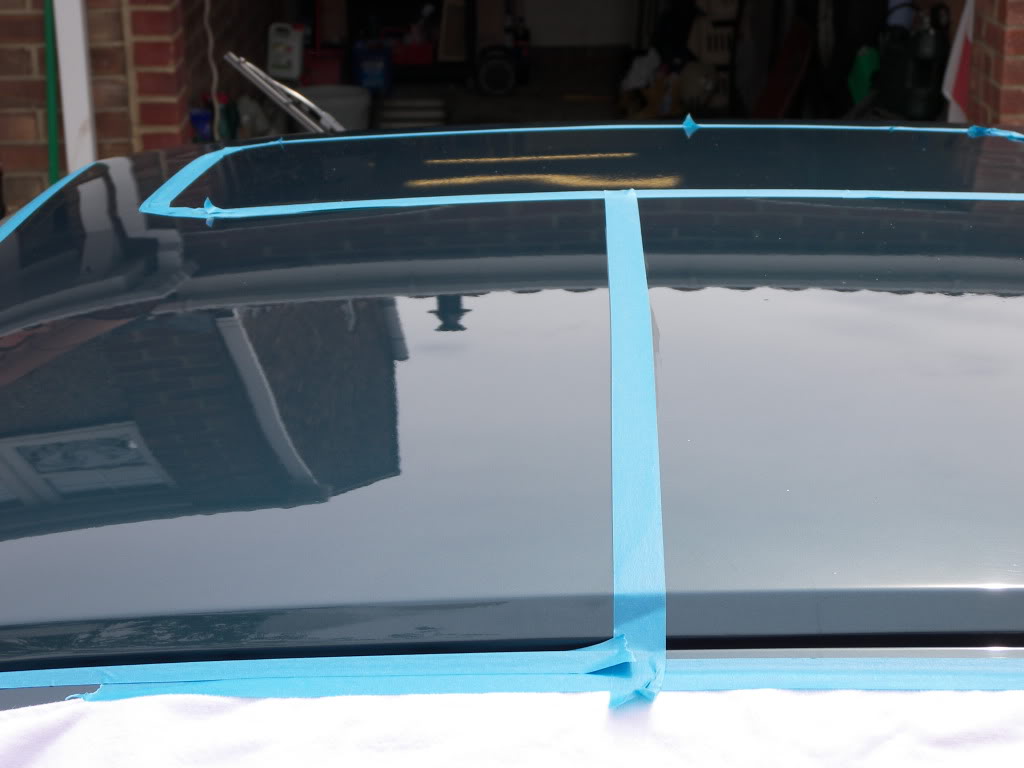

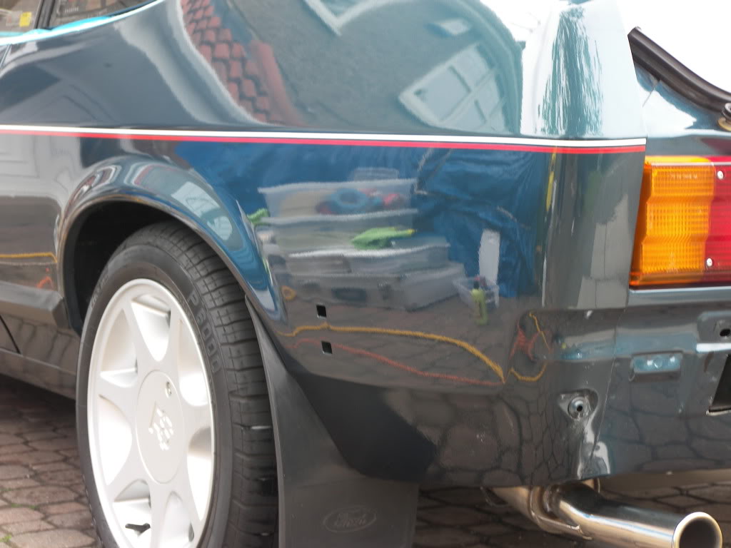

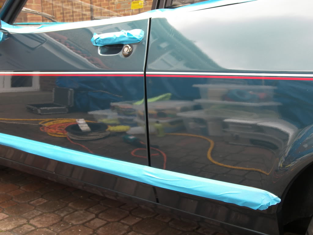

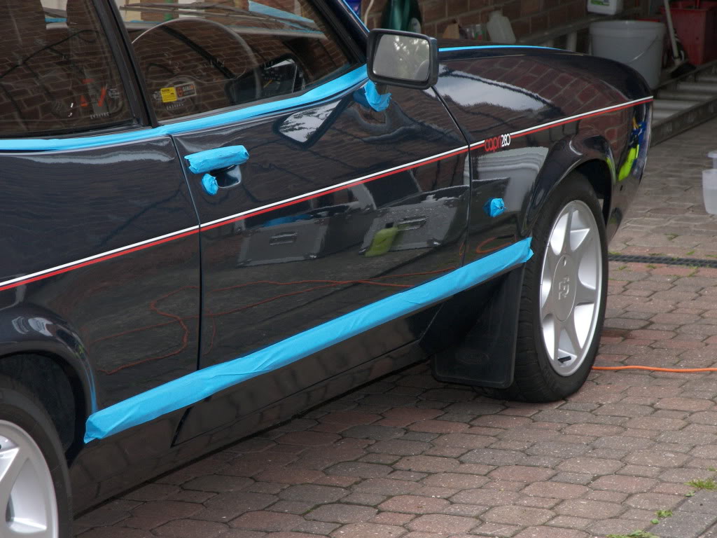

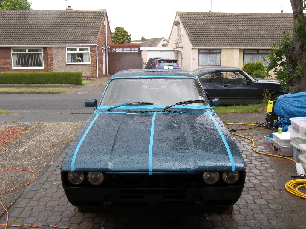

Car was then taped up using 3m masking tape, a couple of quick 50/50 using the lime prime and 3m yellow polishing pads before getting on with the rest car.

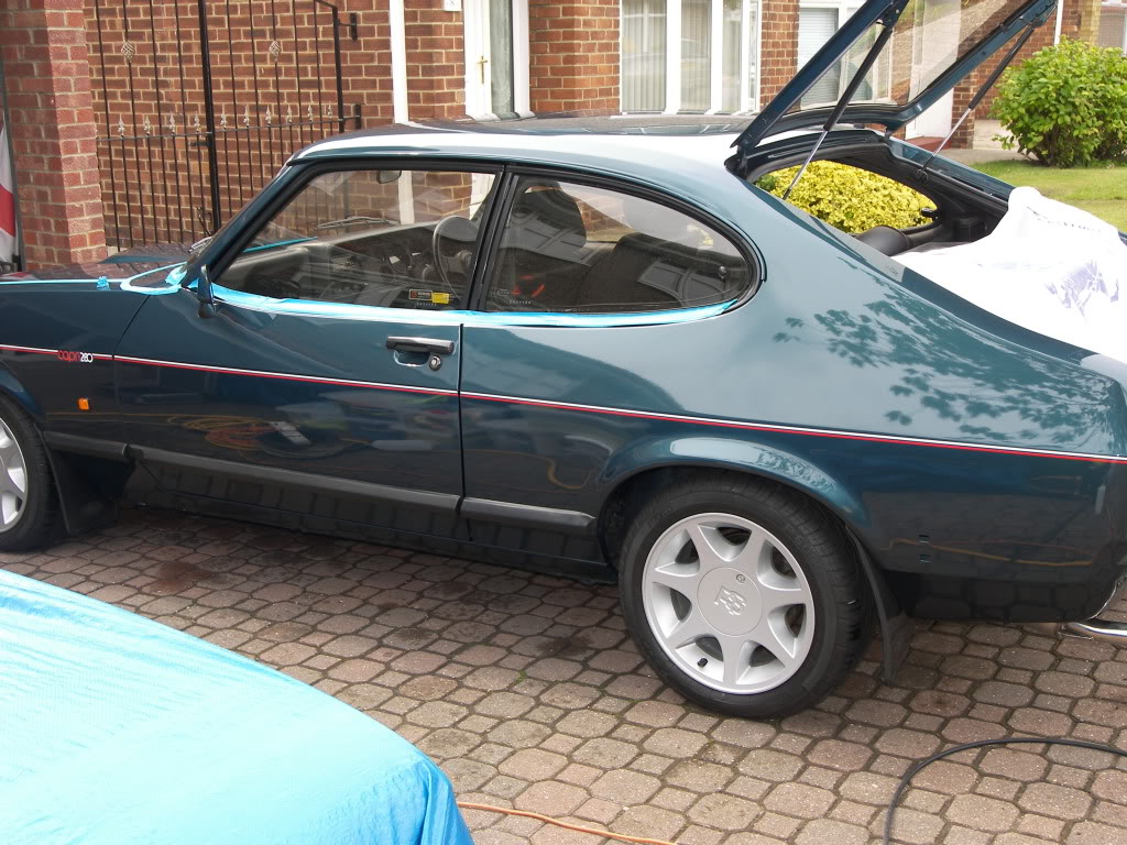

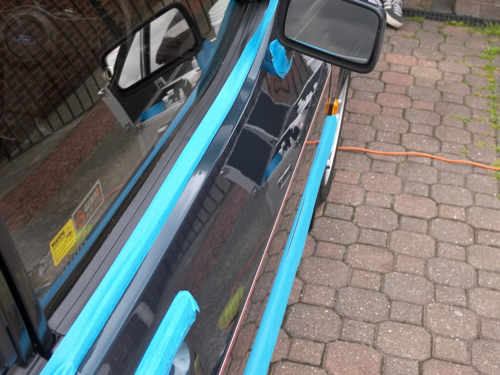

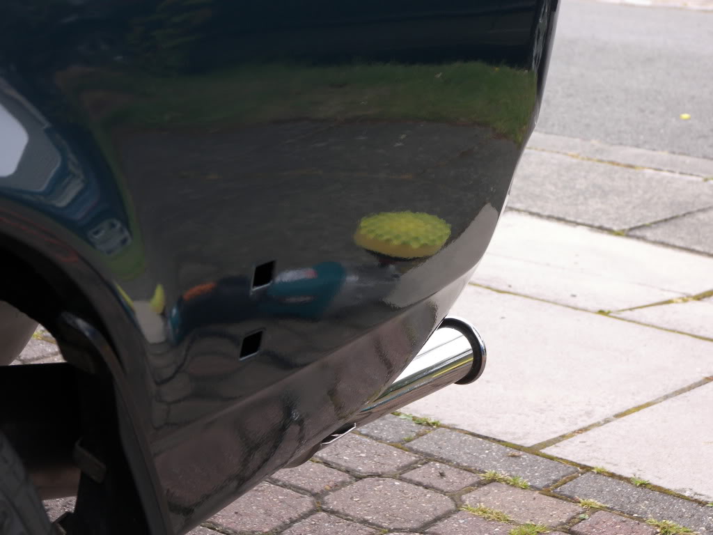

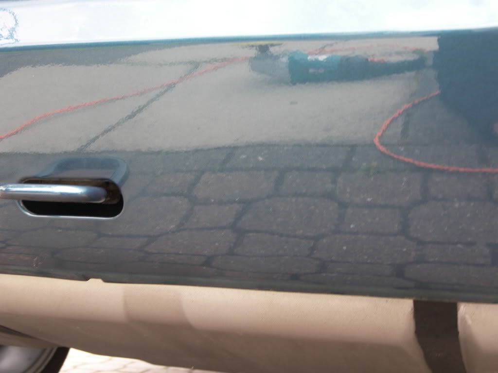

Then started to work my way round the rest of the car, drivers side

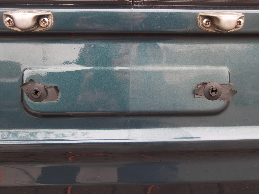

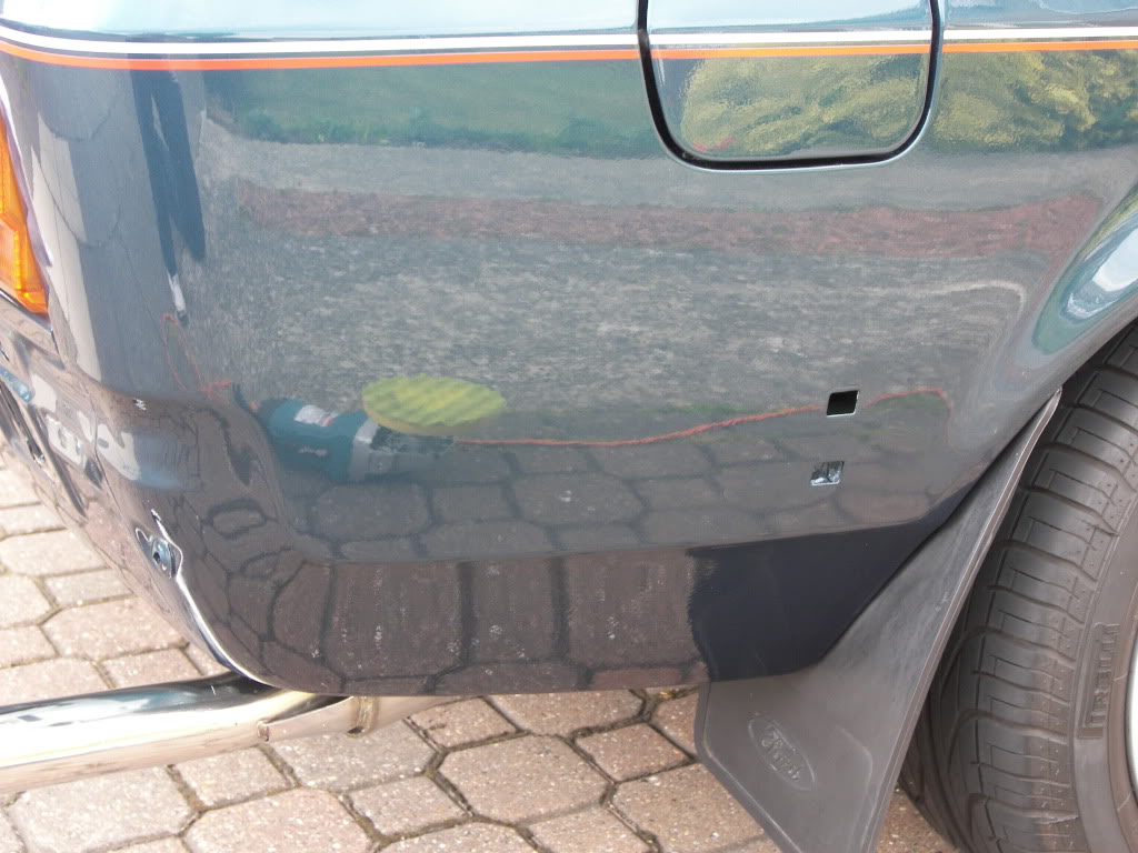

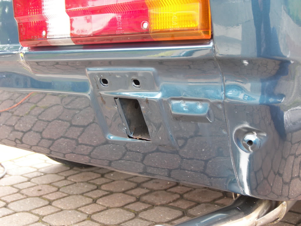

50/50 0n the number plate recess

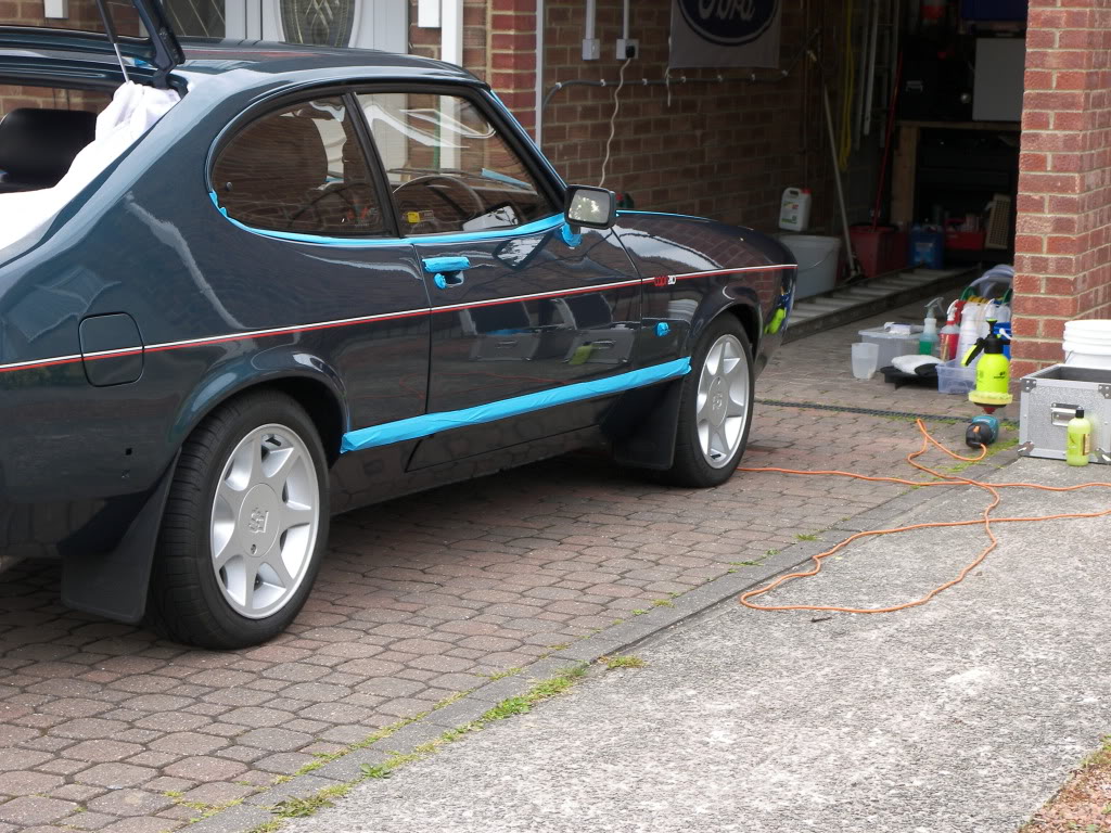

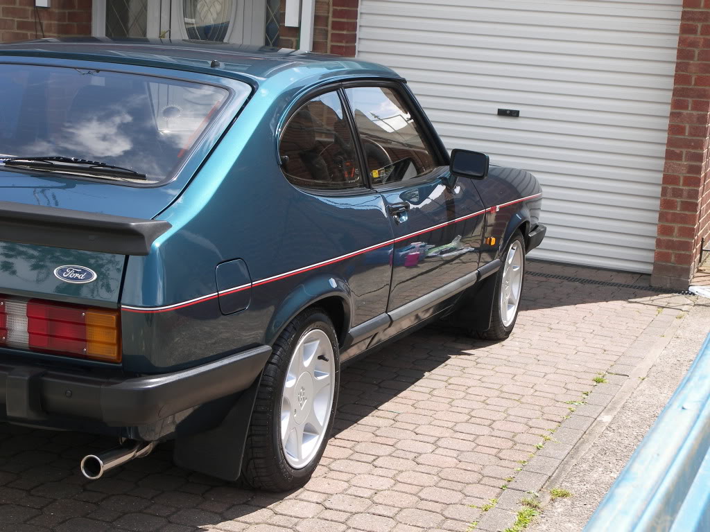

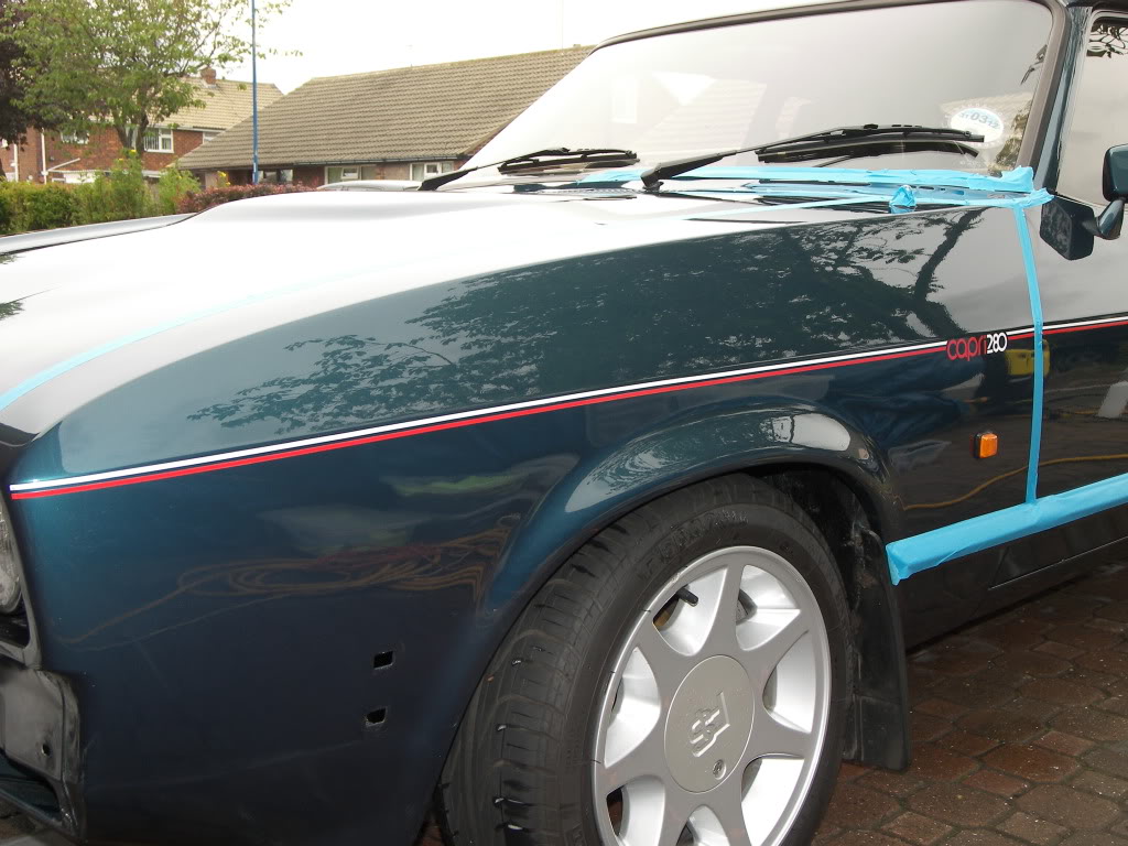

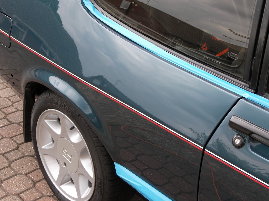

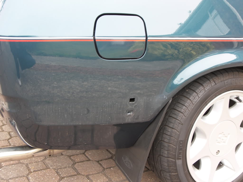

Then started to work my way round the passenger side

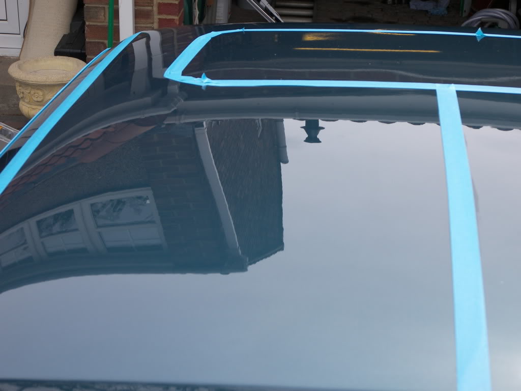

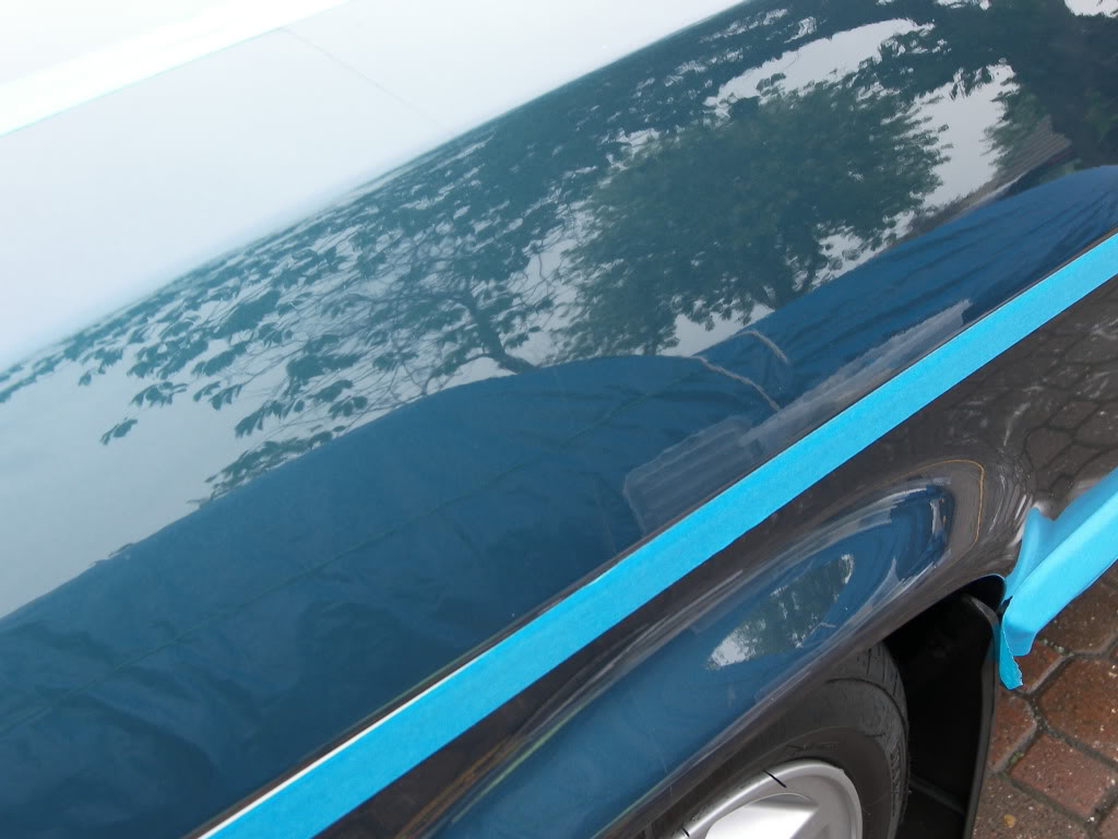

50/50 on the roof

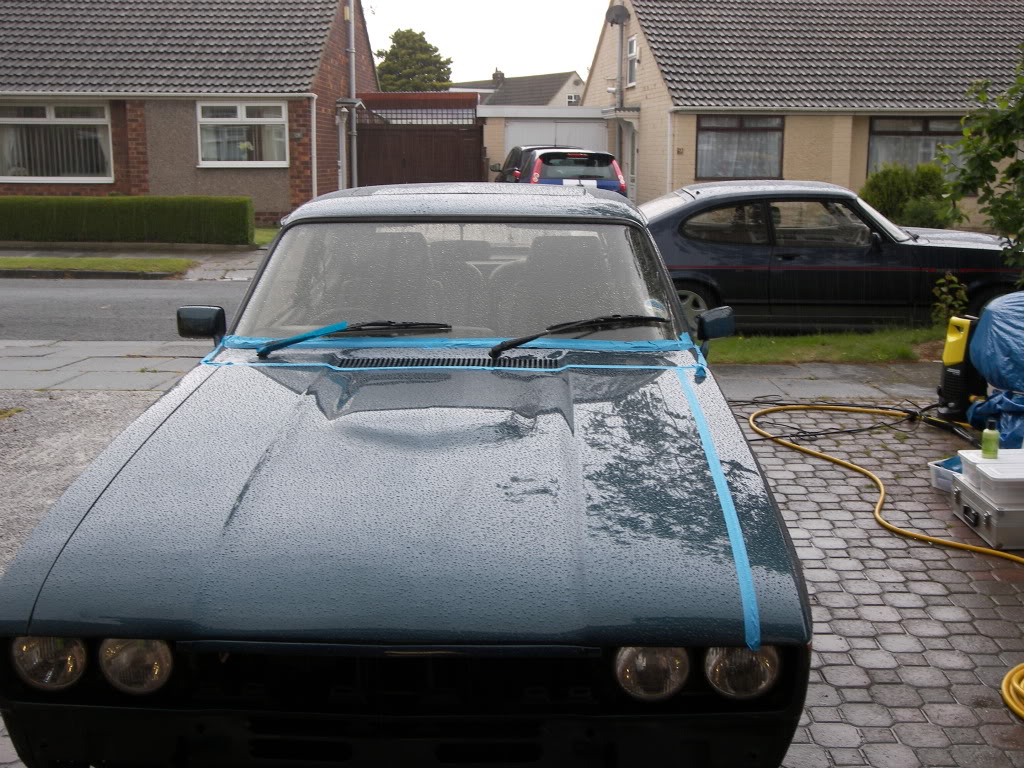

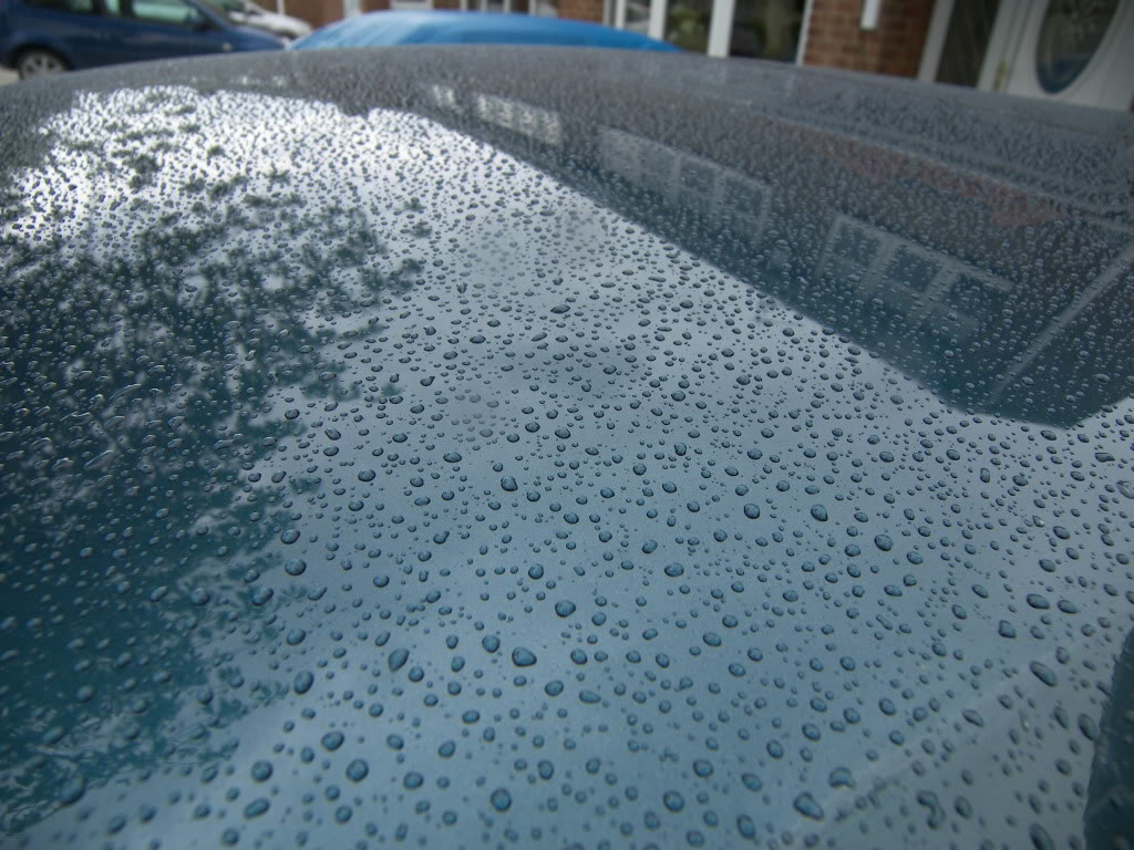

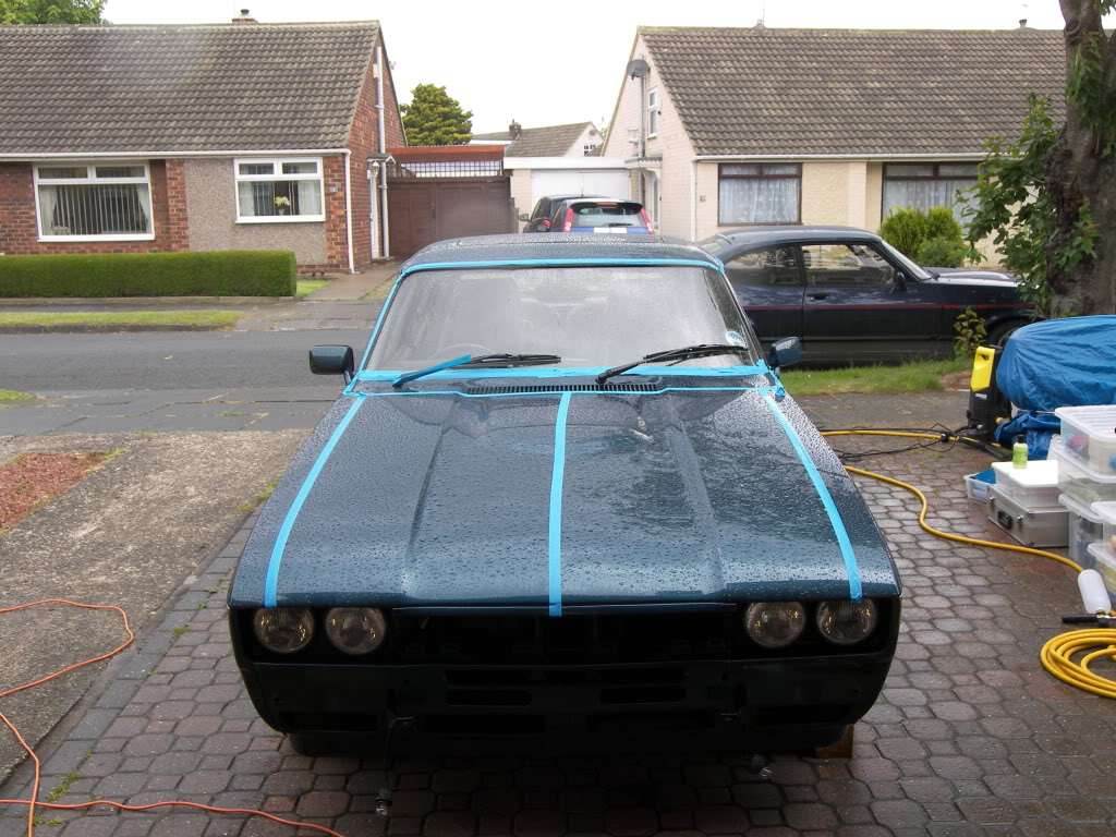

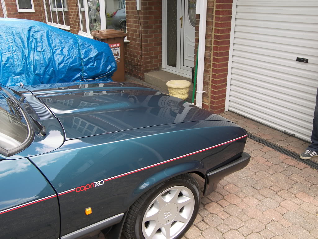

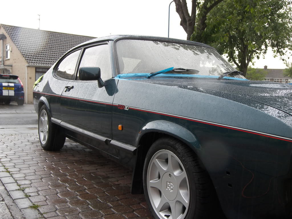

Attempted 50/50 on the bonnet but decided to rain instead
So got some beading shots
Full bonnet

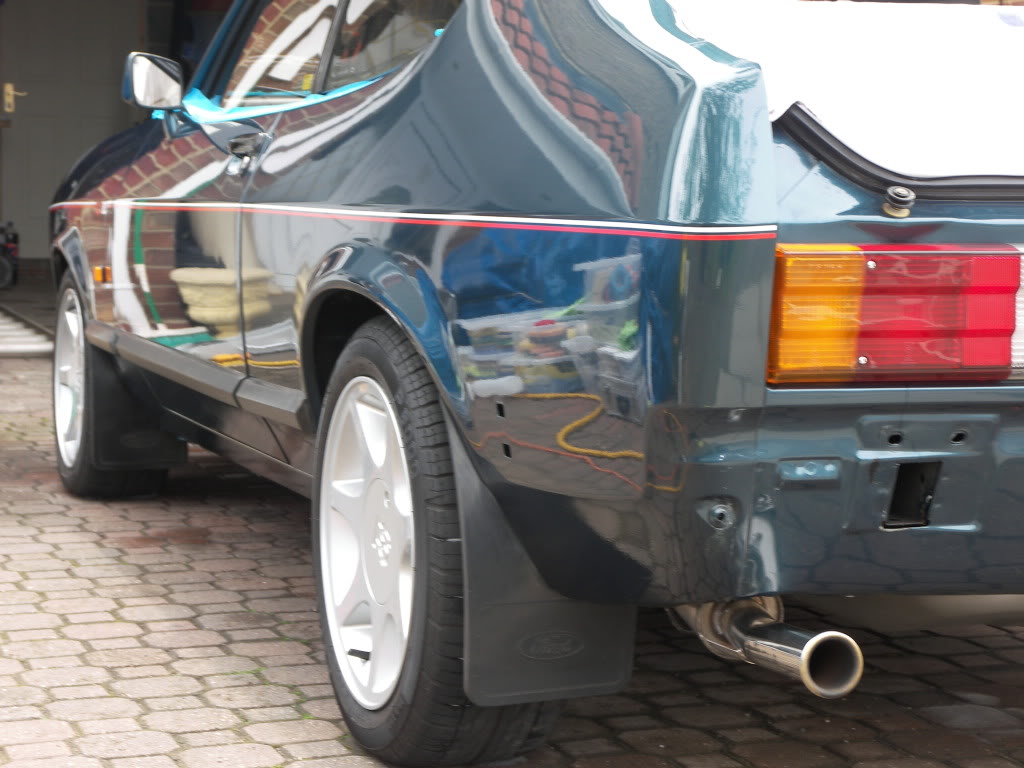

After polishing my way round the car with the rotary, I applied the Dodo supernatural hydrid wax/sealant using a german applicator pad and left to cure before buffing using poorboys microfibre clothes.

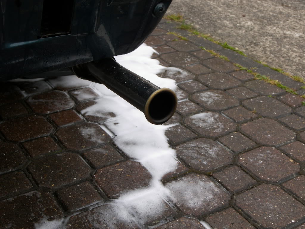

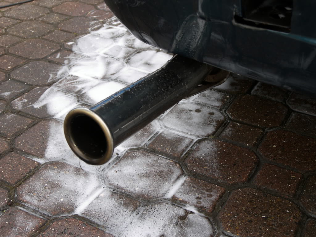

Exhaust was polished up using Autosol and 00 grade wire wool and general microfibers.
Before
After

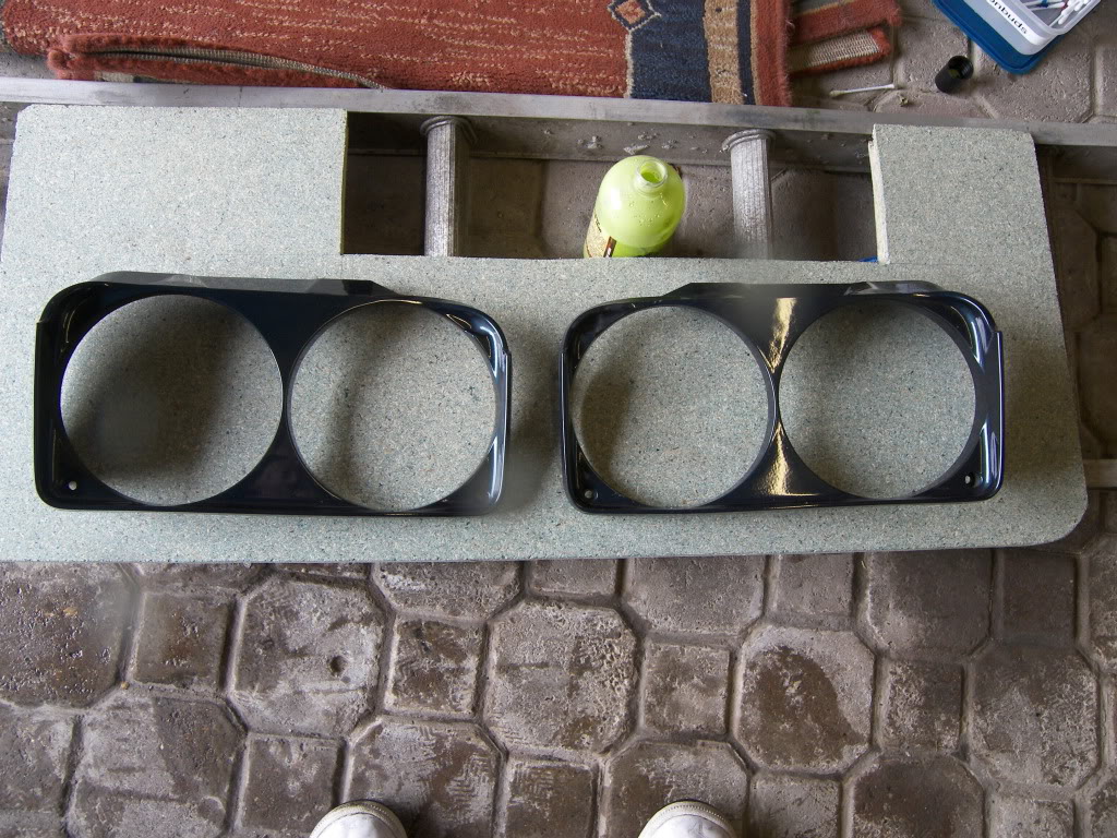

And hand polished the light surrounds using limeprime and a german applicator pad

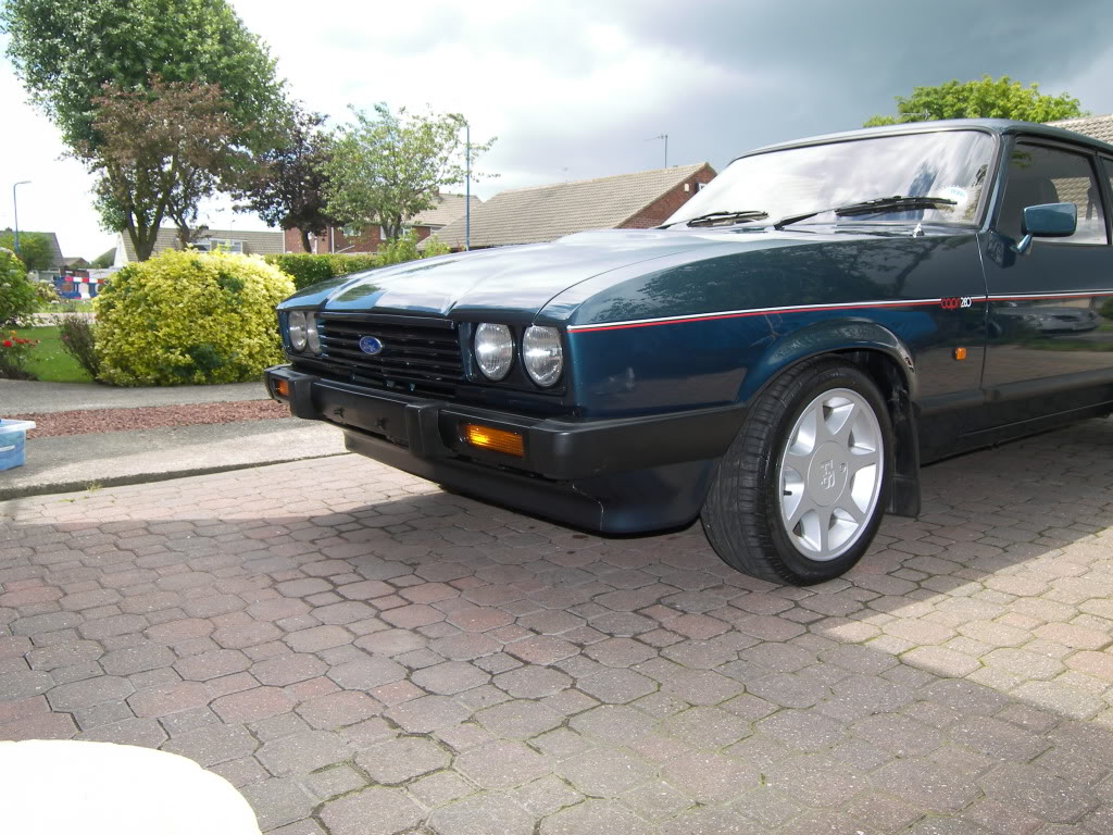

The car was then given a final wipe down using Finishkare 425, and the glass was cleaned using neat citrus bling and the wheels were given 2 coats of Jetseal 109 and the tyres giving a coat of Valet pro tyre dressing.The car was then tucked back up into the garage whilst Andy repainted the bumpers

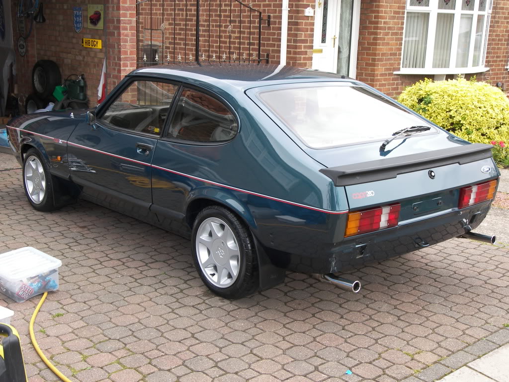

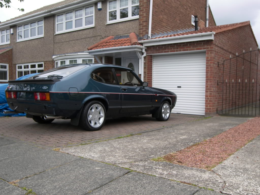

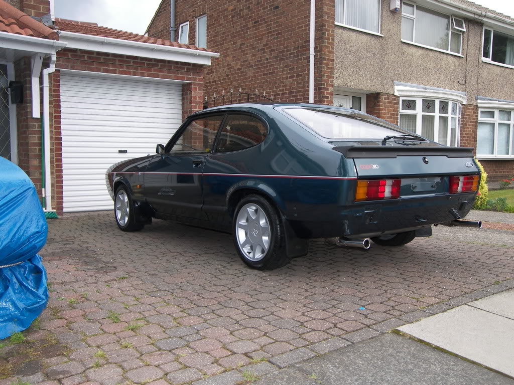

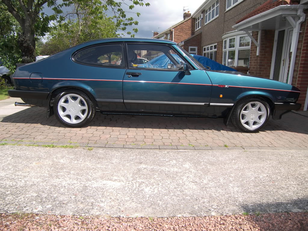

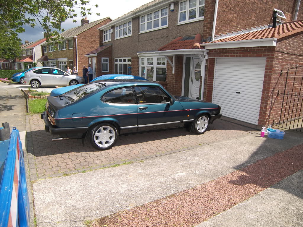

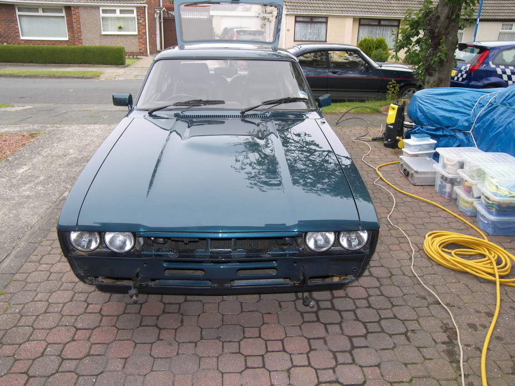

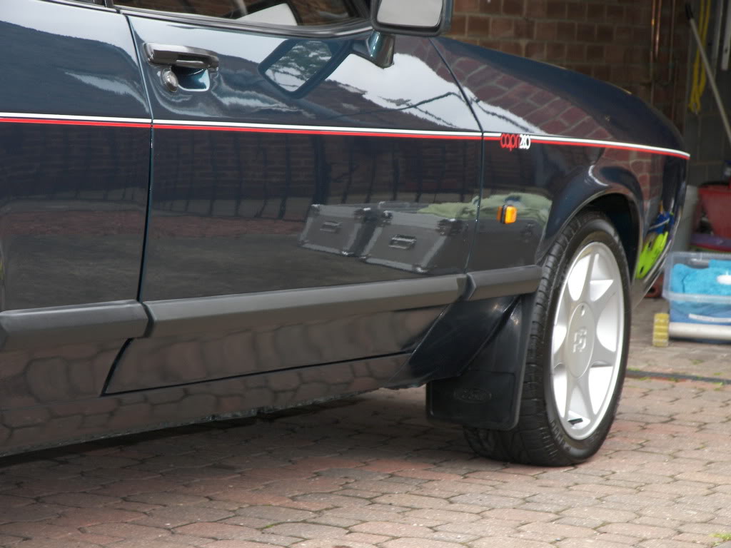

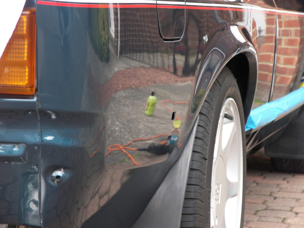

Due to the weather it was nearly 2 weeks before I could get some finished shots.
