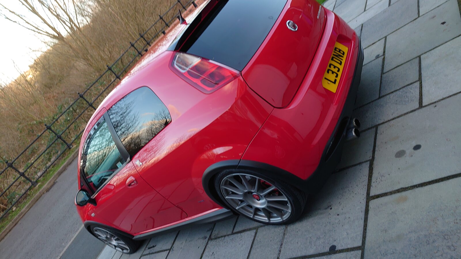

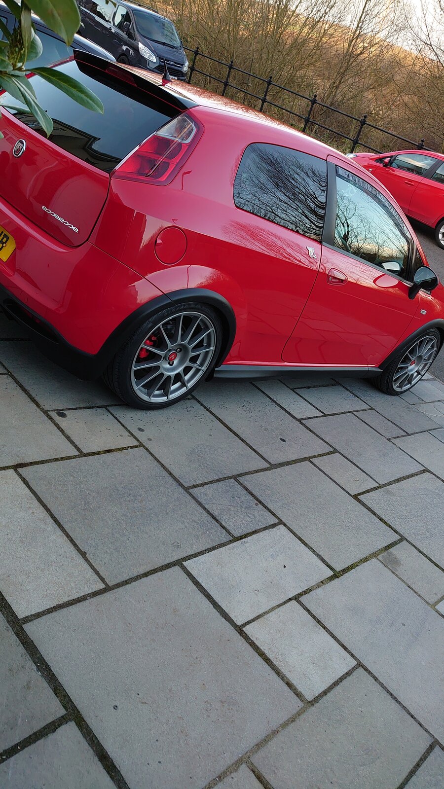

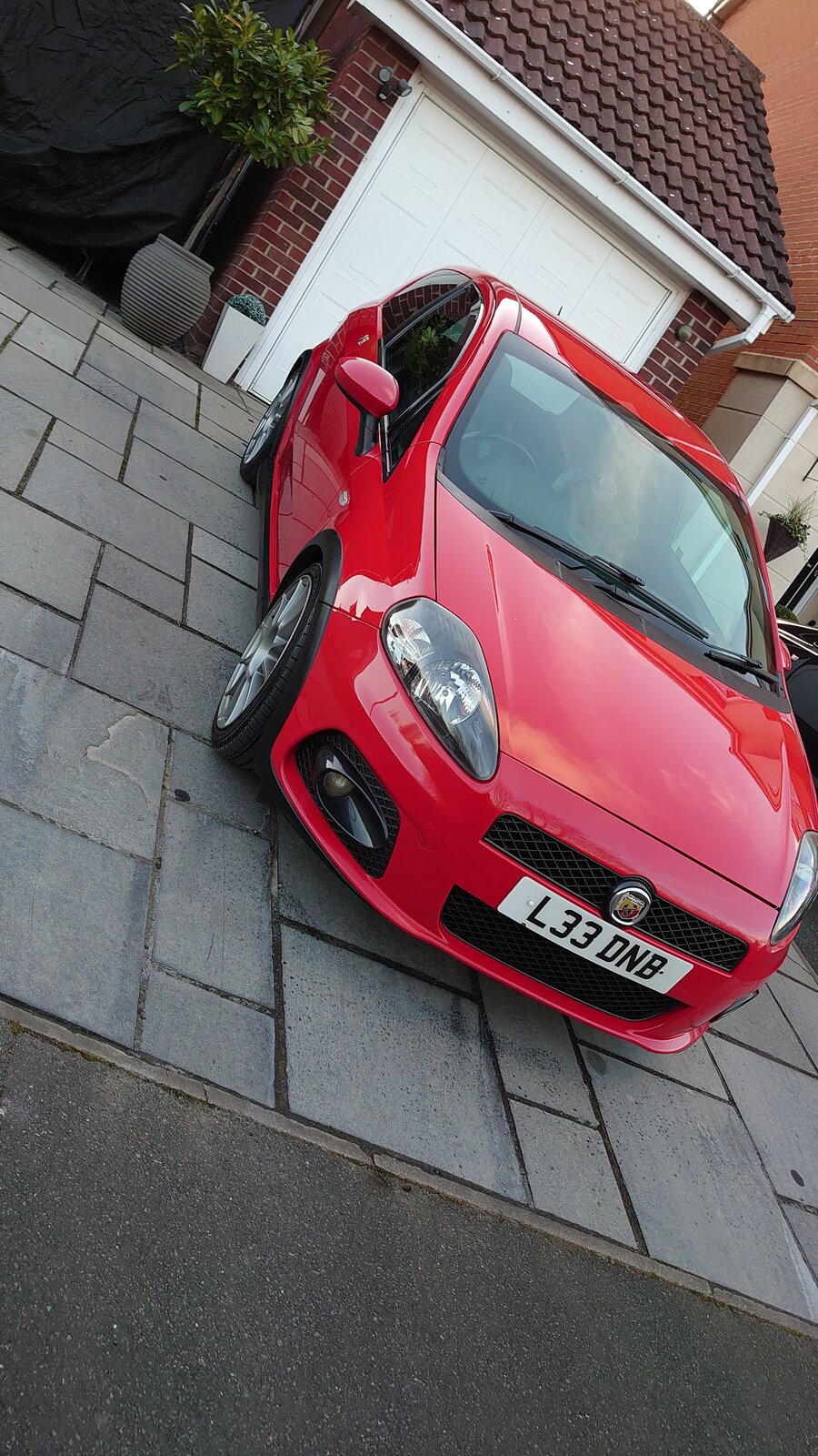

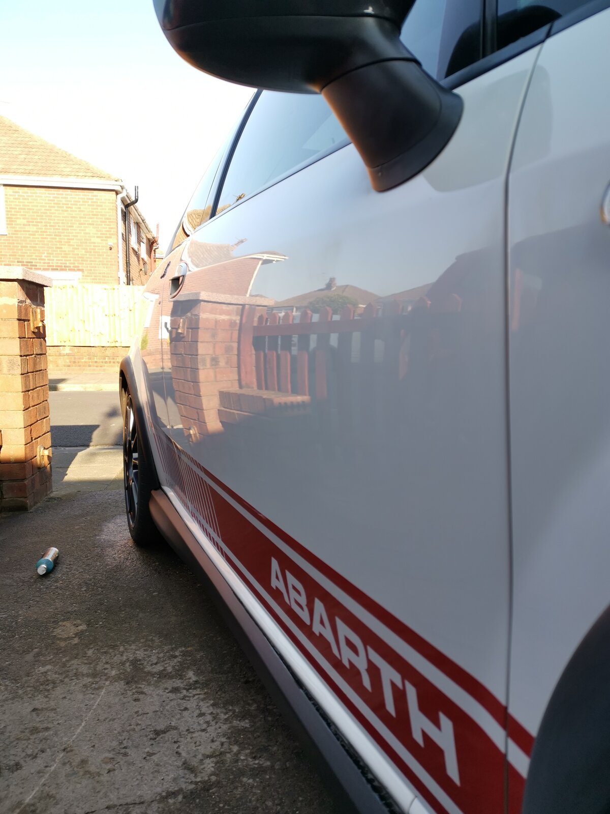

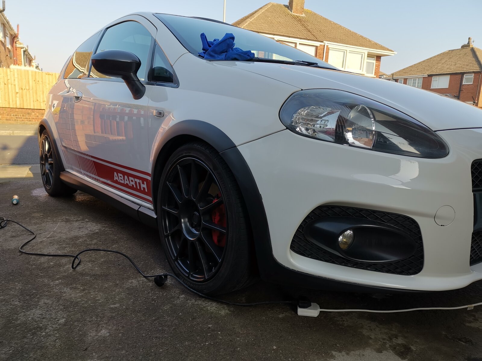

Evening all,
Had a chance today to finially detail the abarth. The intention was to do a full correctional machine polish however time isn't on my side so decided to try Autobrite renew one step enhancement polish.
The car was first washed, decontaminated and clayed. I used a rotary buffer and a medium density pad followed by Autobrite ultraslick sealant.
Shame I didn't take any before shots as there is a noticeable difference, didn't really expect much from a one step polish that cost £4 but it's actually quite impressive. Reduced the heavier swirling and gave the paint a nice wet look. Upon looking at the paint under a strong light there is still swirling and a slight hazing from the buffer but you cant expect the world I suppose.

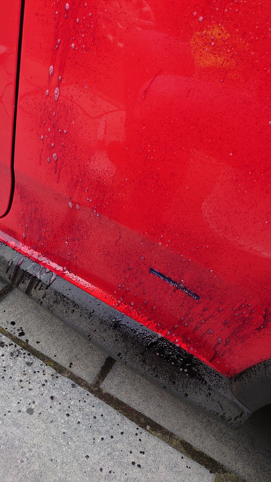

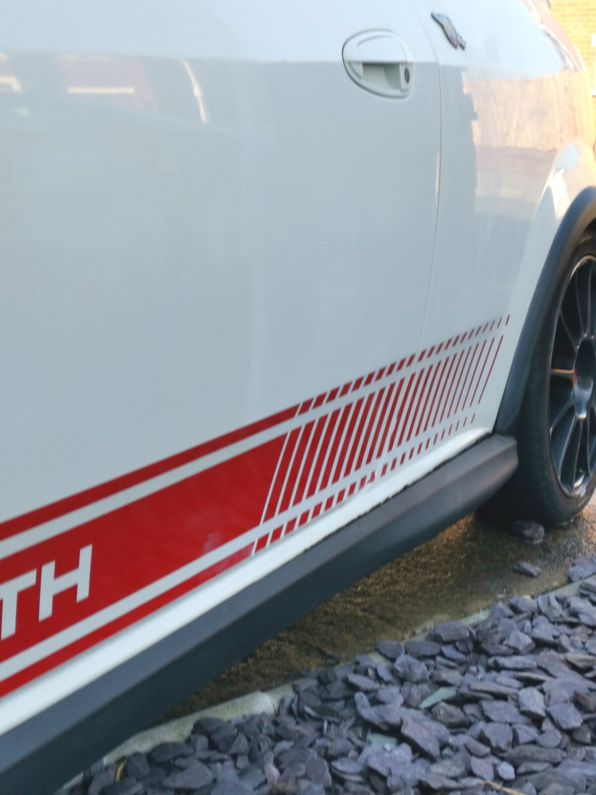

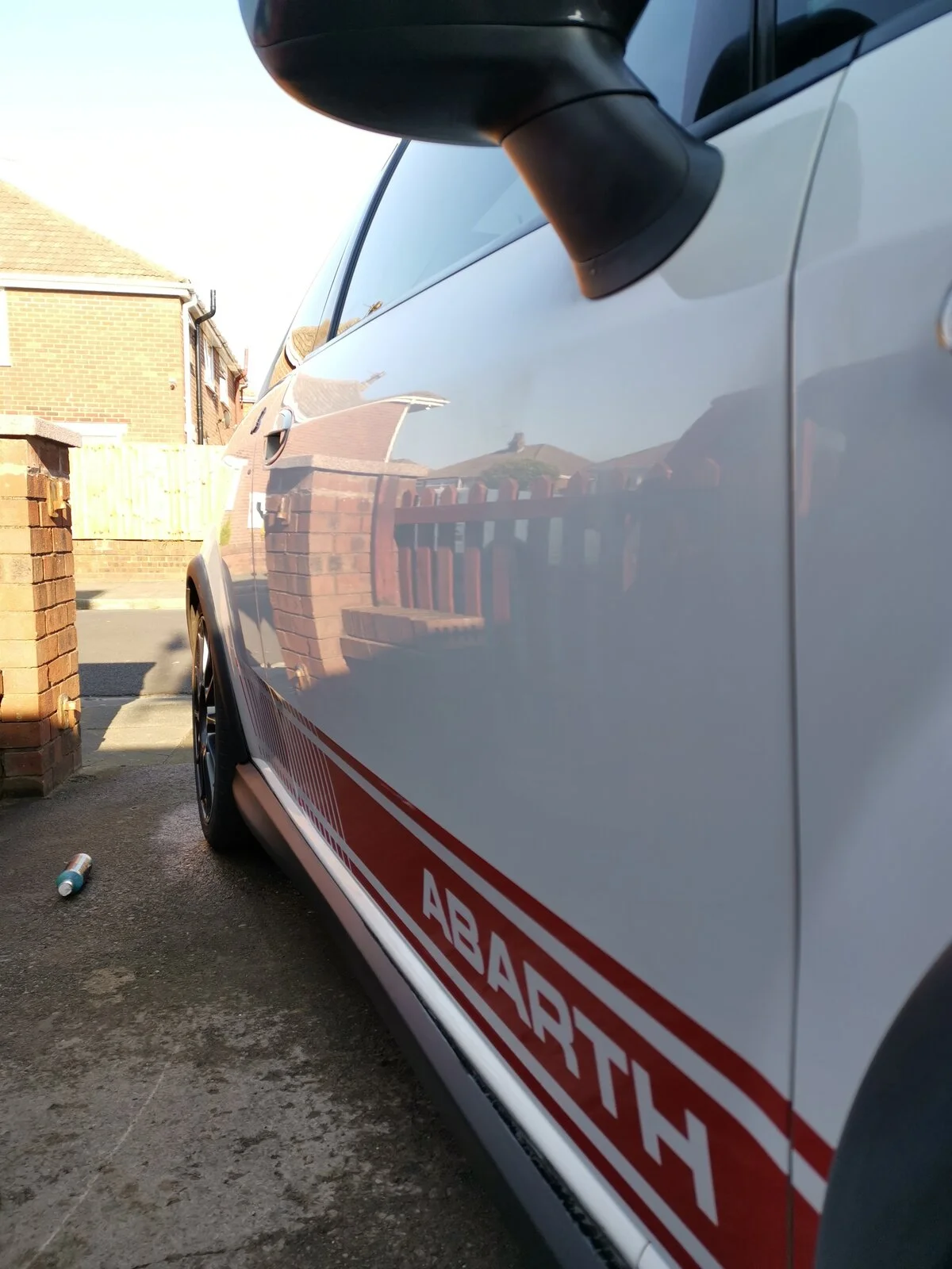

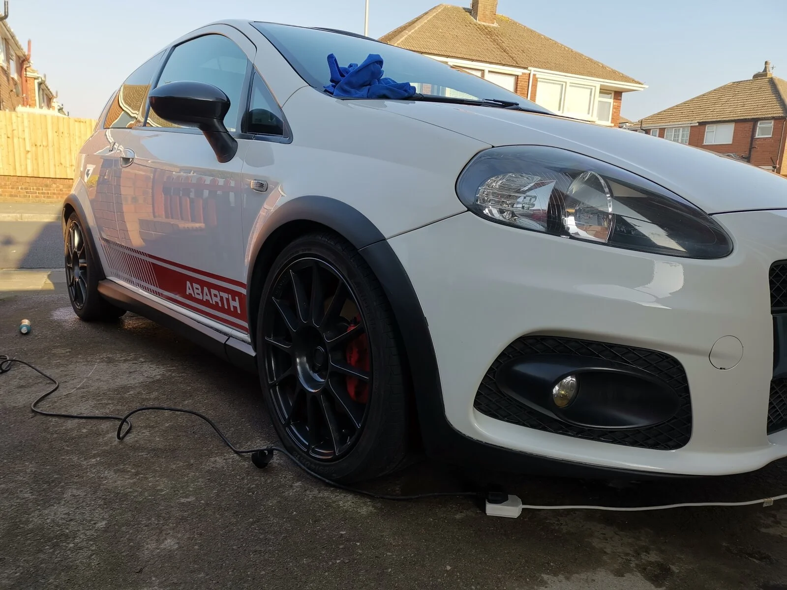

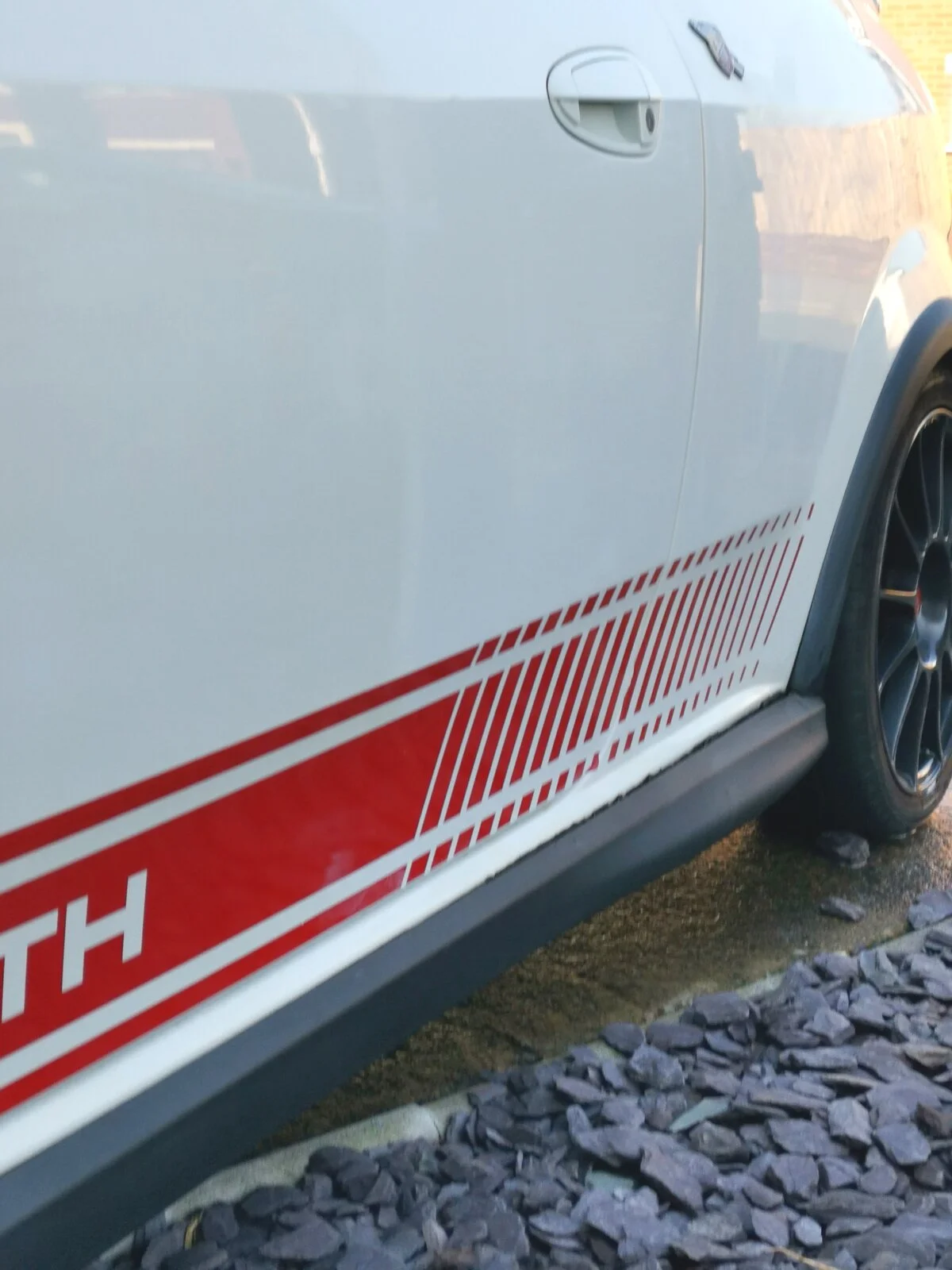

That looks like a lovely example, I've been sorting out ours the last couple of days too, it was more of a cream colour than white to start with, did you find the boot covered in tar and iron fillings? Seems to be a hot spot, not sure where ours was kept previously but I had to do multiple hits of iron remover over the doors and boot, it was terrible!

Bootlid and the bottoms of the rear arches were caked on mine, in all honesty though the entire car was coated. Took a heavy coating and some agitation with autofinesse iron out to get it somewhat presentable and a good going over with clay to get it back to a smooth tar free finish. Only problem I'm now left with is some hazing from the polish that I haven't noticed until we have had these last few sunny days
