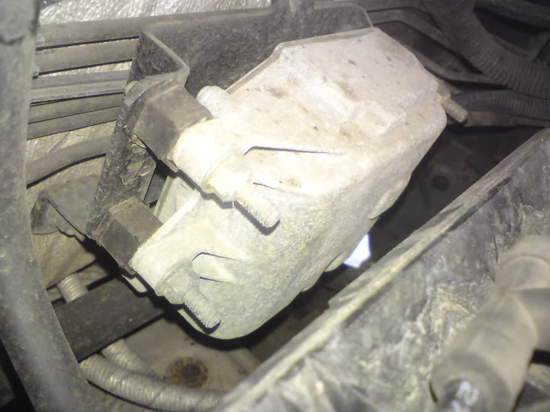

My other halfs 52 plate Focus ST170 has just started making a really funny noise, the easiest way i can explain it, is its a slow rotation noise and from inside the car it sounds like a plunger sucking off something over and over :S
Iv traced the noise to this box that bolts to the bulkhead, it has a few pipes coming off it and an electrical plug.
Anyone have a clue what it is?
Deffo come from there? I've heard of this noise coming from the airbox on them (i joined a forum when i was thinking of buying one years ago)
Quicky search has come up with IMRC module? Maybe have a google for that, apprently a common issue. (I may have been searching for the wrong thing though)
jusr searched, your spot on, cheers mate! Will chase the cabe round, if thats not the problem il replace the IMRC
