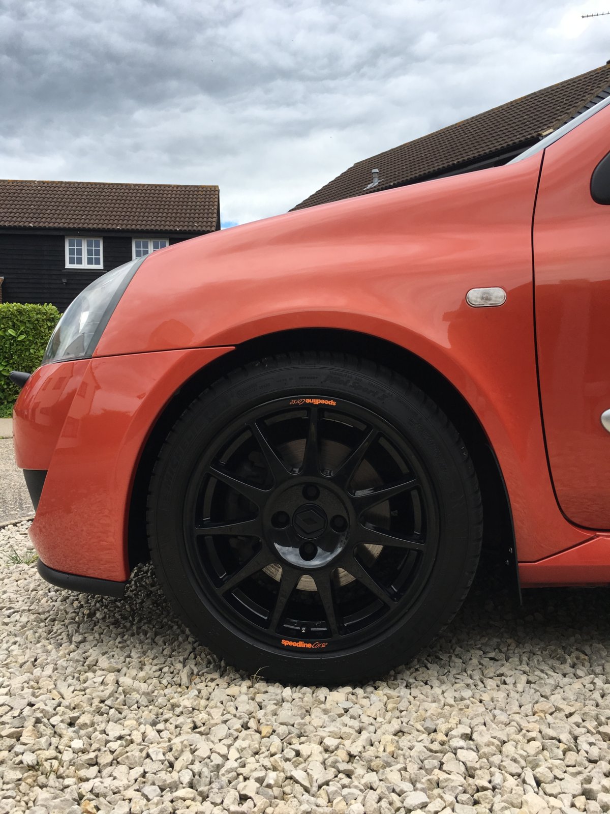

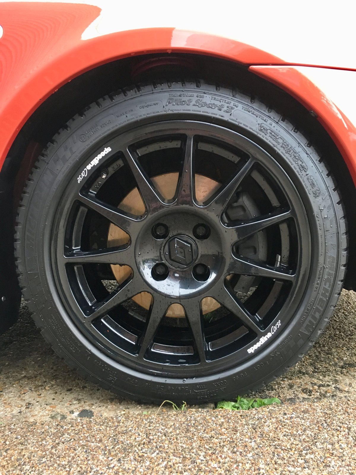

Her Turinis have had a gloss black colour change with new Federal RSRs and discs & pads.
Even treated the old girl to a wash :)
How did you get on at the ring?
Wheels look great. Just put gloss black superleggeras on mine

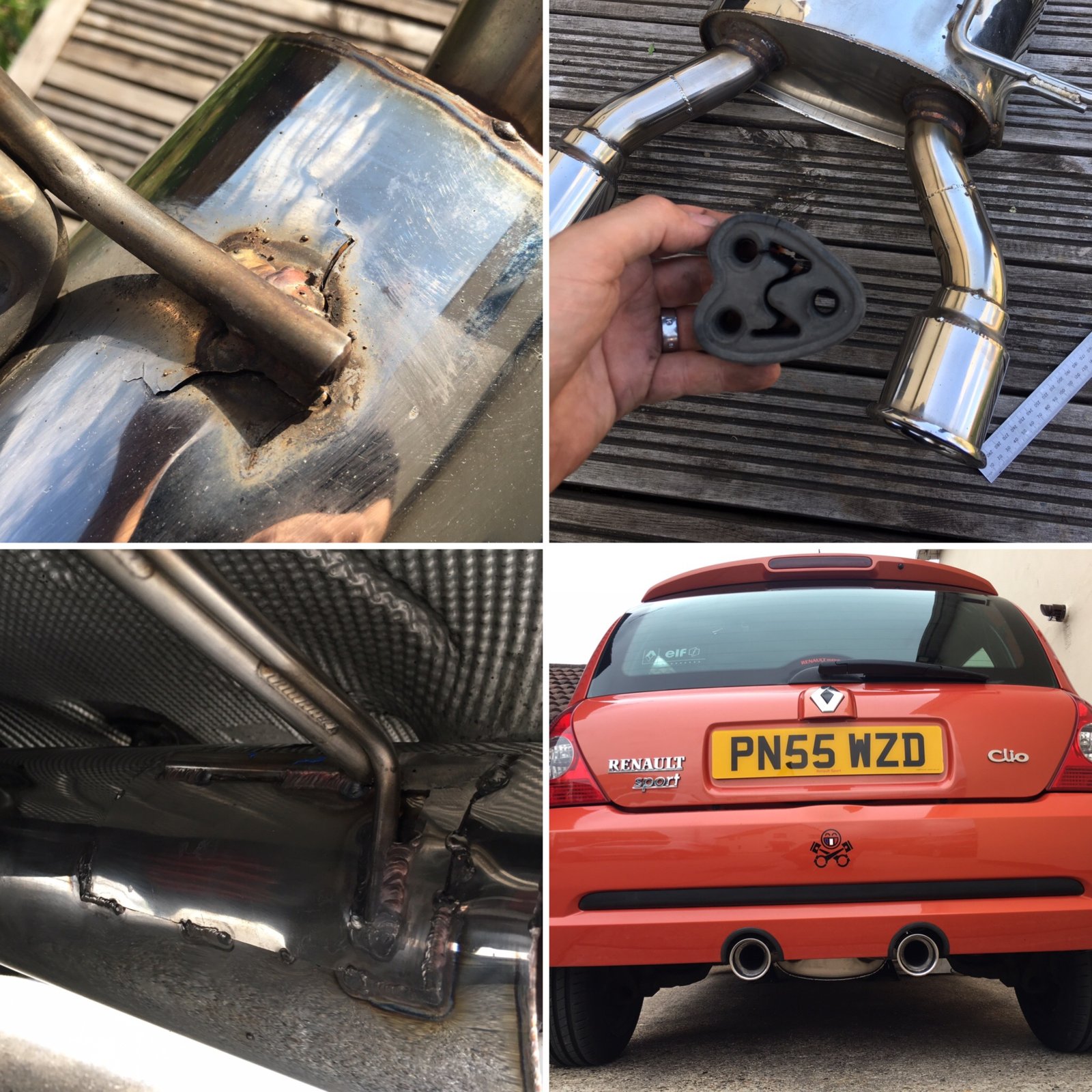

Fixed-welded exhaust, ordered new exhaust hanger for the BTM.

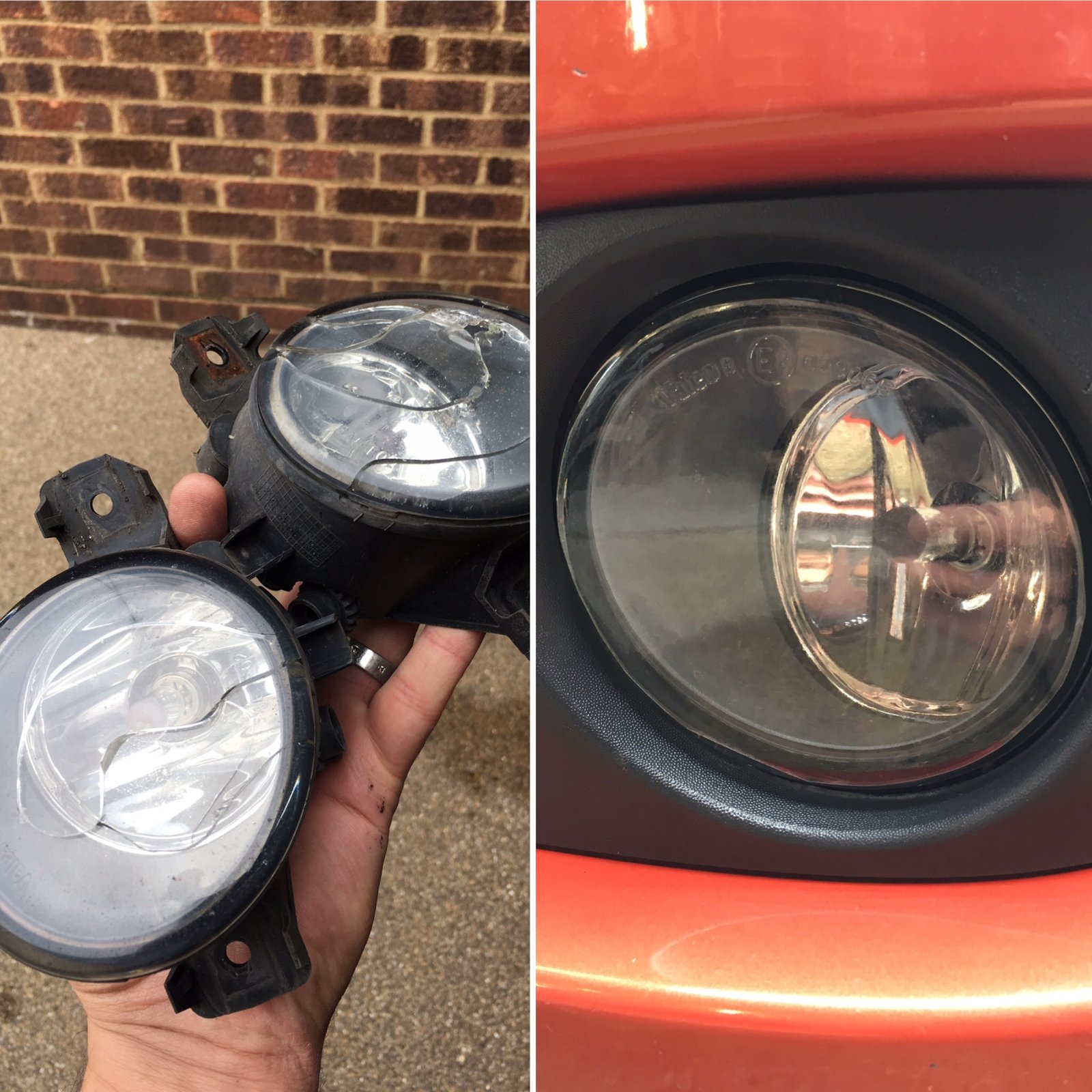

Replaced foglights with new OEM Valeos and PPF filmed them
For protection.

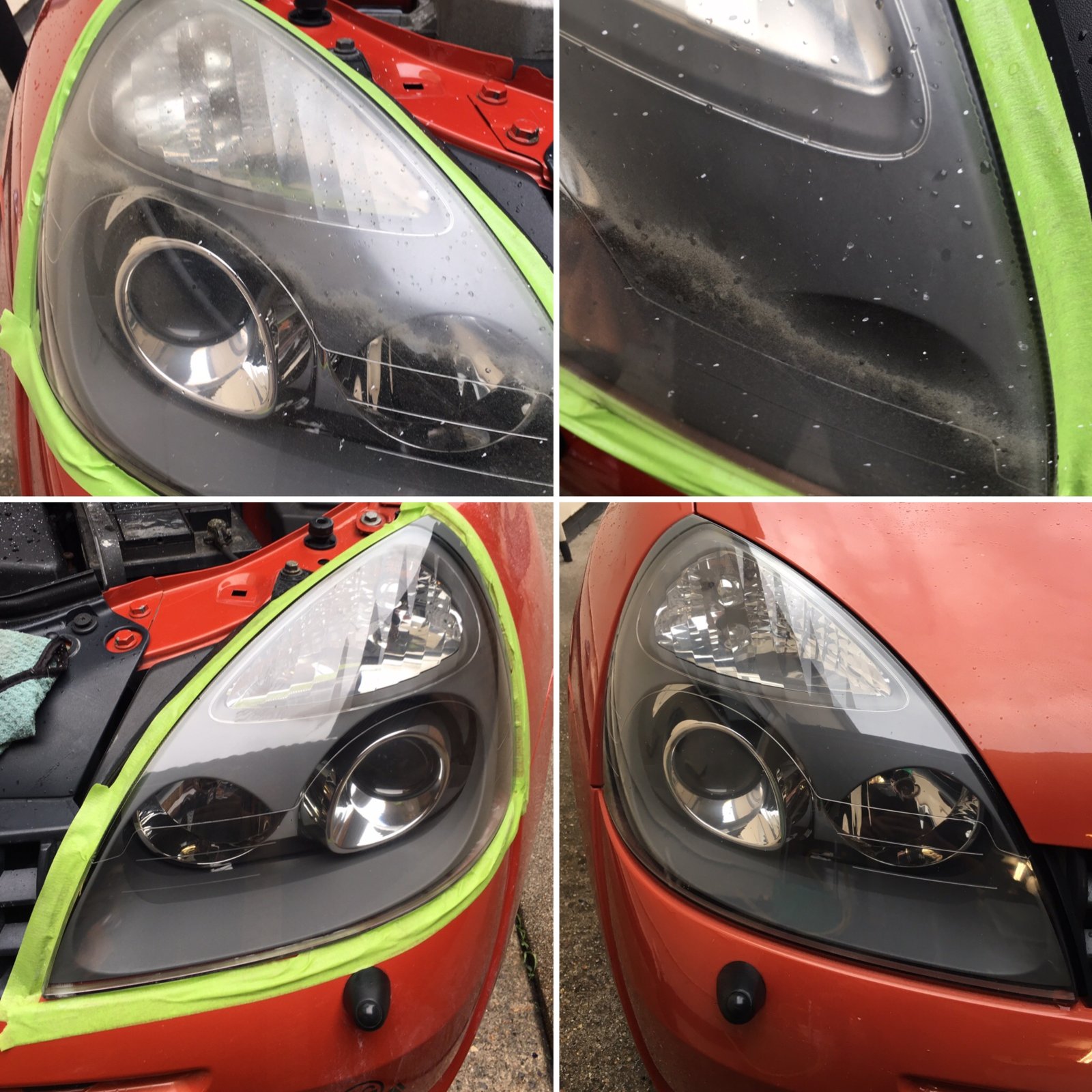

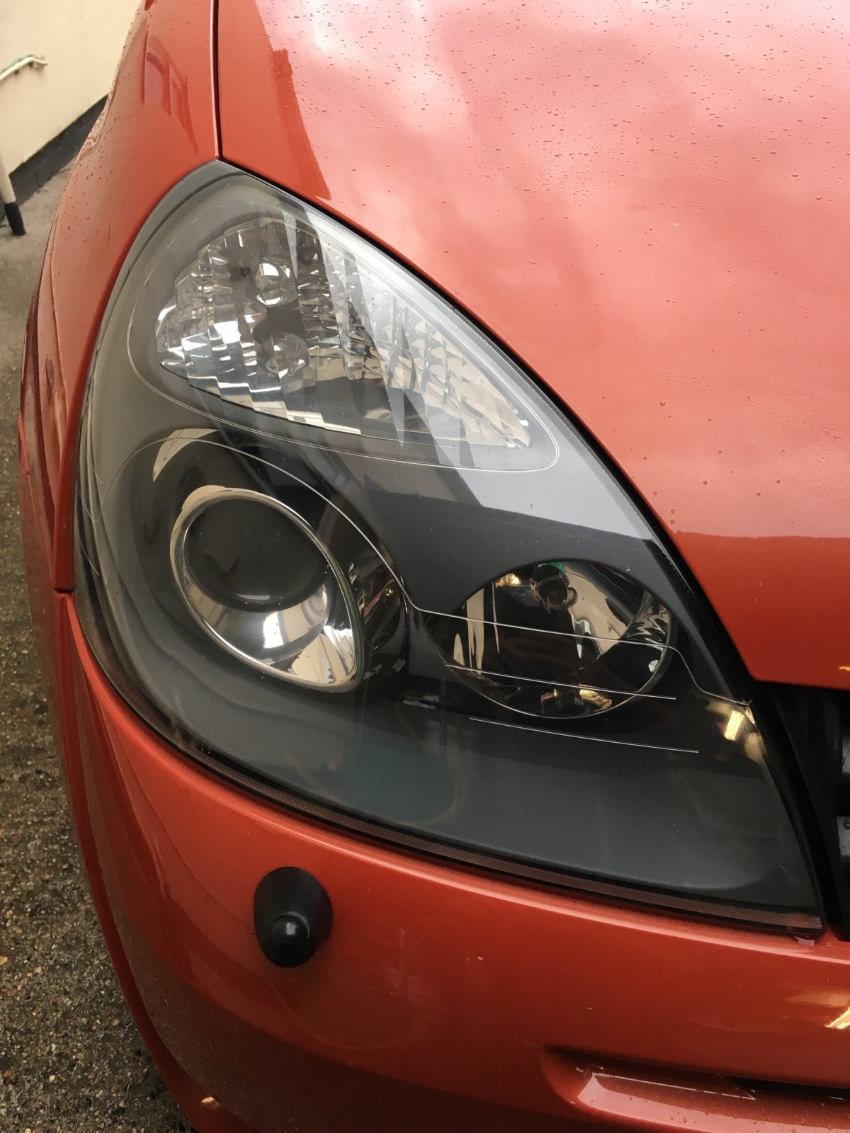

Refurbed the headlights.

Tracked the exhaust rubber for the BTM system down to that for a Honda. So ordered one of those.

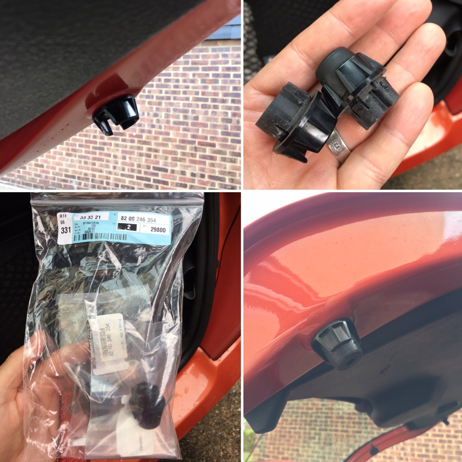

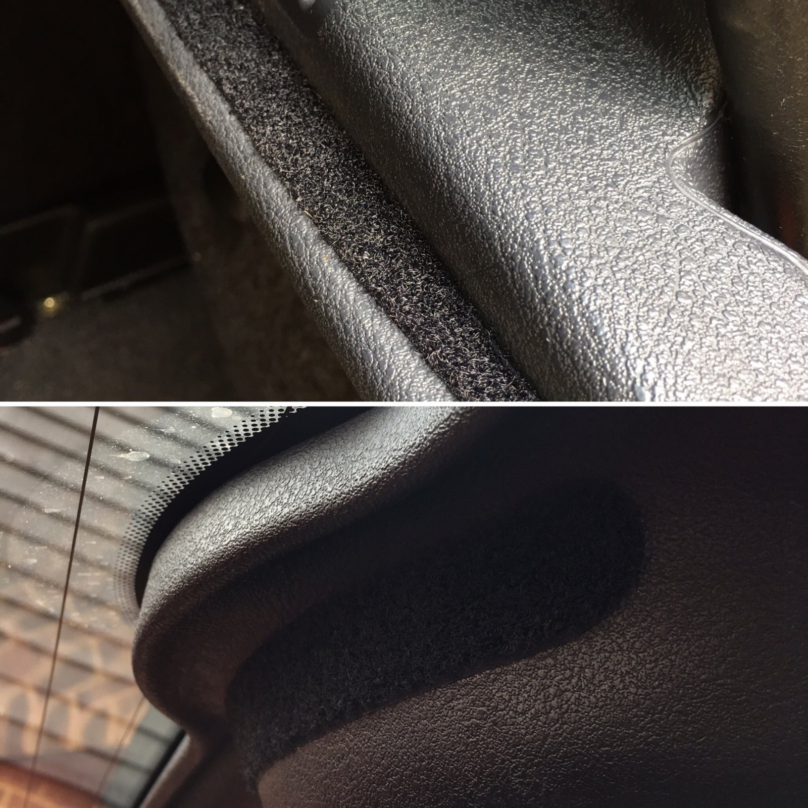

This mornings jobs were to try and eliminate the boot/parcel shelf rattle. (Of which so far so good)
The tailgate rubbers were shot, one was missing and the other was hard as nails. These are still available from Renault and at a cost of less than £5 for a pair, the new soft rubbers mean the tailgate closes with a much less aggressive thud.
Also traced the parcel shelf rattling up and down against it’s mounts and tapping the top of the inner tailgate trim.
I used some soft side Velcro on these panels to cushion the parcel shelf and now it fits snug.

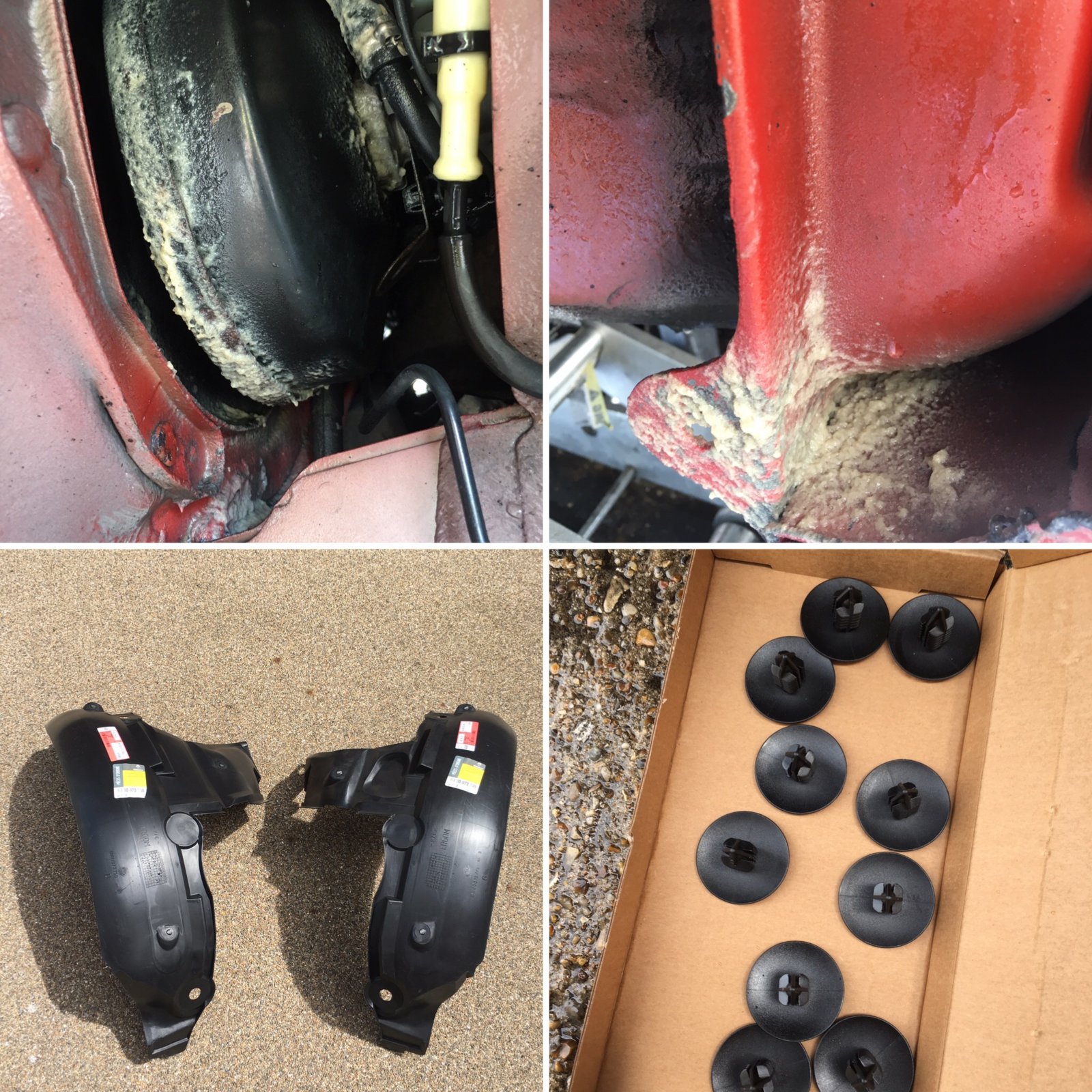

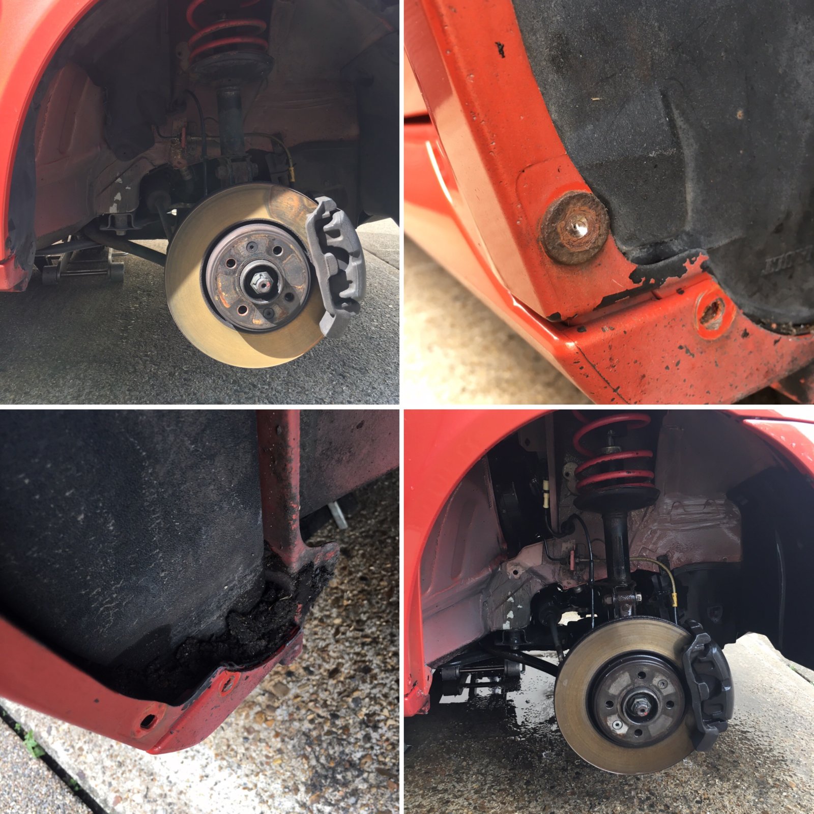

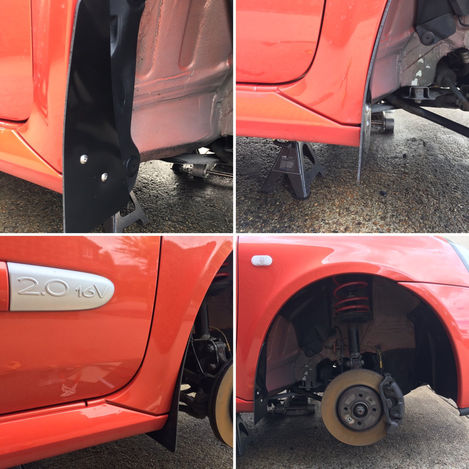

Freshened up the arches with some new liners, cleaned out the sills and skirts.
Gave everything a liberal coating of Waxoil and added some Kaylan stone guards.
Used these on quite a few cars now and they offer discrete protection without having full sized flaps fitted.
Used just the OEM fixing positions and the top of the guards is fixed right to the body using double sided body trim tape.

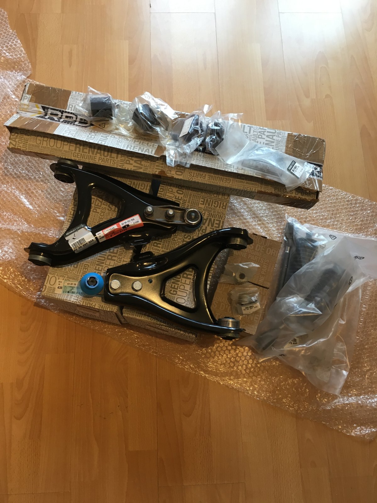

Keen to give the old girl a freshen up, the first of more boxes of goodies arrived today.
I last freshened all the dampers and topmounts at 74k miles. She’s now on 112k so I figured I’d do the same again.
Pair front complete Cup lower arms
Pair front Cup dampers
Pair rear Cup dampers
Pair revised front topmounts
Pair revised topmount nuts
Pair inner track rod ends
Inner/outter ARB bushes

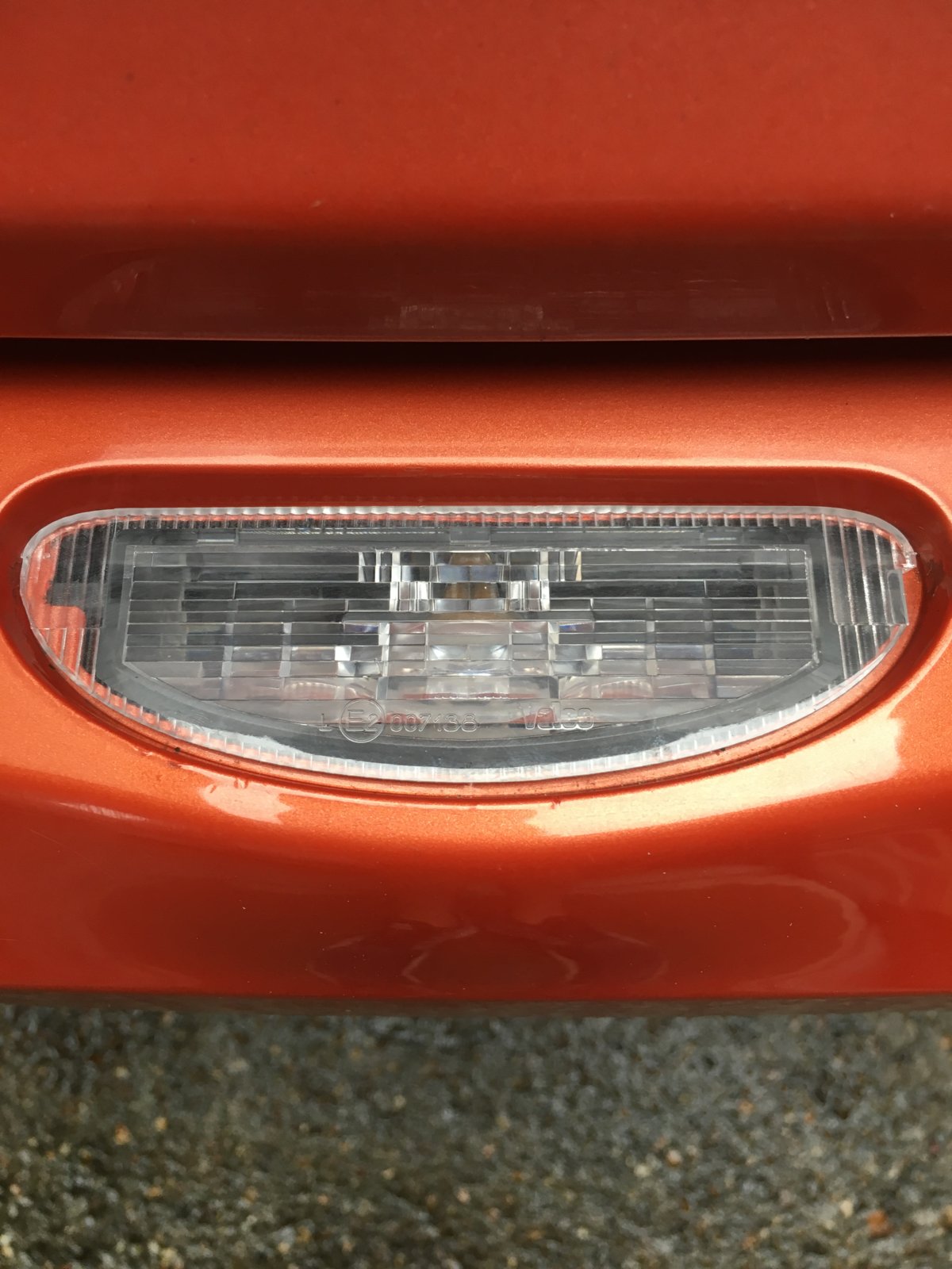

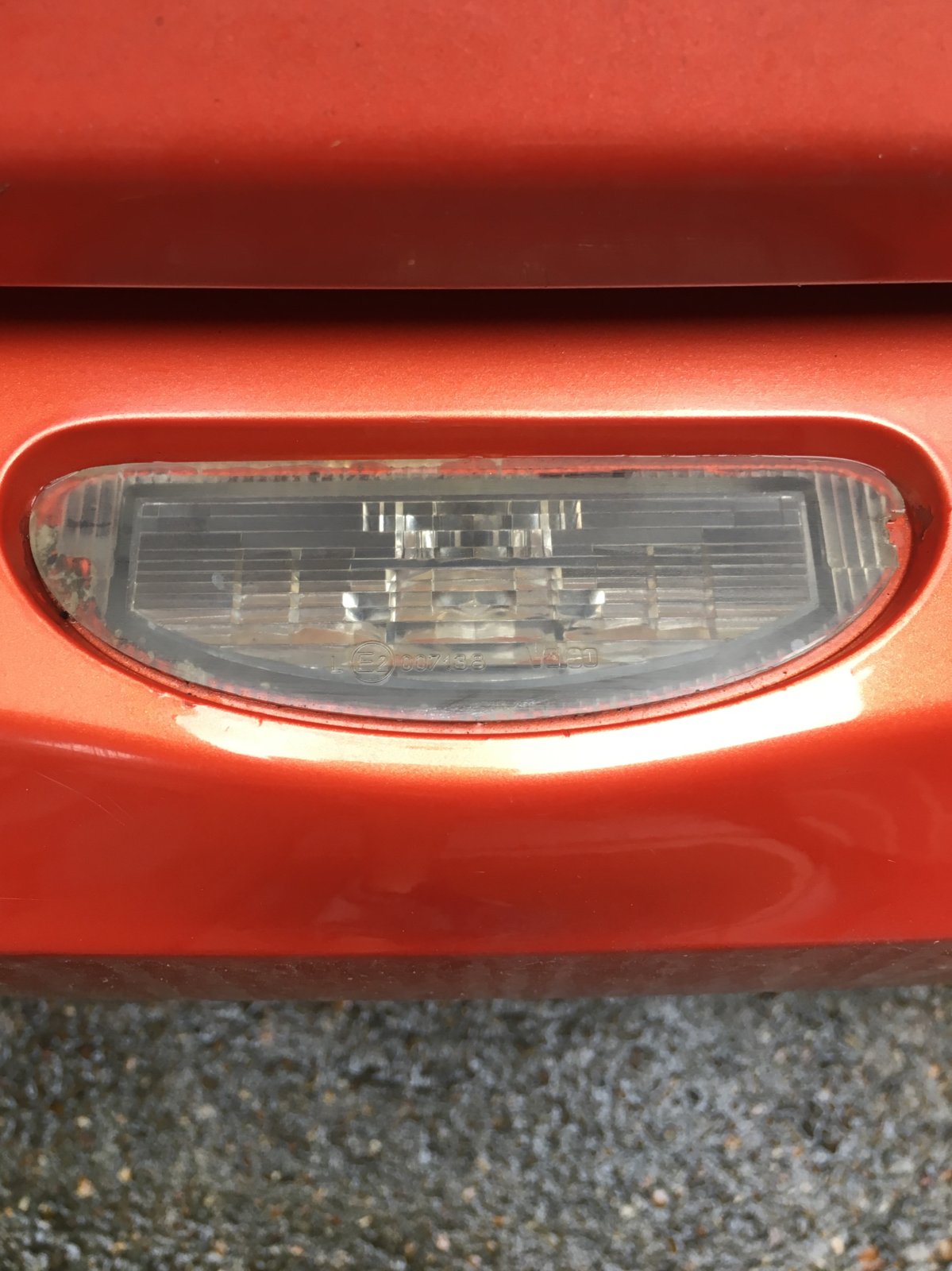

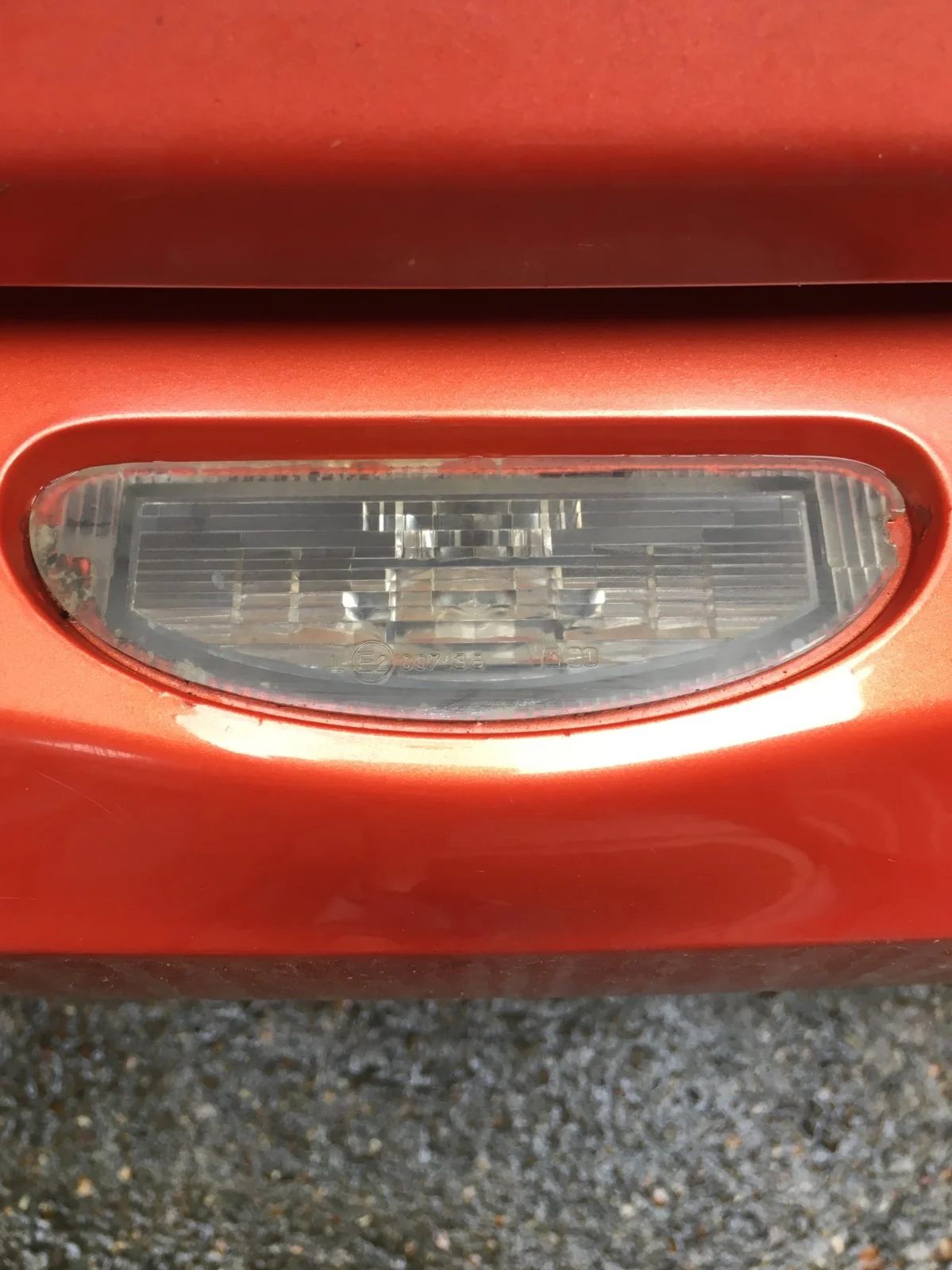

New rear numberplate lamp.
Obviously the lamp was all I could fit tonight, so that went straight on. A vast improvement, I’m sure you’ll agree.

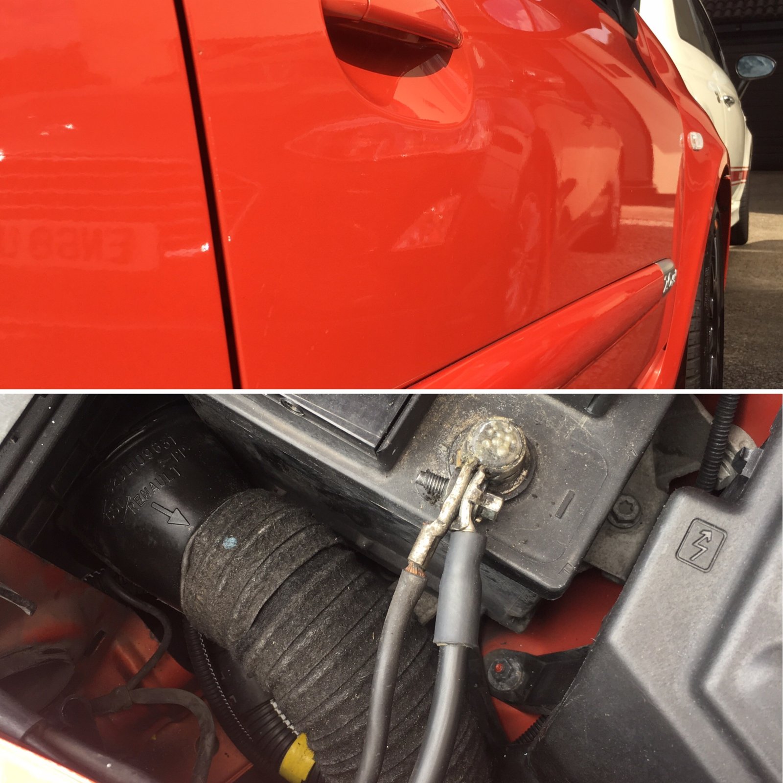

Only a small update on the 182, bit of poor show on my part really as I forgot to take any before pics. However I had all the little dings I found on it taken out today. 2 on the drivers door that were visable. One on the passenger door and 3 on the bonnet that were barely visable, but I’m fussy. Used a guy I usually use for this and his work is superb.
She’s now arrow straight again.

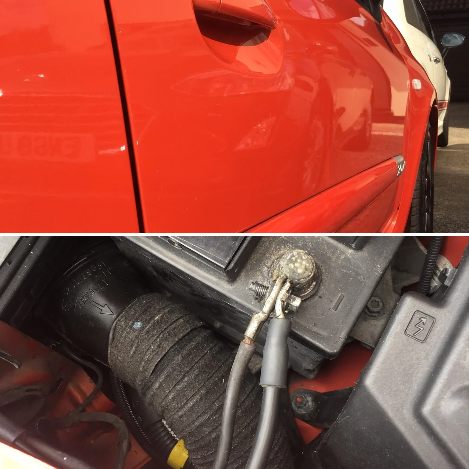

Also saw how poor the OEM earthing setup is, so I made up a much thicker earth strap to the chassis ground and I’m going to make up another from engine/gearbox to the chassis ground. It may be placebo that it feels smoother to drive but I’m 100% it isles much nicer.

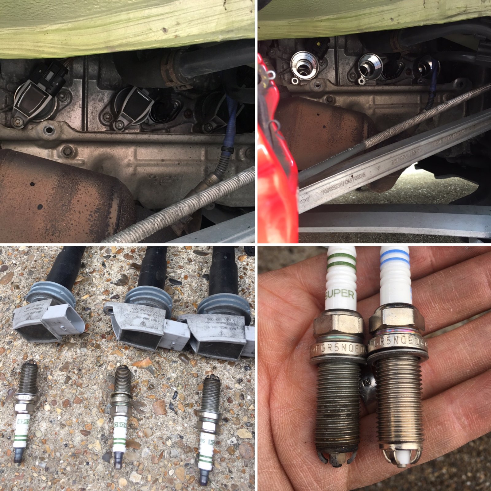

Also the R was due a plug change, so swapped those out. The ones I took out were pretty mint to be fair, hardest part of this job is getting the rear wheels off. Lol. OCD found me hoovering behind the wheel liners, but hey, we all do that, right? ?

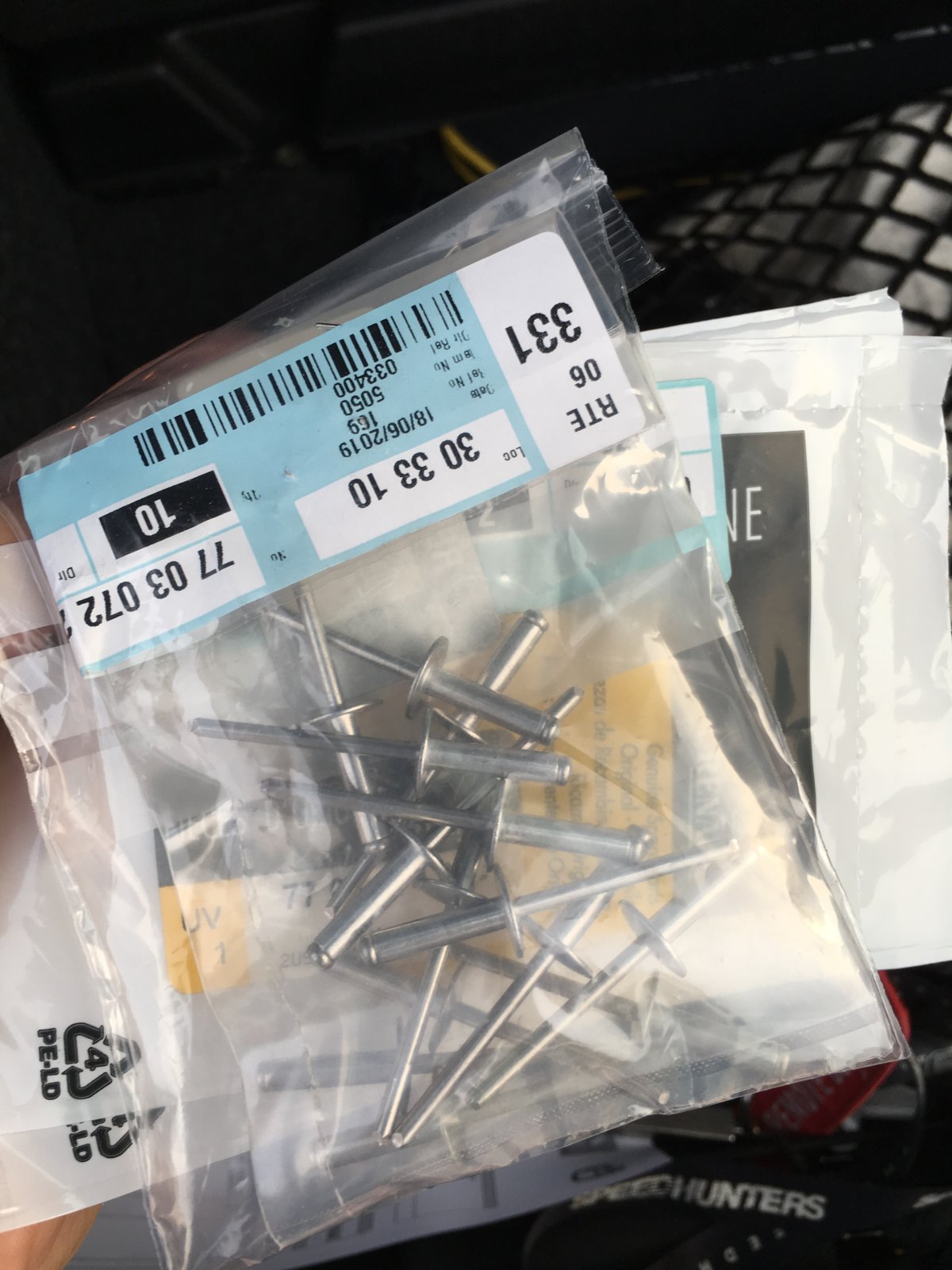

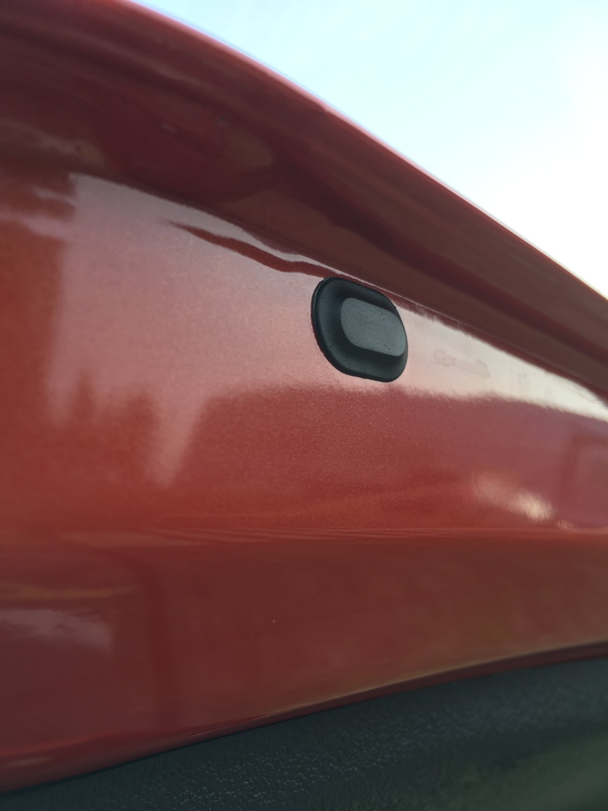

Nothing much, however I collected some small bits from the dealers in the way of some blanks for the bottom of the tailgate to finish the holes.
Also collected new rivets for the skirts as I want to have them off to clean/underseal and refit.
The OEM Black rivets are no longer available and have been replaced with these silver ones. Not too happy about that to be honest, so I’ve ordered a box of black peel rivets and hopefully they will be more in keeping with the OEM finish.

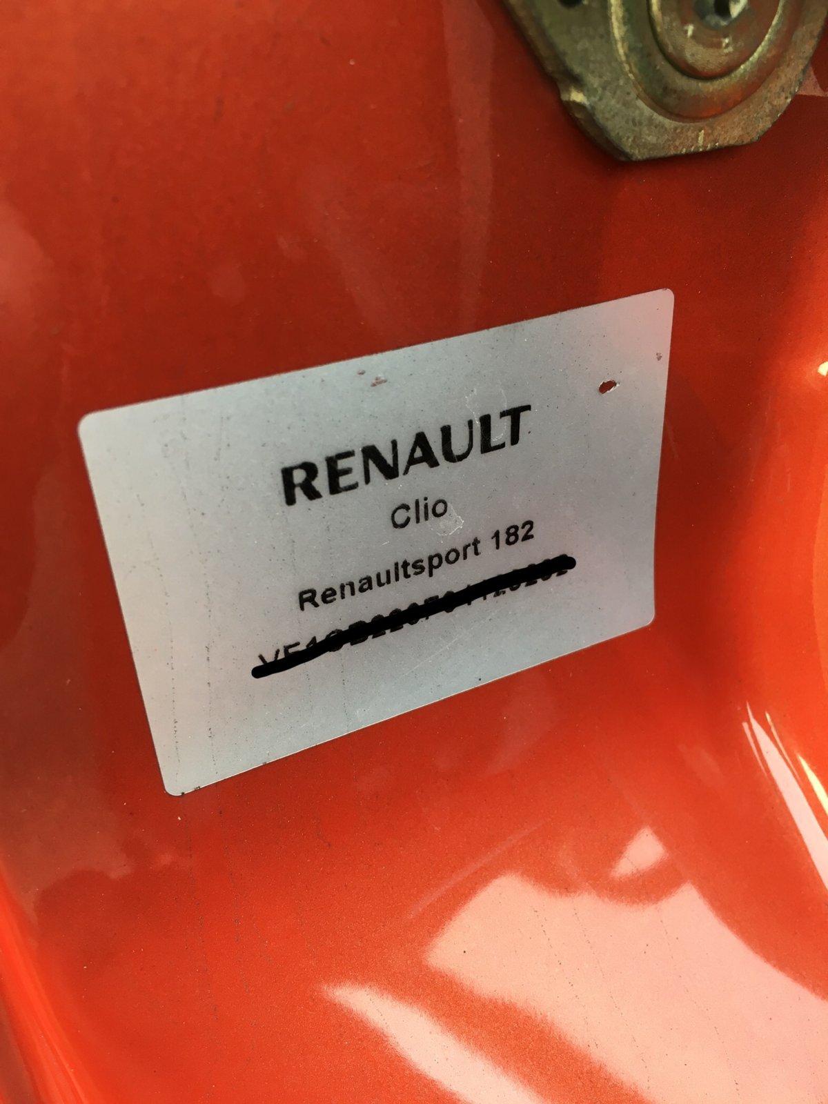

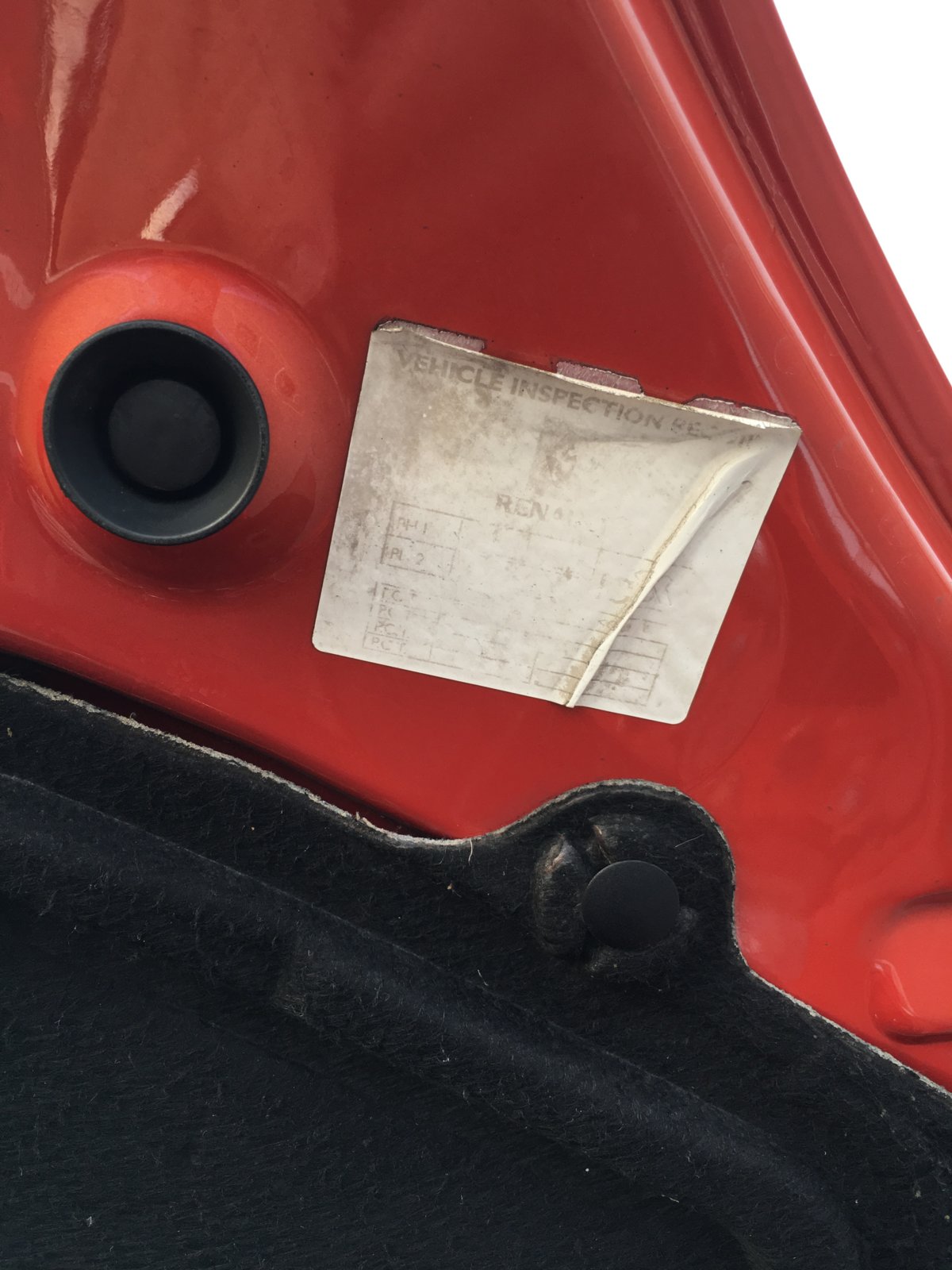

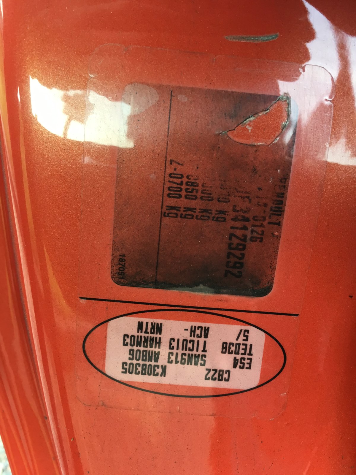

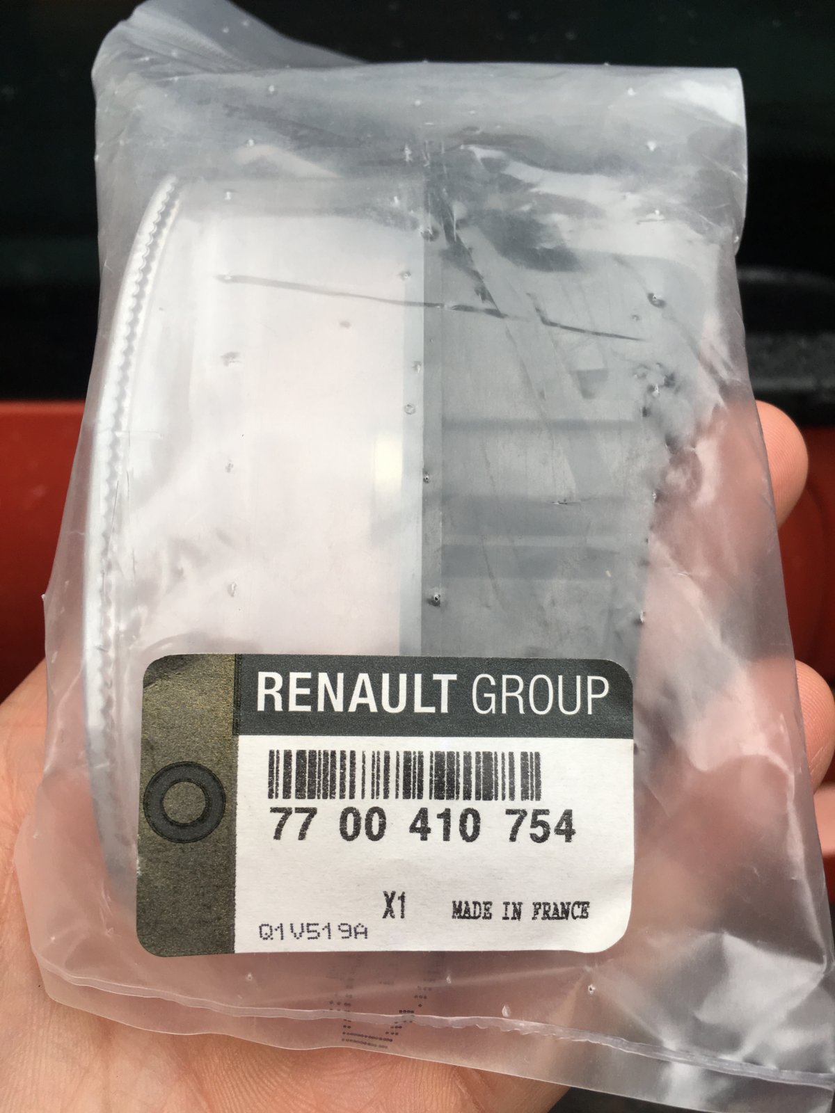

I’ve also contacted Renault UK to see if I can track down replacements of the vehicle ID stickers inside the drivers door shut and the under bonnet decal. They’re coming back to me, so hopefully with a favourable reply.

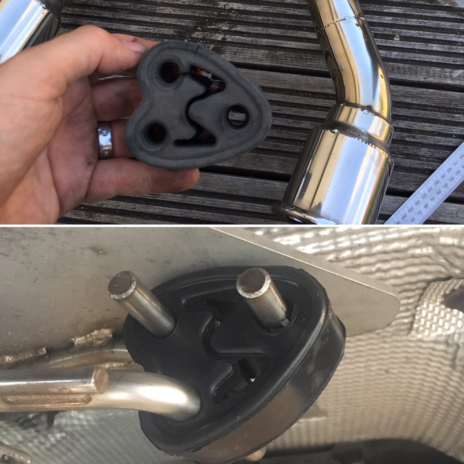

More parts arrived today in the shape of a new OEM Centre mount for the exhaust and managed to track down a pair of genuine Cup washer blanks.
These are notorious for breaking so I’ll fill the thread centres with resin and internally sleeve them.
Just need to decide if I paint these satin black or body colour.

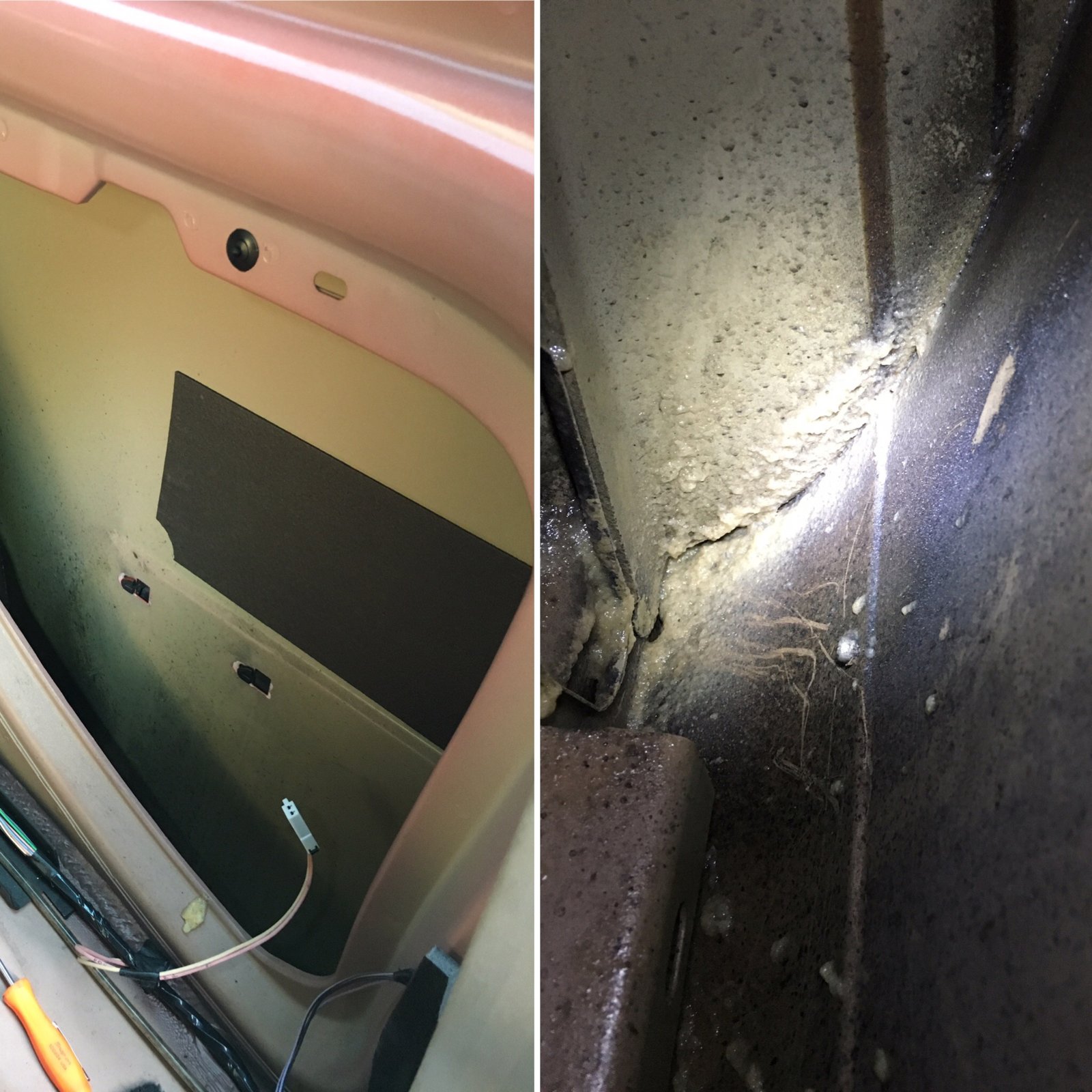

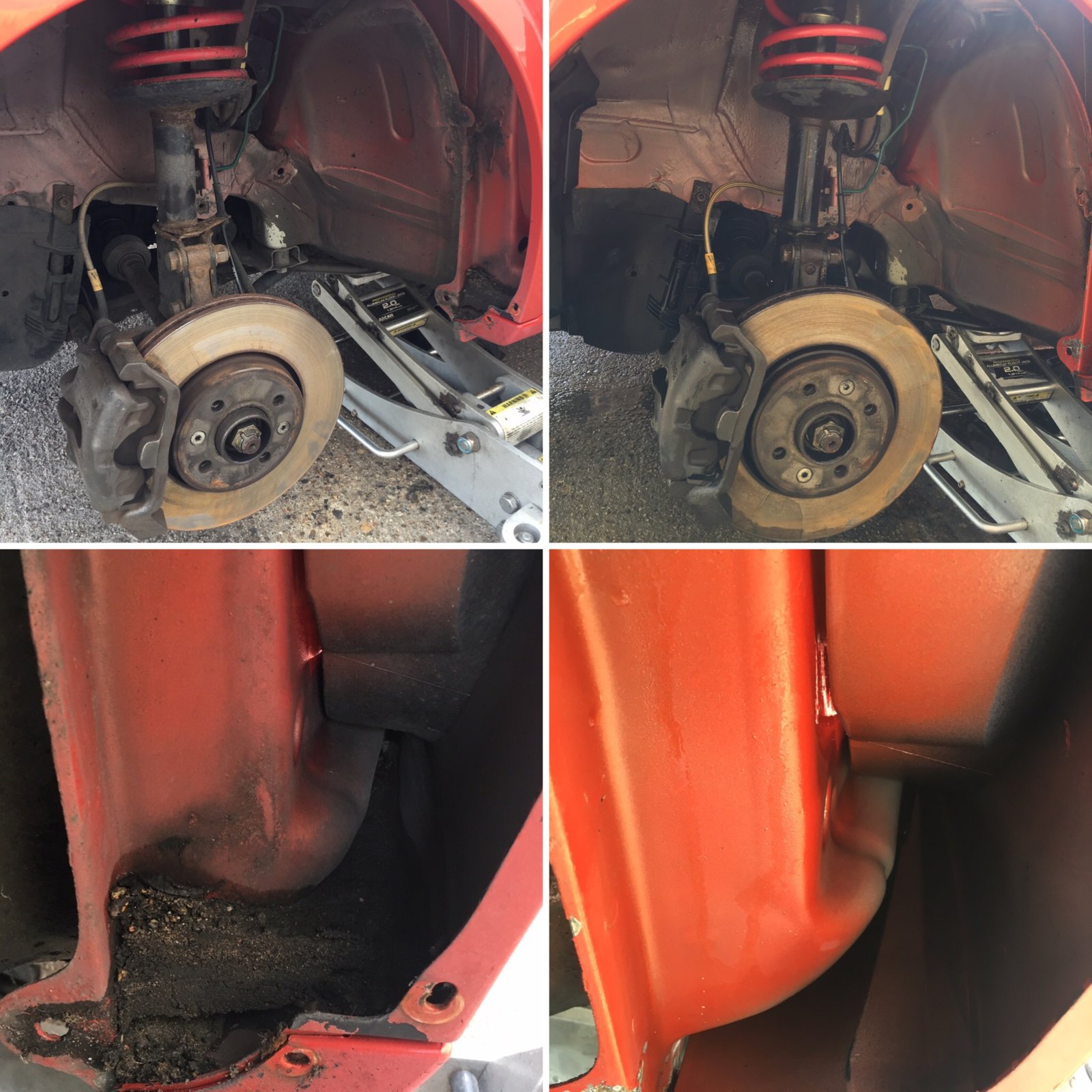

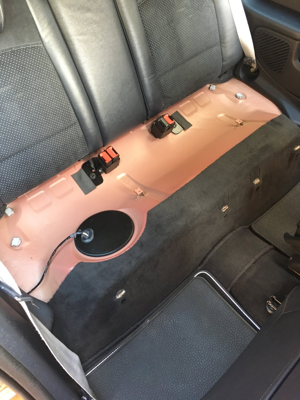

Another job I’ve been meaning to do is get the rear panels off to check the state of the sills from inside.
Happy to report there is no corrosion in here at all. So just a quick hoover round, clear the drainage holes and a liberal coat of Waxoil.
I will however order some Bilt Hamber and revisit these areas to get them properly protected.
Easy enough to get off? Been meaning to get around to this. Glad you didn’t find anything lurking in there!
Yep, dead easy.
Pull the rear bench lower sections out.
17mm hex for the lower rear belt fixings.
TX40 for the lower front belt fixings.
Just give a gentle tug all the way around the rear doorcard and they pop right off.
Mindful to unplug the rear speakers before taking the doorcards fully away.
Small foam sound deadening pad behind that isn’t fastened in so comes right out and there you have full view inside the rear qtrs.

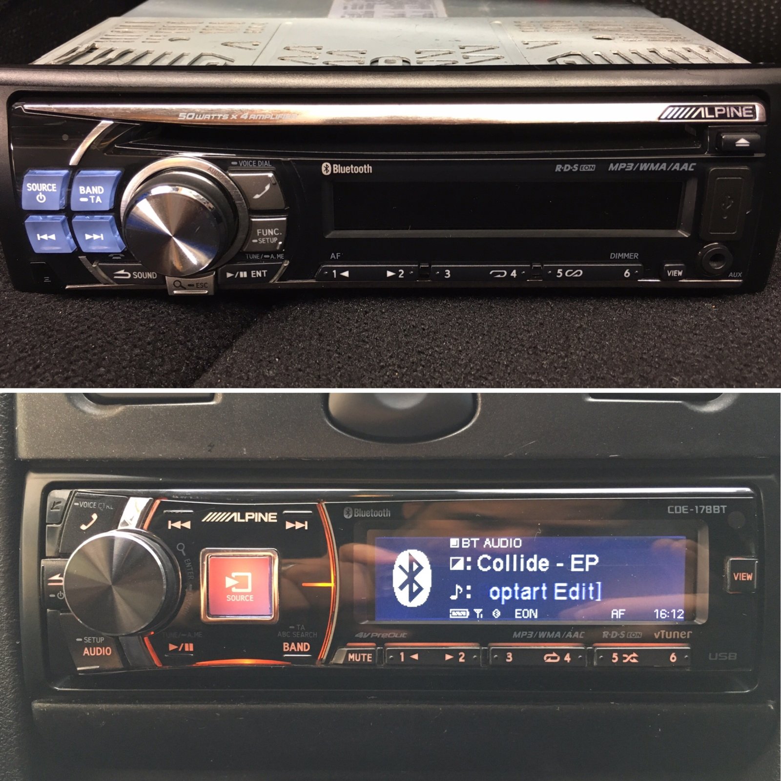

Wen I first owned the car I fitted what was at the time a pretty high spec Alpine HU. FFwd to now and I wanted one that would stream from my phone as well as have a full high speed iPod connection.
So swapped out the CDE-113BT for a CDE-178BT.

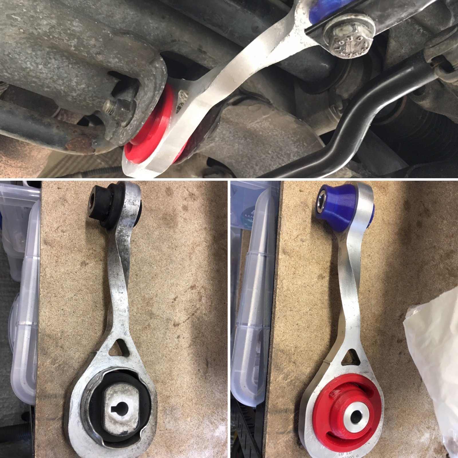

Also fitted a new prototype poly dogbone from Phillip M. This is really quite impressive, much improved gear selection and control of the engines torque reaction. However absolutely zero increase in NVH... it’s wizardry I’m sure.

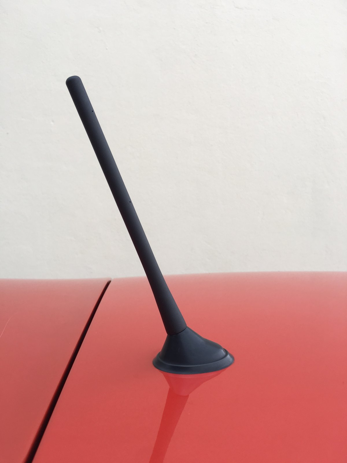

Swapped out my OEM aerial from that of a latest gen Fiesta to keep the OEM+ type finish and finally swapped my orange Speedline decals for some white ones.
I really liked the idea of them in orange but wasn’t quite convinced once fitted. Personally I like the white better as it looks more OEM to the Speedline wheel.
