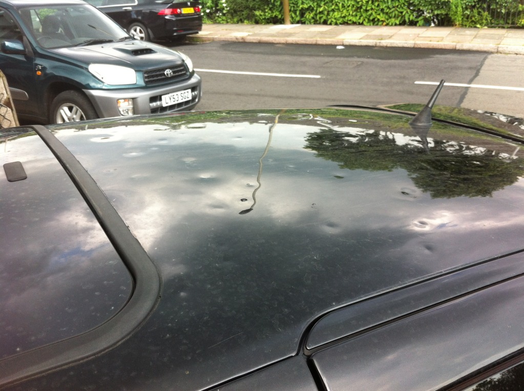

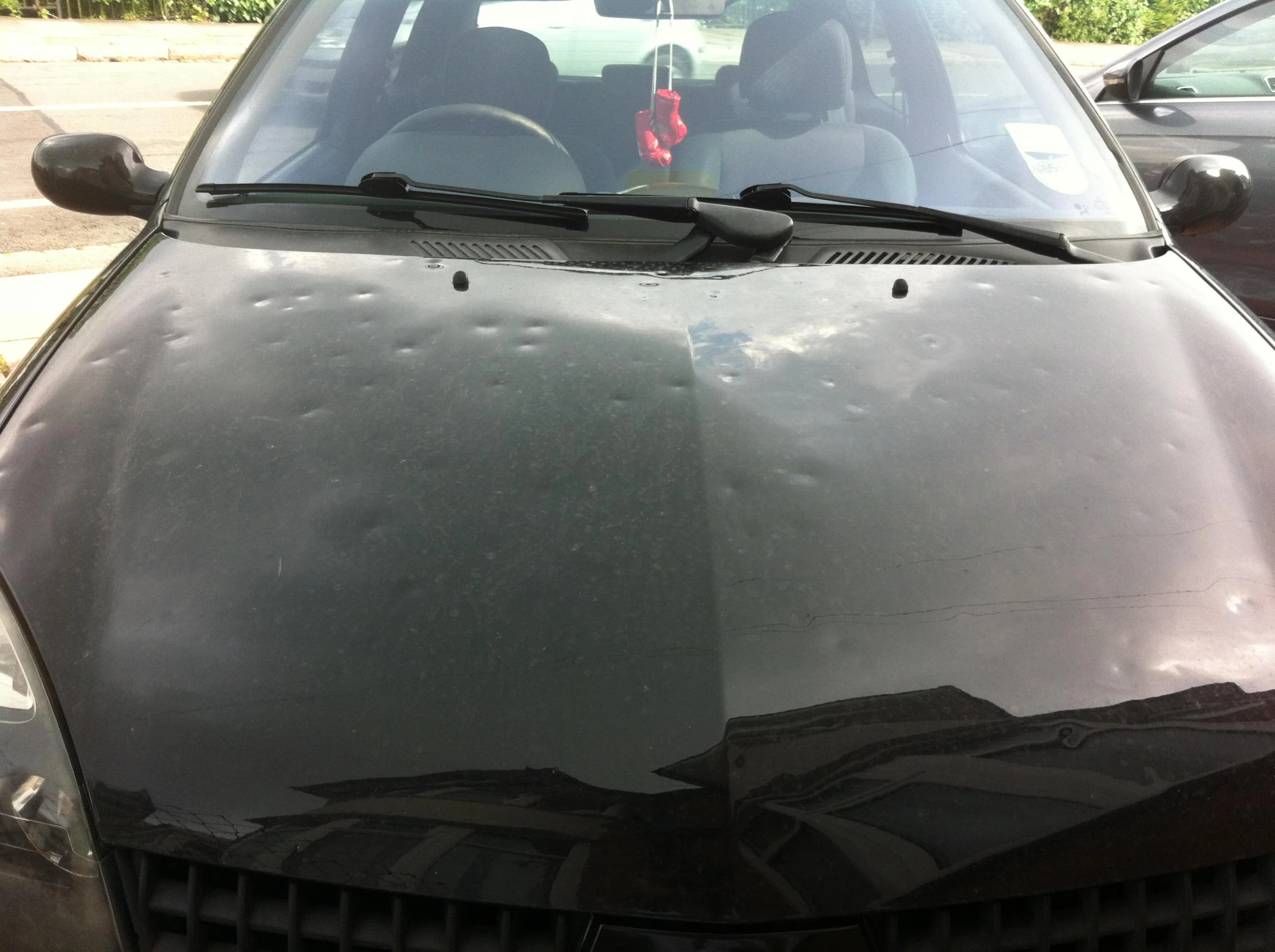

Yeah it is, I had the 182 and the storm was no way near as bad where I was, it's only one of them at least.
Been and had a quote, every panel will be repaired and resprayed so the whole car will be resprayed. With all new decals it'll cost around £3800

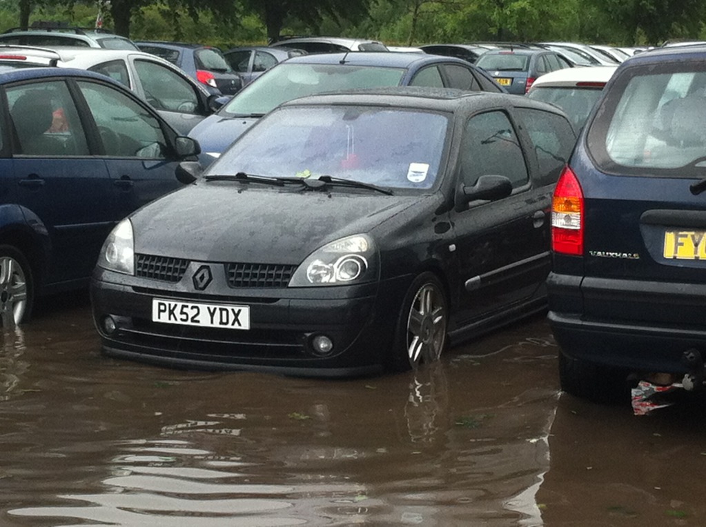

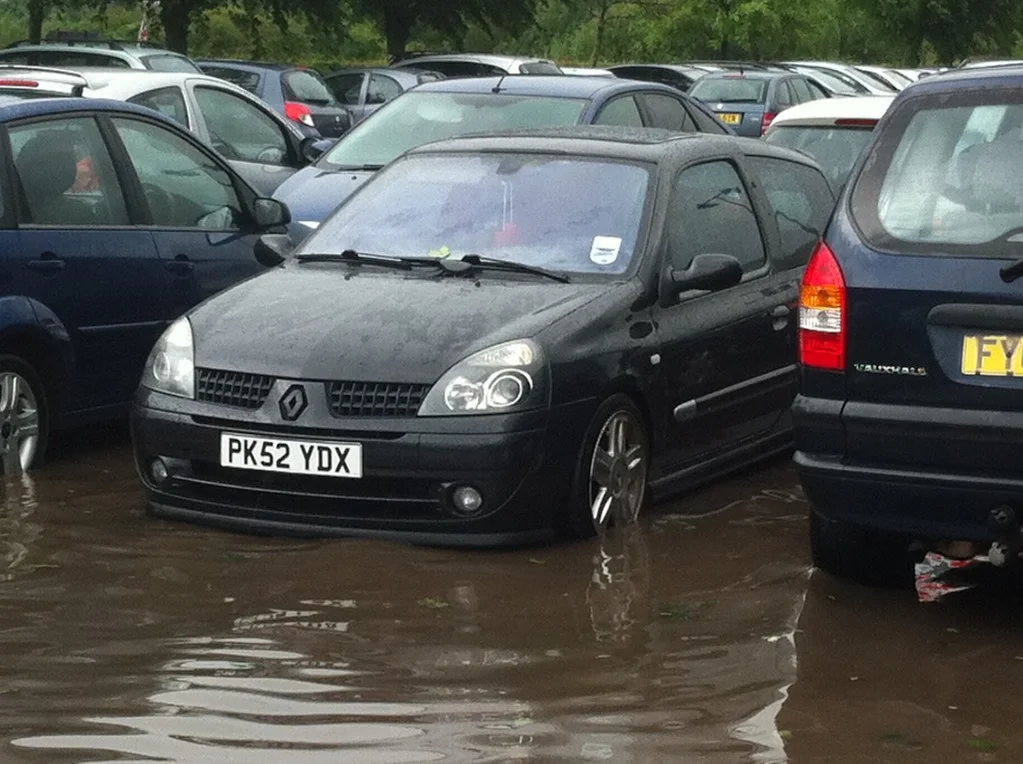

no hail stones but had to do some serious fording to get home... water mark on my car was like near the bump strips on the doors :| thank god for diesel!

Dent man?
Can they do it>? mine is a magician
I'd say a good dent man could get a lot of them out, but there are some in double skinned areas and places they can't get to. There's so many in the bonnet I don't think it would ever be right, dents on dents

I don't want to go through insurance so what are the options and what am I expecting to pay in regards to price?
New bonnet or is it repairable and what about the roof? :|
  182 Cup/Mk5 Gti
2nd hand bonnet would be the cheapest repair for the front and you could get a dent tech for the roof but depends if they can do all if not then ring renparts and get them to cut you a roof off and get a bodyshop to change the roof skin then spray it. I payed £100 for a roof from them and genuine new one is £400ish.

Wouldnt want to attempt a roof, doors yes maybe as you can massage dents out by levering off inner door skin to correct outer skin imperfections, but on the roof it's going to be freehand dent removal fook that, will be worse than when you started.

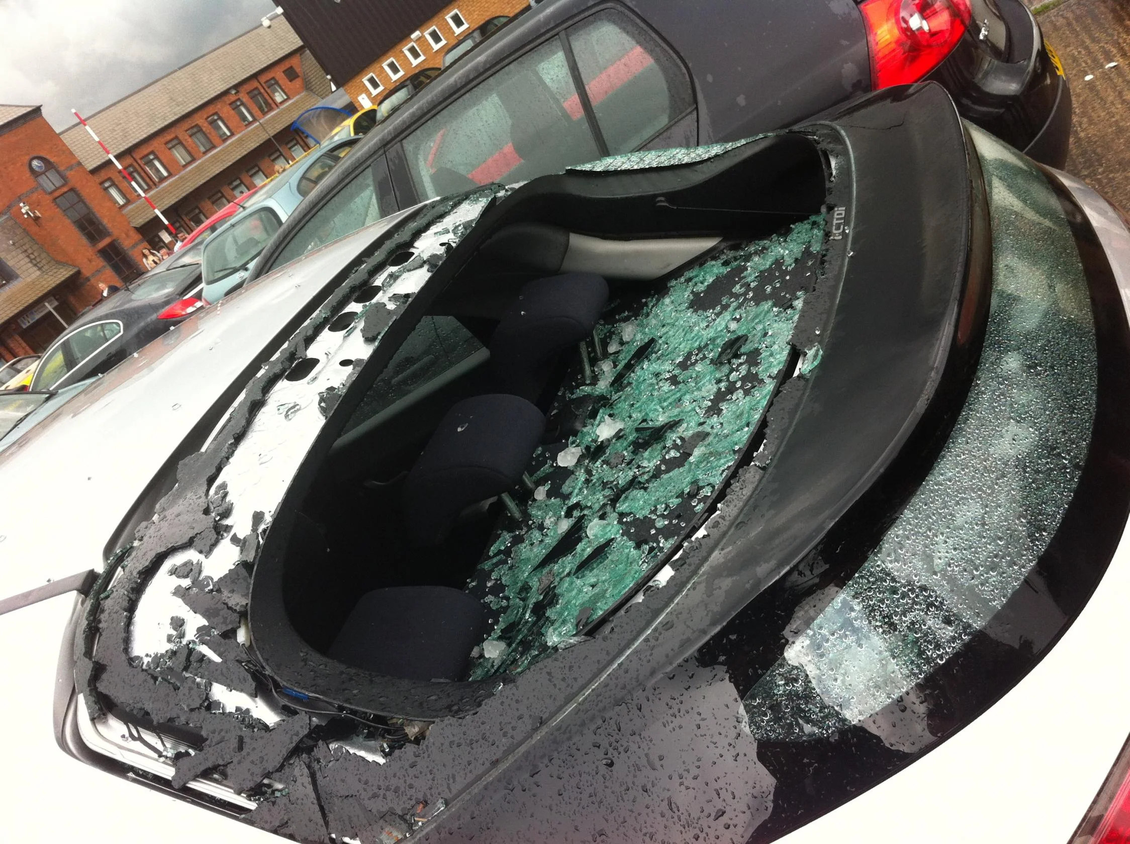

Ahh mate! same happened to me! my car was sitting in the car park and i came back to 20-30 dinks in my roof and bonnet! to be fair i got let off easy compared to the amount of windows i saw smashed plus their dinks! 1st pic is the dink and 2nd is someones civic
