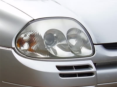

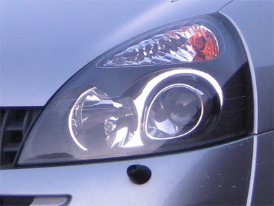

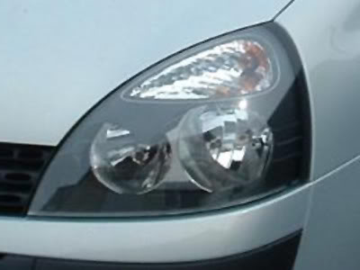

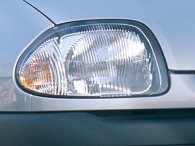

Only put the HIDs in if you have the correct housings for them or you'll burn everyone's eyes out. And I'm assuming you mean 55w. Be careful because the temperature created by 55w HIDs can melt housings. If in doubt, 35w. Don't go higher than 6k either or you'll look an idiot with your blue headlights.
By correct housings I mean these:
or
rather than these:
or
