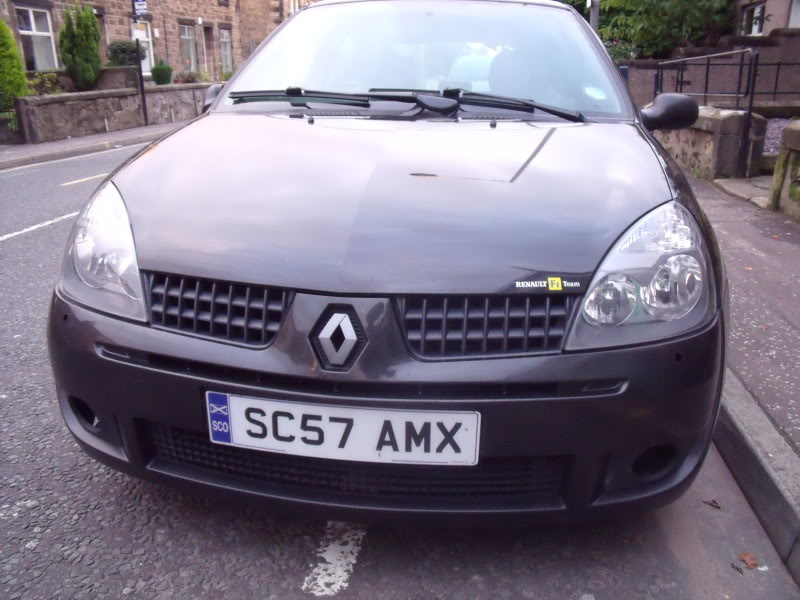

Quick picture of the car as it stands just now!
(Coils and spacers on tomorrow! Side skirts at a later date.)

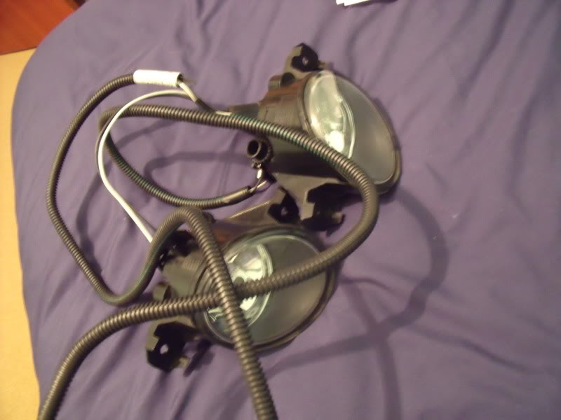

And picked these up off the bay for 50 quid. ;)
Cheers dude! :)

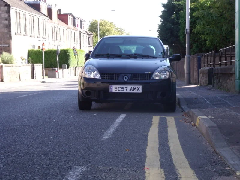

Got the spacers on now (30mm front, 13mm back) and it looks spot on.

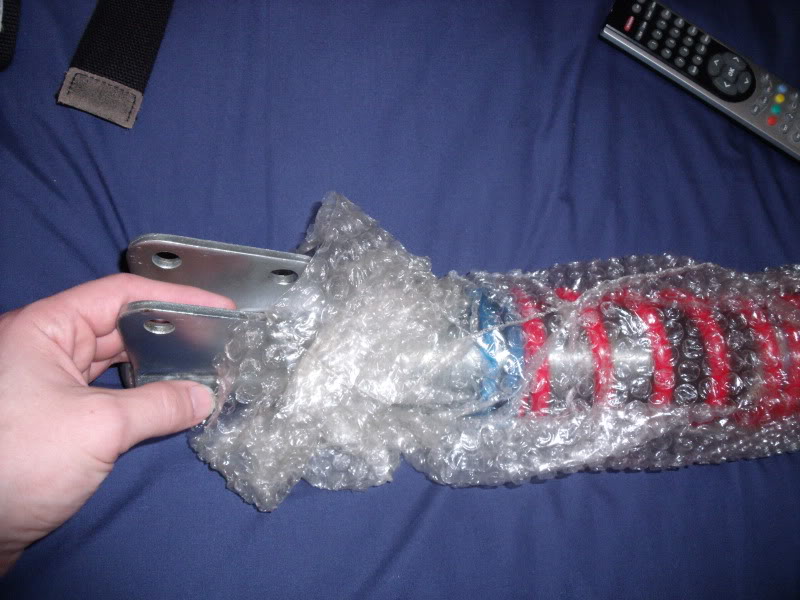

Had a problem with the coilovers being the wrong size (not the bolt spacing though!)
The bracket bit my finger is in is a 28mm gap.
The bit on the hub that fits into this is only 23mm.
So I've contacted Speedbox who are talking with Vmaxx just now.
I'm tempted to try sticking some 2.5mm spacers on each side though to solve the problem! :rasp:
Will be fitting the skirts next week once I get hold of a rivet gun at the weekend and may look at fitting the fogs (but not wiring them up) this week.

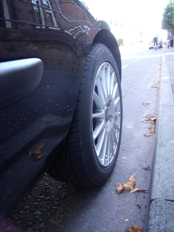

Took the car for a "spirited" drive earlier.
The handling is immense with the spacers on, corners I would take at 45-50mph I'm taking comfortably at 60ish. (this may be due to the size of my balls though).
The car feels totally planted.

Will just add I heard back from Speedbox and Vmaxx and it turns out I have the wrong front struts! Their coming on Monday to pick them up and will be sending the correct ones out once they have them. :)

Turns out I had the correct coilovers but they were labeled wrong! :dapprove:
So will be waiting to get them back!
Also fitted the sideskirts (no pics) but the colour match ain't great so they will need a proper re-spray. ;)

Turns out theres different hub spacings too!
You get 3 sizes for the clio, 23mm, 25mm which are for 1*2's and 27mm not 28mm which are the ones I got that wont fit.
Don't know if Vmaxx know this but will hopefully know by tomorrow! :)
Right for anyone that doesn't know!
Speedbox contacted me and said Vmaxx are sending the coilovers back, and I've to try using spacers/washers to put them on.
As I'm not entitled to a refund!

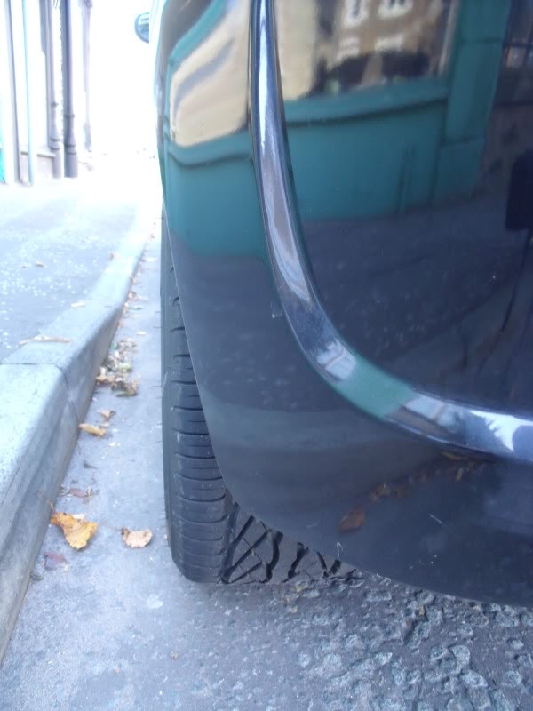

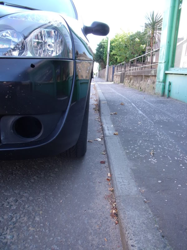

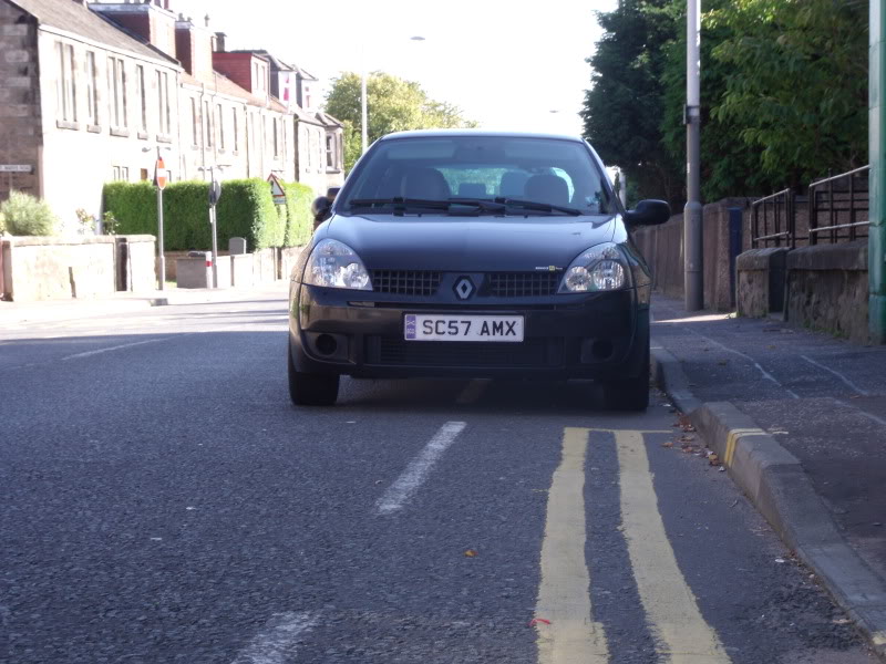

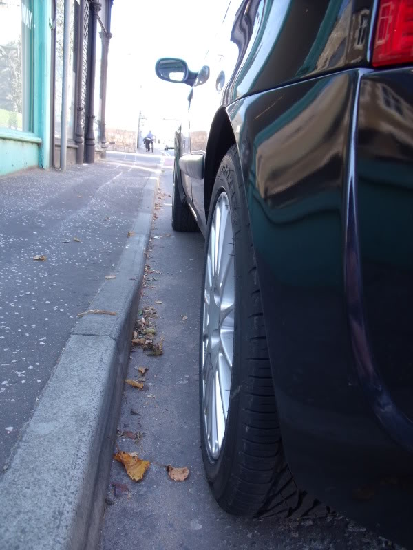

Lowered on Eibach Sportlines.
I'd say about 40mm rear, (it's how I want it)
And about 30mm front.
The box says 45 front and 30 rear though! :rolleyes:
Don't need to defend yourself! i like the height. and I've just bought those exact springs :D:D:D
