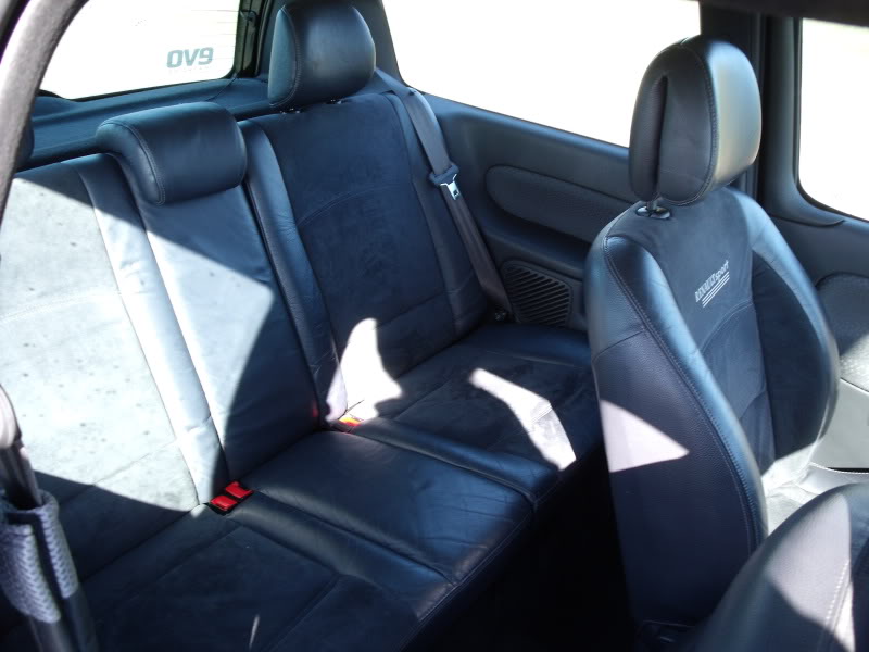

Hate the campus rear, really glad you put the 172 one on :)
Why do the rear headrests look different to mine and every other clio i have seen?

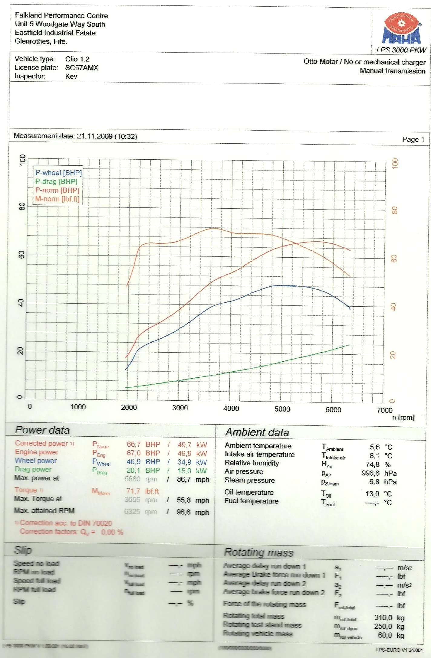

Thought I would post up my results from the RR's the car has been on!
Bear in mind this was just for fun each time! I wasn't really bothered what I got!
The first run made the most power looking at "corrected engine power", but if you look at "wheel power" (which I'm told is the actual power) it goes up each run.
1st run - Sebring Bacbox, K&N replacement filter.
2nd run - Sebring Backbox, Pipercross open IK, ghetto decat.
3rd run - K-tec "sport" stealth, Enclosed IK, ghetto decat.
Also looking at the third run it looks like I no longer have a flat spot at 3000rpm, this is probably due the engine being run in I guess.
Runs in order.

3rd RR Graph is really interesting with the flat spot gone at 3k revs, im trying to work out why and i just cant work out what could cause it and what would have sorted it.
initially i thought it could have been the decat but then i noticed 1. it done it before the decat was fitted and 2. you still had it fitted in the 3rd
the car being run in you would have thought would have affected the graph throughout not just at a set point
