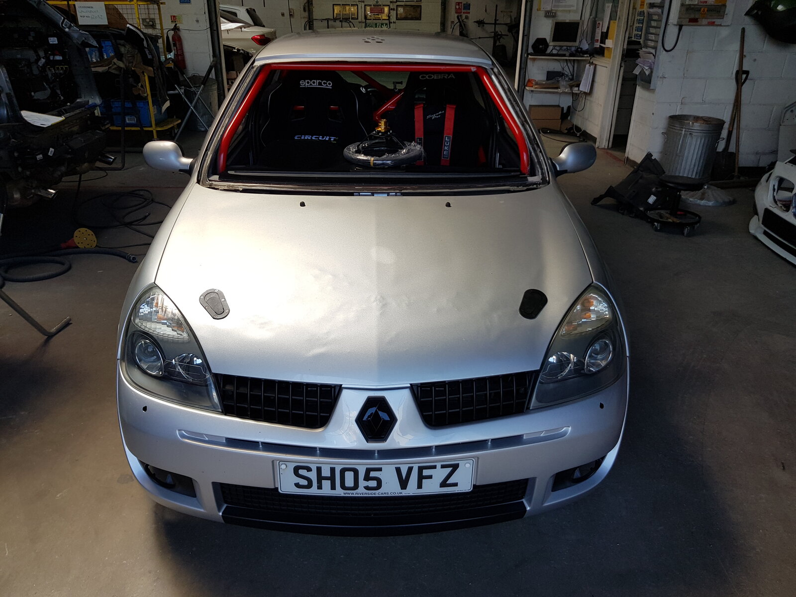

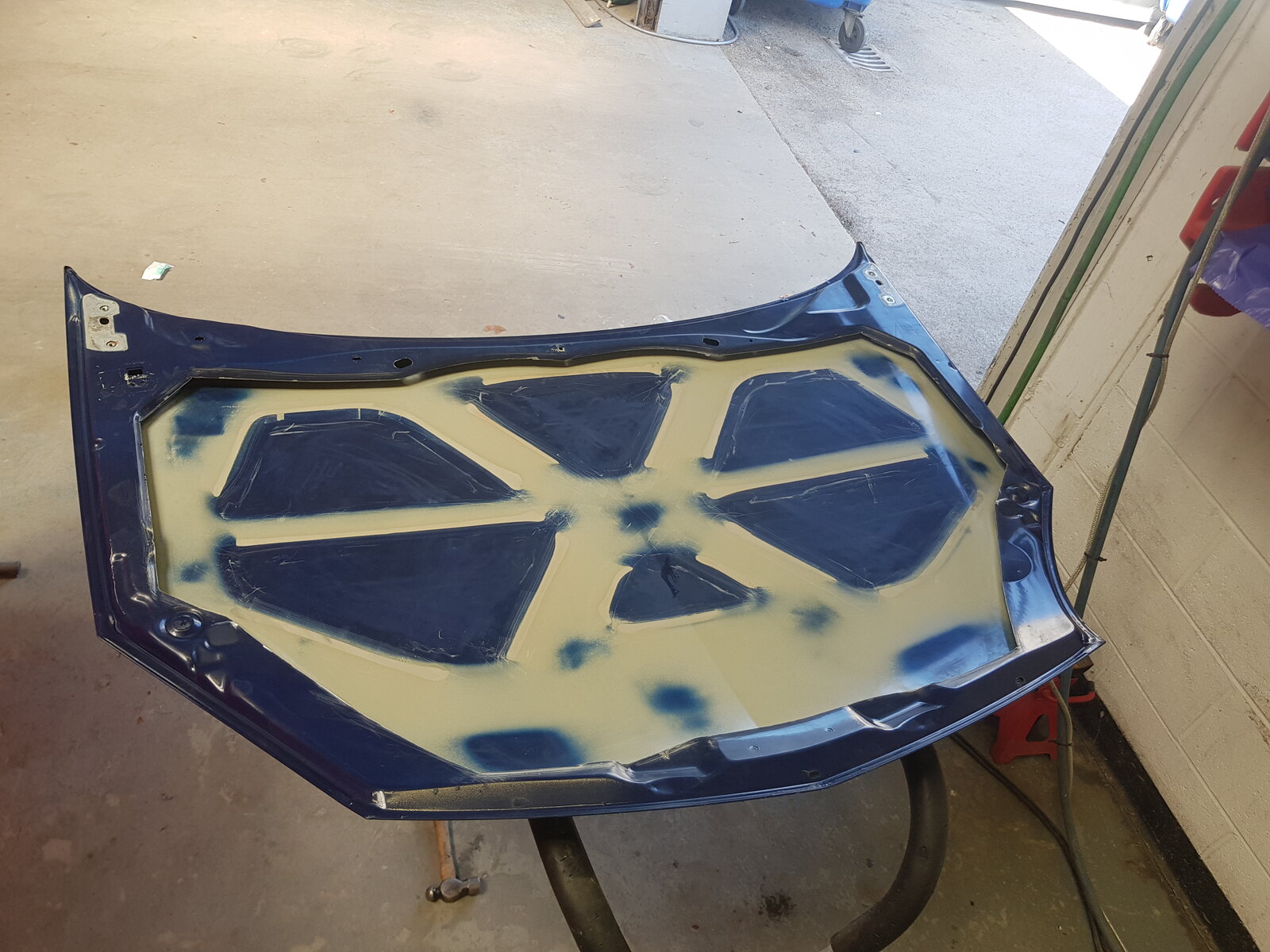

Bumper,bonnet and wings redone. Bonnet had all the insides cut out for lighter weight

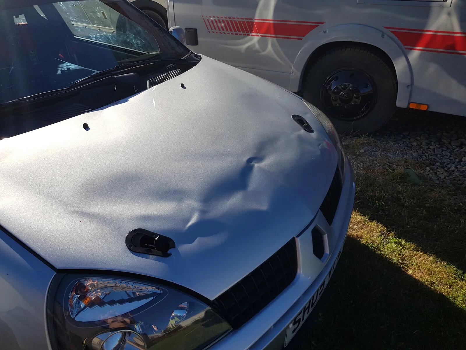

Some idiot didnt shut the bonnet clips
I was so gutted that I couldn't be arsed doing it all again so I just got my rubber mallet out and ruffed the bonnet out something like and left it.

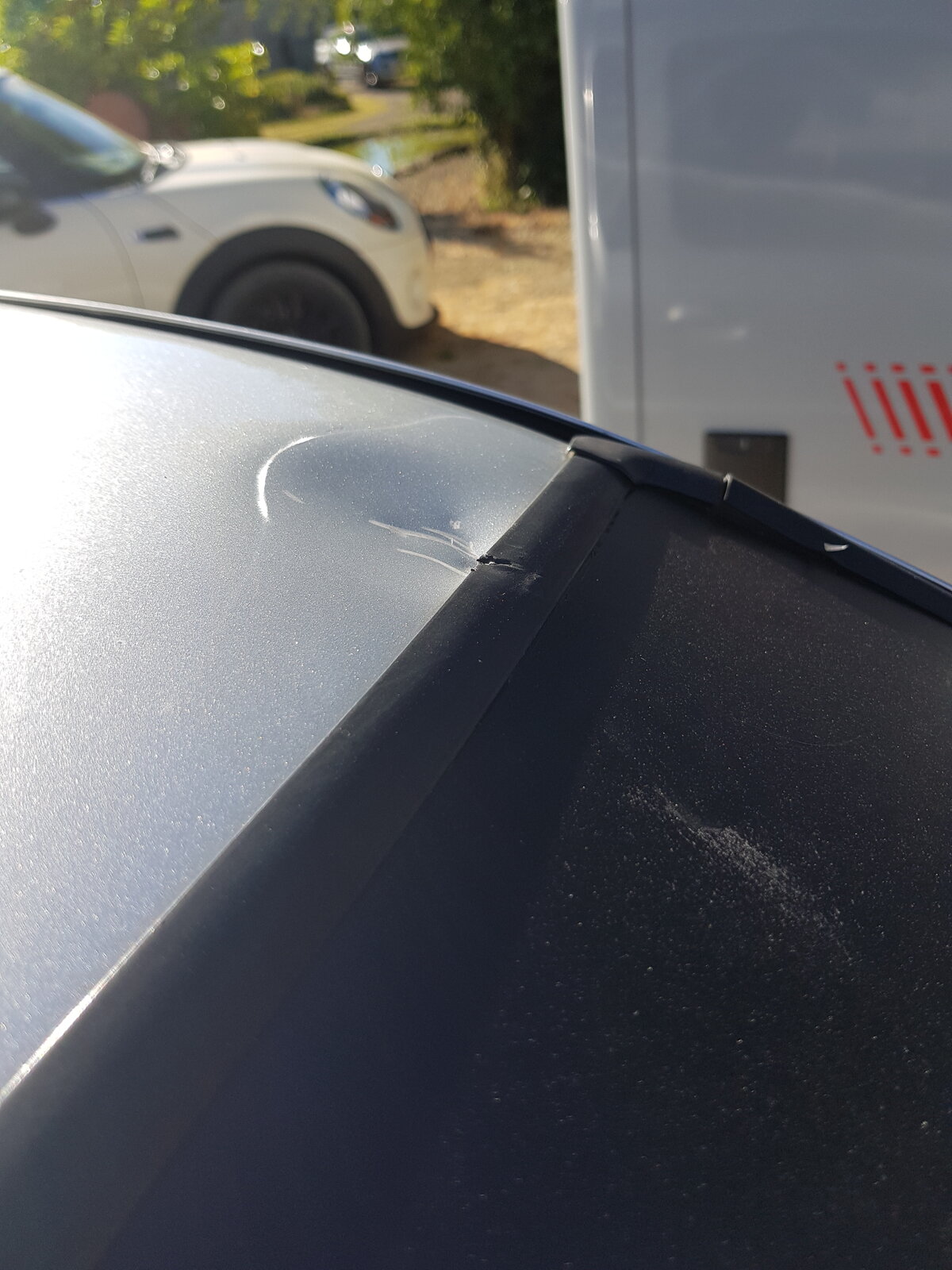

Buggered the roof and windscreen aswell
So I had to repair that before putting a new screen in

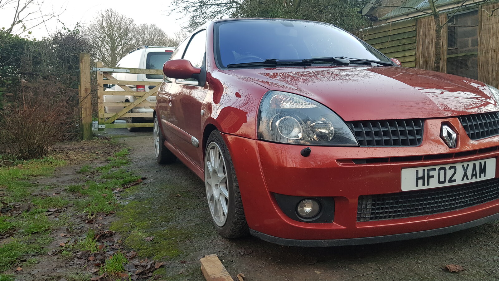

While we're on the subject, mine being flame red has faded, or matured as I like to call it, I've DA'd it and sealed but is there anything else I can do to bring some colour back? Will some waxes help with colour, I tried purple haze as I had it to hand
The sun naturally fades the pigment in the paint, newer stuff has UV protection in the lacquer. All you can do it polishes the lacquer to bring the shine back the wax it. You wont physically change the colour though.
