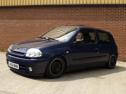

There does look to be a bit of a difference. Its probably due to the paint having been faded as Ph1's are getting on a bit now. That or he took the picture just after it was put on (So it hadn't been washed or polished all together)

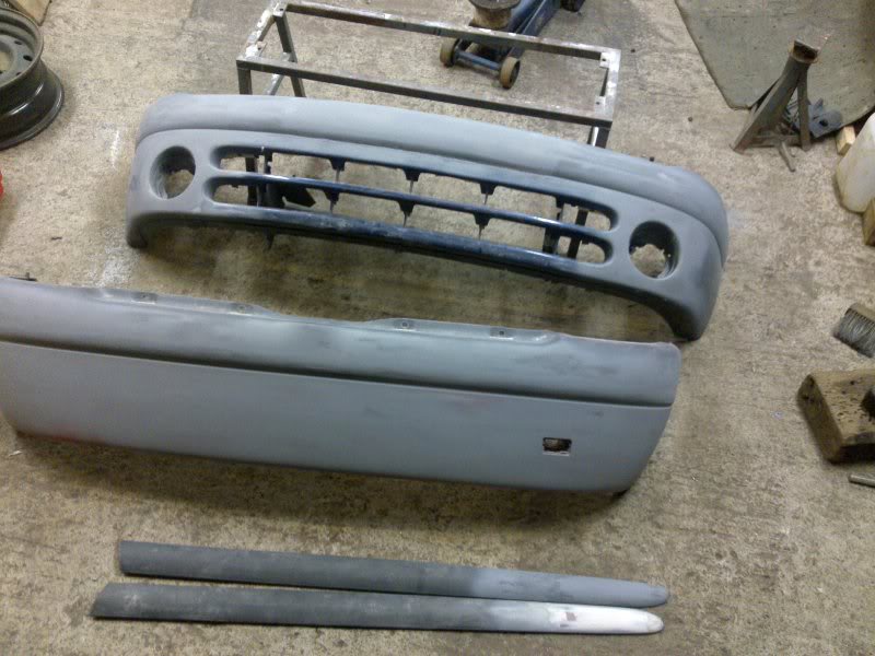

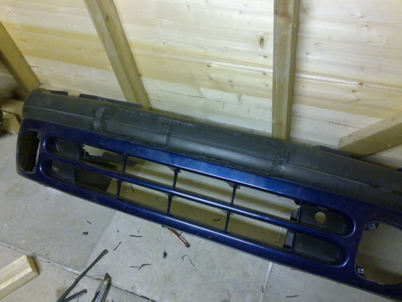

i smoothed mine out, cut out 2 sections of bumper off one at the scrappys, then used a soldering iron to melt it into the recess, fibreglassed over it then filled it...not on my car yet tho as they need painting
thats how they are the now and aint cracked with being moved around...yet :D haha

What do you mean?, ive just smoothed in the ordinary fog light surrounds into the bumper
ah dont worrh then. I just gave in and smoothed the fog lights.
But it all cracked when i bent the bumper to the shape of the car
