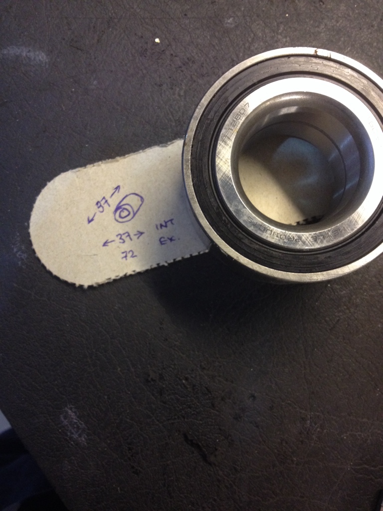

B barnesautos Car 172 Ph1 Aug 14, 2014 #1 Found this and wondered if it was a front bearing for my 172 phase 1 Anyone know if it is ?
J Jamie_P Car BLACK FF CLIO 182 Aug 14, 2014 #2 not too surw about the diameter myself but is there any part numbers on the bearing? maybe do a quick google search ans confirm with main dealer?
T treemanx Car Fiesta ST-2 Aug 14, 2014 #3 I can find out tomorrow if you haven't by then, I'm off work today.
Carbonraider ClioSport Club Member Car Raider, 172, the van Aug 14, 2014 #5 Looks like a rear although I could be wrong.

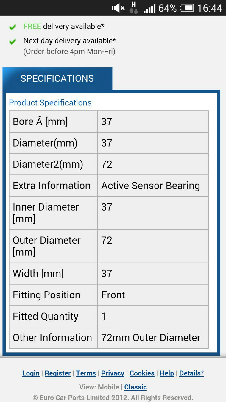

MWright Car Black one Aug 14, 2014 #6 Pretty sure that's a front, replaced mine albeit non sport with one same dimensions as above. ECP show dimensions so you can clarify. Edit : Based on a 1.2 16v
B barnesautos Car 172 Ph1 Aug 14, 2014 #7 Thanks for the info , but I'm not sure if the 1.2s run a smaller bearing . ? And that's whT I've supposedly got here .
MWright Car Black one Aug 14, 2014 #8 Try a RS reg and compare. There's a smaller one than the above for the fronts also, they're for 8v. Think rear disc bearings are 37mm x OD 52mm ID 25mm.
B barnesautos Car 172 Ph1 Aug 14, 2014 #9 Yes the smaller one would be for the 8v models . So maybe it's looking good then .
T treemanx Car Fiesta ST-2 Aug 27, 2014 #10 GB12807 the reference on the bearing is correct for a phase 1 172. Forgot about this thread, sorry. 37x72.04x37. Same as the 1.2 etc.
