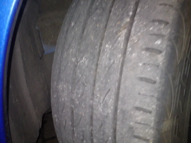

i have the same problem and have changed both wishbones and had it tracked up , i can almost gaurentee its the sub frame m8, i need to get on to, my driver side wheel sits 10mm back from the passenger side, this is what it did to my tyres after about a year, sorry for crappy pic, took it at night, the left hand tread is completly bold btw.

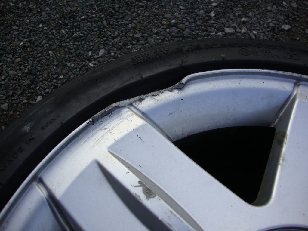

I can only imagine it's hit a kerb hard at some point, as to my horror when I checked the spare wheel out to put on the front whilst I had it on the lift, as my tyre is pretty low, I found this....
So I reckon therein lies the answer!

ffs, hit a curb hard for sure.......

nice, save some money then, well mine is bearable, apart from the wear on the tyres, mine is sat 10mm back from the passenger side, went to local breakers for one,........ ended up coming out with brembo max disks, ktec braided lines and ferodo ds2500 pads, all as new for 100 squids:D there was a subframe aswell but couldnt let anyone beat me on the brakes, getting the subframe this wknd coming for 150 so not to bad, wish i lived a little closer as could do with help fitting mine:( ah well
