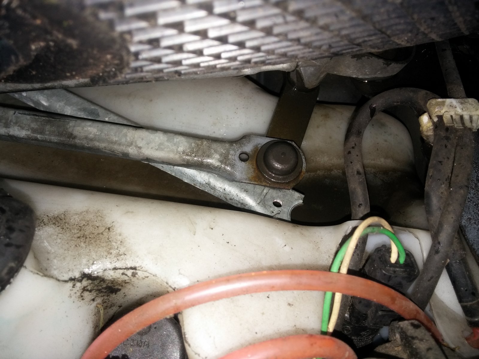

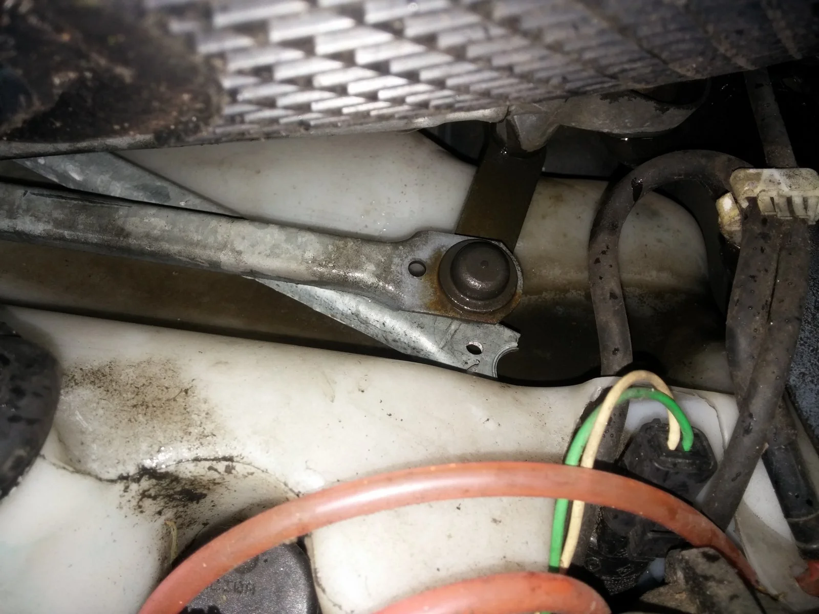

I was just driving the car in the rain then they stopped just like that, then a burning smell followed.
I have pulled over and turning everything off, tried the wipers after 10mins and nothing.
I lifted the bonnet and scuttle panel to see this, not sure but it looks knackered
I am supposed to go away on Friday in it:confused:

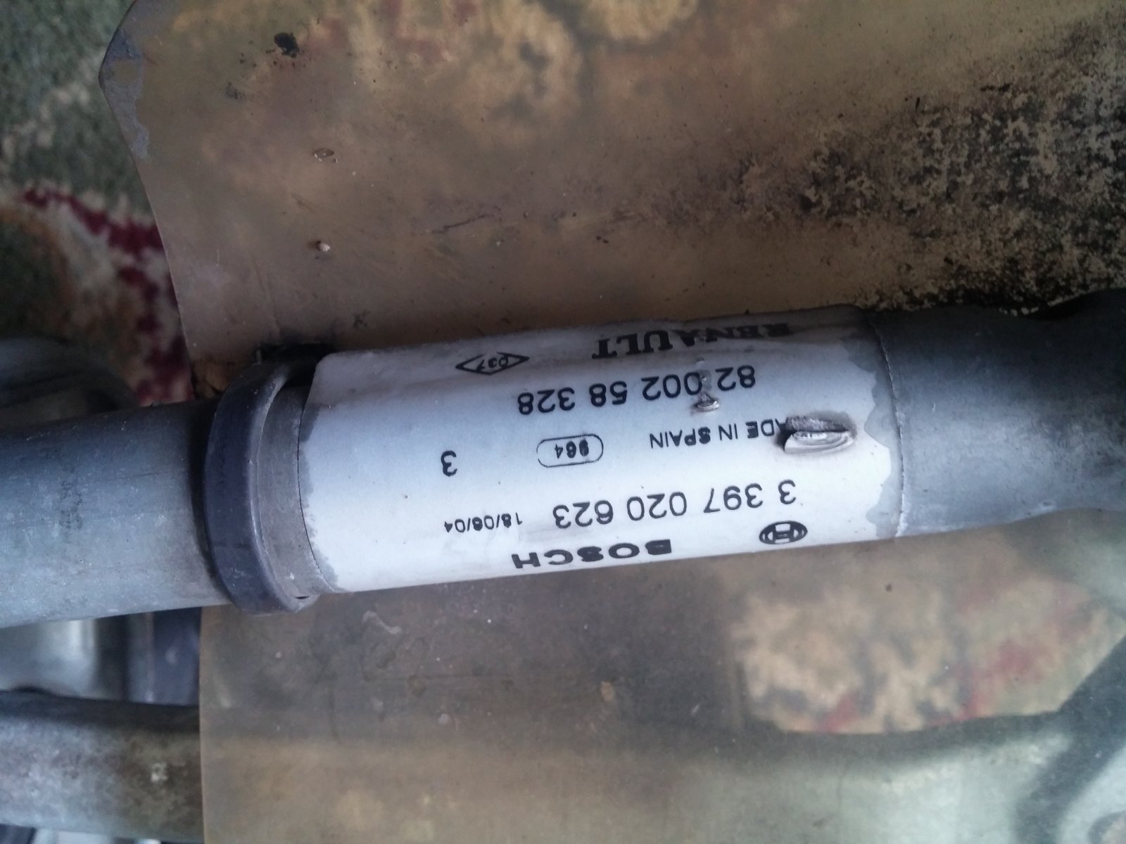

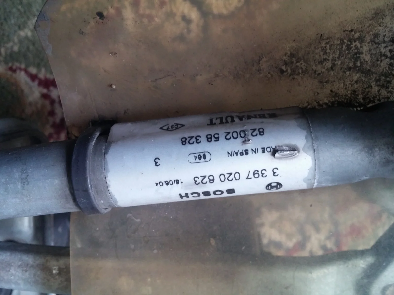

Ive just took mine out but the numbers on the little white sticker are not the same as what he's gave me.
Mine says this

Should still work even if the part number is different mate.
It's only the motor connections that vary and that can be easily sorted like i said by swapping the motor over.

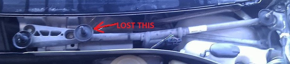

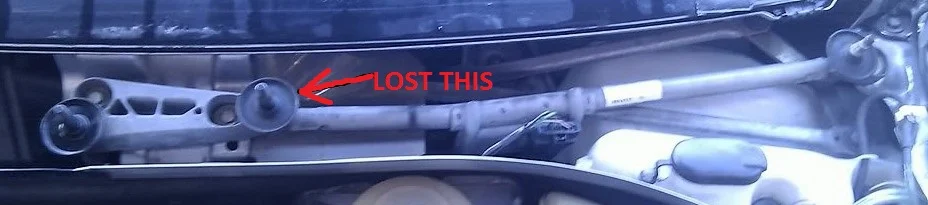

Yep I dd thanks to Darren S mentioning it, cheers pal!
This is what went awol, guessing it's not vital
Leo182
  Blk/Gld 182 Cupped
Just stops water over time i guess. Probably want to replace it at some point, or just another linkage if it fails again 😂
