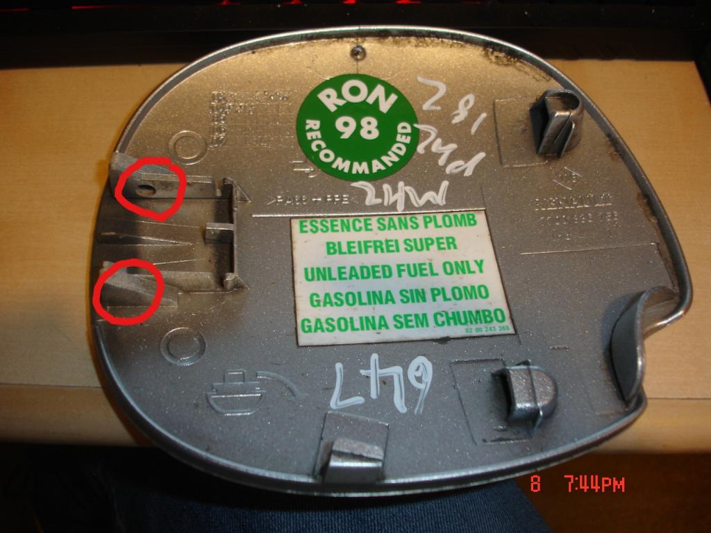

Is it possible to remove just the flap itself, rather than getting behind the arch liner to remove the nuts that will most likely snap anyway?
Gently prize it out from where i've marked it on the pic?
Got it off :approve:.
For those that don't know, open flap, pull flap towards you then gently prise where its circled red above, bottom first as its slightly chamfered there. To refit just put the top bit in first, then the bottom chamfered bit.
