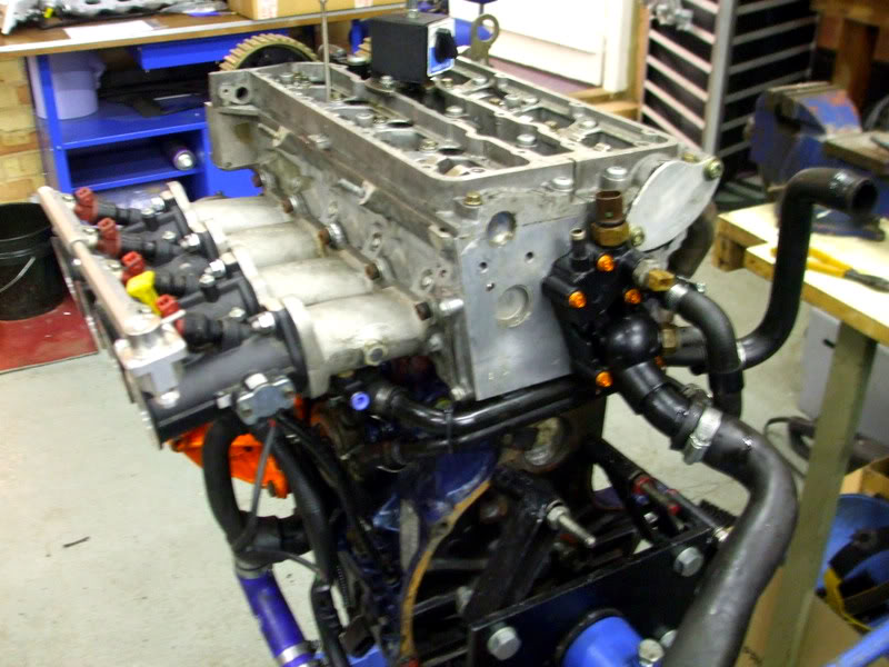

i live between Peterborough and Cambridge, my clio has itb's cat cams 421's, k tec gen 90 ecu and ali race fuel tank and swirl pot with after market efi pump, i need to get hold of a fuel pressure regulator ASAP (ideally tomorrow) any ideas?
your choices are either to find a ph1 fuel rail with the regulator built in, or buy something like a weber 3bar FPR. Avoid adjustable regulators like the FSE boost valve as they're not very stable.
The slightly more expensive option, is to buy a clio specific jenvey fuel rail, with an FPR adaptor screwed on the end of it, and use braided fuel hose and proper fittings.
something like this.....
cheers, i have a phs 1 rail with return take off to tank, i have a cheap adjustable fuel pressure regulator on it atm, but its shite, so non adjustable is the way to go? does it want to be 3.5 bar at idle?
