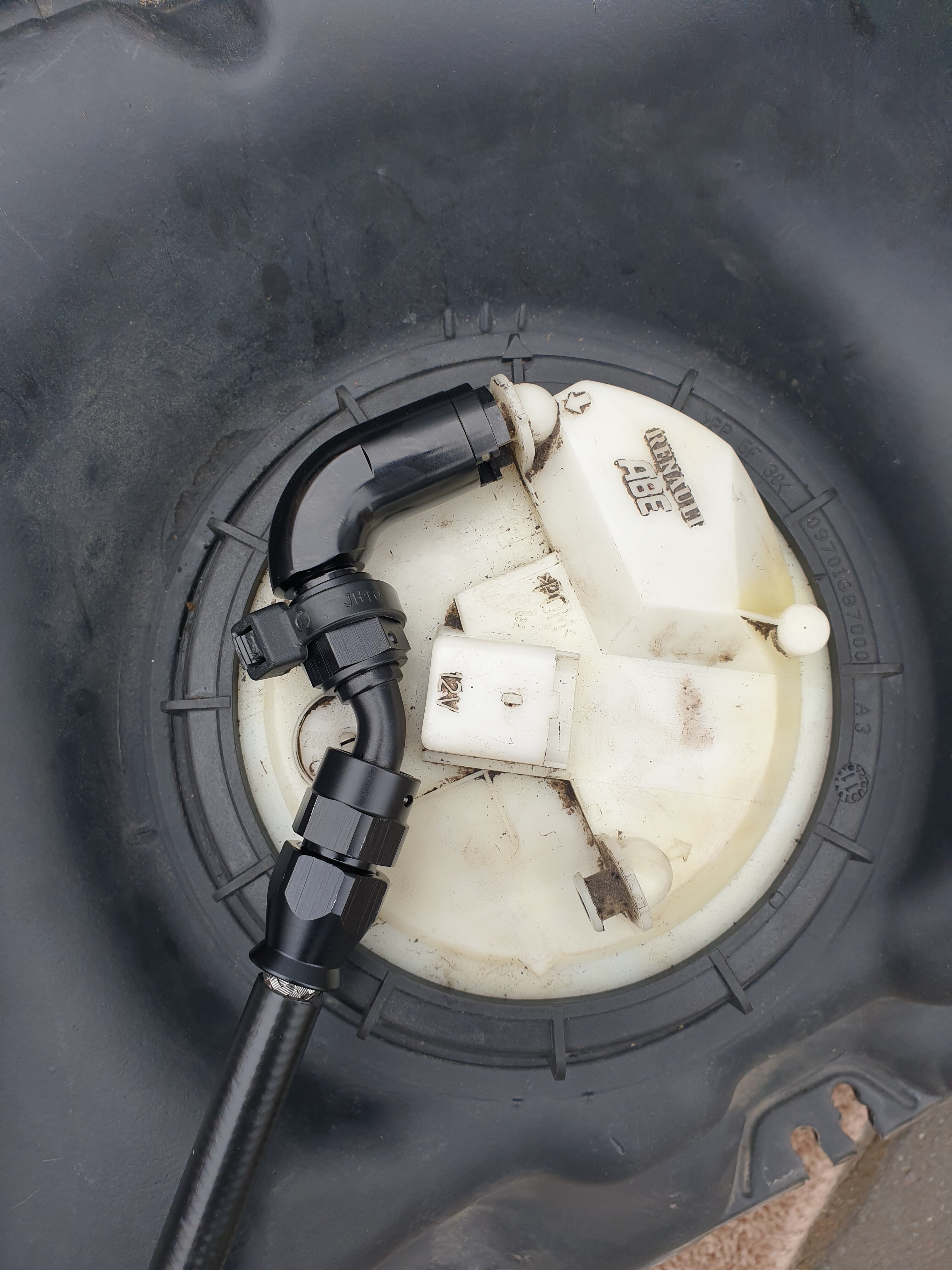

On my Kangoo im running a torques an6 quick fit connector on the tank sender outlet pipe and ptfe braided fuel lines. Something has gone a miss and its started leaking a bit which means dropping the tank to find out the issue as no access hatch :cautious:
Not sure if the fitting has moved a bit and cracked the sender outlet pipe, i was a bit concerned this could happen so added a joint under the tank to relieve stress.
Has anybody run the same fittings on a plastic sender and had issues? Im not sure whether to bin it and go back to a normal fitting, due to its location and not easy to access once the tank is fitted. Any ideas or better solutions ?
I get the feeling that a cobbled together rubber hose combo would have worked but pikey, go for the expensive option and it leaks :cautious: :LOL:
Half considering making a steel pipe up so perfect route around tank as i think the an pipe is pulling on the fitting slightly making one of the o rings not seal properly. Will pull the tank and test it all to see whats going on. Bring on fuel pissing all over me taking the tank off

Will drop tank in the next couple of days and report back. Will run the pump when tank is dropped to find the issue. Hopefully find a bullet proof solution, as im gearing it up for a 250 550kpa in tank regulator.
If all else fails ill run a 250 high pressure fuel line and join the an pipe up an the front quick connect.

Dropped tank and could not find any leaks with pump primed off the ignition a few times and seemed to be holding pressure. No issues with the fitting on the sender outlet - its a very good tight fit and a lot better fit than the oem fuel pipe.
I eventually found the leak after nipping one lf the an fittings up.
I had reused an old ptfe fitting with a new insert fitted, and for some reason there was a slight mismatch and the insert had cut into the ptfe liner slightly, and when nipping it up it turned into a gusher.
This is a new one to me as ive made loads of fuel and oil hoses in ptfe over the years and not had a single issue (tested some previous fuel hoses to 9bar and no bother)
Very hard to see with stainless overbraid until stripped down. Drop kicked that fitting into the bin, new one fitted and remade the full line with a better combination of new fittings, job done.
