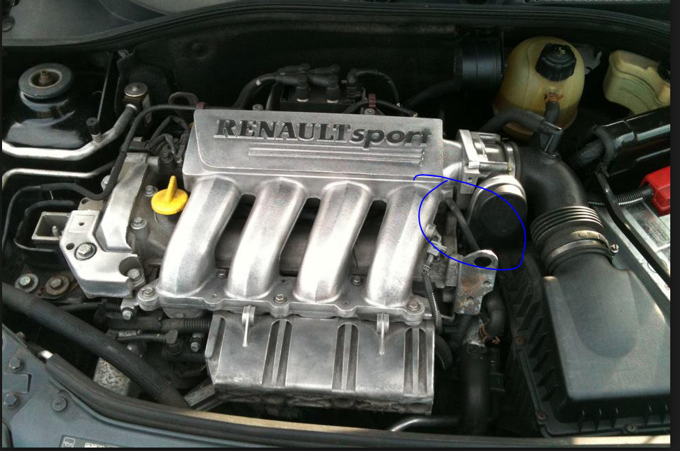

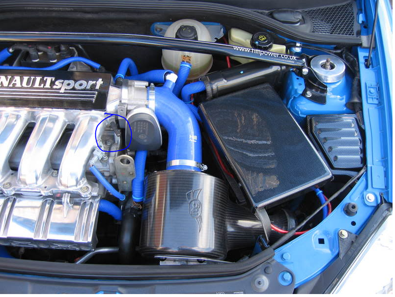

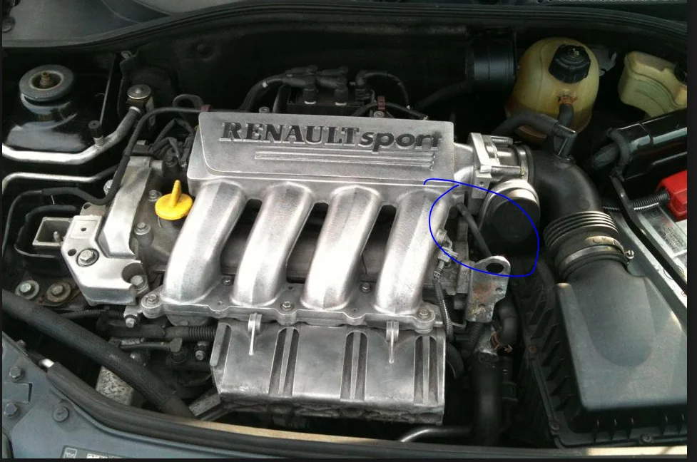

Quick question,
My phase 1 has this thing blocked,
My phase 1 facelift has a tube going from it,
when the car is on, it pushes air out from this
(images pulled from the web)

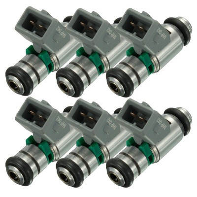

Injectors replaced,
Not that.

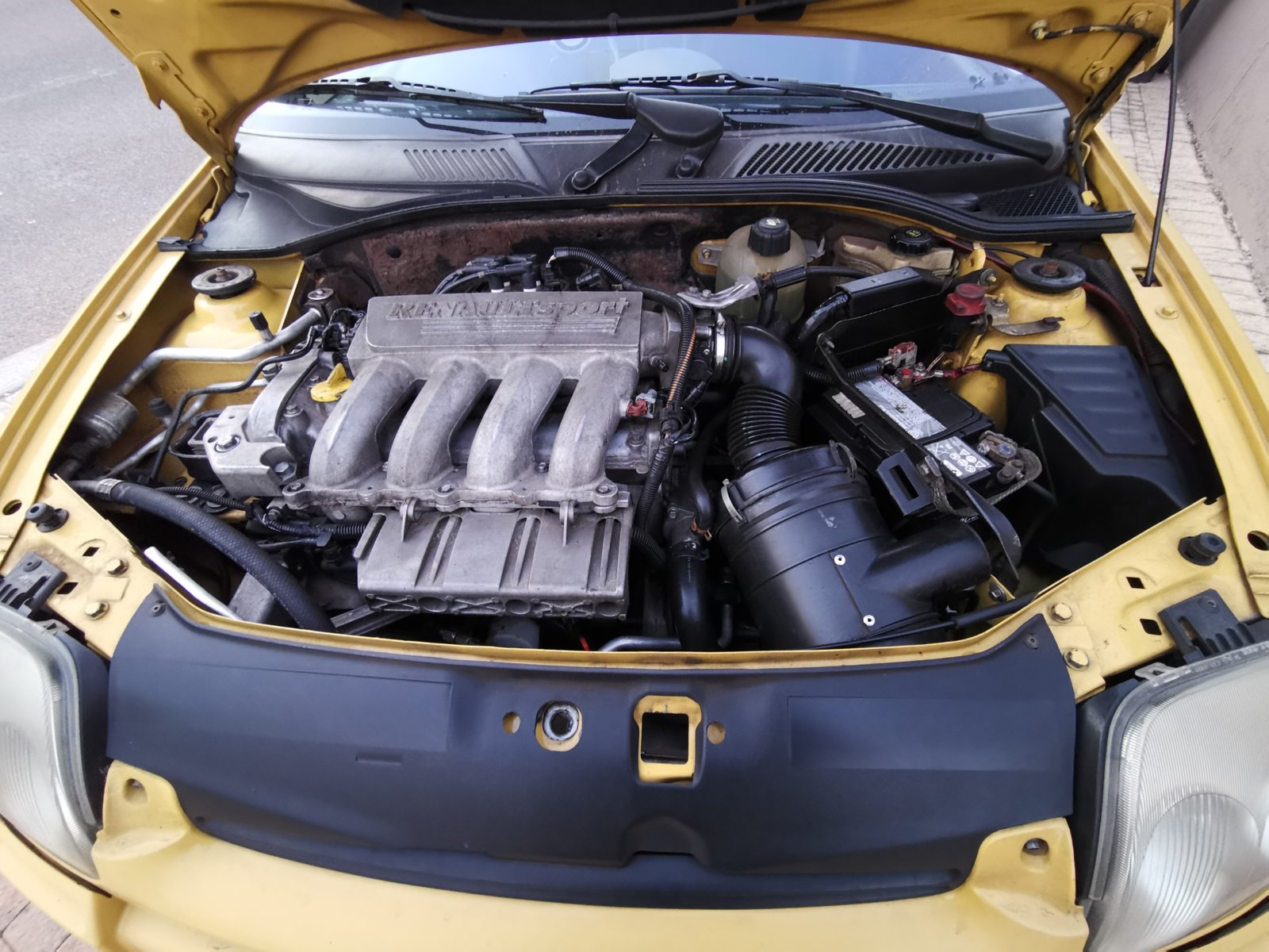

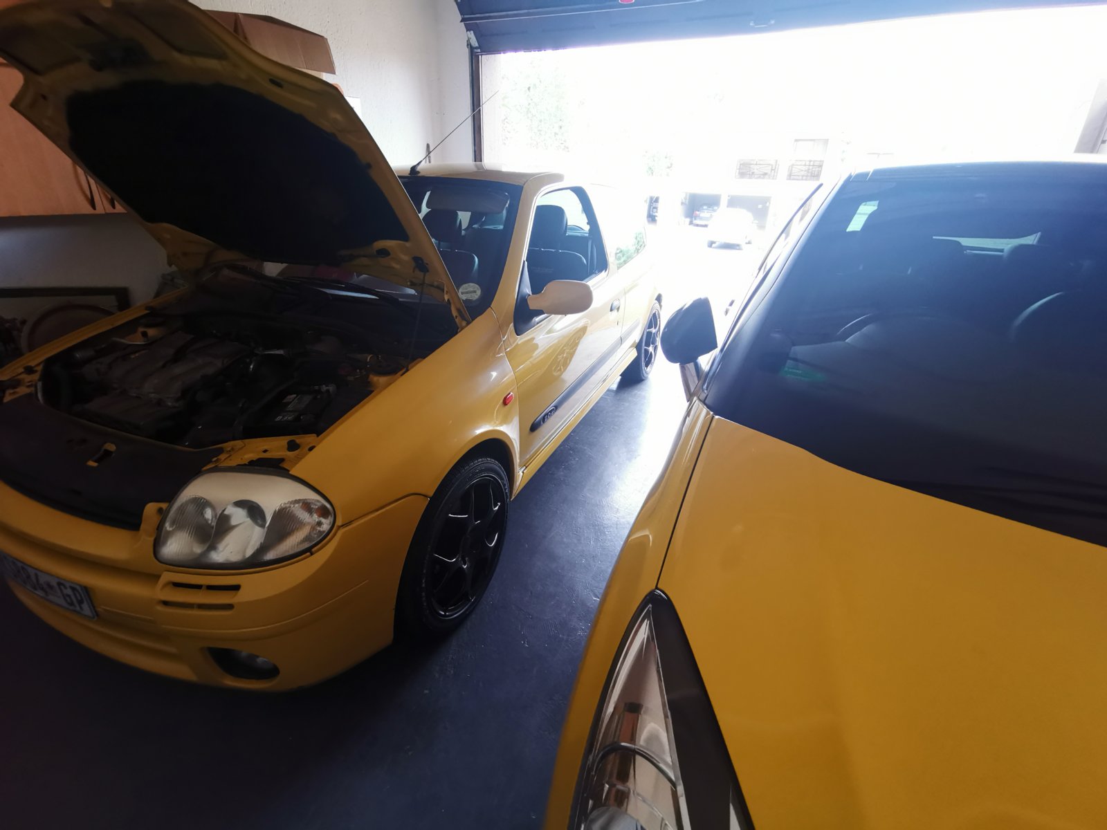

Hey all
Decided to put some pics up :)
Car has been a nightmare lately, it drives but driving me up the wall with this nonsense.
Its a 2001 model with 156k km on the clock.
Hasnt had a clean in a month or so though, mostly been in shop or i've been working on it.
Lots of paint work n some dents to sort still, but need to get it driving right before going onto that
