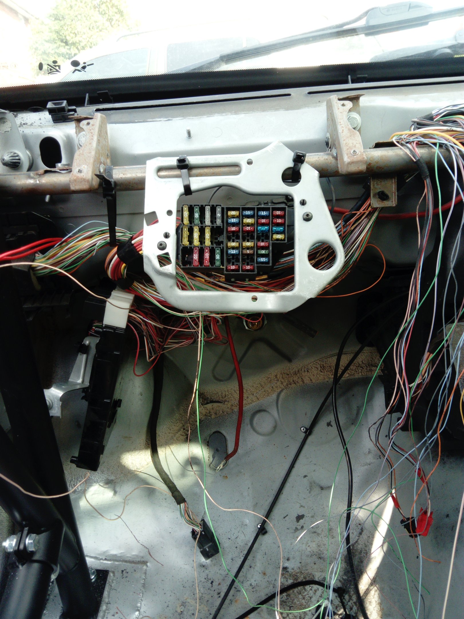

Hey Guys,
So im setting about fitting my cage in the clio and Iv got to move the fusebox and possibly the UCH, has anyone got any pics of where they have mounted there fusebox? (iv had a good google/google images search) im sure I seen one that was where the passanger heater vent used to be?
Thanks in advance
This was still at a work in progress stage, fuse box plate has now been welded to dash support, uch bracket has been turned around and bent/manipulated to allow uch to sit upright, also clips in the other way around to normal
Obviously this only works if you'e not re using the lower dash
Thats an awesome idea thanks bud appreciate it. Don’t suppose i could be a cheeky git and ask for a closer pic of the UCH bracket. Theres hardly any info anywhere about rollcage/fuse box/UCH So would be good to have some pics for future people...also would help me out:innocent:
Apologies for the delay mate, been away with work the last few weeks. Will get some for you asap if you're still in need
