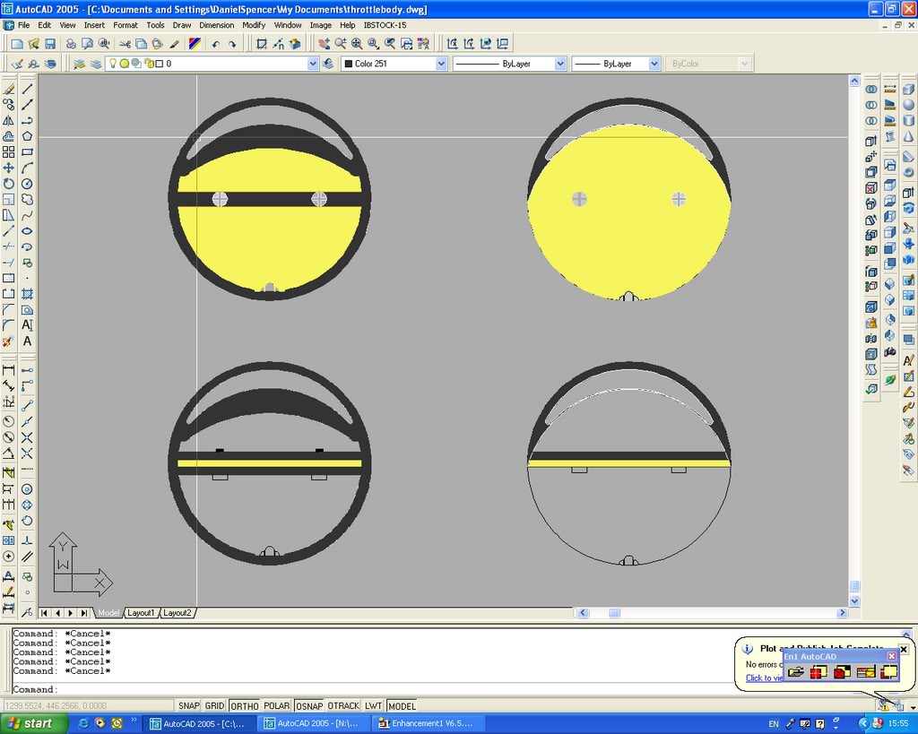

This is a common mod on the VTS and GTi's but thats because the TB is a weird shape and intrudes into the cylinder of the butterfly. The Clio body isnt restriced by any casting so the size of the butterfly is pretty much fluent throughout the length of it.
I'll get a pic of the VTS body to show what I mean....
M
mini-valver
On the left is how the throttle body is standard, the grey area is casting that protrudes in front of the butterfly. On the right, is a ported one, where the casting is removed...
