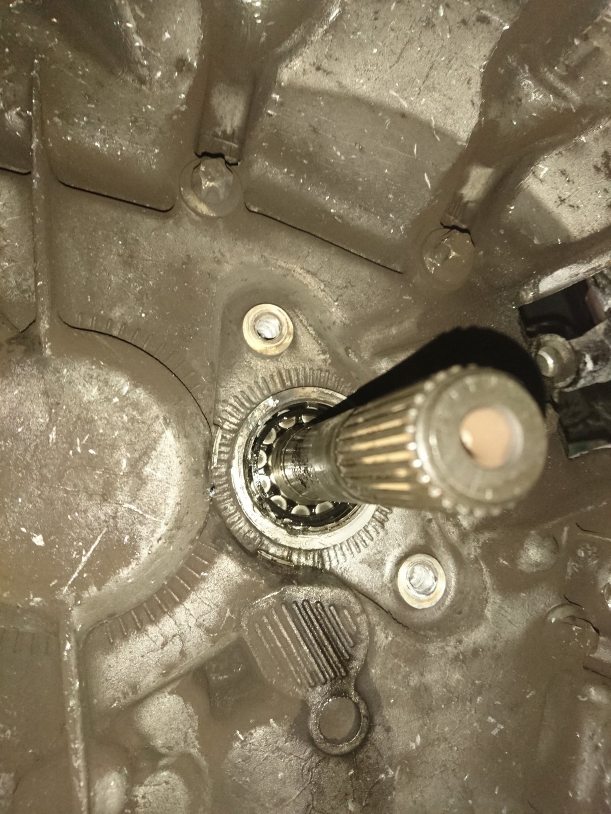

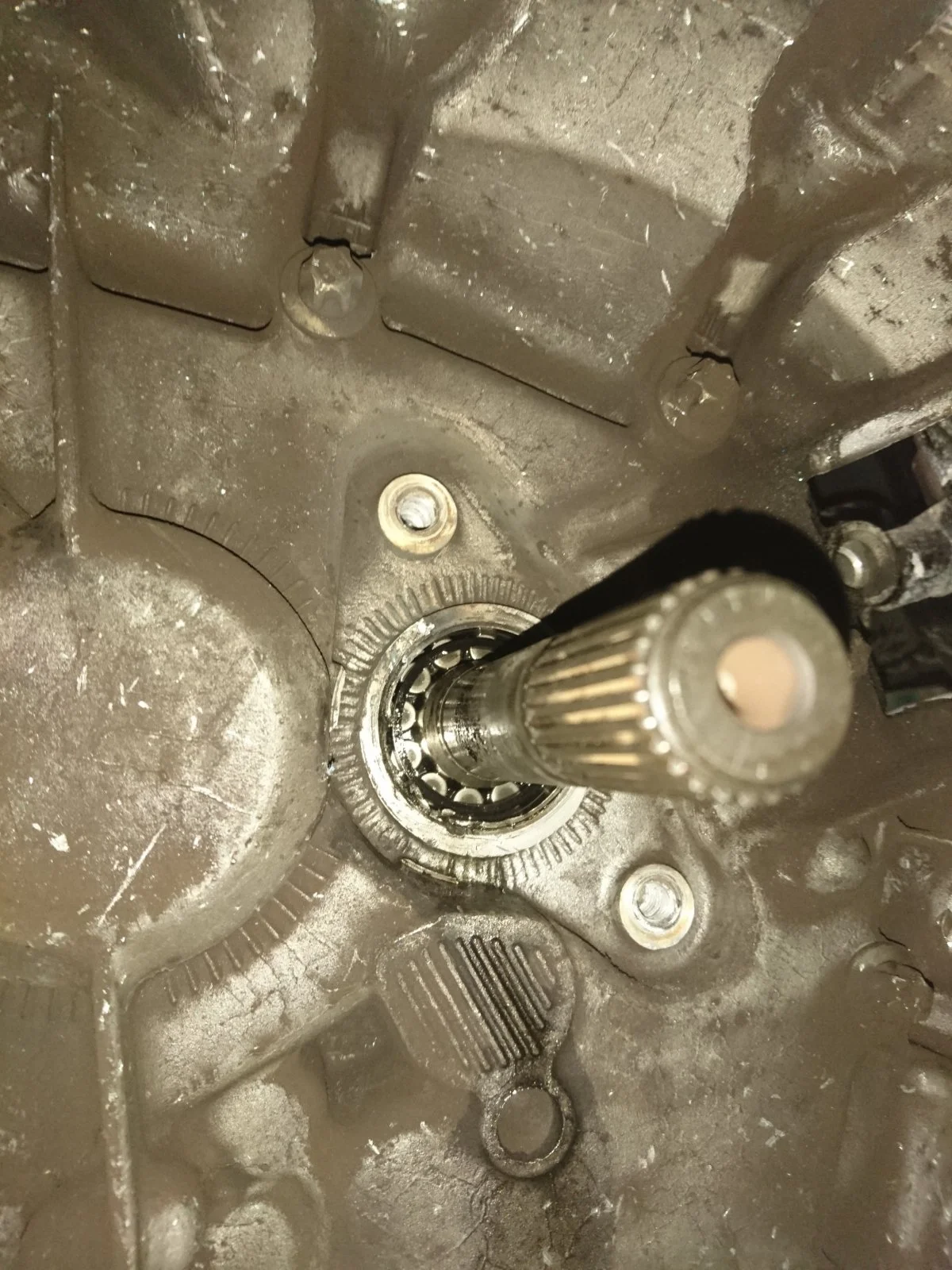

  Clio Sport 182

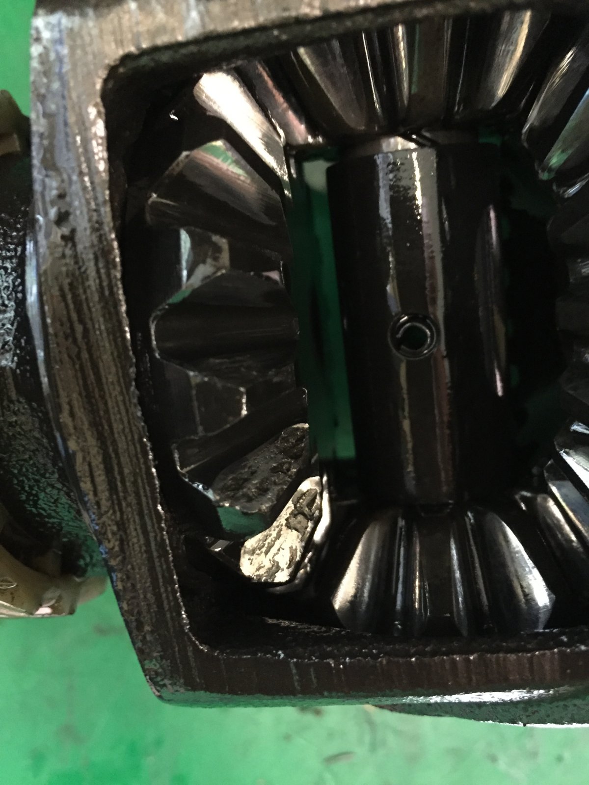

The jc5's are a bit tricky tbh mate and you'll also need some pullers - one of which needs to have very thin jaws to pull the 5th gear off the shaft, the other needs to be an internal bearing puller. You may as well look in the diff as well mate, as I'm seeing a lot that are fucked now internally.
As can be seen here!

The jc5's are a bit tricky tbh mate and you'll also need some pullers - one of which needs to have very thin jaws to pull the 5th gear off the shaft, the other needs to be an internal bearing puller. You may as well look in the diff as well mate, as I'm seeing a lot that are fucked now internally. View attachment 181133As can be seen here!
