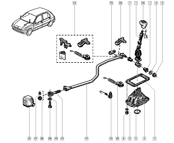

So I had a short trip earlier and had stoped with the car running for about 10 seconds then when I pulled away I think I got into first but when I went to second it didnt go in (the engine just revved), so I pulled in and the gearstick wouldnt go into any gear and would just flop around. There was no wierd sounds or anything so maybe it is a linkage?:S
so i was wondering if anyone has any idea's on what this could be,the car is a 2000 1.2 with amost 170000 miles
Thanks:)
When mine did the sale it was the bolt hat connects the linkage to the pivot bar,
No 20 here:
Thanks for the reply's;), It was the fork to blame:dead: atleast it was a quick and easy fix
