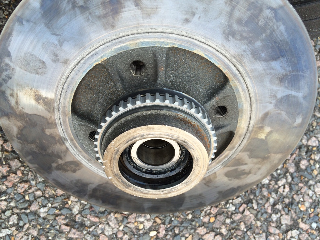

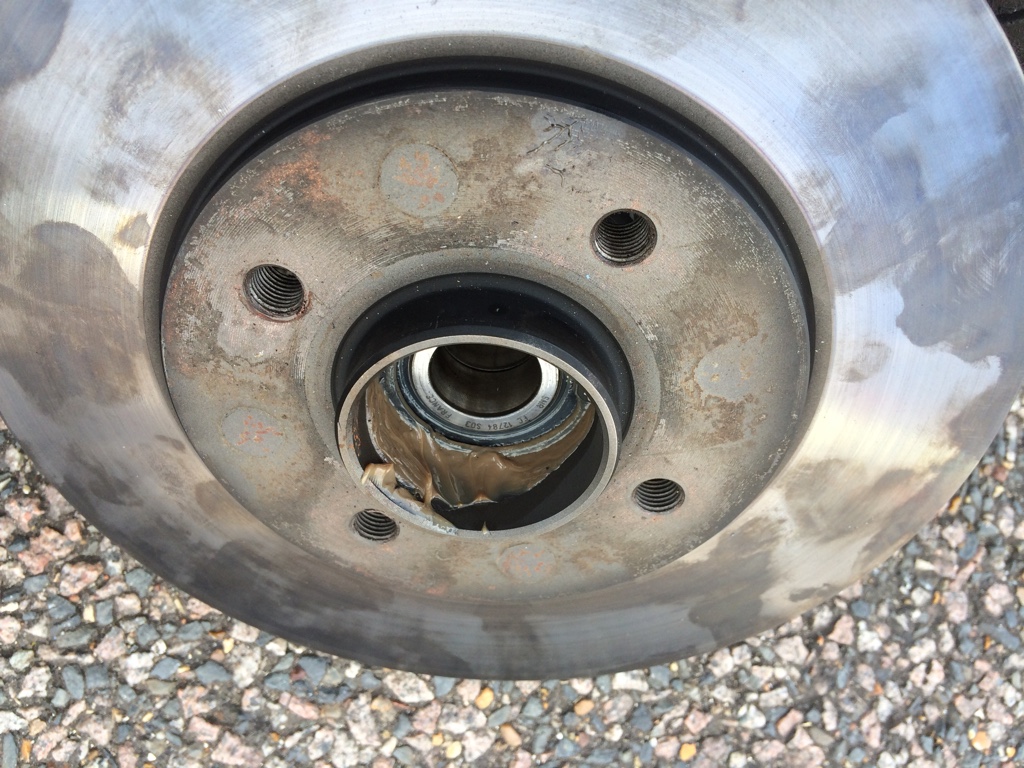

Literally fitted these, drove to track and did a 20 minute session and this happened, it's so broke the wheel doesn't even turn freely.
Genuine discs from Renault parts uk FYI.
Could this be caused by fitment? I have the spacer present and in the correct way!
I did yes. The other side is totally fine annoyingly. The misses is currently going to to get me some replacements so I can go out for the afternoon at least.

Was the tapered ring definitely the right way around? :smile:
Yup 100% :smile: If it wasn't it would be cracked, which it wasn't thank god. Yes it was the offside, it lasted a few laps of Snet... although I would have thought it would have been the near side being that most of Snet is hard right handers?!

Well I have a single spare to carry with me now, I torqued up the replacements to 175nm and the other bearing (the near side) is now seeping abit of very dark grease, although its fine and might be normal with hard use, not nothing ive paid attention to before now.

What bearings would people suggest I replace the broken one with? I doubt Renault will replace them and being as the disc is brand new its pointless binning them.

SNR make the bearings in genuine discs IIRC.
...Although if they've failed already they may not be the best to go for lol.
Well I'm assuming it wasn't user fitment error but surely even a badly torqued hub nut wouldn't cause the extreme quick failure I had?! Who knows.

I think FAG, SKF and SNR are generally considered good wheel bearing brands. I think I can see SNR on the bearing in the first pic.
Might be worth replacing the spacer/washer/thingy in case it's damaged/deformed and the hub nut for good measure as well. Might be worth using a different torque wrench too, though you'd expect yours would need to be a long way out for it to have caused this and not ruined the other side as well. Wonder if it could also be heat related if your rear caliper is sticking for example?
