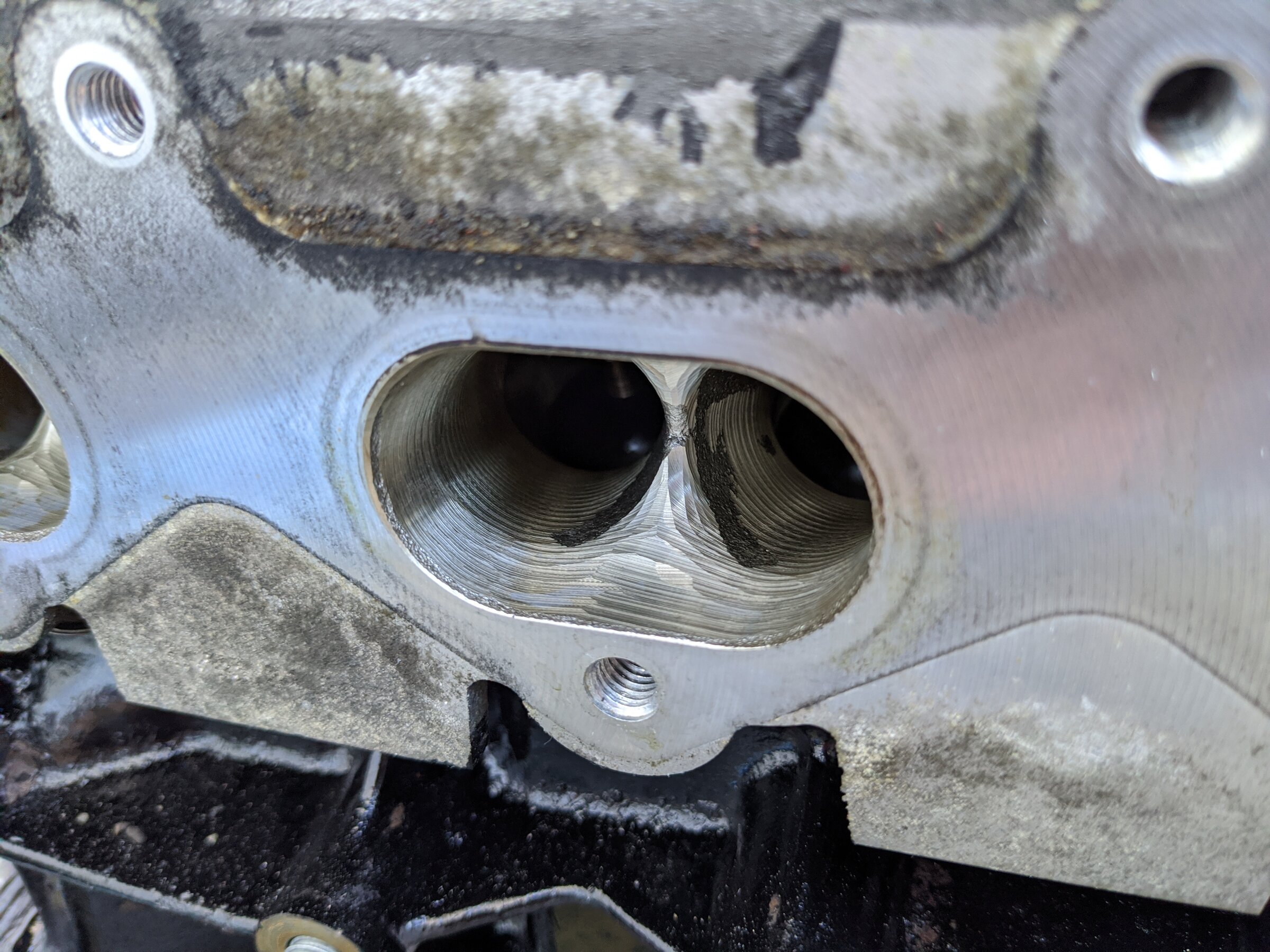

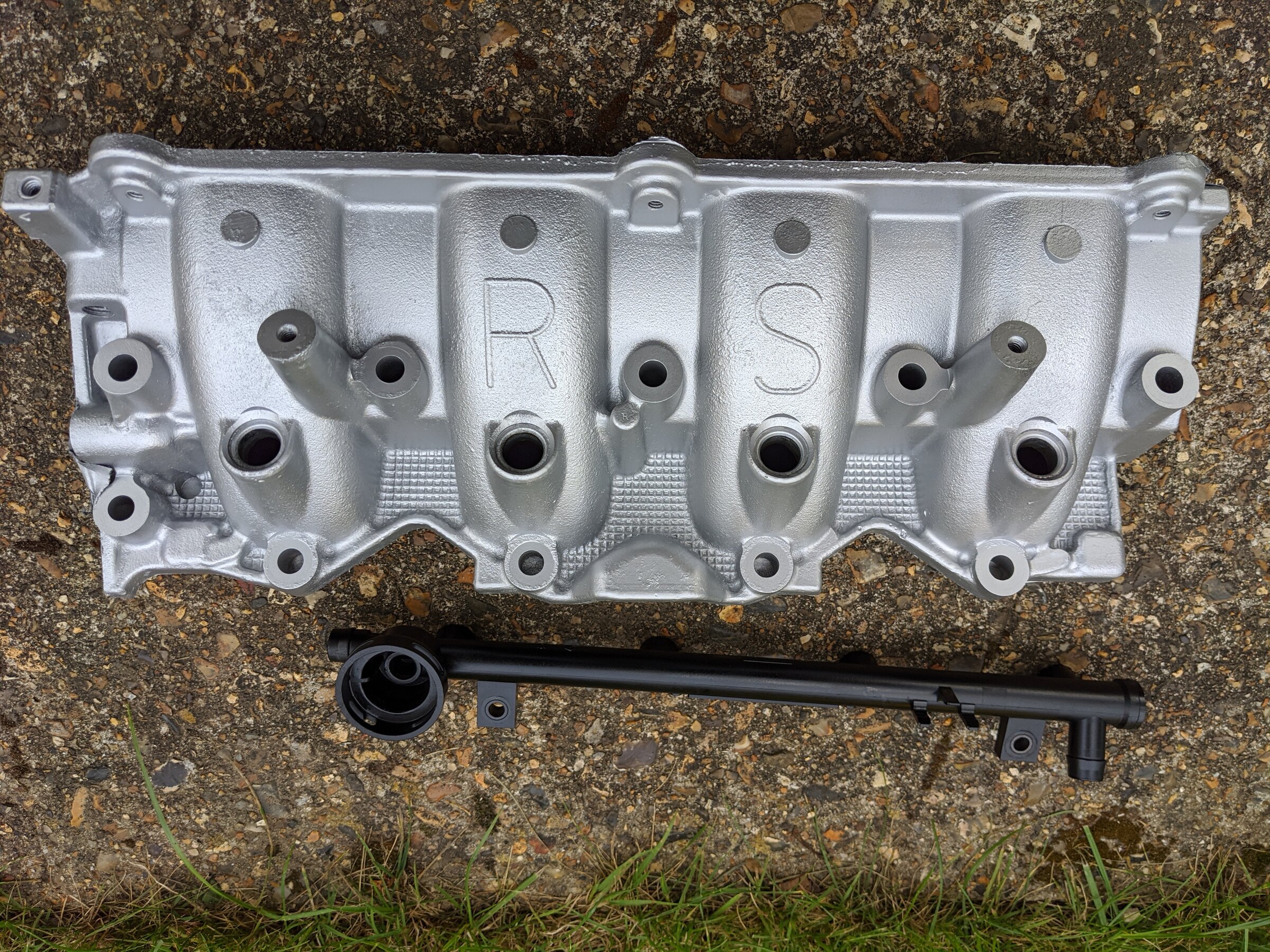

Also can anyone tell me if these 182's came with a ported inlet as standard? As I removed the inlet I was surprised to see the ported have as rough a finish as they have. Pictures to follow 👍

From memory the inlet manifold runners have a cast finish while the inlets ports on the head have a CNC finish, not much point in smoothing them tbh. If the inlet is stamped RS then the match is better, mine was pretty good (not sure if there is anything else different about them though.

Ah right. I have the same as you re the RS stamped manifold. I thought it a little strange to see a non cast finish in the ports.
