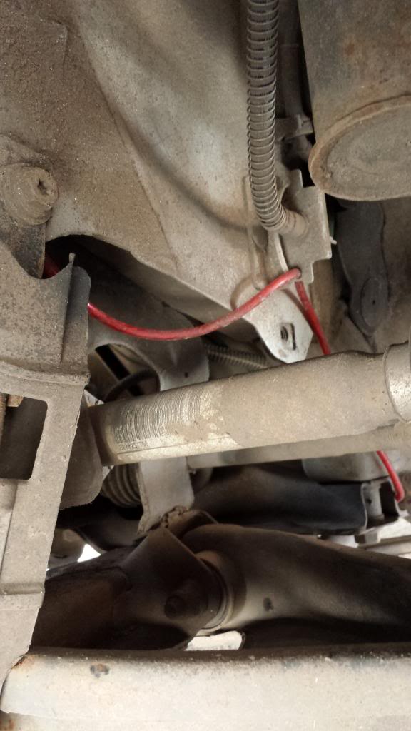

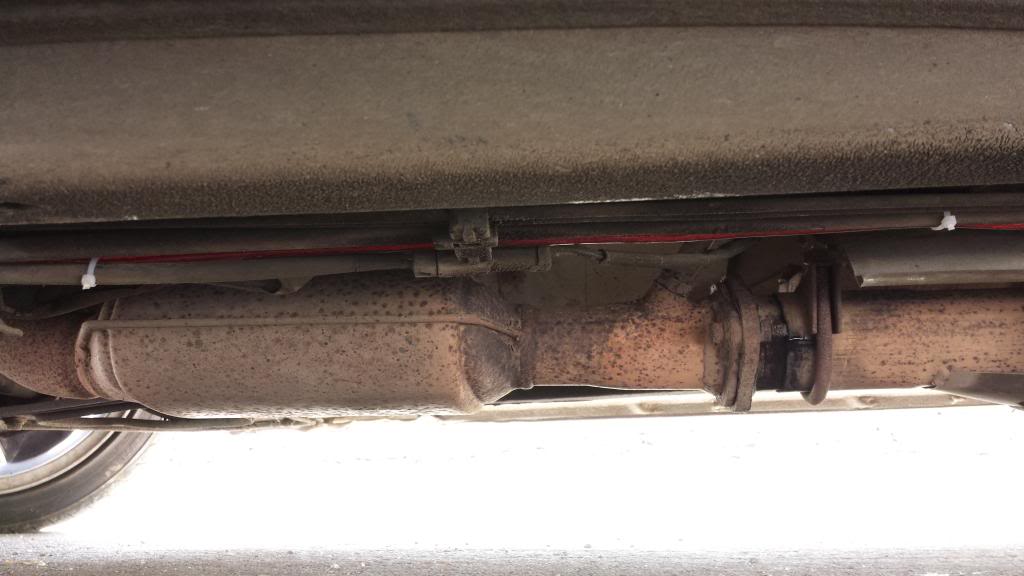

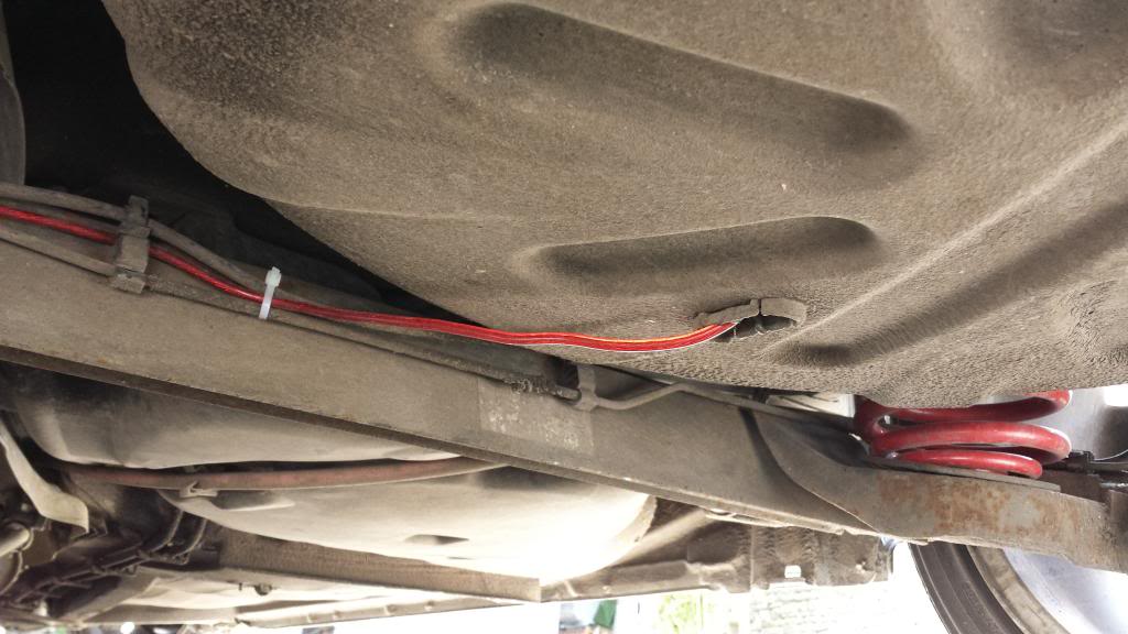

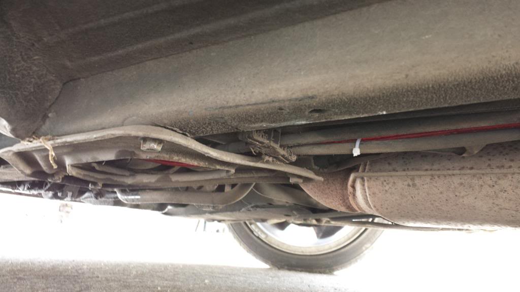

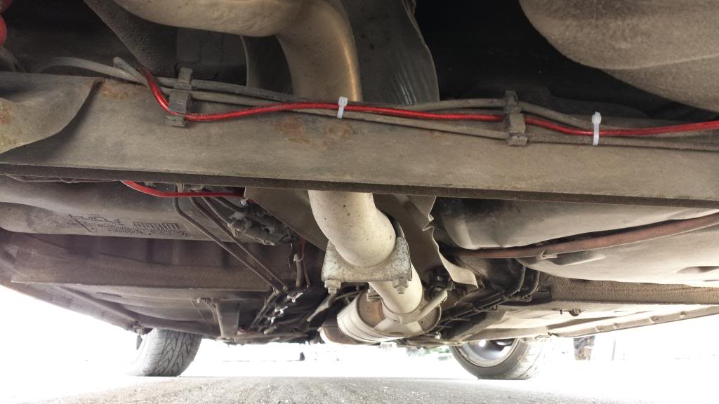

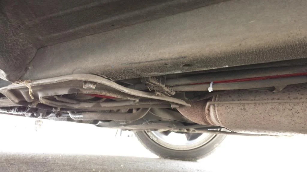

I run mine from the battery, dropped it to the under-tray, through the front of the passenger side wheel arch, cable-tied it neatly around the base of the damper, and then followed some pipes down the underside of the car, being very careful to keep it out the way of any moving components Then once at the spare wheel well, I made a small hole in the grommet and up into the boot.
Easiest and neatest way IMO :)
I'll get some pics now...
  180.5 bhp 172
As mentioned above, over the drive shaft (I used the clip that is there as you can see), and basically work it down the underside (I used the spare pipe clips that seem to be there for some reason..!), up through the plug in the bottom of the wheel-well and into the boot.
***On the rear, make sure you leave enough slack for the suspension to operate freely without snapping your cable***
Hope this helps!
