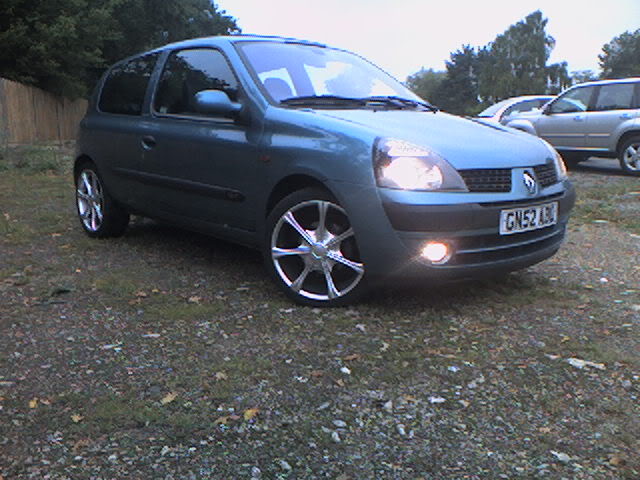

Heres a Pic, not the best angle and its bit old, have clear side repeaters and a few other bits and pieces now. would go take a new picture, but the wheels arent on the car at the mo.
How low should i go guys?
o yer, b4 u say, i dont drive with the fogs on!!
  Golf GTI 1.8T
how comes the wheels arent on the car atm? dont look too bad actually, will look nice with 60mm drop, they will sit in the arch nicely. :)

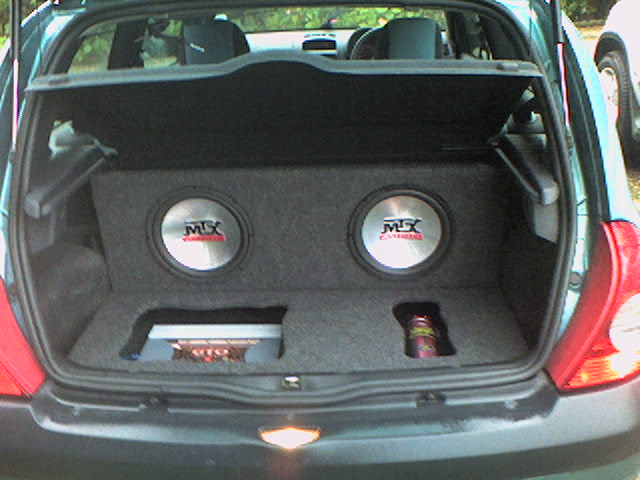

cheers John, Built it all myself, Took 2 days lol
Never Realised MTX sounded so good until i powered them up!
