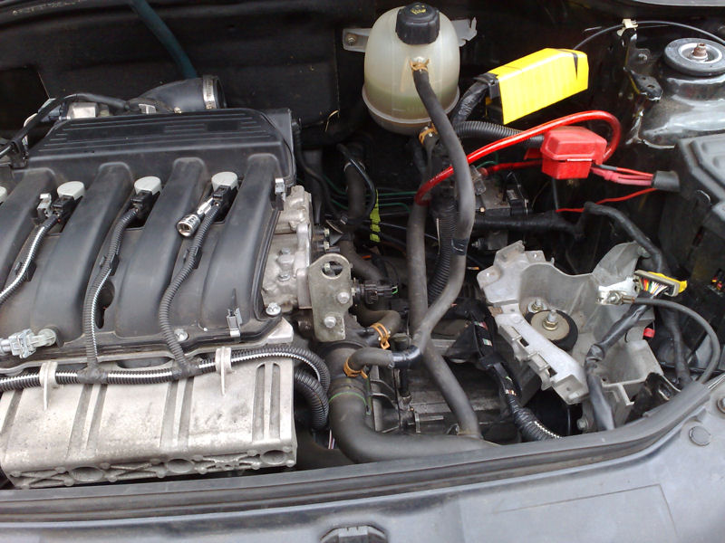

Prepping for box out for the second time since i've had this one :dapprove:. Looks to be a failed release bearing or friction plate in the clute yay. Well at least I haven't got to rebuild the gearbox this time.
Well it'll keep me entertained I guess :dapprove:.

Its not that bad a job really once you've got all the other shite out the way to let you get the box off. Trouble is theres loads of shite in the way lol.
Just waiting for a hand to drop the subframe now, lovely.

Got rained off for most of today fecking weather :dapprove:. Still, managed to pick up all the bits I need and get the new clutch in and the box back on.
Well I now have silky smooth and rather lighter than before clutch action so heres hoping it'll work.
