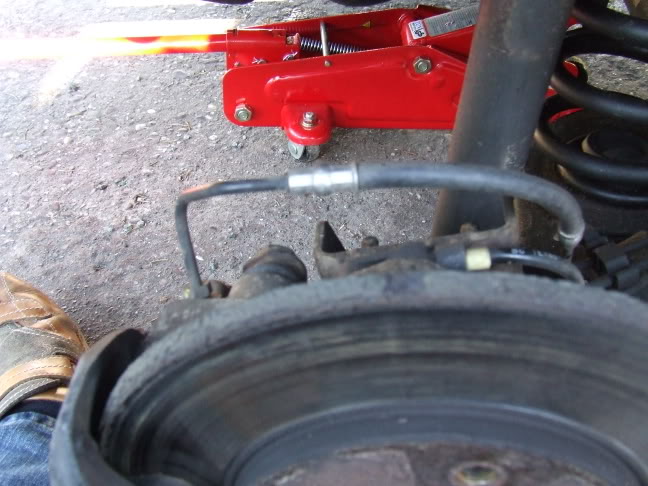

I have been trying to Fit my goodridge brake lines i have bought for my car. Problem is the rears dont appear to be right. I have checked the package and the package says it is for a 172/182/cup
I have a 172 Cup is there something i am missing here????

From what you saying i'm guessing you think the rear pipes go here?
I made the same mistake is so, they actually go here

LMAO, I am such a dumb ass at times, Thanks you soooooo much really didnt want to have to go through the rigmorall of send them back to demon tweaks

Lol i did exactly the same thing, if you look under the car on the passengers side, by the rear wheel you should see those shorter pipes.

Sweet, Cheers Man,
