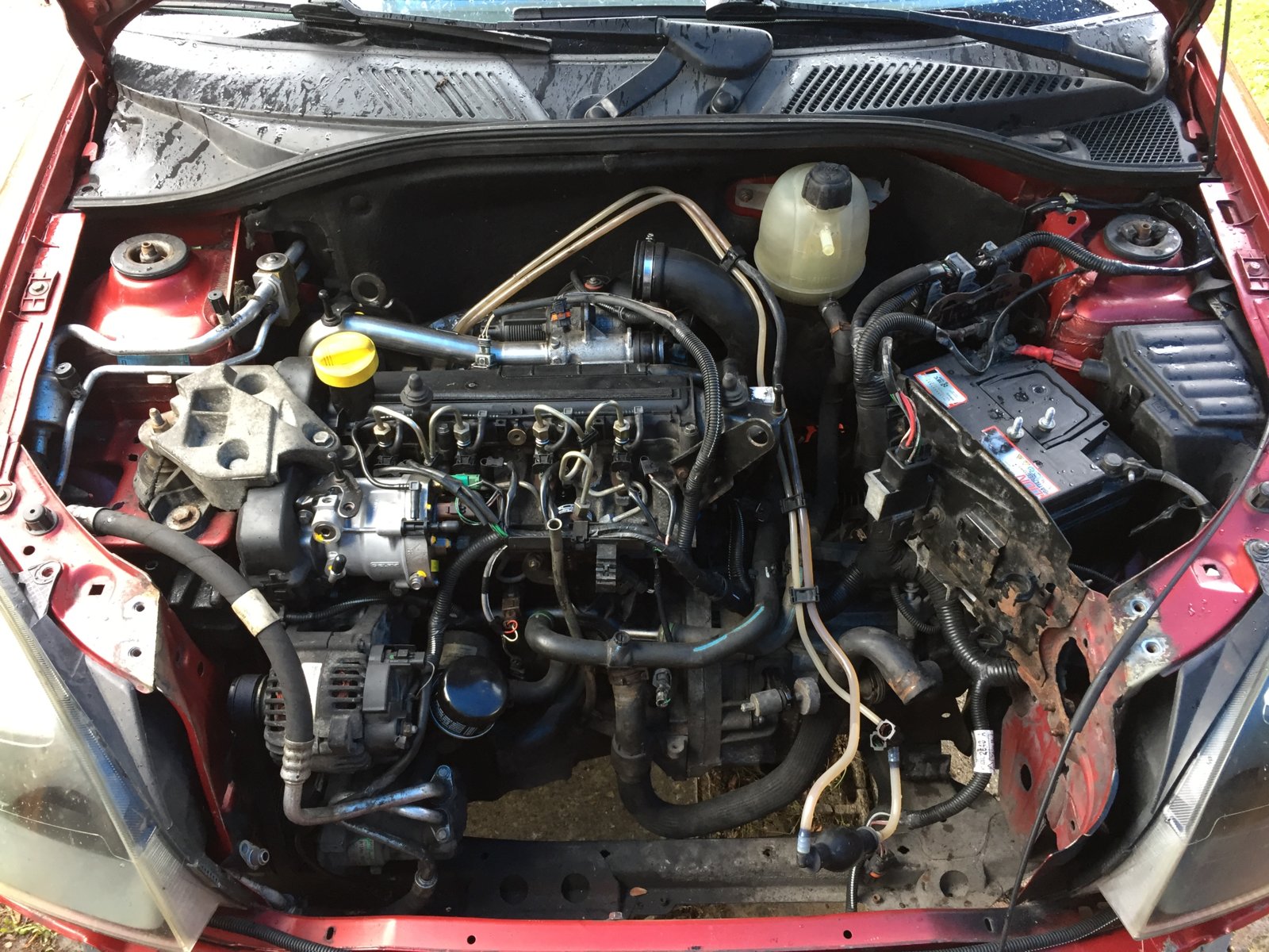

Fast forward a couple of weeks and today I've started repairing the fuel system. This is a HUGE job as I'm also attempting to sort a number of other jobs at the same time. That said it's all manageable and I've got all the bits. I cleaned out a petrol tank last night to ensure there was no chance of metal filings going back into the fuel.

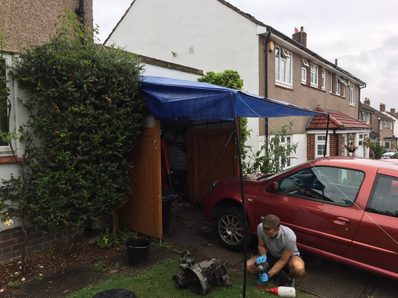

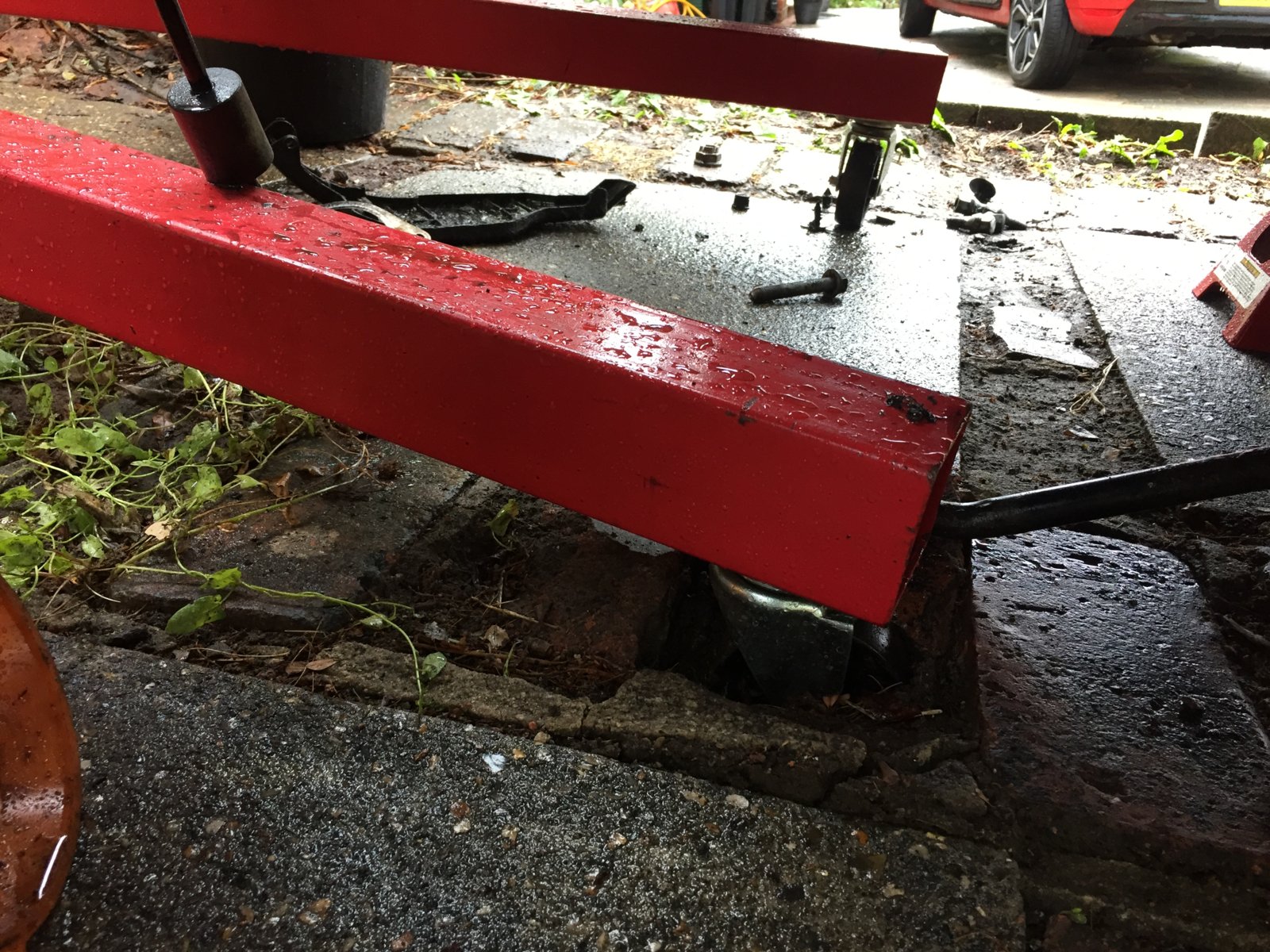

Today was horrific, I started at 7:45 and it started raining almost immediately delaying me until about half 10 when I decided I needed to get on so started working in the rain. That;'s not all though, my trolley jack was at my parents, I've lost the memory card for my camera, my electric ratchet charger gave up the ghost and oh Christ, everything I touched was disgusting. I got the engine out about 12 but the engine crane lodged it's self in the drive so it was stuck until I removed all the wiring and gearbox in the pouring rain.
Sadly due to the huge flywheel I can't get the engine on the engine stand so am going to attempt the cambelt job on the engine crane. For some time I knew there had been an oil leak on the back of the engine and had put it down to the turbo seals having gone. Simple enough, a replacement turbo would fix that. How wrong was I, I started taking the cambelt off and realised inside the protective covers was a diesel oil nightmare. The cambelt was covered in the stuff and and now after many hours all my tool and I am to....grotty.

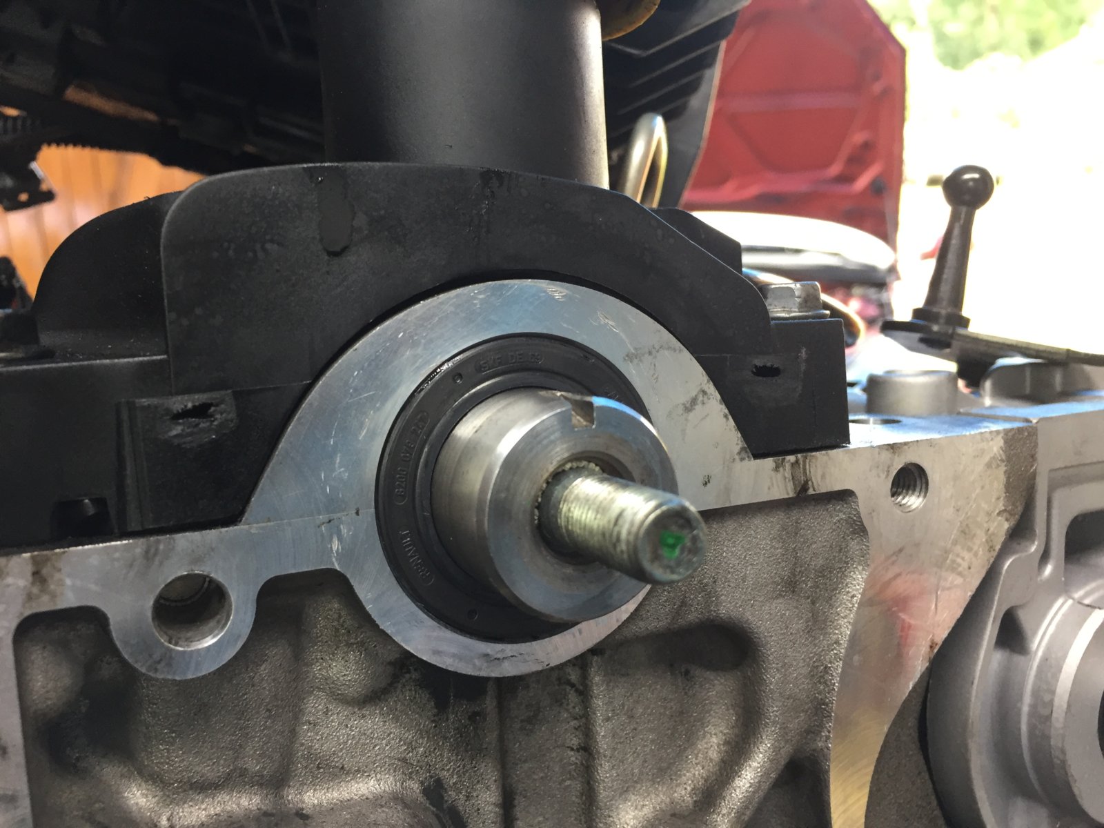

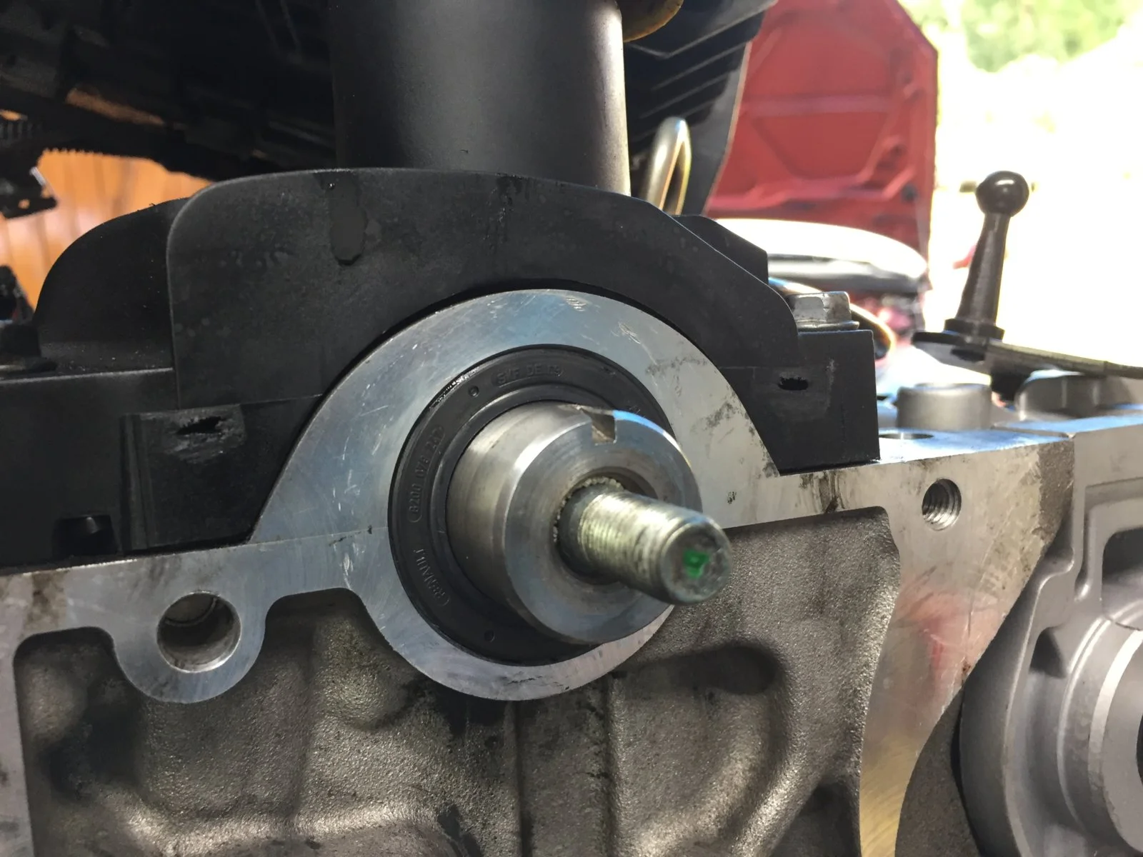

So doing this in a couple of days is out the window. New seals for the crank, cam and oil pump cover arrive on Tuesday so I'm going to get everything ready before then so Tuesday is only a sealing and cambelt day.
Wish me luck! Now I'm doing this and it's rubbish I wish I'd just bought a new car......

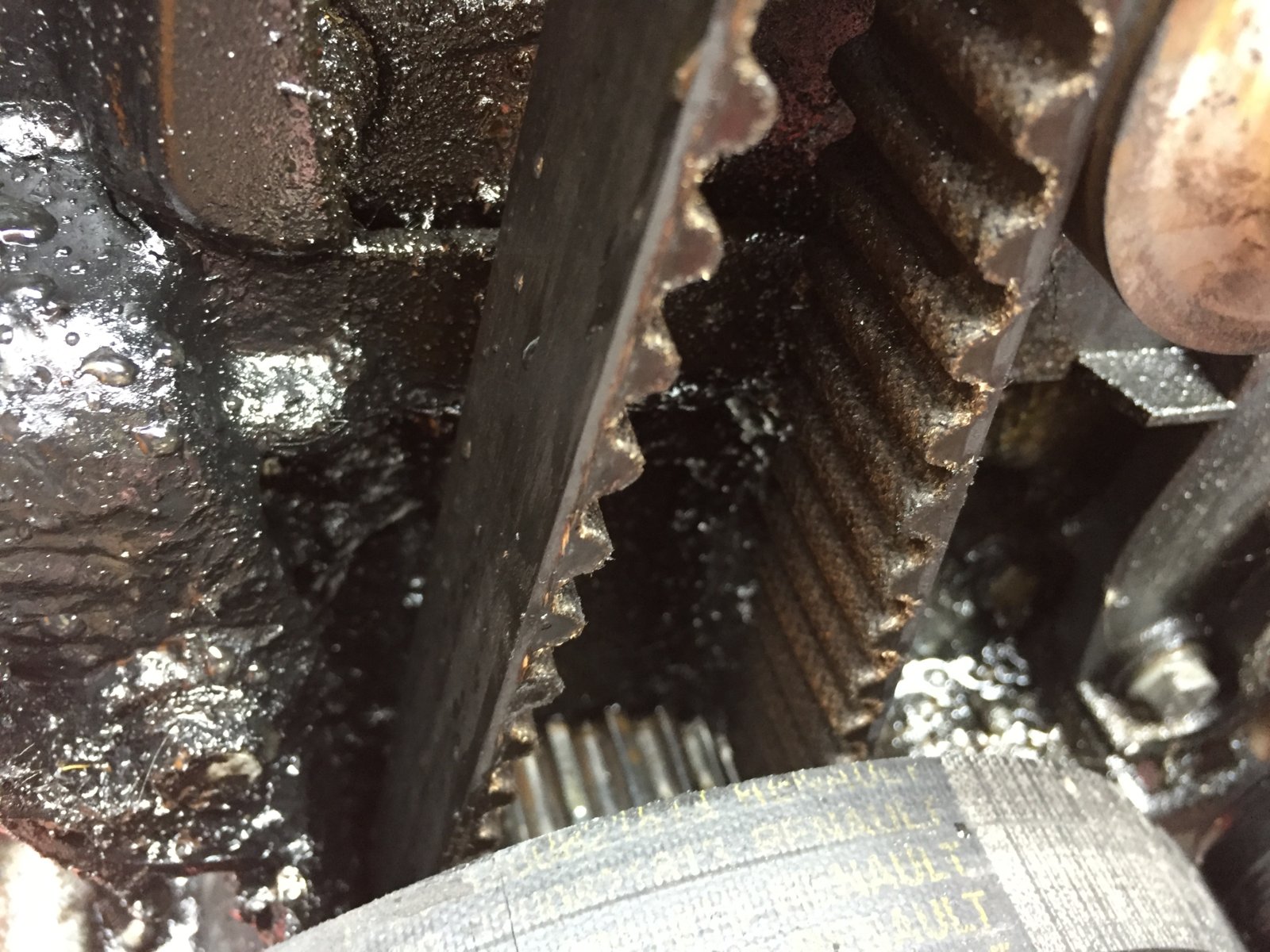

Noice! Mine was the same, luckily the cambelt was oil free but everything around it was absolutely caked in grease! I spent 3 hours cleaning my block and all the covers?

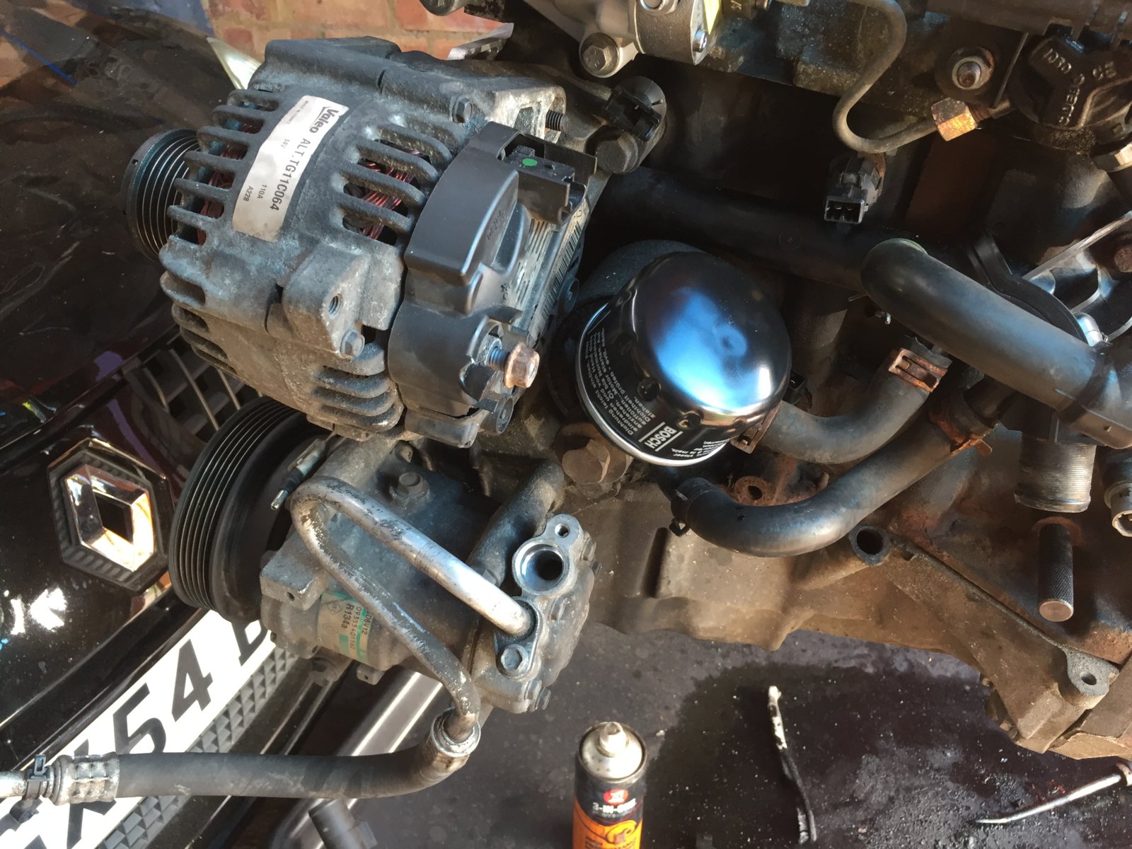

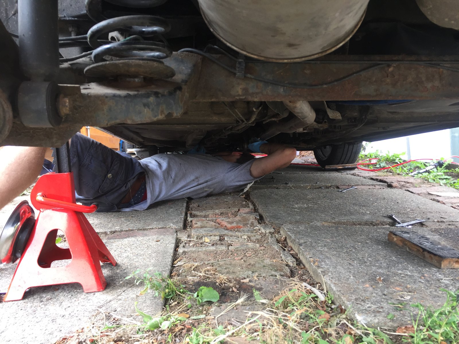

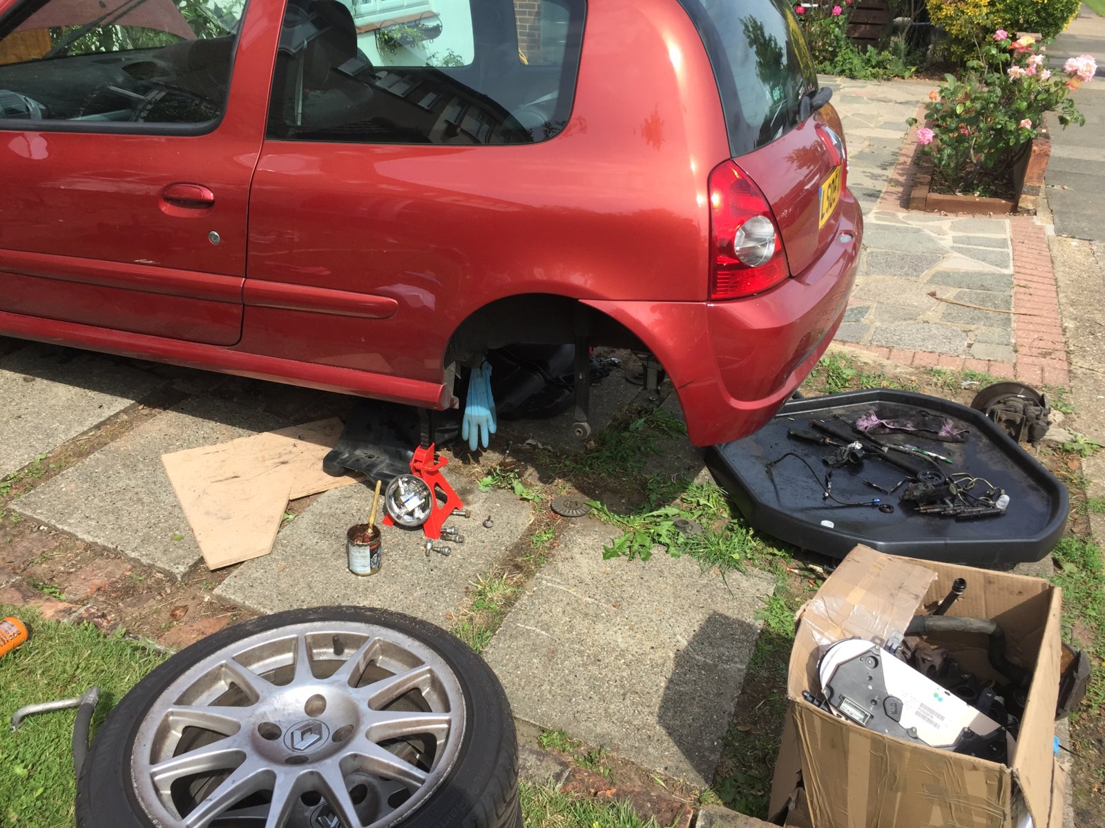

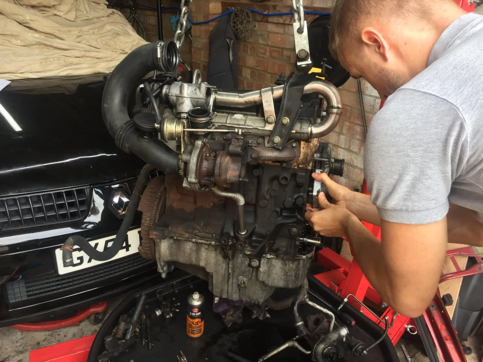

Made a bit of progress over the past couple of days. @Martin. has been a huge help putting my sanity back in check and making a horrific task a laugh. The garage looked like a K9K bomb had hit it after Friday so needed some serious re-arranging which we spent most of Saturday doing. Today saw a few bits done on the engine, some of which went OK and others which took far longer than they should.
We even fashioned a rainproof shelter but it stopped raining after we got it up

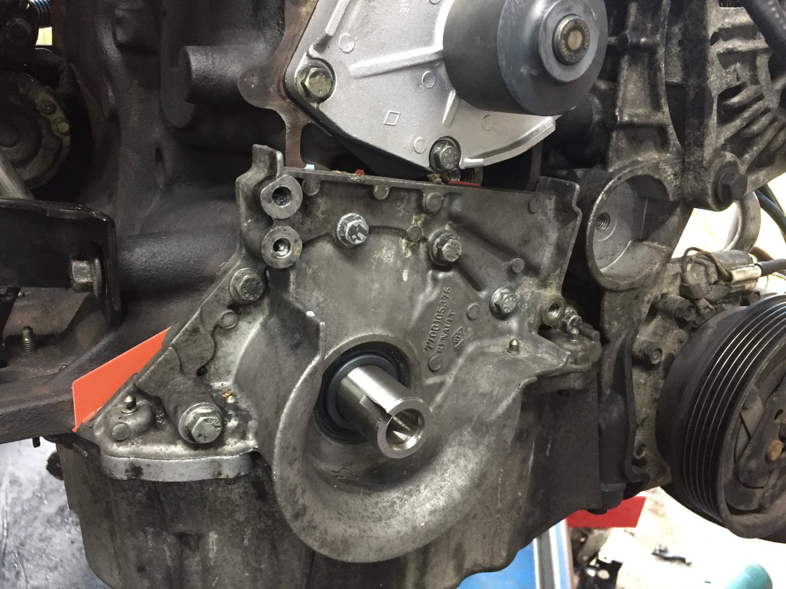

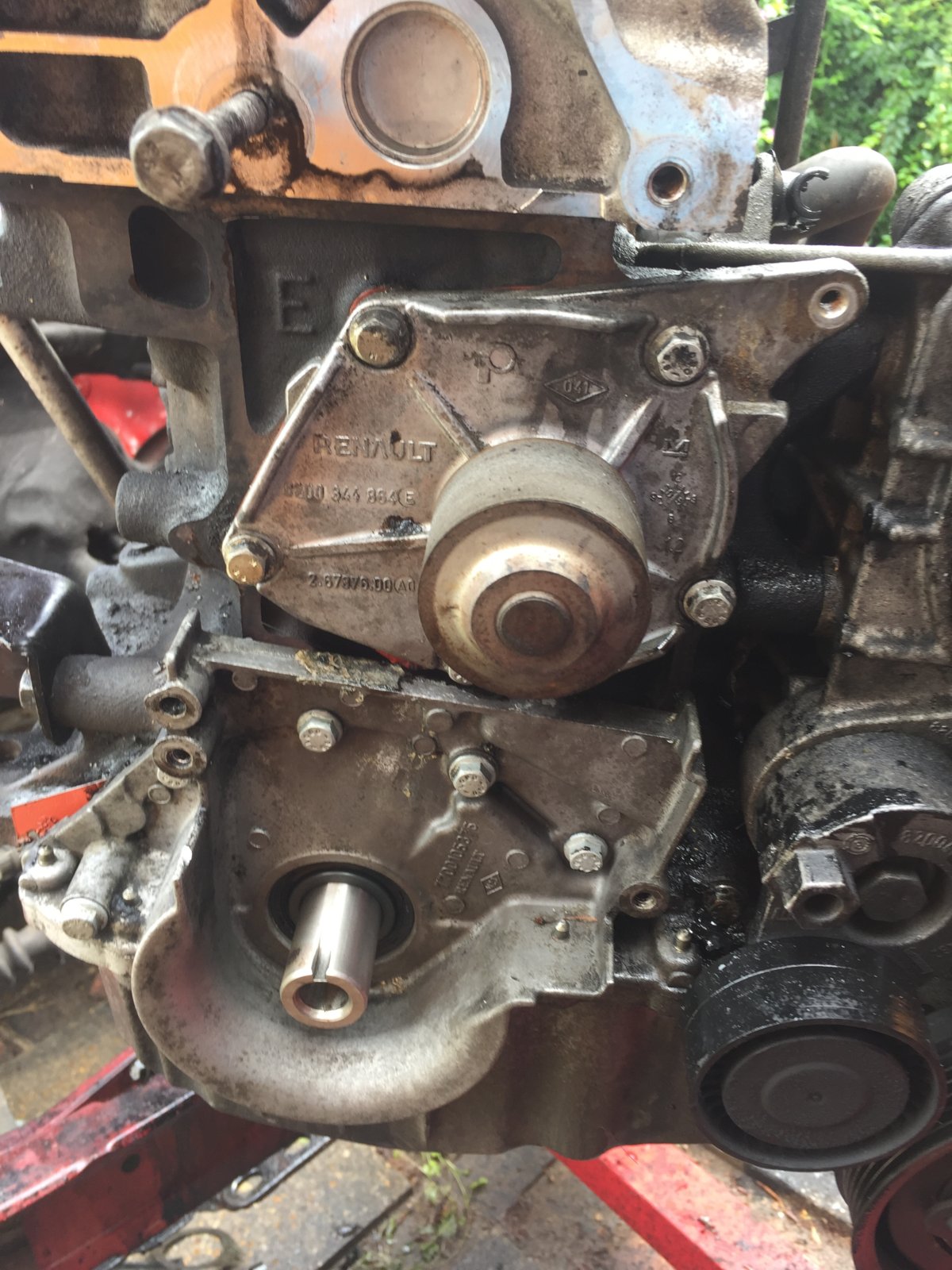

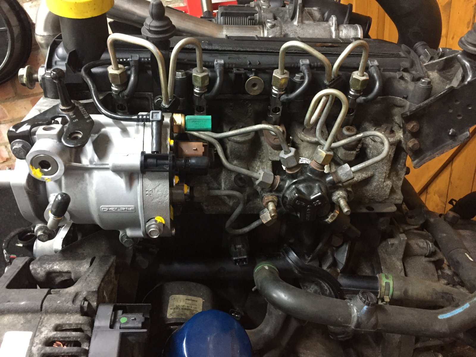

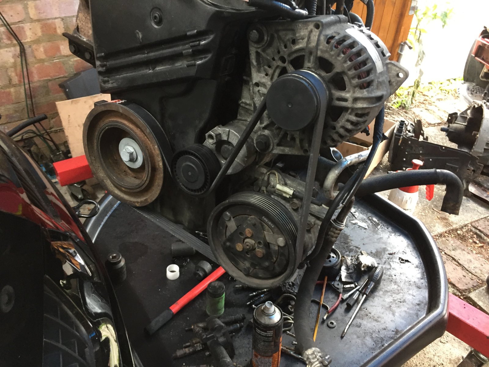

After taking off a fair amount of the bits attached to the engine it was given a serious dousing in brake cleaner to get rid of the grime. I've gone through 5 litres over the past couple of days as most things on the car as vile after this oil leak. Thankfully they are cleaning up a treat after going through several thousand microfibre cloths.

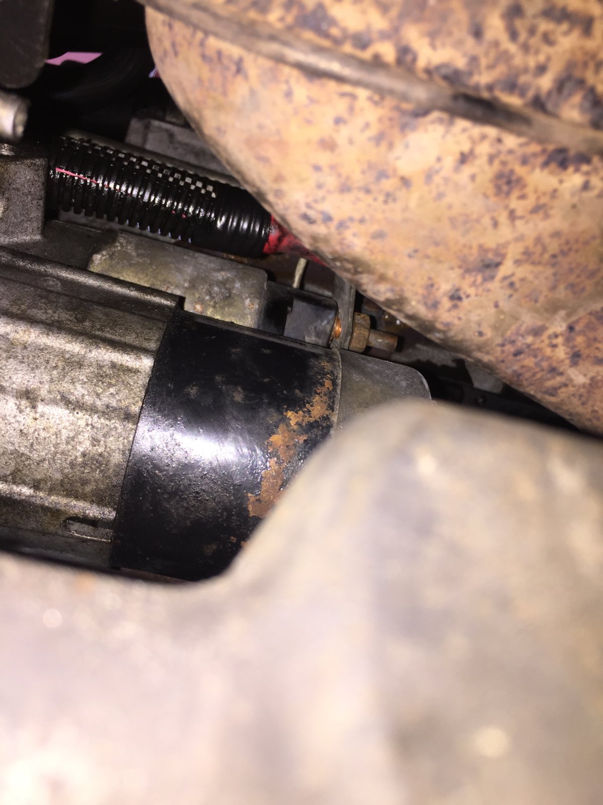

Today the first three jobs I attempted went totally wrong. The thermostat I ordered didn't have a nipple for the overflow so I've had to order another and the first injector was seized solid. After about 2 hours of levering and soaking the bore in carb cleaner it finally came out. The dipstick had annoyingly snapped during removal of the engine and even more helpfully the dipstick tube was seized solid in the block. After a couple of hours of soaking in plusgas and a persuasion session it came out, however, a new tube is near £60 so I'm going to try and recover one from the dci 80 donor engine before splashing out.

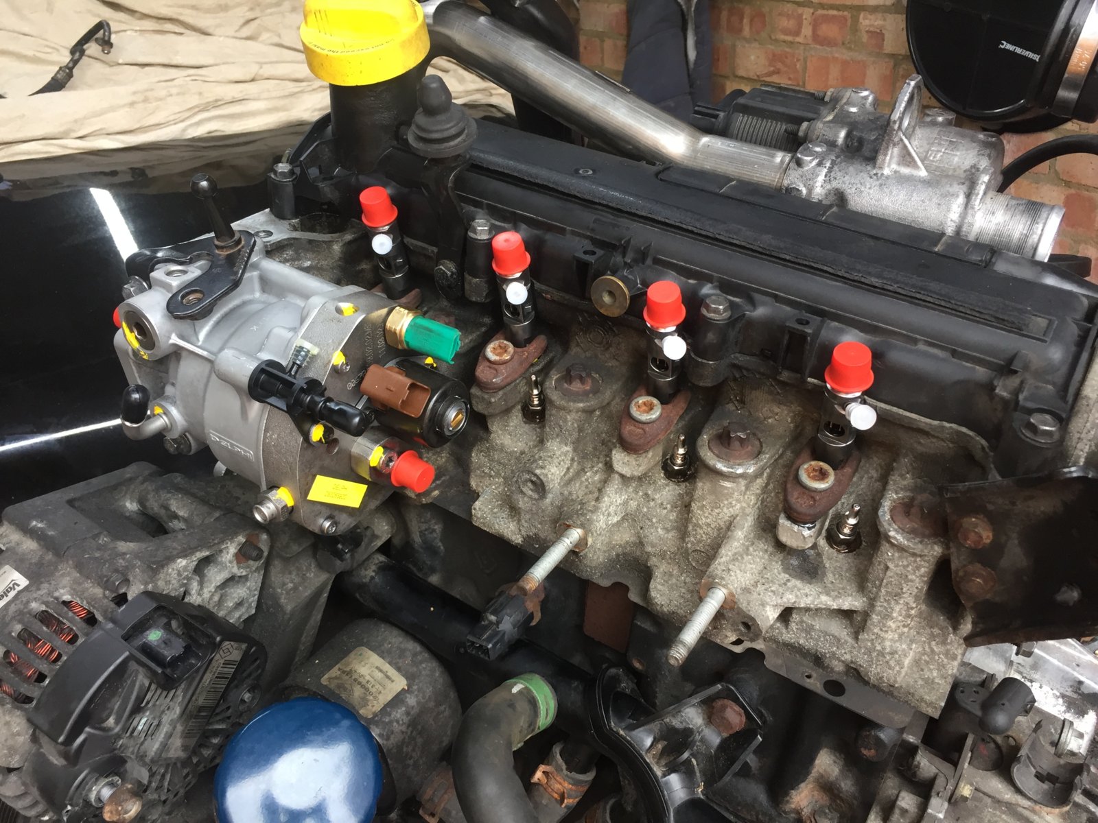

Apart from these bits everything went well and we managed to get these parts on:
  • Injectors
  • Fuel pump
  • Glow plugs
  • Water pump
  • Clutch
  • New gearbox selector bush and circlip
  • DCI 80 turbo (factory set to 1.2 bar instead of 1.0 on a 65)

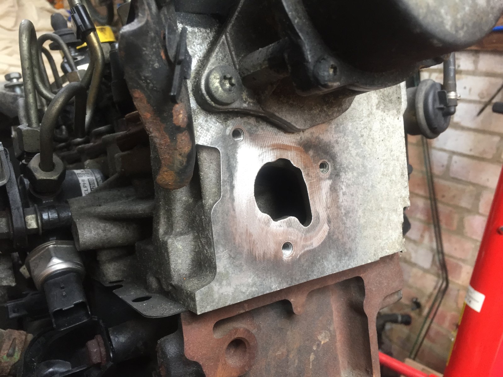

The EGR housing, EGR valve and solid pipe were also given a thorough clean and I swapped over to dci 80 A/C pipes for the new rad pack which will be going in the car.

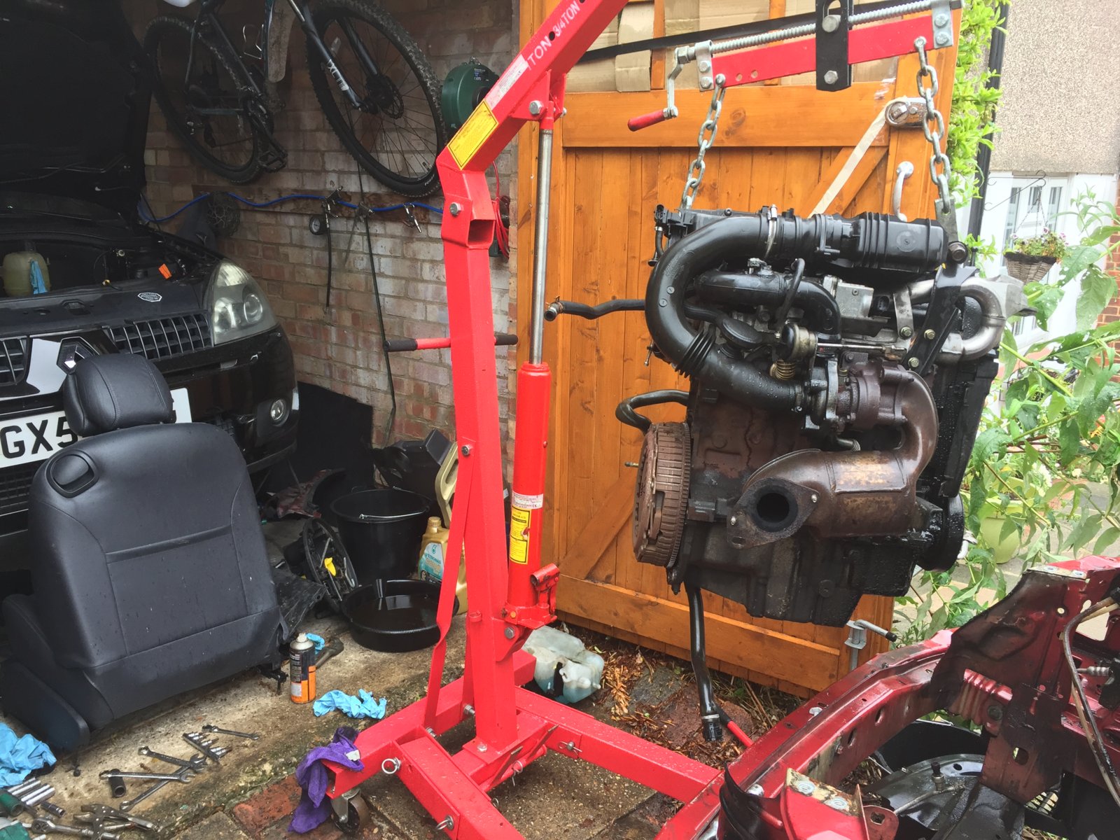

Yeah I'm glad the dCi 100 came with a normal looking flywheel. The 65 and 80 ones are bigger than a tripledisk clutch ffs!!

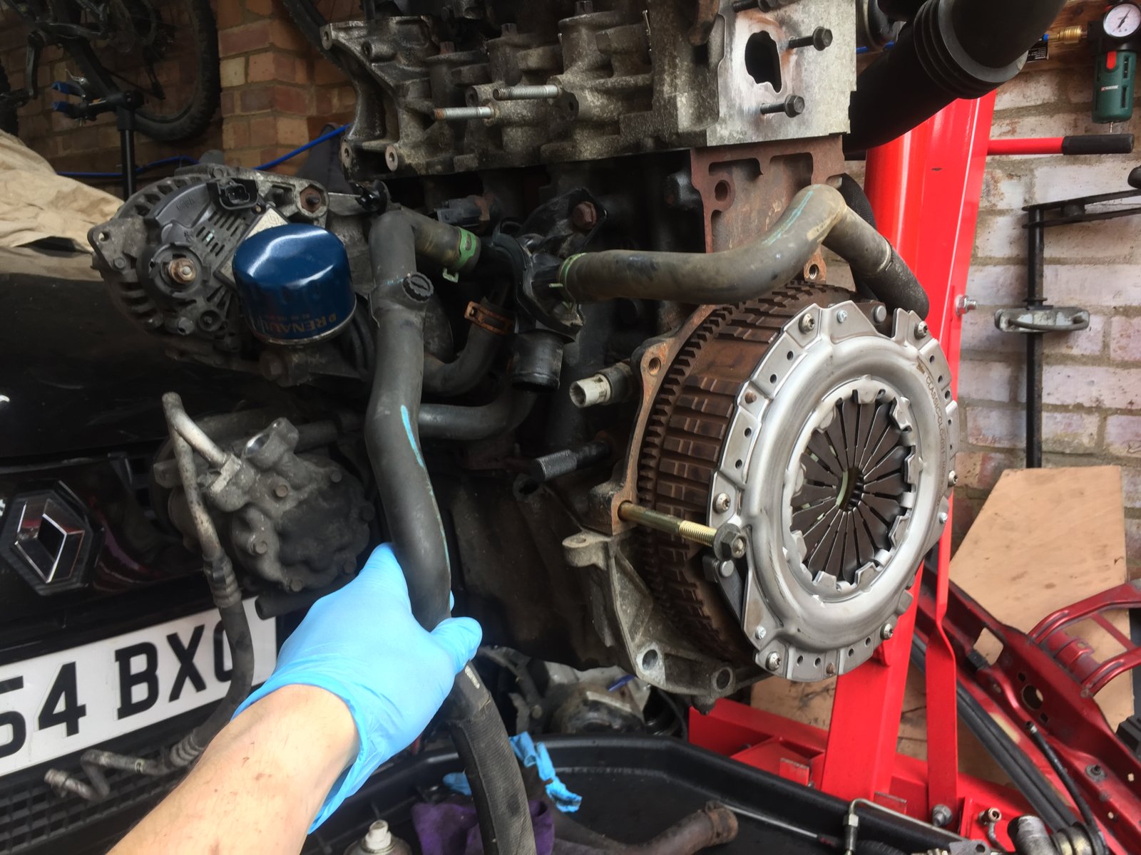

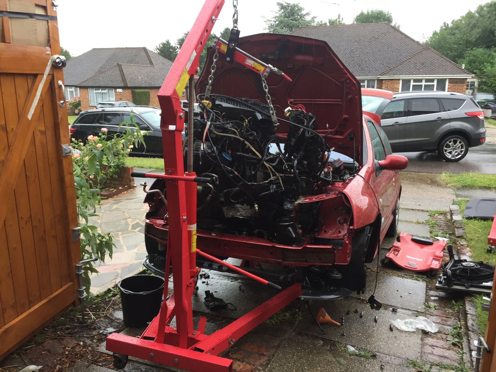

This thing was enormous but working with it on the crane wasn't as bad as I originally thought it would be!

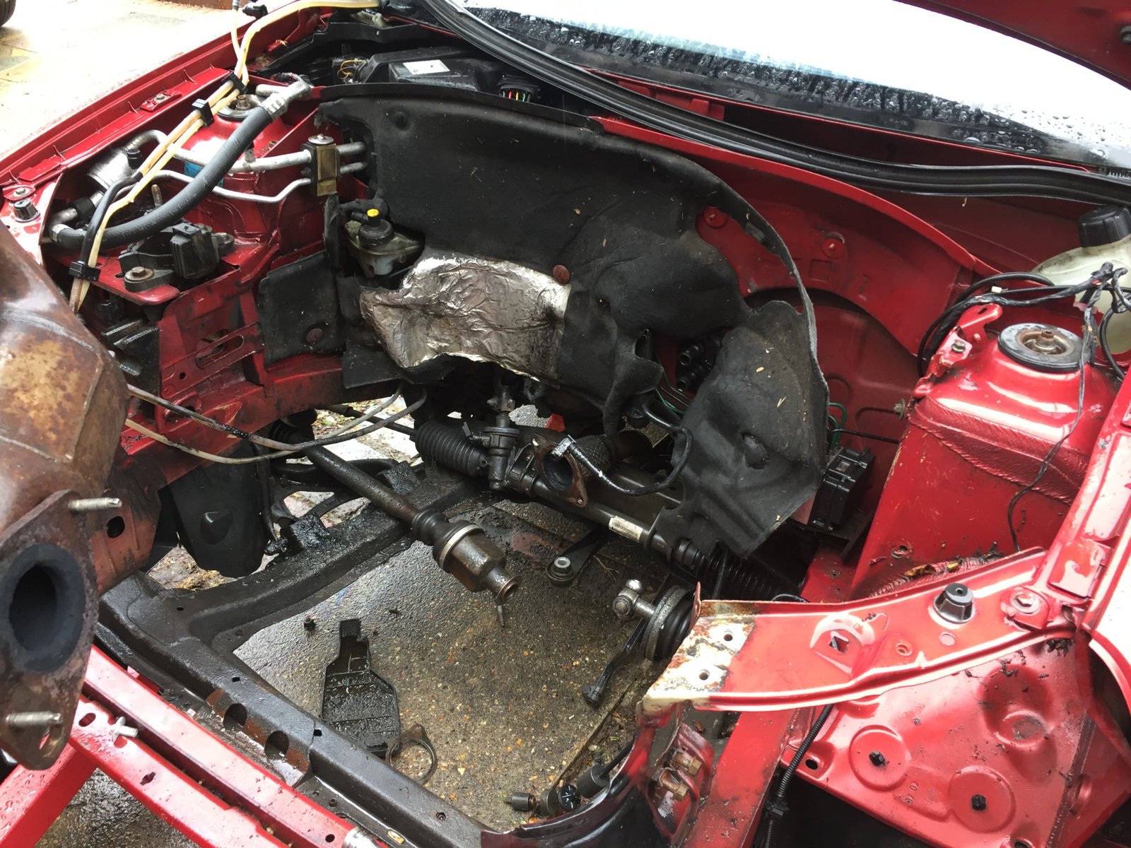

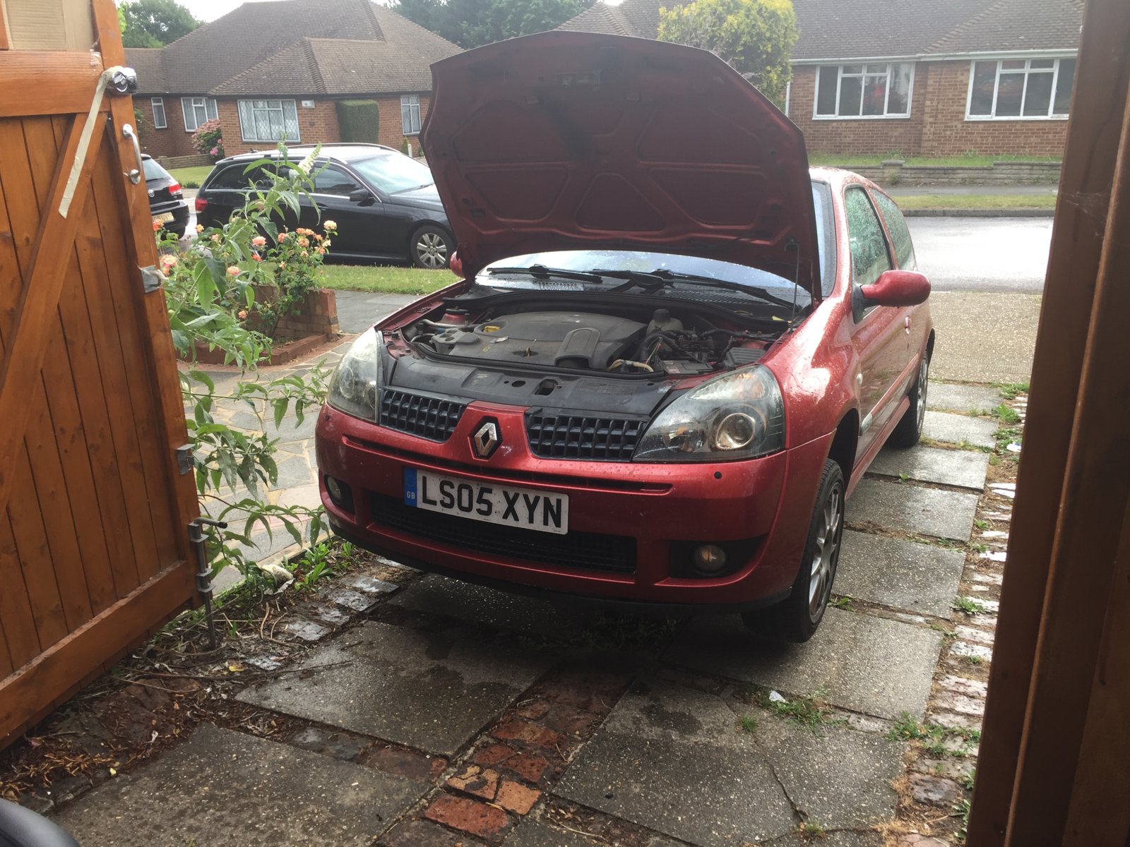

Yesterday I took the day off to make some more progress on the car. This is now day 4 and admittedly a much longer job than I anticipated but reassuringly the end is in sight. Everything went to plan and I ended the day with the engine back in the car.
On Monday evening I spent quite some time cleaning the injector hard lines and common rail with brake cleaner and the air compressor. Given these parts are post filter they need to be immaculate to prevent anything getting into the injectors and blocking the microscopically small nozzles. A grain of sand is quite a few times the size of the hole. I’m glad I did this clean as on the first go there was a fair bit of debris and what I think was some metalic flecks. Some from the outside of the pipe and some from inside. These pipes are from the donor car which supposedly ran very well. I cleaned them a second time too until I was satisfied everything was out and they were in a good state to go on the car.
Tuesday came and of course the weather had turned on me again, however, this time I was prepared with the gazebo which saved me big time when it started to pour.

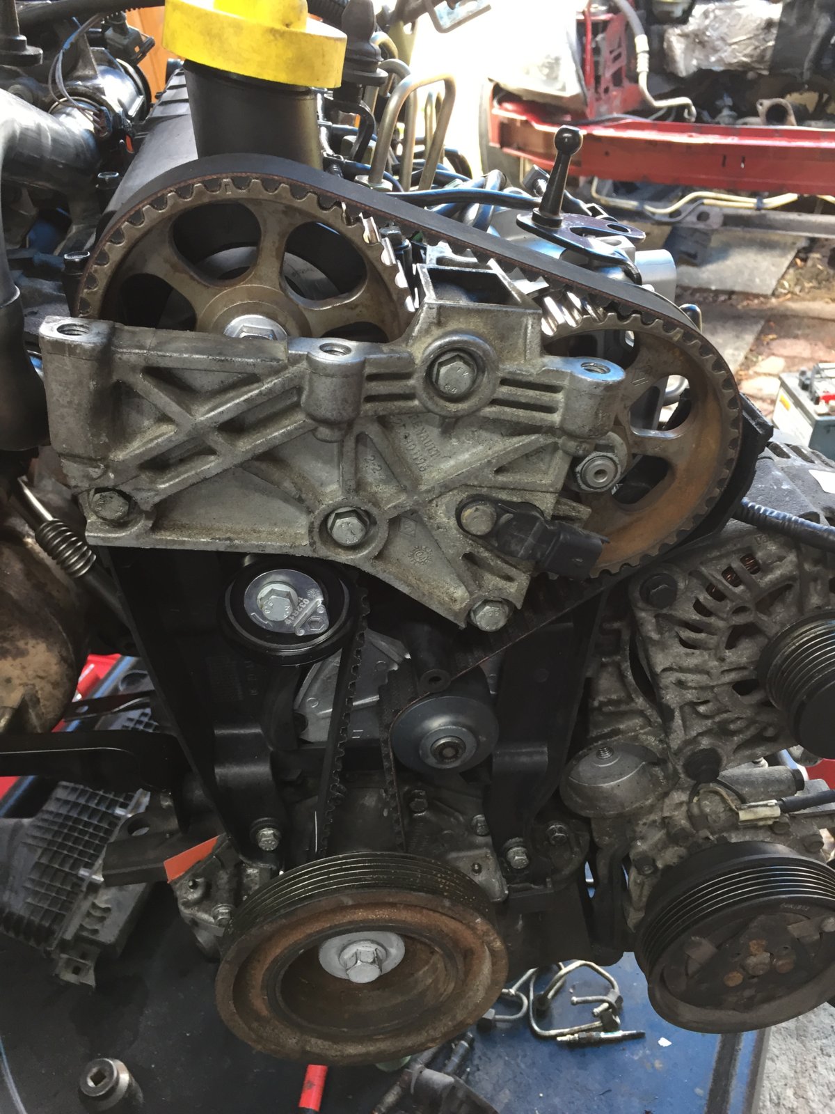

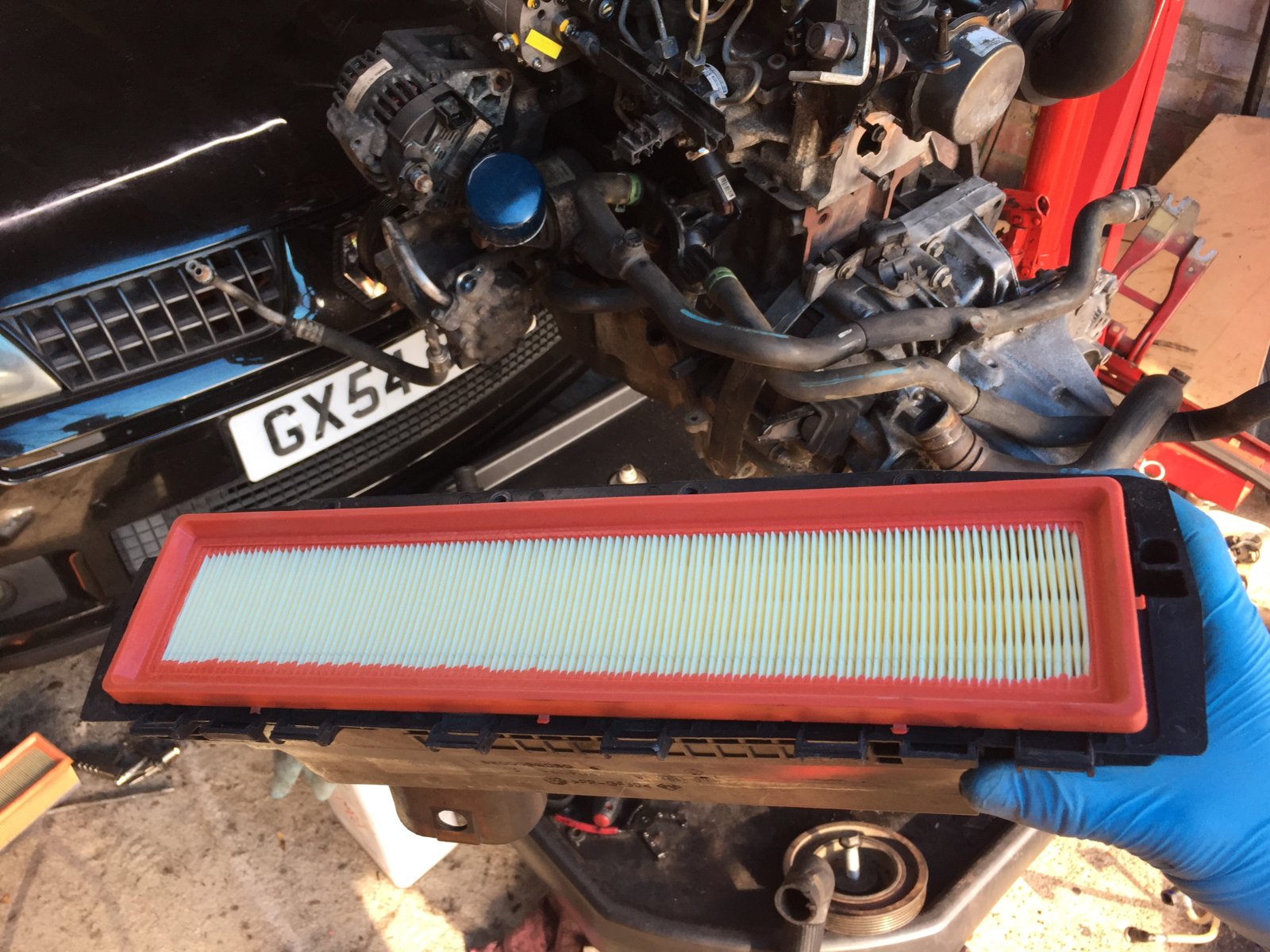

I started out doing a few service items, air filter, oil filter and then set about getting the engine wired up again. Admittedly I made a mistake when taking the car apart. Although I thought it was weird the engine loom didn’t come apart from the engine bay loom (like it does on a sport) I had figured this was a DCI thing and ended up taking the whole engine bay loom out (indicator, power steering, ABS etc). When putting the 80 loom on the car, it of course fell apart from the engine bay loom, proving I’d wasted a huge amount of time removing all the extra wiring. With the original engine bay loom back in I put the 80 loom on the engine and was thankful that this revelation would make engine re-entry a much easier task. It also meant there was no need to add in cruise control wires as this ECU plug is on the original dci 65 engine bay loom. The only difference between the 65 and 80 loom is an additional air temperature sensor on the intercooler piping.

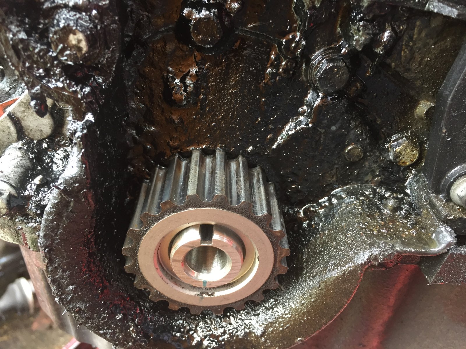

By 11 Renault had called and my parts were ready so I popped down to there. The cam seal was a doddle, as was the crank. On the oil pump cover I put a tiny amount of instant gasket on to make sure there were no leaks from where the block, sump and oil pump cover meet. If there was a leak it’d be a bit rubbish to get at and is a cambelt off job. After this was all on the cambelt was done, checked multiple times and correctly tensioned. I pulled a muscle in my arm doing the 120nm plus 95 degrees on the crank bolt and sat for a good five minutes waiting for my arm to recover. I replaced the aux belt and turbo seals, a part not listed on Dialogys but if anyone needs it 7701471140 has 2 o rings and 2 copper crush washers in. On my old DCI after replacing the turbo my car used to gush oil out of the turbo feed. If only I could go back and realise I'd put the o ring on the wrong side of the lip on the pipe.
Last hurrah of the day. I managed to recover the dipstick tube from the donor car, saving a packet in the process.
