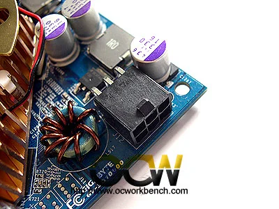

  Monaro VXR
Not got a PCI-E style connector on the card has it?
Should be a small black section in 2 lots of 3 pins.
If so you need a plug in there to give the card power. technically does not require it but if its provided sometimes its needed. Otherwise make sure you have monitor plugged into the right port on the graphics card. And if the motherboard has onboard video that it is disabled in the bios. But with you saying about thepins chances are its a serial port rather than vga port.
  Civic Type -R FN2
it is pci - e but no connector on it like that, as before the only thing i can see is a small gold pci bit on the top
