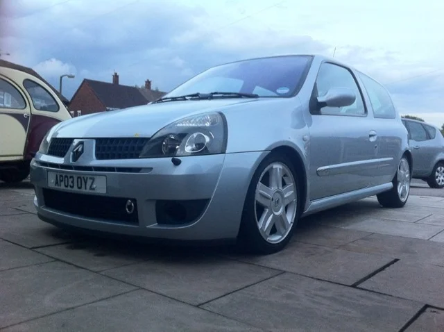

The only pic I have.
that's still pretty low and when you are only going around corners hard i reckon its just scrubbing on the arches, mine will do it. if you where catching on something surely it would be making a noise all the time?
might be an idea buying spacers for the front
i have 10mm on the front
it improved my turning circle quite a bit as well lol
