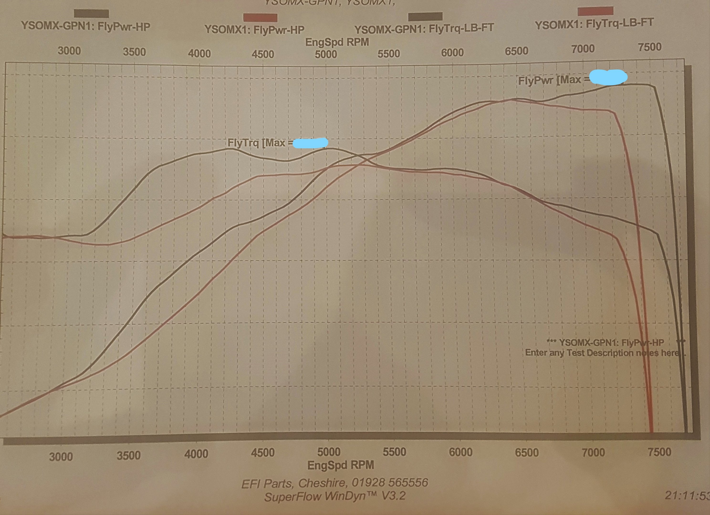

Finally had my belts done with group n timing and mapped by EFI.
Red graph was from power run pre work in March

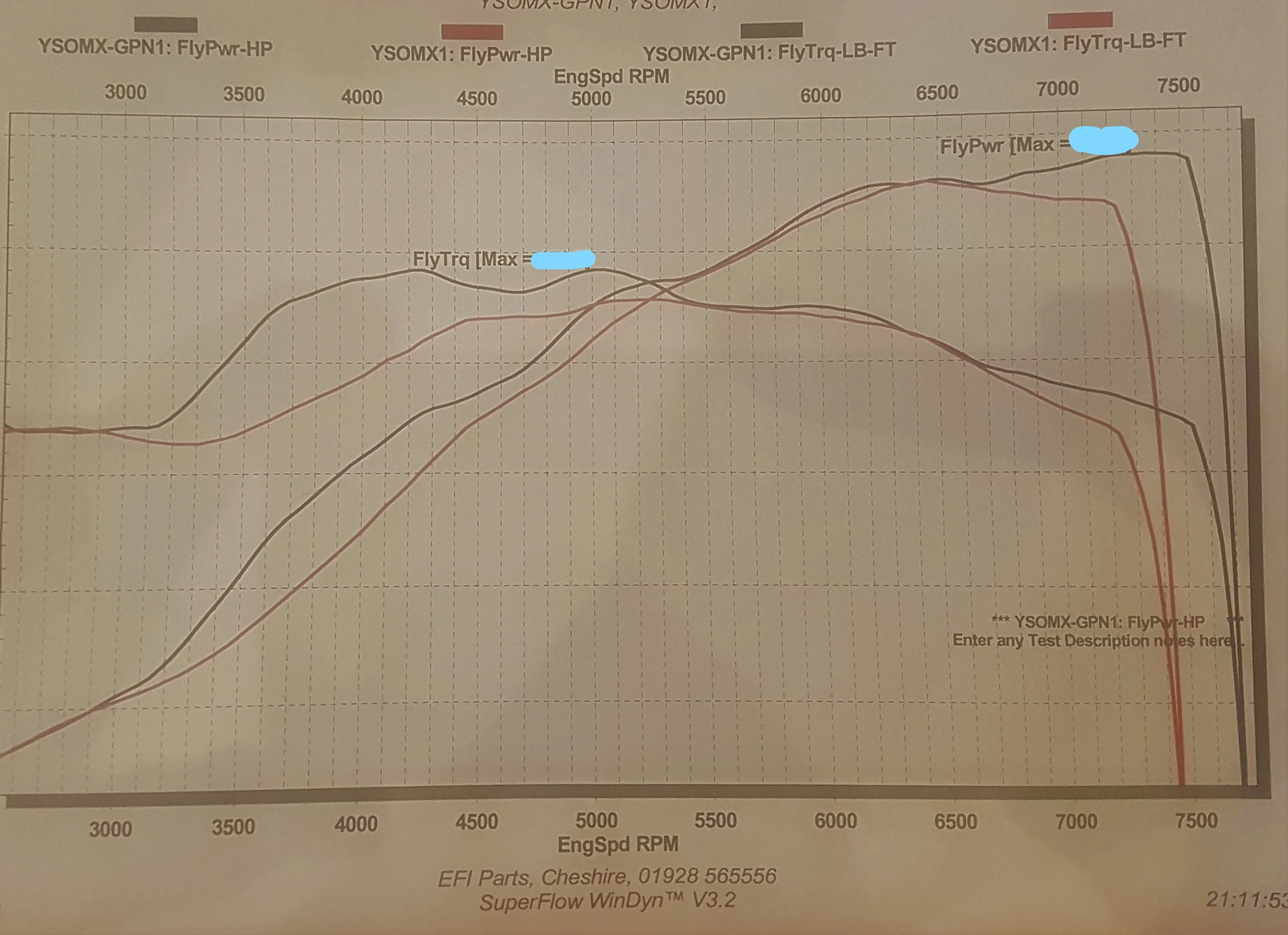

Thank you to @NorthloopCup for advice, making the timing tools and matching my inlets.

What setup have you got? Exhaust Intake etc I’m having mine mapped next week at EFI
Car - 2003 172 on 109k
Red trace on graph-
Btb cat back exhaust (still running cat)
Ktec induction
Rs tuner
Today’s run in black-
182 manifold
Ktec sports cat
Btb exhaust
Matched inlets
Ktec induction kit
Group n cam timing and custom map by Chris at EFI
Red trace on graph-
Ktec induction
Rs tuner
182 manifold
Ktec sports cat
Btb exhaust
Matched inlets
Ktec induction kit
If I can replicate that graph I’ll be happy!!! I’ve got pretty much the same mods as you

Oh forgot 197 injectors. Chris advised me to get some when I did the power run
Massive torque increase right in the middle, how does it feel on the road? :)
The way it picks up from 70 in 5th - it’s like a different car. Unfortunately the knock sensor spat it’s dummy out on the last pull so it’s killing power above 5k. Luckily Chris had finished an was just doing a final pull. Getting one on Wednesday so hopefully it will cure it
Will have to see if mine will has I’ve got a sports cat
