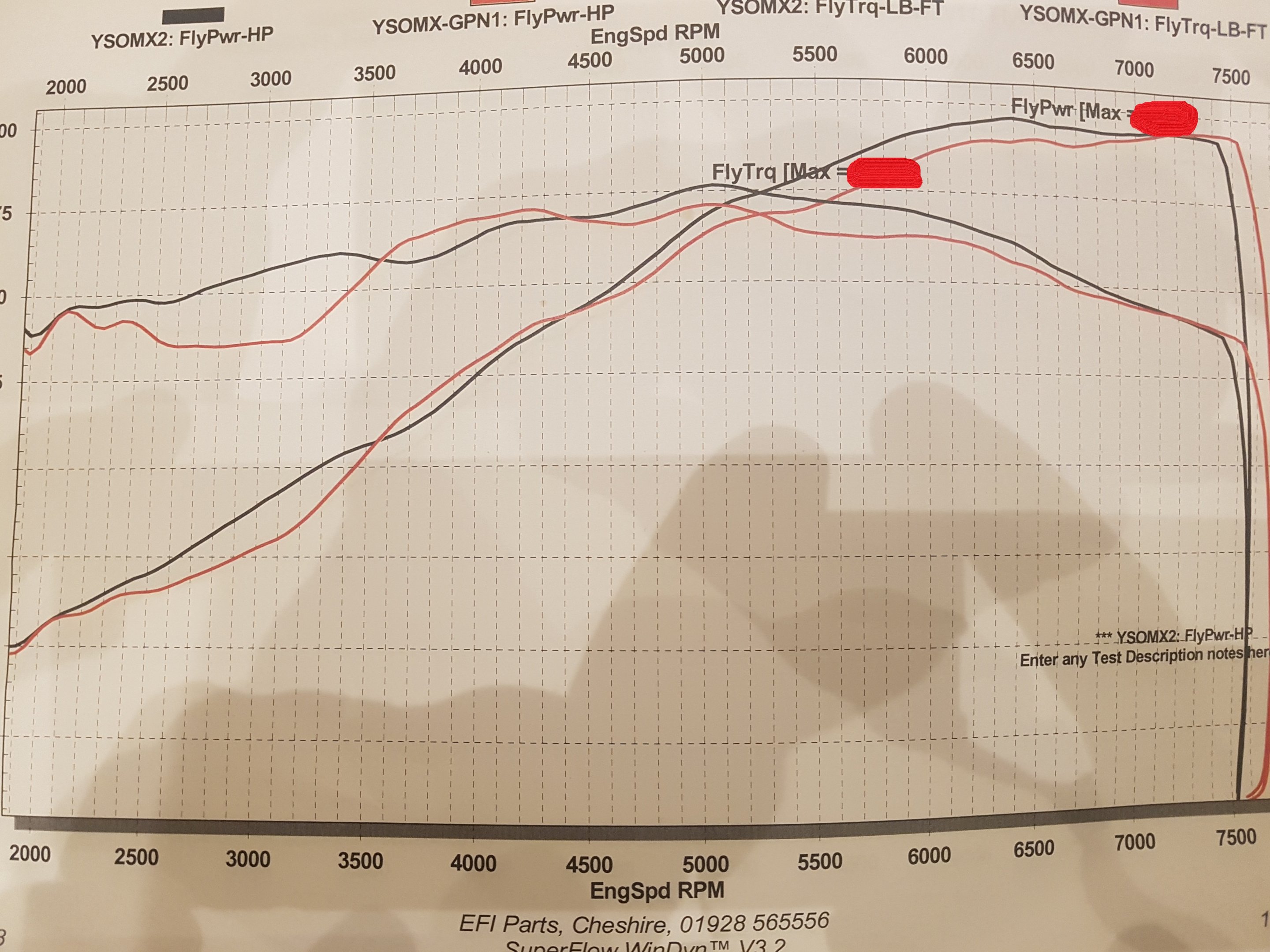

Forgot to update this the other week, car now got a 182 exhaust manifold on it and at the mo sat freezing my toes off in efi while Chris sorts it out, will post graph later on but surprising difference from the manifold and bit of mapping.
Had a feeling the manifold would work well with the timing.
  dan's cast offs.
the red is with group n and 172 exhaust manifold, the black is 182 manifold and mapped again.

Wow, what other mods other than the group N timing?
matched inlets, cone filter and pms exhaust. although the guys who did the inlets seem to have the impression it's down to them by the way they've posted it on facebook, that could disappoint a lot of people who buy them!!!!!!!
was getting a bit of det top end so chris had to pull timing on it, guessing it's standard pistons but didn't check down the plug hole when i was doing it.

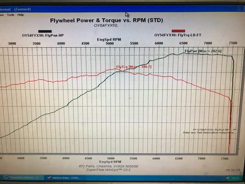

compression was high on it, was starting to det top end so chris had to pull timing on it. speaking to him this morning saying possibly head skimmed on it? either way still a stonking car, just a shame we didn't have a before graph for it. that's the downside to having to turn it round in a day when someone is coming from 3 hours away as well.
