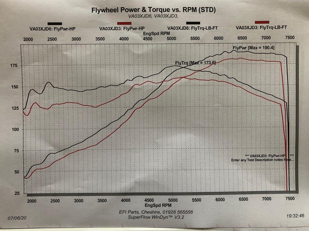

Finally had my belts done with group n timing and mapped by EFI.
Red graph was from power run pre work in March

What setup have you got? Exhaust Intake etc I’m having mine mapped next week at EFI
Car - 2003 172 on 109k
Red trace on graph-
Btb cat back exhaust (still running cat)
Ktec induction
Rs tuner
Today’s run in black-
182 manifold
Ktec sports cat
Btb exhaust
Matched inlets
Ktec induction kit
Group n cam timing and custom map by Chris at EFI

If I can replicate that graph I’ll be happy!!! I’ve got pretty much the same mods as you

Oh forgot 197 injectors. Chris advised me to get some when I did the power run
497adam
  clio 172 phase 2
Massive torque increase right in the middle, how does it feel on the road? :)
The way it picks up from 70 in 5th - it’s like a different car. Unfortunately the knock sensor spat it’s dummy out on the last pull so it’s killing power above 5k. Luckily Chris had finished an was just doing a final pull. Getting one on Wednesday so hopefully it will cure it

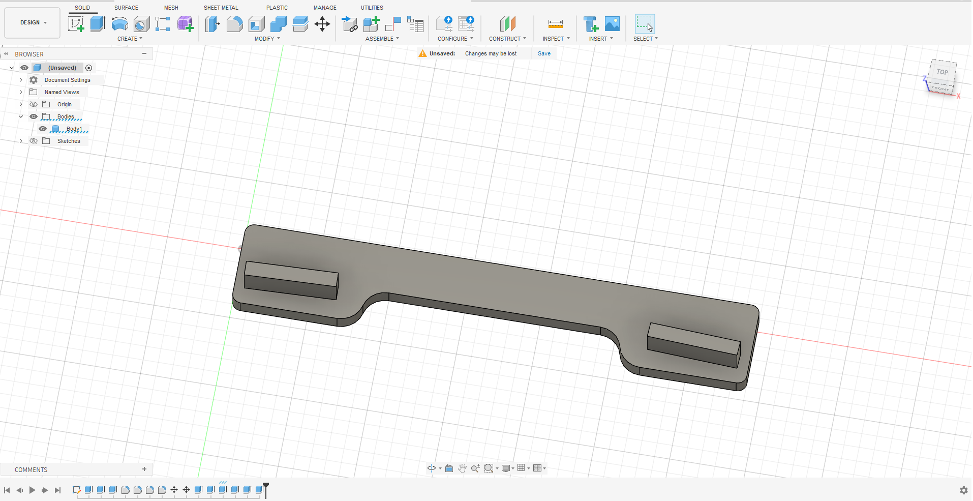

So I have moddelled up a timing tool now and i have put the exhaust cam locker 2 degrees on r****d and the intake cam locker on 3 degrees advance.
That should be correct right?
Trying to print it with Carbon Fibre Nylon 12 and see if its strong enough to time with...
pic below of the model.
Does this look right? i think so, if not please correct me.

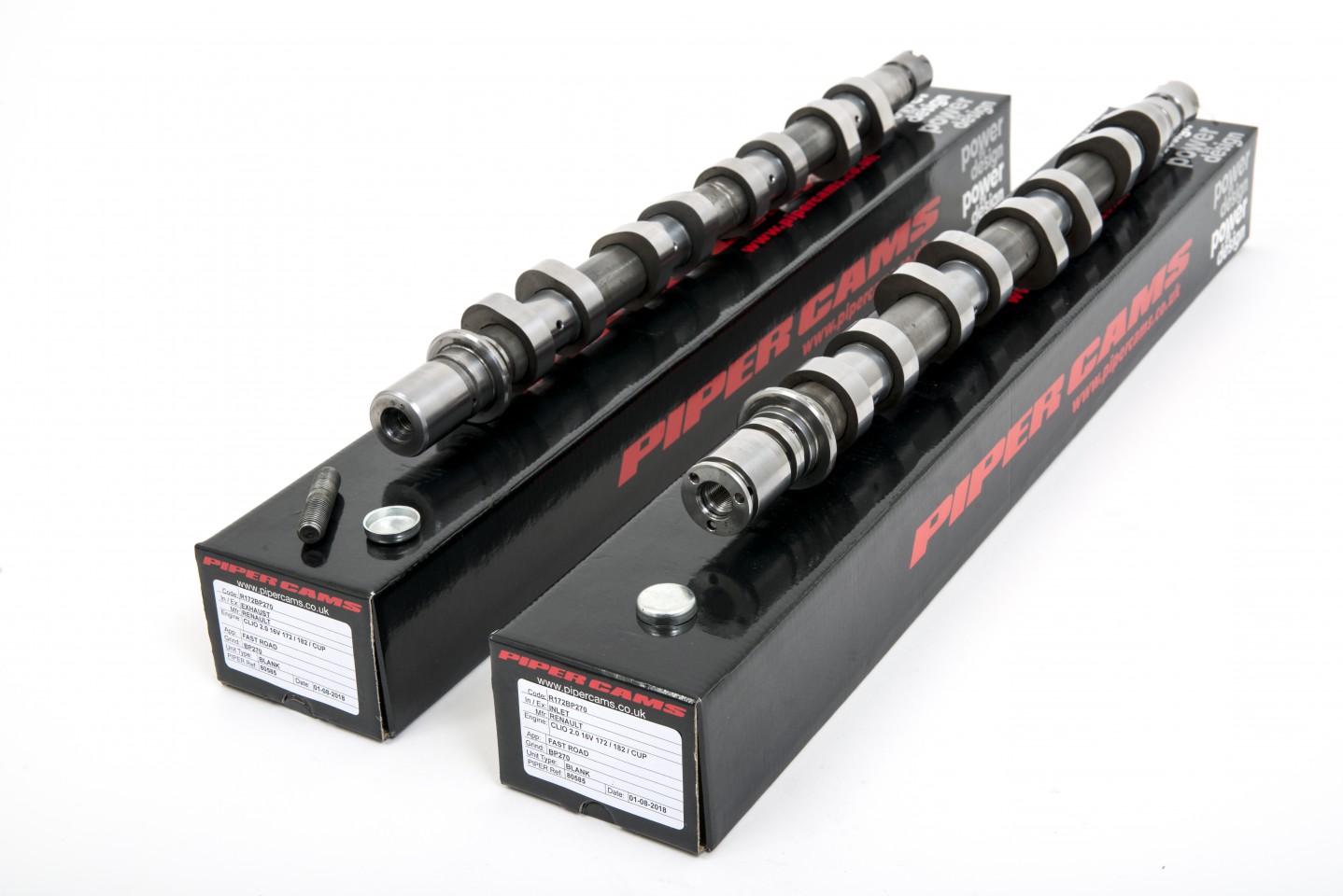

Would there be any point on doing gr.N timing with pipercams BP270 cams? as they are regrind cams..
@NorthloopCup what's your advice mate?
Also what would be better, 197 cams on 7° or std cams with gr.n timing or bp270 with gr.n timing, on stock engine with ported inlet and 182 manifold?
Thanks!
NorthloopCup
Unsure how well the Grp n timing would work on the bp270’s tbh.
Regards what’s best, it all depends what you’re after. Peak bhp then 197, but in my opinion you get better drivability from Grp n on standard cams.
