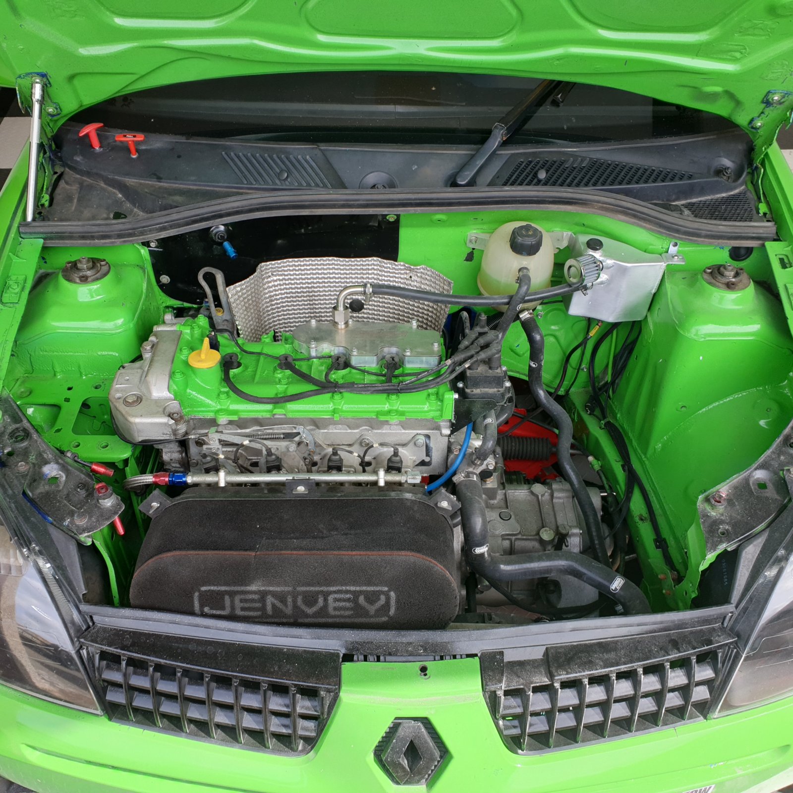

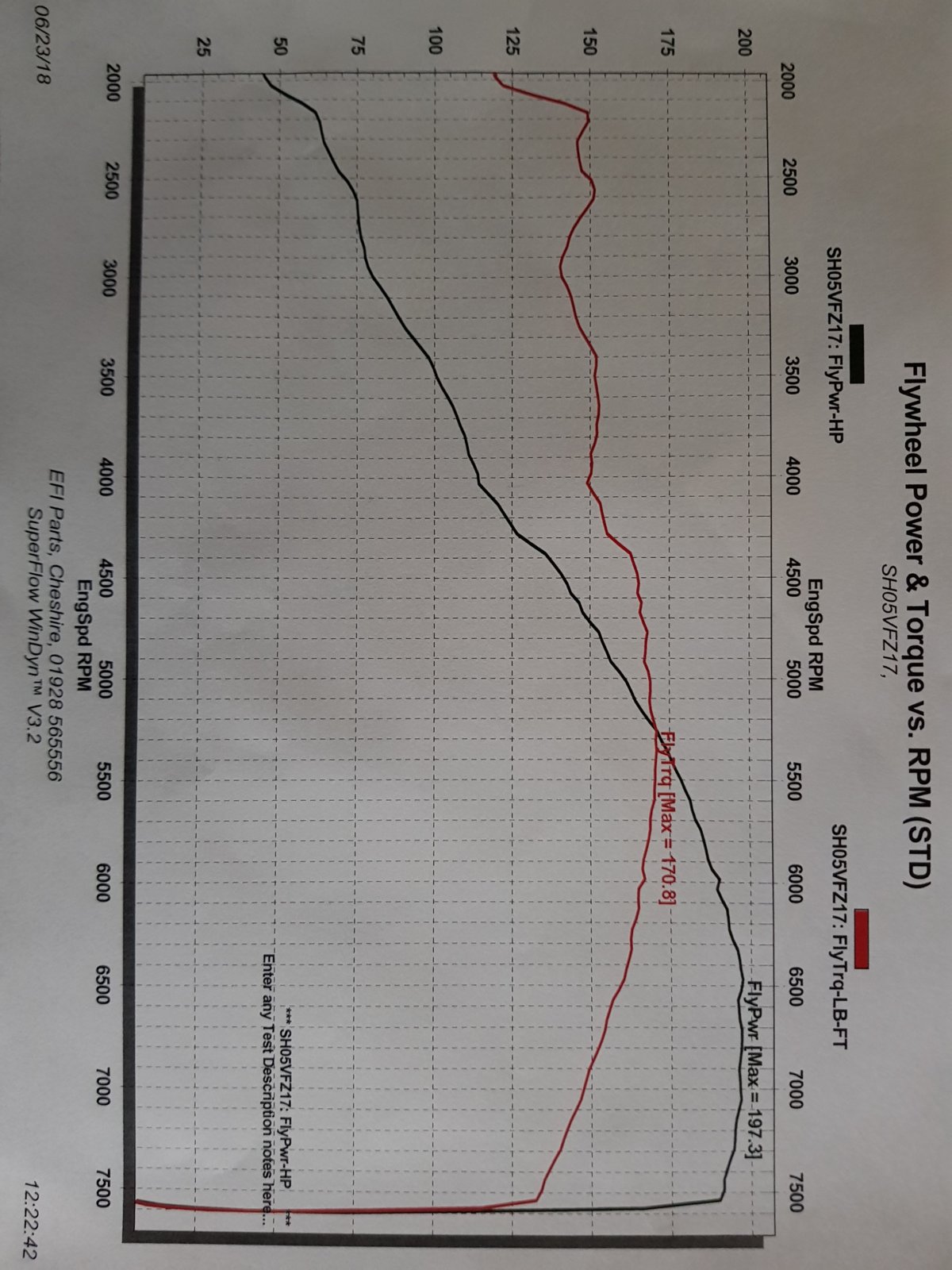

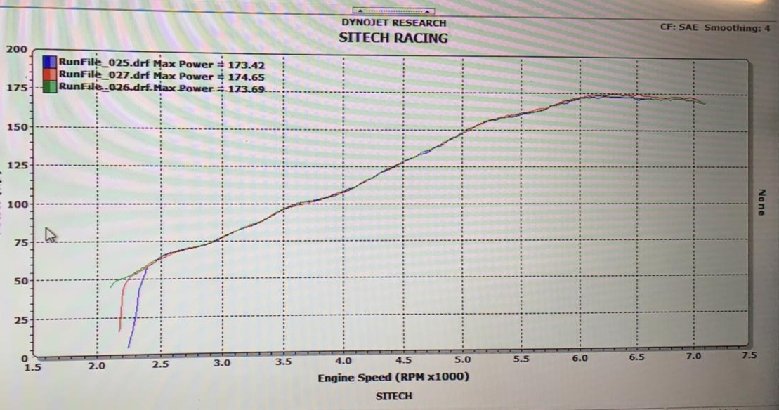

My latest power run with group n timing and jenvey bodies , we ended up fitting larger injectors to be safe.
One issue I am having is poor running below 2000 rpm , no matter what fuel and timing the car hesitates . As soon as the car is over 2000 rpm it clears and pulls perfect , one theory is fuel drop out in the inlet due to low air speed. Ive ran this same set up on an old engine bar the cam timing and never had this issue, guessing with the timing change I may have valve overlap ??

I think you're bang on with the low port velocity, I'm having the same issue at the moment on the micra with some wild cams and a big port head

Im assuming this is wheel power,
How dose it feel to drive now? Any video’s of it on idle?
Pez
neil a
Yes power at the wheels
Feels good, with good pull through the rev range , different to drive as now on a seq gearbox.
I dont have any idle videos but it idles smooth at around 900 rpm.

Jenvey 48's
Had this same issue both on standard injectors and peco 480 injectos which have a narrower spray pattern.
In the past i have ran this set up of bodies,ecu,exhaust , on a standard engine , standard engine with ED cams , high comp engine with ED cams and we have never had this issue.

Have same setup as you. Jenvey 48mm, group N timing, I'm on meg225 injectors, 182 manifold, gen90 ECU, with a super light flywheel and mine does not hesitate or murmer under 2k. Idles ok at 1000rpm under that it very lumpy and I got sick of people saying that doesnt sound very well, so I upped it.
I can't honestly see why yours would do it?
